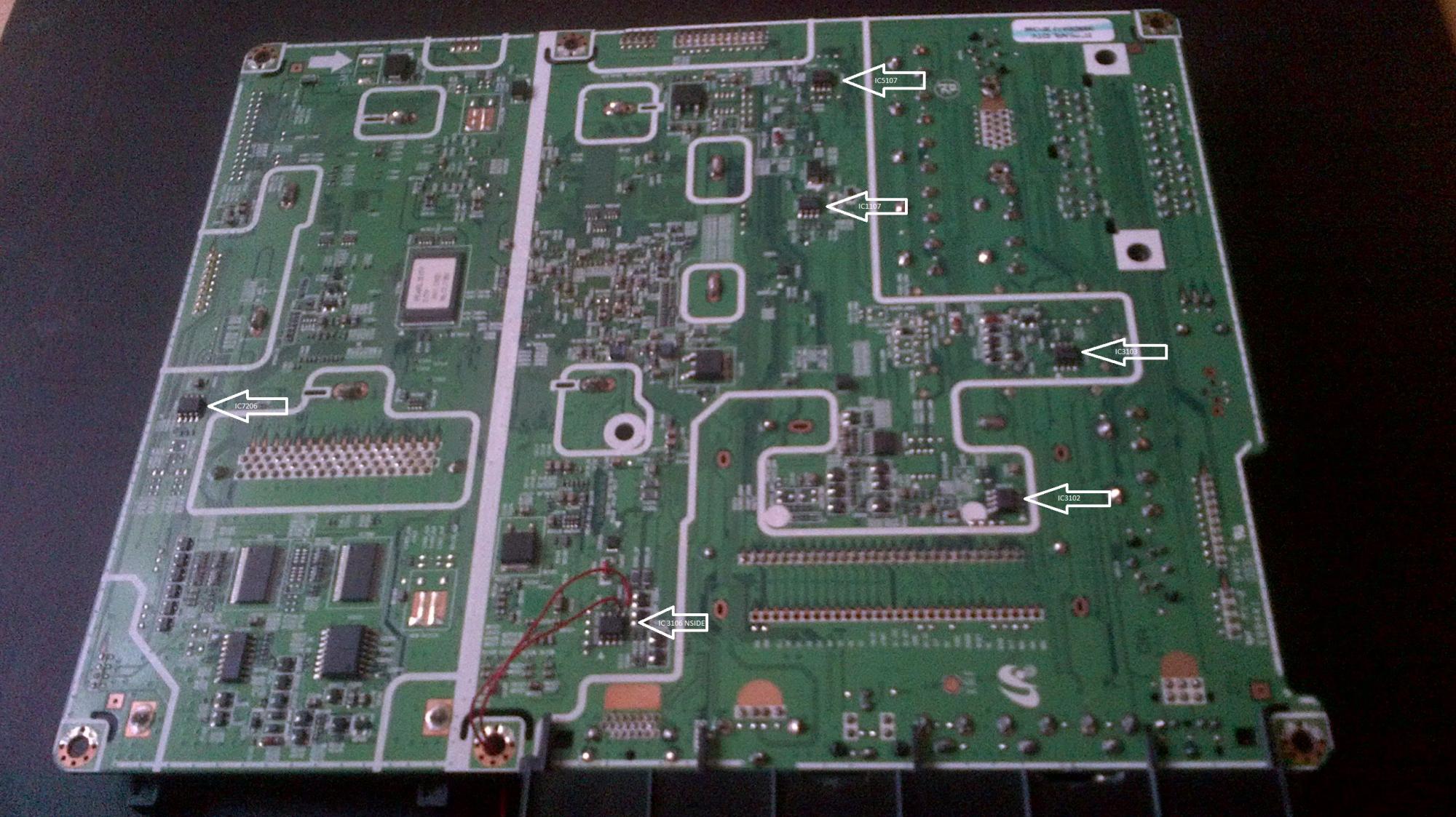

    I've attached a marked pic of the backside of your mainboard. Could you list what it says on the marked 8pin chips?
    One of them should be a 256KBit EEPROM, usually from Atmel.
    It should say ATML in the first line, and either "(AT)24C256B" or "2EB1" in the 2nd line.
    Resetting that (or replacing it) could bring it back to life. I remember that when I played with the service menu settings on my Samsung too much, it wouldn't turn on anymore (LED blinks a few times, then goes steady (standby mode))
    Had to reset the EEPROM to get it to boot properly again.
    Tell me if you found it.. the reset procedure is a bit tricky, but unlike buying a blank replacement, it's free
    edit: the BN41-00813E board is quite a bit more expensive *click*
    The bottom of that board looks different to the one I have. It does still have 6 8pin chips on it though and here are the numbers.
    2544 1ym 0815
    ATMLH820 0281 Z8F5509D (x3)
    ATMLH816 2EB 715070
    MP23630N p2831989 MP5815
    They are how they read on mine.

      I wasn't aware this was also a problem on the 5 series and from what I read it isn't. Here's hoping this turns out to be a case of 'don't believe everything you read on the internet'. Any 5 series I have replaced caps on I have never had to replace the eeprom on the mainboard. I have only had to do it with the older R series, although I know it does happen on the M series and S series LCD's and Q series plasmas.
      If your handy with a soldering iron I wouldn't waste your time trying to reset it, your better off just replacing it, save yourself the grief of possibly ending up with some functions still corrupted and or picture problems on some inputs.
      The Atmel AT24C256B is no longer manufactured so getting your hands on one for a sensible price will be difficult. There are sellers here in the U.K selling them on Fleabay but they are asking £2 with £1.50 P+P!!
      I have found a comparable epprom for replacing the AT24C256B but I am not sure if it will be alright. Can anyone with more knowledge tell me if it would be a good replacement. It's a Microchip 24LC256-I/P. The only difference I can see is the clock rate is 2Mhz instead of 1Mhz. Should be good but it's always best to ask before going and buying a pile of them!
      Remember to let us all know how you get on Jasgriff. I too am keen to find out if this does occur with the 5 series Sammys.
      Edit: Forgot to say HAPPY BIRTHDAY!!
      Tried it a few times and it still doesnt seem to bring up a picture oe play any sounds.
      The remote still seems to work the tv as the standby light seems to be doing all of the right things just nothing else really seems to be happening with it.
      I am going to try again a few more times to see if I can get it going.

              Going by a close up of your pictures your main board is a BN41-00813E-LP1.0 (it's written in white in the top left corner on the top side of the mainboard) Can you confirm this.
              This is the same main board as is used in the LE40M87BDX (you also have the same power supply as the LE40M87BDX going by your pics)
              The main board you would expect to see in the LE37A556P1F is the BN41-0094A. If you do end up going down the route of having to change the main board this is a possible replacement as well as the BN41-00813E.
              For your board (BN41-00813E) It looks like the eeprom chip you want to be trying to reset or replace is located at IC1803. Find this and tell me what the serial number is.

                BN44-00974B is the mainboard.
                IC3106 = ATMLH820 0281 28F5509D is the one that I have as being the one that needs shorting.
                This is the one closest to the 100ohm Resistors
                There are 3 of those same Atmels on the underside of the mainboard.

                                        Here is a pic of the board with labels on where the IC's are.

                                          The difficulty I am having is sussing out which one of those eeproms is the one that's used to store the software we want to try and reset and what the others are used for (given that one will likely be a back up).
                                          We can rule out the MP23630N as it's not an epprom and I am pretty sure we can rule out the ATMLH816 (also know as AT24C32CN) as it only has 32K of memory, not enough to store the operating system, it requires a minimum of 256K. The remaining 3 ATMLH820 (also known as AT24C02) are essentially the same as the previously mentioned AT24C256B (the one Techamp want's to be replacing, lol) except they are surface mount rather than through hole IC's.
                                          Soooooo that tells me one of the 3 ATMLH820 will store the operating system, another will store the back up (or possibly both, I just don't know)
                                          Here is my dilemma, lol. I presume you chose IC3106 because it was beside the 100 ohm resistor but that was from Scenics reply to what we now know is Techamps pics (the BN41-00813E mainboard) So I personally wouldn't apply that to your board, given it's a different design.
                                          Now, lol. Like I mentioned originally I cant find any cases were even resetting or replacing the eeprom on the LE37A556 (BN41-0094A) has been done. although it has been done on the LE40A557 (mainboard BN44-00199A) and it is located at IC5107.
                                          My gut instinct is that the eeprom is the problem and replacing it is a lot cheaper the paying out for a replacement main board (A lot!). The problem is, I'm stumped at this point. I even have the service manual and it states, from what I can tell, that it uses a AT24C256B (the one Techamp needs?!?!) and it is definitely the parts list for the LE37A556P1F (BN41-0094A).
                                          My brain is frazzled (I need another coffee!) and we need someone with more knowledge about your main board. My problem now is I won't be happy till I find out which one it is!
