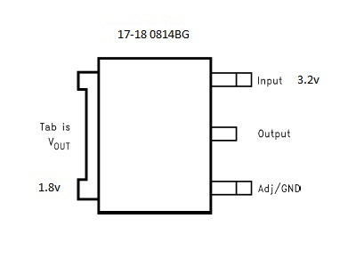

                        CH? 17-33 0818BG
                        CH? 17-18 0814BG
                        ch? 1117 0819BG x 2
                        17-25 0807AG
                        KIA 78D015F
                        Those are the ones I can see on the main board.

                          CH? 17-33 0818BG: More likely to be the same as LM1117 3.3V FIXED Regulator
                          CH? 17-18 0814BG: More likely to be the same as LM1117 1.8V FIXED Regulator
                          ch? 1117 0819BG x 2: More likely to be the same as LM1117 Variable Regulator, the voltage will set by two resistor on one of the PIN.
                          17-25 0807AG: More likely to be the same as LM1117 2.5V FIXED Regulator
                          KIA 78D015F: More likely to be the same as LM7805 low drop out type 15V FIXED Regulator
                          So just look up the datasheet for them.

                                  I still do not know which IC will be using 1.5v for VCC, the cpu will more likely to use the 1.8v. But we will find out if he can find what went out on the main board.
                                    #57
                                    Re: Samsung LE37A556P1F Flashing red light
                                    Ok thats all of the readings from the voltage regulators listed.
                                    All seem to be performing ok.
                                    Not sure how to test what the variable regulators should actually be outputting though?

                                      The one with the adjustable output using the resistors at the adjustable pin, there is a note in the spec sheet on how to set the out put voltage by calculating the value of the two resistors. You will have to Ohm out the two resistor and see if you put those value into the formula to see what it should have at the output.
                                        #59
                                        Ok I have tested the first set and these are the results and my calculations do they seem correct?
                                        The second set of readings are attached and they seem to be alot closer to what I would be expecting to find.
