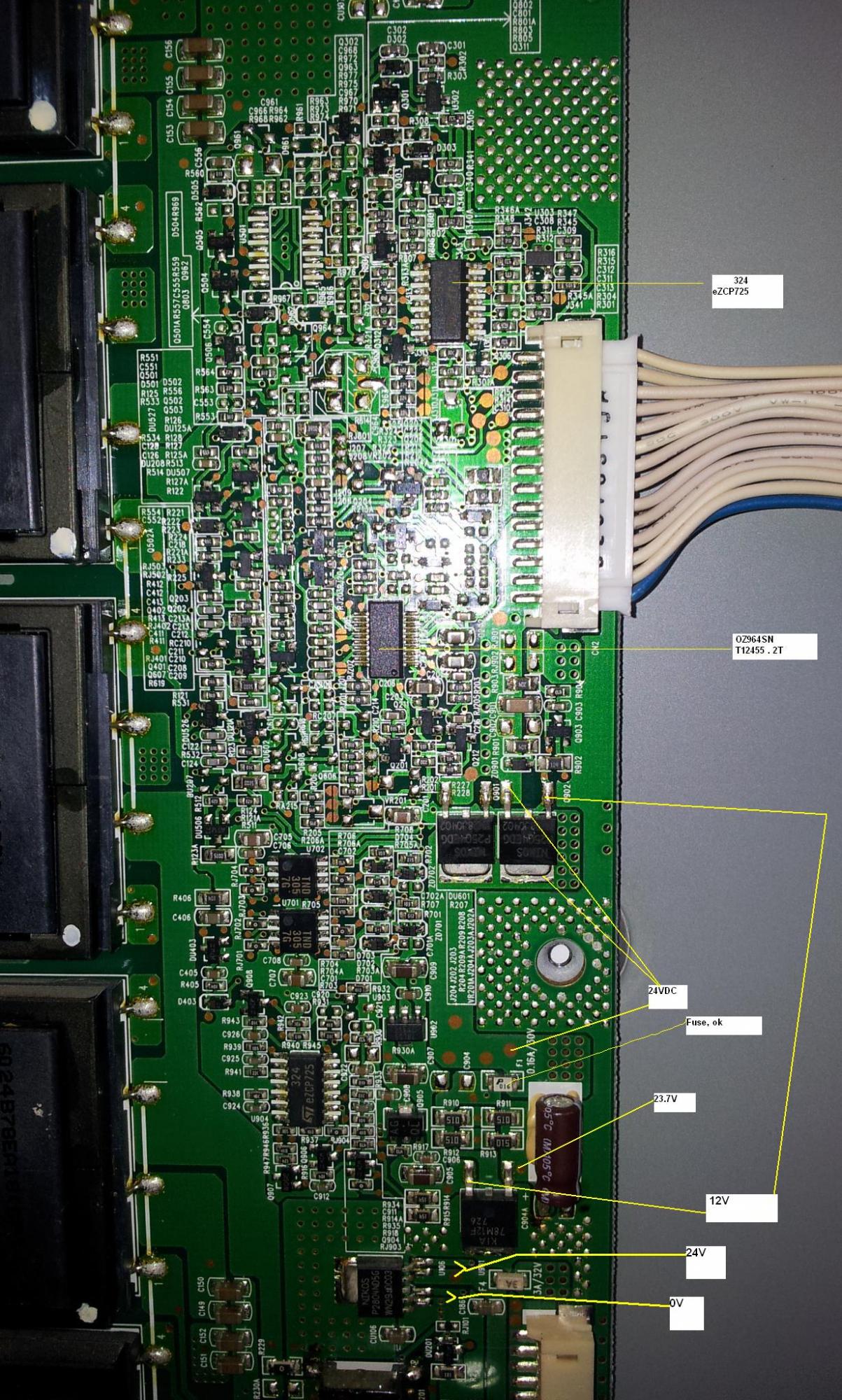

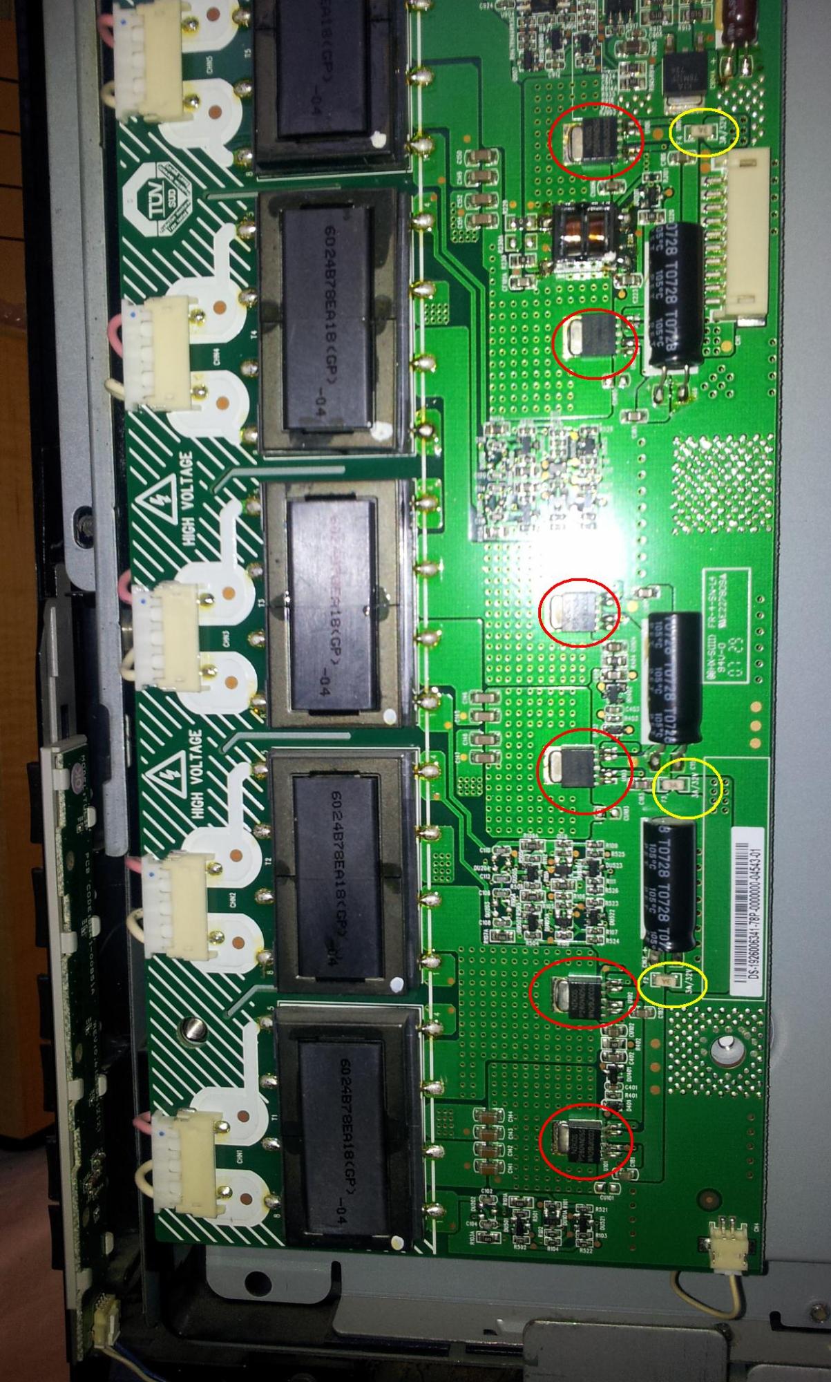

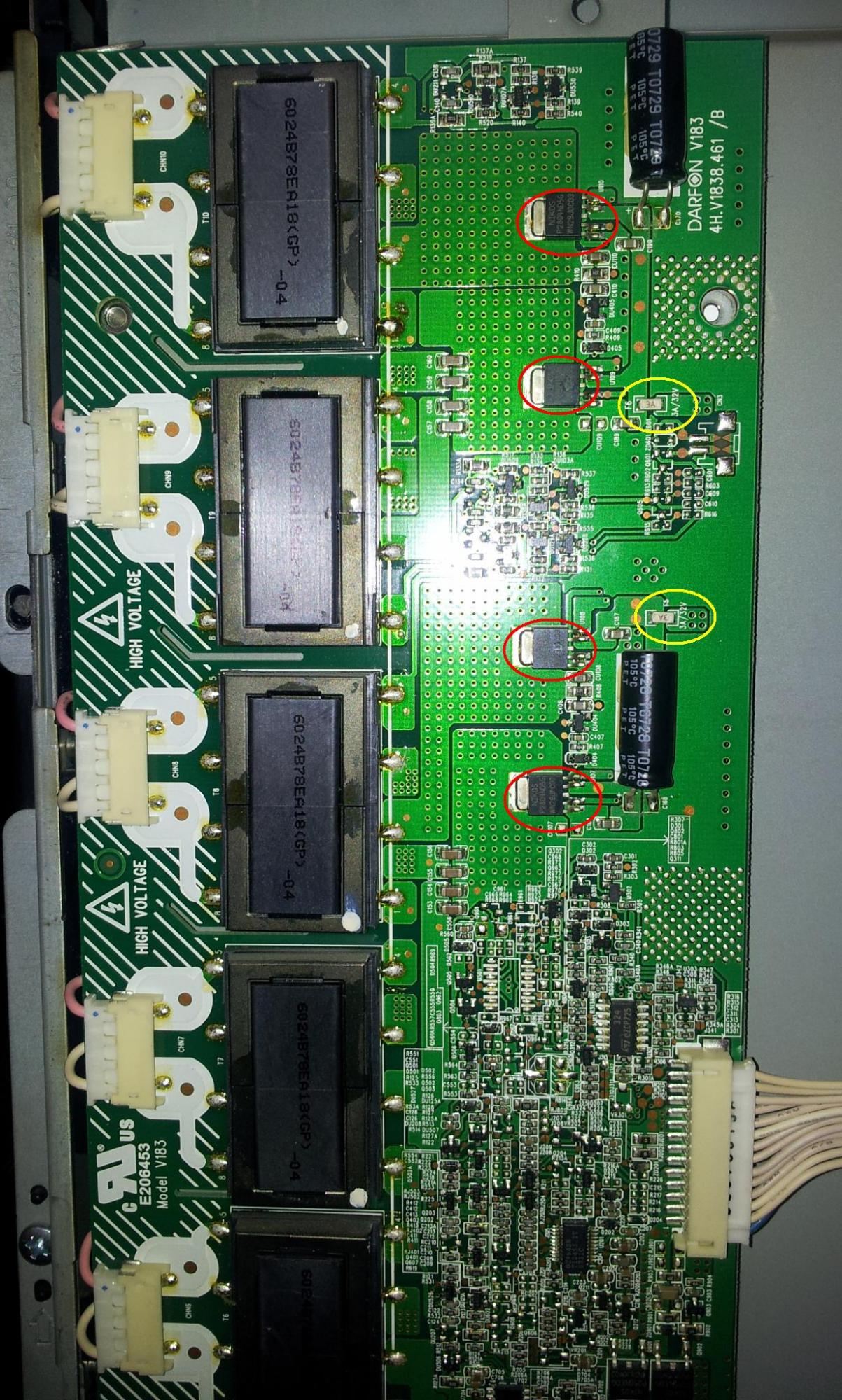

      Re: Samsung LE37M86BD wont turn the screen!
      Hookup a DVD source playing a movie. Plug it into the TV. In dark room, ..
      1) ..can you see the DVD playing without the backlight on? nothing
      Try shining a flashlight on it. didn't help.. Is there sound? Yes
      2) Circled in red are some ICs. What is the part number?
      P2804ND5G, N- & P-Channel Trans.
      3) circled in yellow are SMD fuses. 3A/32V, all are OK
      Is it a good idea if I disconnect all inverter channels by disoldering those 3A fuses, and test only one ch. at a time?

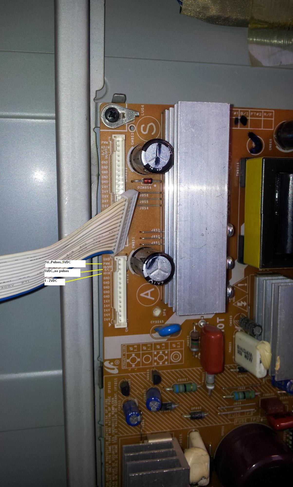

      On PSU board, there is no pulses at " PMW & ADIM". Is that normal. There are no pulses at all on the Inverter board, when the TV is ON!
      I made & noted down som measurements on the boards for your info!
          1) Here is the datasheet for
          http://pdf1.alldatasheet.com/datashe...P2804ND5G.html
          Refer to the diagram for pinouts.
          2) Measure the resistance between S1-G1, S1-D1, D1-G1, S2-G2, S2-D2, D2-G2 for all chips. You can do this in circuit and report all readings. Any reading under 30 ohms suggest the mosfet might be shorted and warrants desoldering and verifying the reading out of circuit.
          3) PS. Since you are getting sound, the power LED on, and a brief flash of backlight, this narrows down the problem to the inverter board.

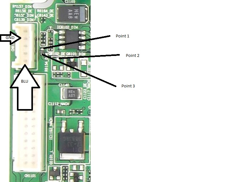

                Re: Samsung LE37A556P1F Flashing red light
                I have traced BLU back to the mainboard and here is a pic of what it look like and how I tested it.
                GND to BLU = 0.1v
                GND to Point 1 = 0.1v
                GND to Point 2 = 5.2v
                GND to Point 3 = 5.2v
                  Can you please post the picture without the marking so I can see if the trace is connected to the Collector pin ( middle pin the small 3-pin device) through the resistor?

                    #29
                    Sure....

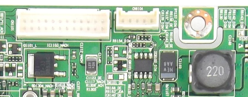

                      I actually ordered a second mainboard for this set which turned out to be a slightly different model.
                      It doesnt have the connector or the resistor attached which allows me to test if that pin connects to the collector through the resitor and it definitely does.
