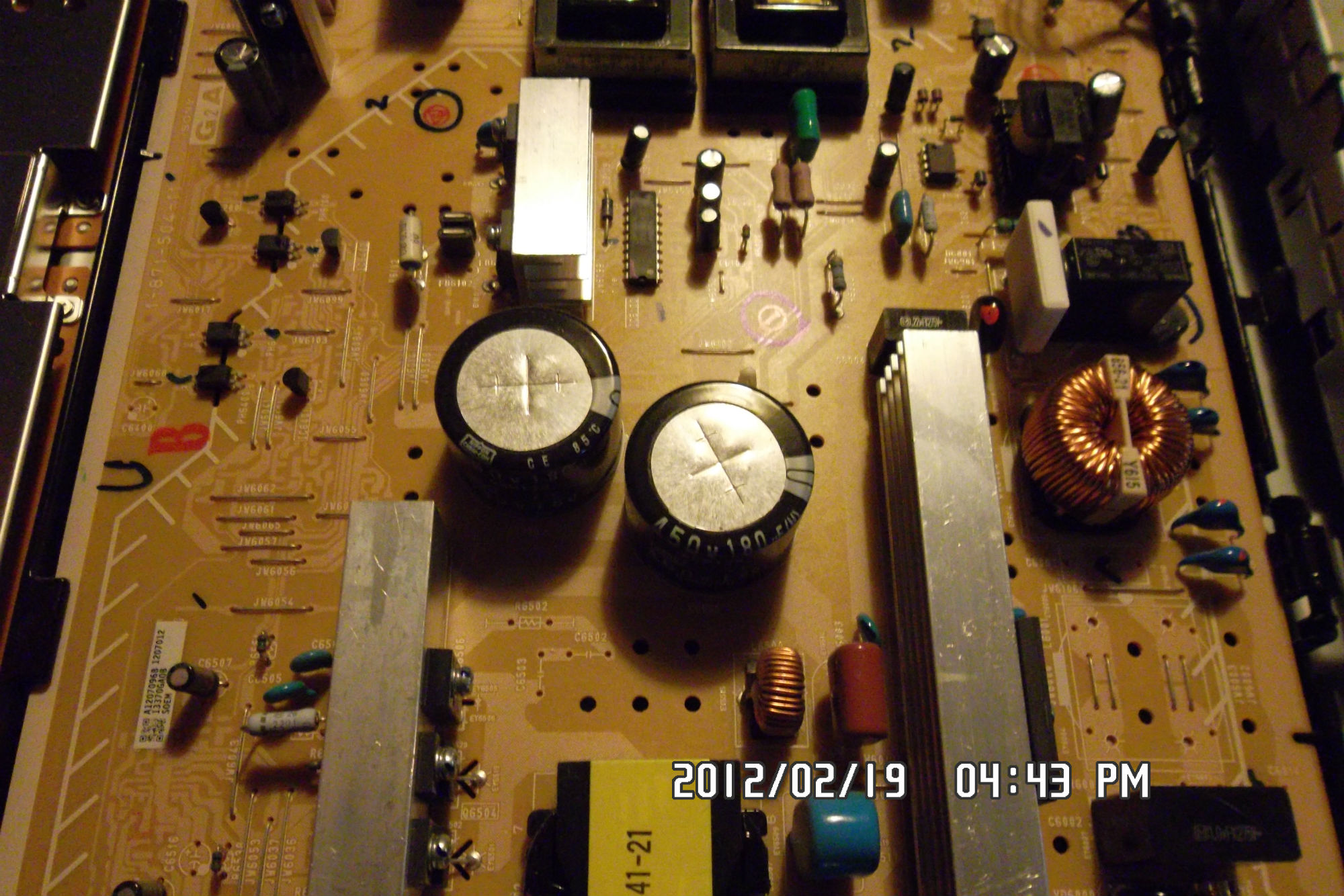

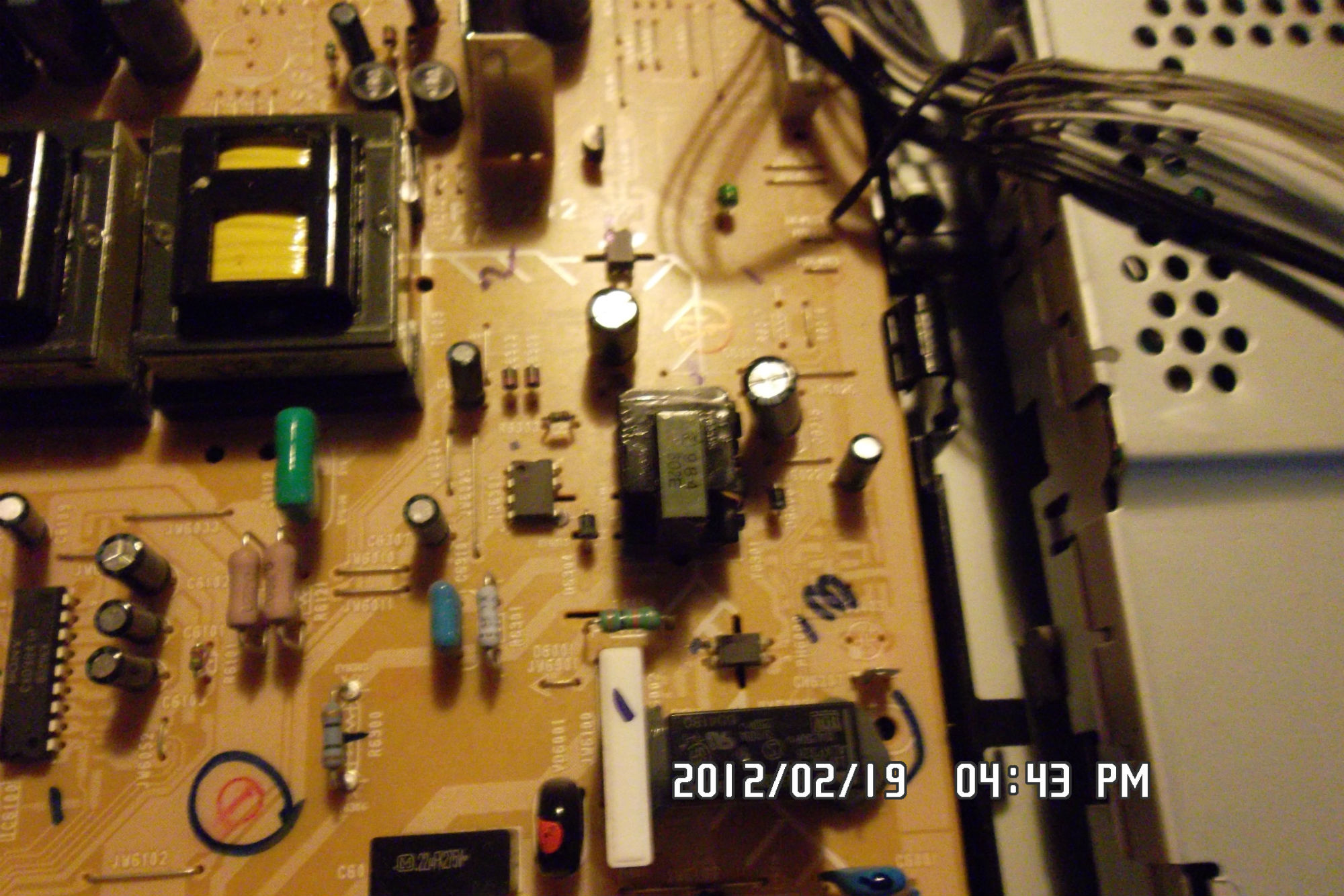

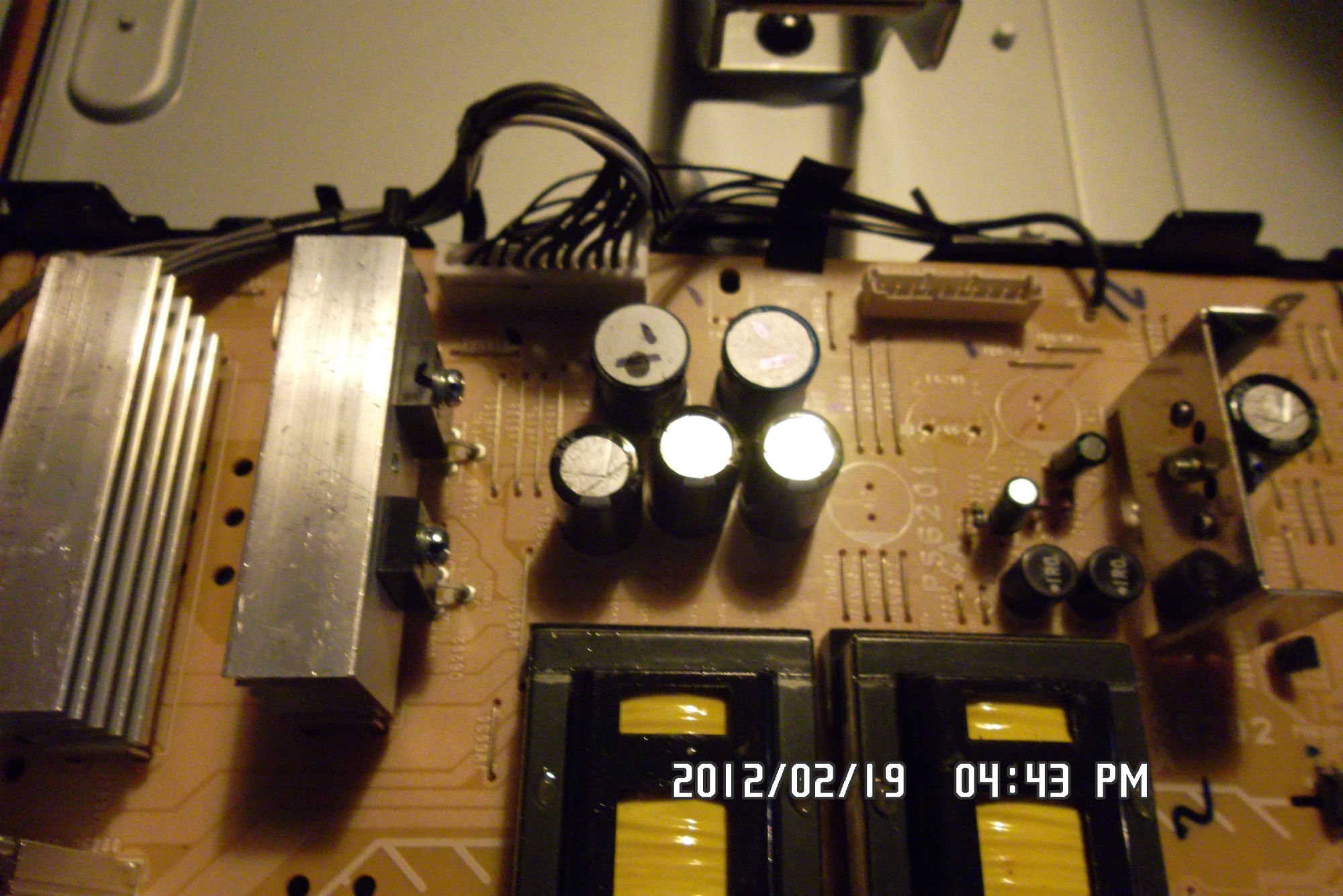

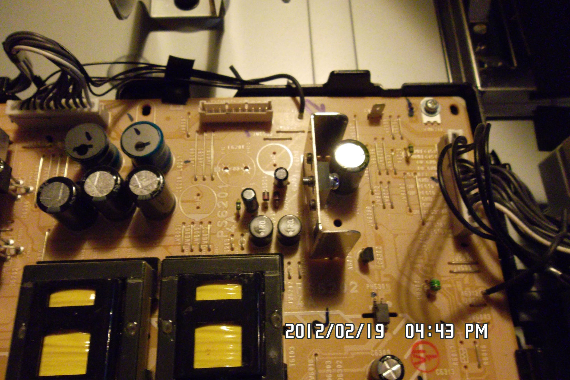

Hello. I was given a bravia kdl-40v2500 that behaves weirdly. I get a picture for 5 minutes, then it turns off, then turns on again, displays picture for 5 minutes, then off again maybe 5 times, then it is permanently off. When it shuts down I get 5 red flashes from the status led in front of the tv. Before I start the process of disassembling the tv I thought I would ask here. Is this typical of faulty caps? Is this a much more serious problem? What is your experience? Thanks for the help.

I will source a camera and get back to the forum. However it seems I can't count. It is actually 9 flashes. I don't know if this changes anything.Comment
Re: Sony Bravia kdl-40v2500, not working properly bad caps?
9 is not shown
02 Main Power Error Pwr_Err
05 DC_ALERT3 DC_Alt
06 Backlight Error Bck_Lgt
07 Thermal Error Temp_Err
08 Audio Error Aud_Err
10 Digital FE/BE Error Dig_Err
12 HFR Error (Tcon) Hfr_Err
13 Balancer Error Bal_Err
14 Tcon Error Tcn_ErrsigpicComment
