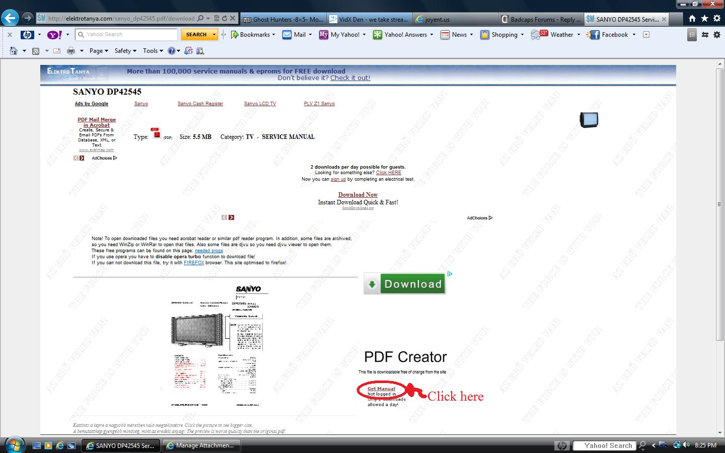

    Down load manuals here:
    http://elektrotanya.com/samsung_ln26.../download.html
