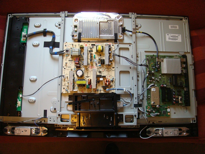

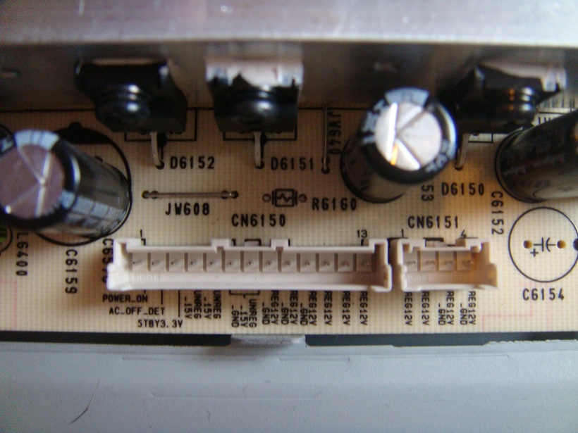

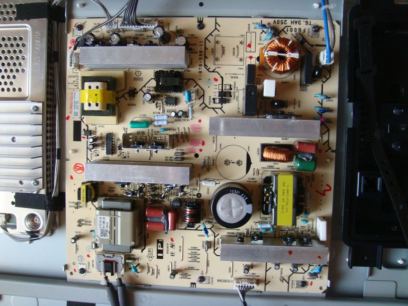

    Hi guys picked up this bravia lcd last night, powers on to solid green led for a few seconds (nothing displayed) then blinks 8 red leds, no sign of bloated caps, not many on this psu, any help would be apreciated, difficult to read voltages as only green for a few seconds
    thanks Ronnie

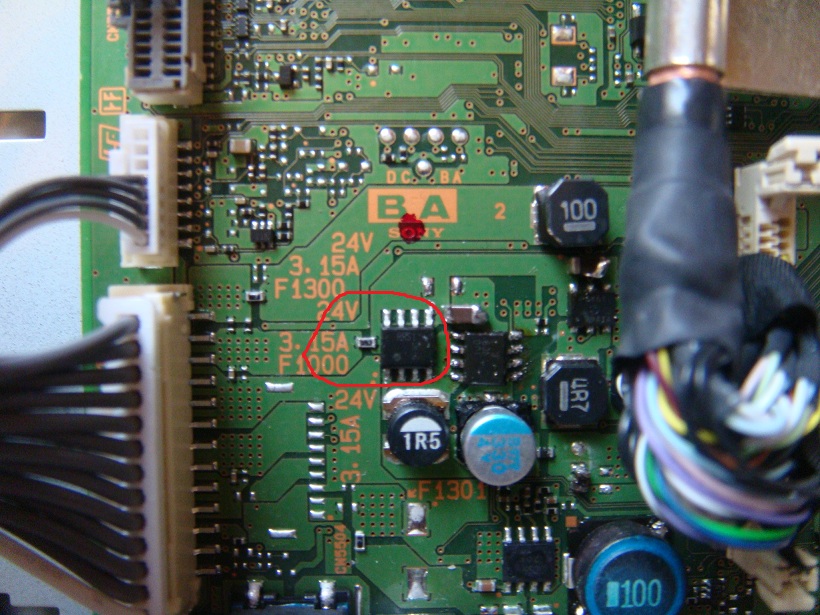

    Ok managed to find service manual for W5800, 8 flashes is audio? just checked the main board and what I think is smd fuses, found one which is open, could this be the 12v audio supply? pic included

        Re: Sony Bravia KDL-40W5810 fault
        Well, replace it. If it blows again, then there's a fault with the audio section - probably one of those SO8 MOSFETs / audio amps.
          Originally posted by tom66
          Well, replace it. If it blows again, then there's a fault with the audio section - probably one of those SO8 MOSFETs.
          I did a temp fix with fine strand of copper wire! made no diffrence? still 8 red flashes
          sigpic
            Check where the 12V disappears. Might be another fuse that's blown.
              Thanks Tom, there does seem to be another open smd fuse on the otherside of the board, but the fuse for 13v audio in the manual is intact.
              I may just need to source another board, I think the psu is ok, this smd stuff is tricky to work on

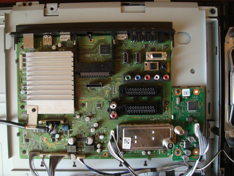

                      hi can you post a much clearer shot in main board and the board at the bottom of it? and please confirm if you have 12v dc out from main smps so we can focusing trouble shooting in main board.
                      • netdent
                        • May 2011
                        • 208
                        Hi thankyou for your response to this, I now have the tv working, I replaced the main av board which cured the fault, the replacement board did not have connector for the freesat board (small board below main av) as it was slightly diffrent model, I managed to buy all the boards from the set for £70 which is handy if you mis diognose the faulty board
