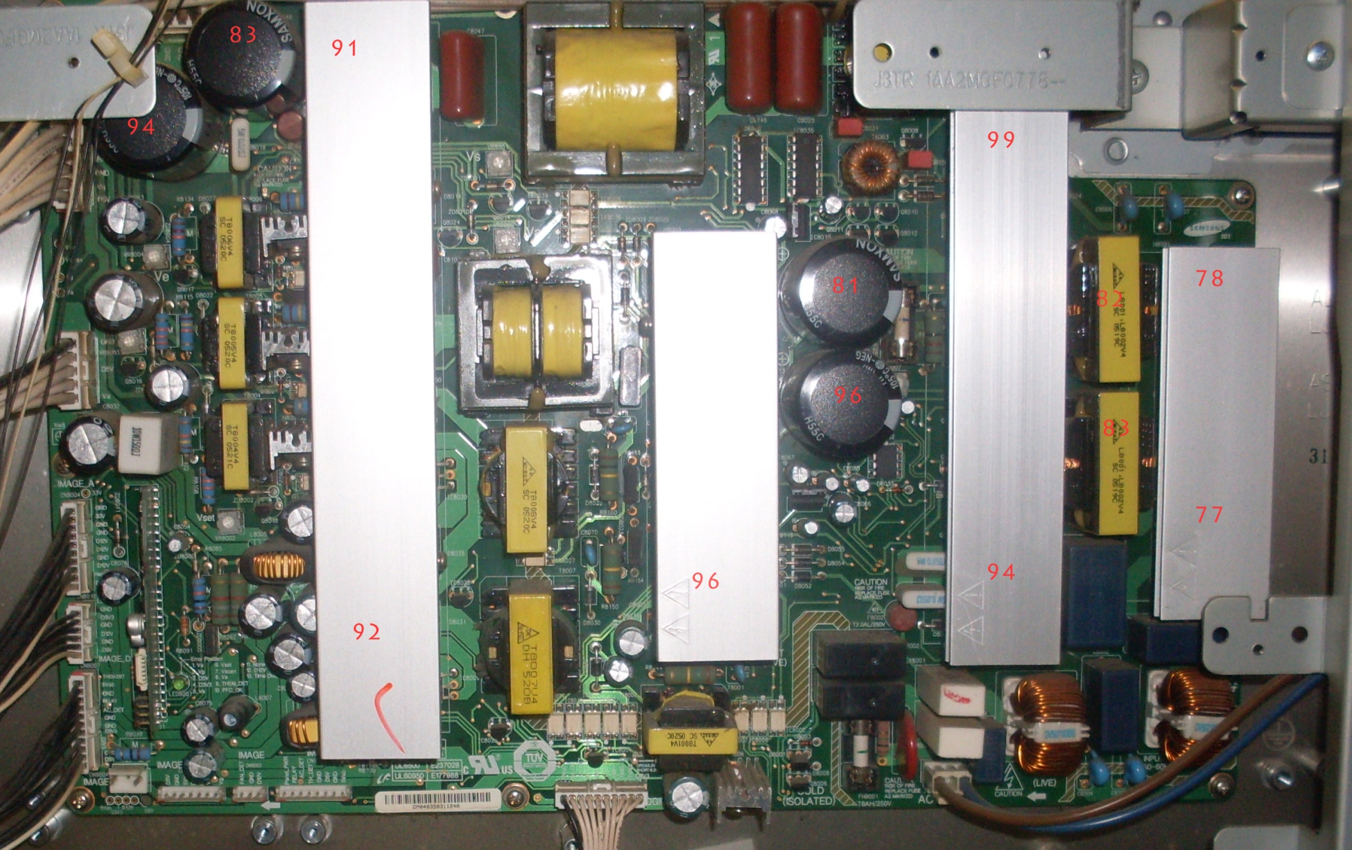

    I have infrared thermometer , we use to check the heat in the tires of our drag car .. that should work , i'd think . let me go grab it from the shop .
    I'll check them , last time i left it on for a couple hours to see if it would show anythign different , and i am thinking nothing really had any heat to it. (when it was working this thing had heat for sure lol .

      Originally posted by rpgruss
      If you have a non-contact infrared thermometer, turn the TV on with everything connected. Give it a few minutes, check the temperatures on the Y and Z sustain board heatsinks. They should be warmer than room temperature. If one of them is room temperature then that is likely your defective board.
      turned it on for about 20 mins ( its in my garage , and its alittle nippy tonight ) heatsinks are 67 degrees and 68 degrees on other .. hummm

        Let me ask a couple more things. Should the Main board have temp in heatsinks since Va and VS was where it should be ? Is there any other voltage i need to check on the mainboard ?

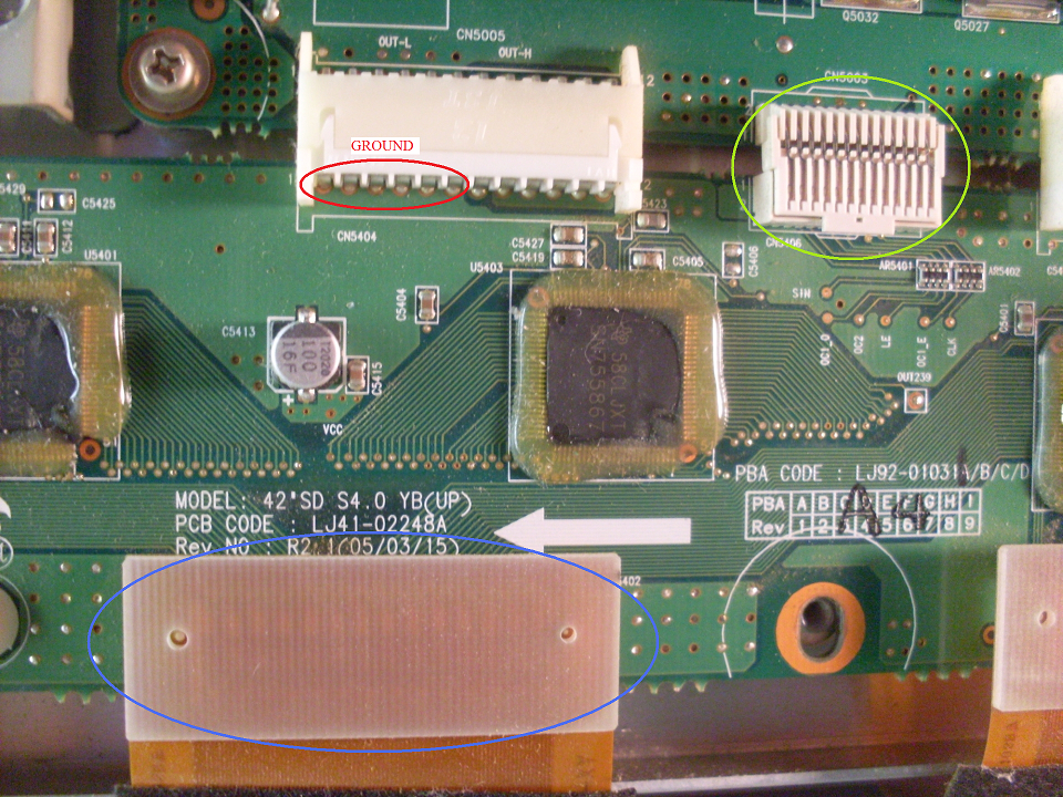

            Re: Sanyo DP42545 no video, has sound . Ready to try some tests.
            Originally posted by Jimmy Nolins
            So i read some other posts again and thought at least let me check the y upper and y lower buffer boards . I recalled reading here about coppell blog and a write up they did. So i found it , but my buffer board connectors are different then the black ones shown . How do i test the style i have ?
            To test Y-Buffers:
            1) Disconnect the ribbon cables to the Y-buffers, circled "blue".
            2) Disconnect the connectors, between the Y-buffers and the Y-SUS, that look like the one circled in "green".
            3) Disconnect the Y-buffers from the Y-SUS by placing a flat screw driver between the PCB boards, near the connect outside end. Apply twisting pressure until it unseats a little. Move to the end of the connect and repeat.
            Continue this for the next connector. Go slow and gentle, until the connectors seperate.
            4) With the Y-buffers out, test one buffer at a time. Set DMM to continuity test, page 14 of Fluke 80 series III manual.
            5) Place one probe to any lead circled in "red" then slowly run the other probe down each side of the connect circled in "blue". Do this for the other connect, the one with the "red" circle.
              Thank you very much cmj21973 , I did this ( with beep feature on ) and got NO beep . I also check the backside of board to be sure and and no beeps . that was the UP board , i checked the LOW board ( pin layout is reversed for ground) also got NO beeps .
              So at this point it seems the Main board is showing correct voltage on VA and VS , and the buffers ( up/low ) seem to be good .
                      Not giving up yet , So questions :
                      1) Should the Main board/ power supply board have heat roughly the same across the board with what my tv doing what its doing ? ( right side last heatsink staying 77 degrees ..... The Y main board heat sinks are 76 and 78 /// the x main heatsinks are 81 and 78 .
                      2) If the PDP is bad .. what else can i check to verify it is ? ( iam still thinking pdp board or logic) IF PDP is would there still be heat in the y and x main boards .
                      3) Any spots i should check on y and x board with DMM ?
                      Last edited by Jimmy Nolins; 02-17-2012, 02:12 PM. Reason: heat temps marked on board
