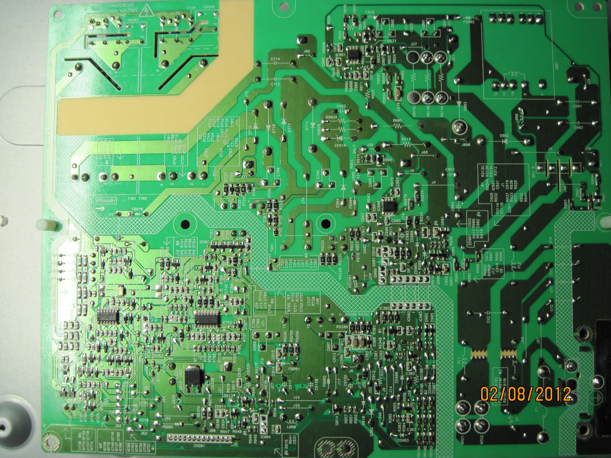

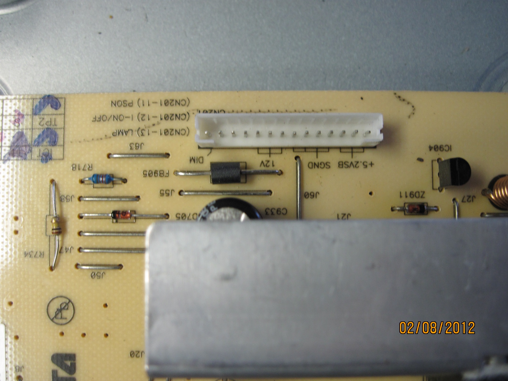

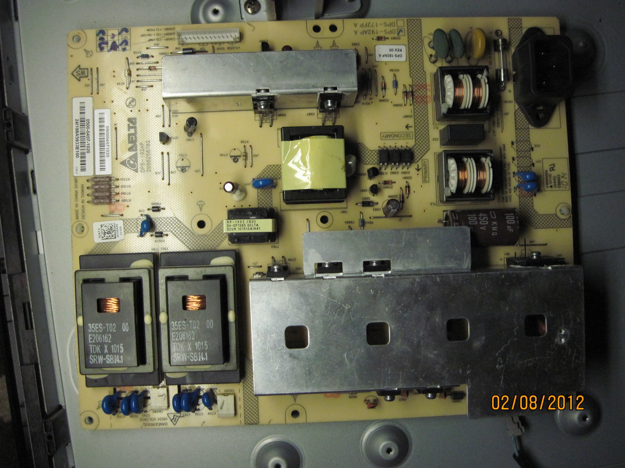

If you really want help you are going to have to give us something to work with.
1. We will need two pictures, each close to but not over 2000 pixels on a side. The first should be of the top side of the power supply, the second of the bottom side. To be adaquate we should be able to read component identifiers. To be exceptional we would be able to read IC part numbers.
2. AAA third picture showing the printing near the power supply output connector would be helpful.

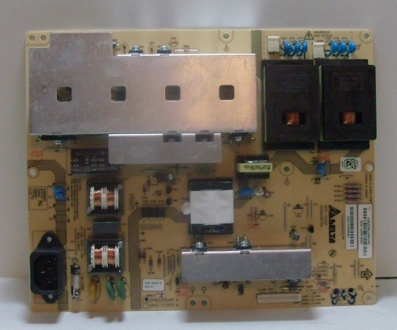

Hopefully this time they will be pictures of YOUR boards as it is, it looks like 16 people have wasted their time trying to find fault with this
http://www.ebay.com/itm/Vizio-E370VL...item3cc0dd2713.
Hopefully some of them will be more forgiving than I.Please upload pictures using attachment function when ask for help on the repair
http://www.badcaps.net/forum/showthread.php?t=39740Comment
Re: vizio e37ovl turns on and back off
I am very sorry my intension was not to mislead anybody. I was unable to figure out how to upload my actual pictures; therefore I used a picture of one like mine. I was just showing everyone what my power supply looks like. Since then I have figured out how to upload the pictures and will be posting the three pictures that were asked for along with the readings. Again I'm sorry and thank you all for your help, TomLast edited by yankys; 02-08-2012, 07:56 PM.Comment
The readings are as followed (as asked for in post 4)....
Ps_on 0.3 while off
Ps_on 2.98 while on
24V pin 5.36 while off
24V pin none while on
450V/100uf capacitor 164.3 while off
450V/100uf capacitor 393 while on
12V pin 0V while off
12V pin 12V while on
Here are some picture of the top, bottom and power output on board. Any help would be greatly appreciated.
