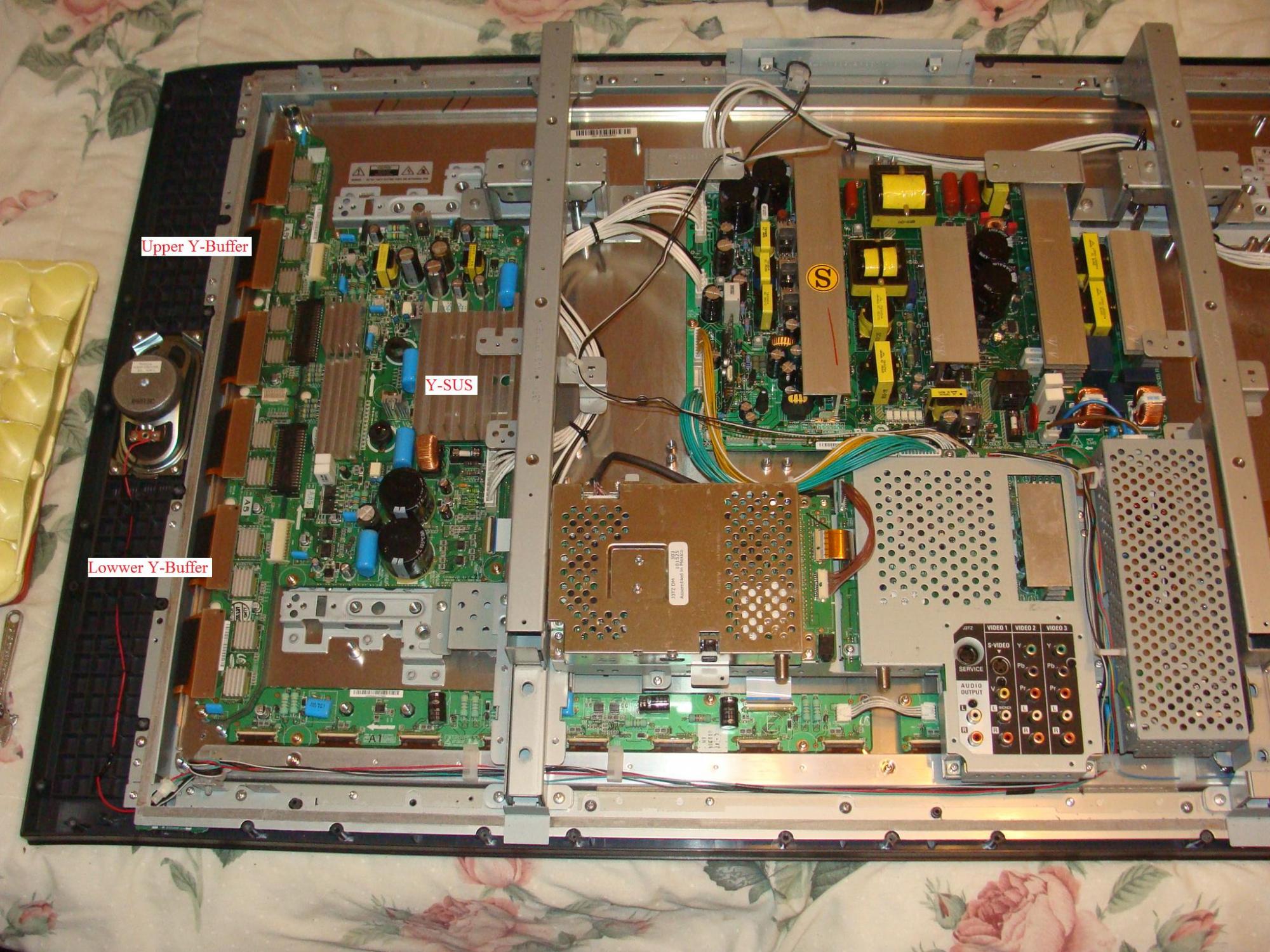

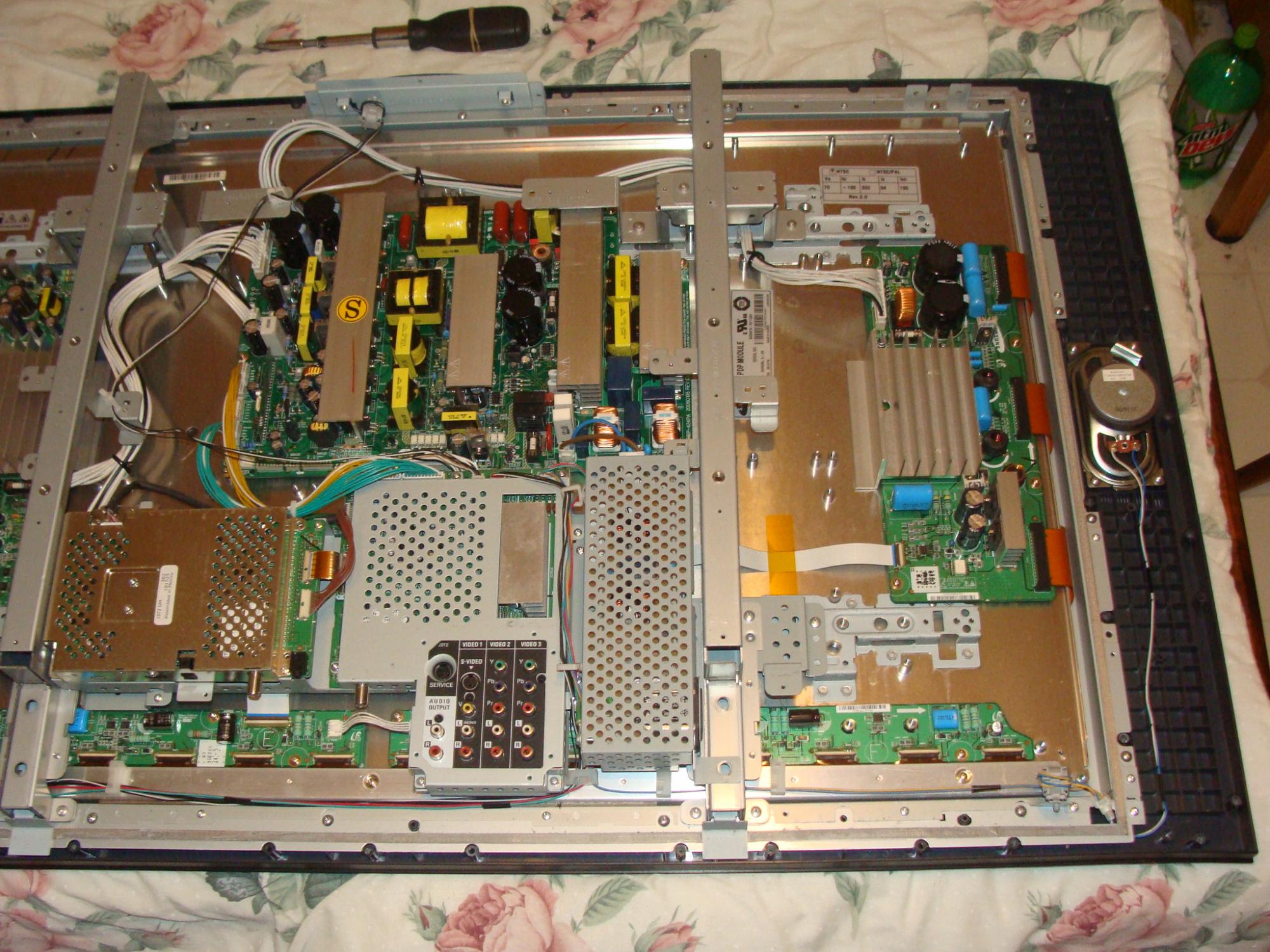

    Found this set on the curb waiting for trash pick. No remote or power cord. Looked in trashcan for them, but seen dog pile bag on top and said screw them.
    I have a power cord that will work. Can get a remote if you all think its worth saving.
    Took back off and plugged it in. No standby light, if it has one.
    Voltage reading just plugged in:
    Va=70 measures 0
    Vsc=-190 measures .21
    Vs=203 measures .01
    Ve= 84 measures 0
    Vset=195 measures 0
    Vg measures .12
    5Vsb measures 5.19
    D3V3 measures 0.01
    D12V measures 0.23
    D5V measures 0.59
    Pressed power. Front red LED on, steady, and screen black. No signal source attached.
    Green LED error code, on PSU, flashes 12 times indicating problem with D12V.
    Voltage power button pressed:
    Va=70 measures 0.06
    Vsc=-190 measures 0.19
    Vs=203 measures 2
    Ve= 84 measures .12
    Vset=195 measures 0.05
    Vg measures 0.06
    5Vsb measures 5.19
    D3V3 measures 0.01
    D12V measures 0.23
    D5V measures 0.5

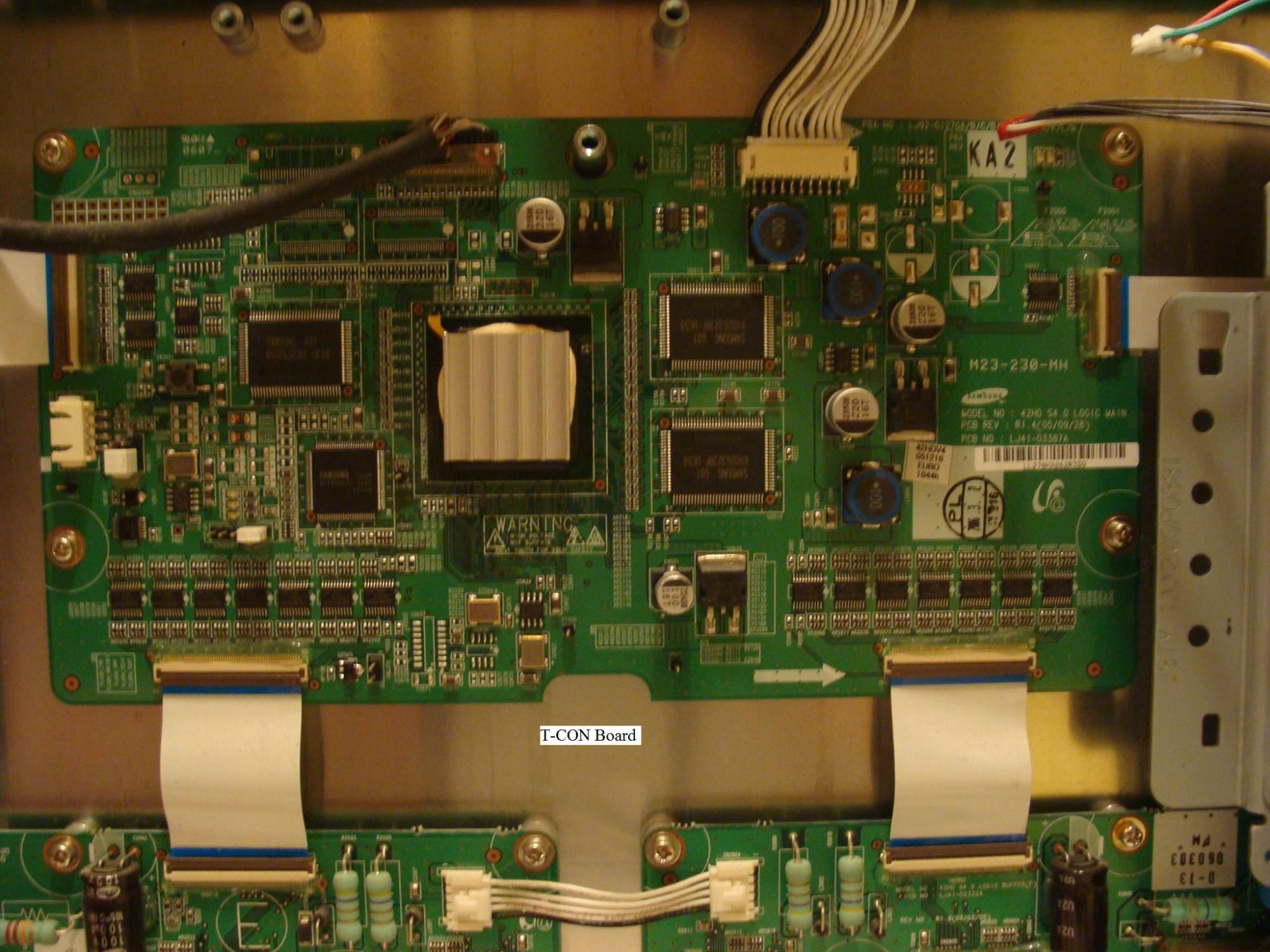

    Disconected the power cable to what I believe is the Y-SUS board. Applied power and pressed power ON button. PSU code error LED stays lit, no flashing.
    Reconnect Y-SUS power cable and disconnect ribbon connect it to what I believe is the T-CON board. Applied power and pressed ON button. PSU code error LED stays lit, no flashing.
    Voltage reading in this state:
    Va=70 measures 69.7
    Vsc=-190 measures -189
    Vs=203 measures 201
    Vset=195 measures 195
    Vg measures 15
    5Vsb measures 5.2
    D3V3 measures 3.4
    D12V measures 12
    D5V measures 5.2
    Questions:
    1) It's a 2006 set should I spend money on fixing it or part it out.
    2) I'm fairly sure it needs a Y-SUS board and the Upper & Lower Y buffer board, but how do I test if the display panel is bad or good?
    Have Owner's manual and Service Manual.
    Can't upload them, will PM/Email if needed.

        Found test for Y-SUS, Upper & Lower Y-Buffer.
        http://blog.coppelltvrepair.com/2010...er-boards.html
        http://blog.coppelltvrepair.com/2010...according.html

              Both Y-buffers tested bad. With the Y-buffers removed still get 12 flash D12v error code, so Y-SUS is bad also.
              I'm going to do a little dissecting on the Y-buffers.
              If I can't fix and watch it, I'm going to learn from it.
              • cmj21973
                • 267
                Re: Sanyo DP42746
                After some more web searching,
                I've decided to rebuild the Y-buffers and Y-SUS boards.
                Y-SUS board:
                1) IPM IC STK795-518 tested ok
                2) all fuses are good. (small through-hole fuses and large ceramic)
                Web search turned up location of shorted power mosfet(s).
                Will pull and check them. I'll replace the shorted ones or all of them.
                If this repairs the Y-SUS to working status, I will then tackle rebuilding the upper & lower Y-buffers.
                My reasoning:
                Buy Y-SUS and Y-buffers(upper&lower)= $200-$300
                IF the only thing wrong with Y-SUS is short power mosfet(s)= $4-$28

                          Got the heat sinks off of the mosfets on the Y-SUS. The thermal compound , what little there was, done harden like tile grout. The heat sinks on the upper and lower Y-buffers were the same way, no wonder they fail.
                          • cmj21973
                            • 267
                            Re: Sanyo DP42746
                            I should have ask if these IXTA36n30p (Q5006, Q5005, Q5007, Q5008, Q5009, Q5010, & Q5011) could be tested without desoldering them.
                            You can test them for continuity without removing them, right?
                            DMM set to continuity (200 Ohms buzzer), place neg. probe to D(tab) and pos. probe to G and then S. If continuity sounds it's shorted (ie bad).
                            I had one were source was shorted to drain.
                            1) Since they are all off the board, will this test find any more bad ones?
                            http://www.4qdtec.com/mostest.html
                            2) If not, what kind of test should I run?
                            3) should I just replace them all?
                            • PlainBill

                                You can temporarily run it with 6/7 MOSFETs but only do this for a minute at a time. Did that on a Panasonic plasma before replacing the FET entirely as a good way of confirming it was at fault.
                                • cmj21973
                                  • 267
                                  Re: Sanyo DP42746
                                  Seven IXTE36n30p should arrive in mail, today.
                                  Anything I should test/check before I install them, apply thermal heat sink compound, and resolder all three heat sinks in place?
                                  • cmj21973
                                    • 267
                                    Re: Sanyo DP42746
                                    I replaced all seven IXTA36n30p mosfet, reapplied thermal compound & heat sinks.
                                    Installed Y-SUS and connected power cable and ribbon connector to T-CON. Applied power to the set to put it in standby mode. Didn't press the ON button.
                                    The error code LED, on the PSU, is now lit steady. No flashing error code.
                                    The left LED on the T-CON board is flashing while the right LED is lit, not flashing.
                                    Am I correct that the power issue with the Y-SUS is repaired, and that the flashing left LED on the T-con is due to the Y-buffers not being installed?
                                    The upper Y-buffer has one bad (shorted) IC and the lower Y-buffer tested good.
                                    Should I test the set with just the lower Y-buffer or wait until I rebuild both Y-buffers?

                                      Installed lower Y-buffer and the plasma panel works, atleast the lower half.
                                      Still don't know what the left blinking LED on LJ92-01270 indicates.
