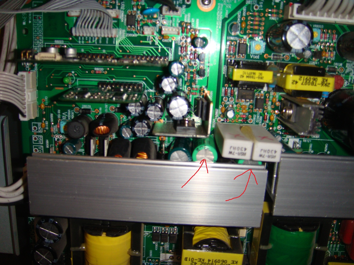

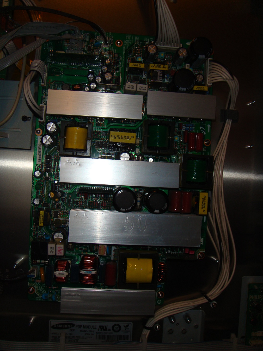

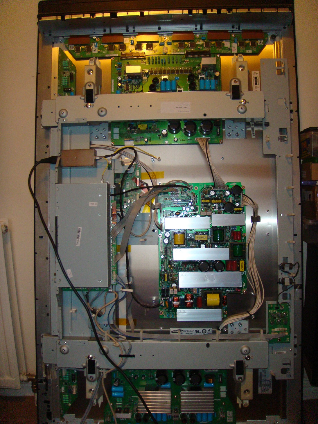

    Hi guys, went to pick this tv up to have a look at it for a friend, when powered up in his house went on to green led but no sign of life! I took it home removed the back then plugged it in and it worked! but I noticed a couple of domed caps on the psu, so I decided to replace these, acesss was difficult but managed to get at them by removing the 2 large resistors first, the caps were both 470uf 35 volts, not having the same value I replaced with 1000uf 35 volts (maybe a bad move?) anyway now when I power on it tries to power can hear the high volts etc but psu shuts off to 3 led blinks on the psu led, could it be these caps are now to high to do the job they were inteded to do? or coincidence, not able to find service manual, in pic 3 I have arrowed the 2 caps, the psu is PS-505-PNH or LJ44-00125A the panel is Samsung, any help would be great

    Did you use Maplin specials?
    Looks like Lelon. Ugh. Probably was better with the bulged ones.
    I believe this Samsung chassis has common problems with those two caps... there's a post somewhere about this.

      No they are recon 105 degree caps, will search for that thread, thanks

        Re: Phillips 50PF7521d/10 psu fault
        In this thread tom66 finds a whole bunch of bad Capxon caps in a PSU and measures them with his ESR meter. He finds that some of the bad ones (bloated) measured 2x their capacitance.
        https://www.badcaps.net/forum/showthread.php?t=17778
        So moving up by 2x may have an effect on your Philips as well?
            Take note however the PSU was still working with these.
            Increasing the capacitance probably isn't the major problem, although it may change the filter characteristics (if it has an LC filter), which in rare cases can increase ripple. Then again, I didn't design the supply, so there could be things like rise time limitations playing into the problem (power supply might be shutting down if voltage does not reach nominal in some amount of time, which is longer with 2x capacitance.) Just speculating...

              Ok thanks, now working, changed the caps for 2 rubycon 105 degrees, so far so good, now on soak test
