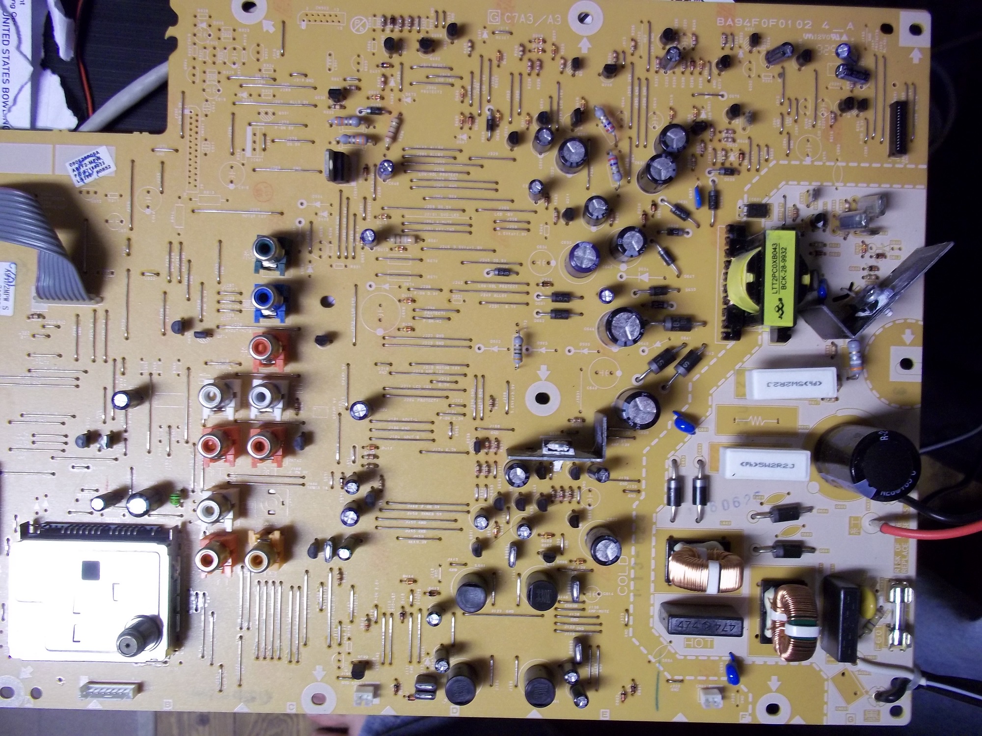

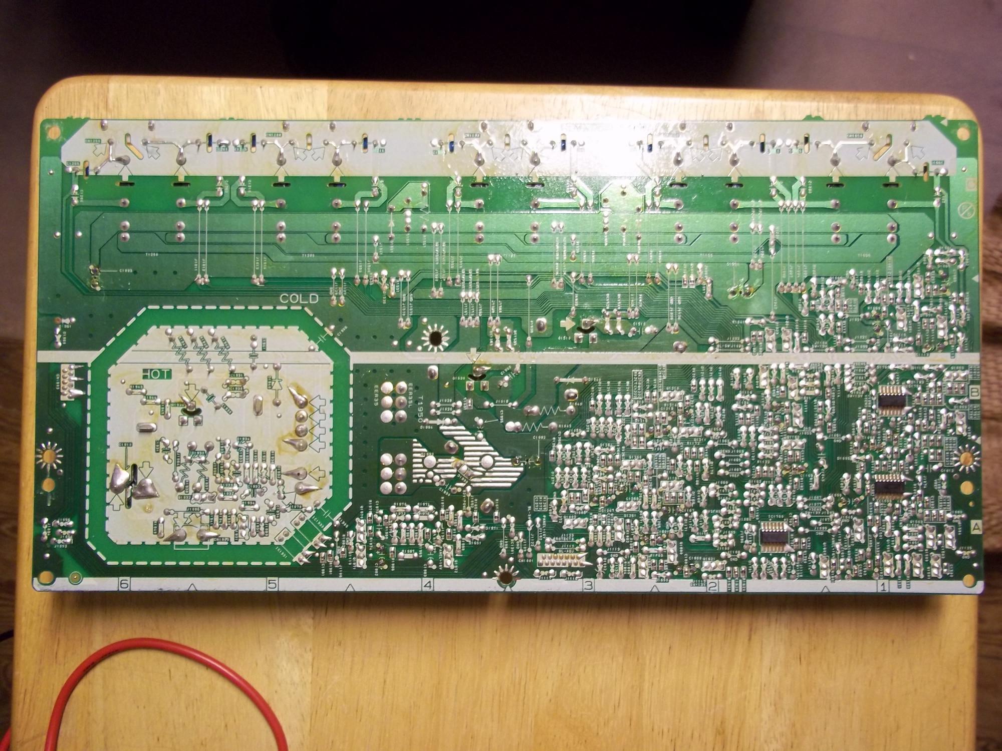

    I got a Phillips 32" in for repair today.
    Phillips 32PFL3504D/F7
    The tv turns on, shows the pretty "Phillips" logo then goes dead completely including the power light on the bottom. But you can restart it. I think the inverter is ok since the screen was alot brighter then my 42".
    I open it up.
    This board plagued with Su'scon and Jamicon caps all over.
    Jamicon
    1x 16v 3300 uf SK 25x12.5x5
    1x 6.3v 2200 uf SK 20x10x5
    1x 35v 1000 uf SK 20x12.5x5
    2x 25v 1000 uf SK 20x10x2.5
    2x 6.3v 1000 uf SK 16x10x3.5
    1x 25v 470 uf SK 12.5x10x3.5
    1x 50v 220 uf SK 12.5x10x3.5
    1x 25v 220 uf SK 12.5x8x2.5 pinched for 3.5 hole
    1x 25v 100 uf SK 10x6.5x 2.5 pinched to 3.5 hole
    small ones
    2x 10v 220 uf SK 5x12.5x2.5
    3x 50v 22uf SK 5x12.5x2.5
    5x 50v 10uf SK 5x12.5x2.5
    1x 50v 3.3 uf SK 5x12.5x2.5
    2x 50v 2.2uf SK 5x12.5x2.5
    Su'scon
    1x 10v 2200 uf SL 20x10x5
    3x 16v 100 uf SL 12x6x2.5
    1x 10v 100uf SL 5x12.5x2.5
    1x 25v 47 uf SL 5x12.5x2.5
    4x 50v 1 uf SL 5x12.5x2.5
    The problem is there are so many small ones and only few big ones.
    I don't have an ESR or capacitance tester so... I should probably invest in one soon.
    Anyways?
    Should I replace all of them?

    This is one of those Philips "creations" that mixes both power supply and inputs on one board. Ugh!
    Anyway, the first logical step would be to check for a supply voltage coming out of that power supply.

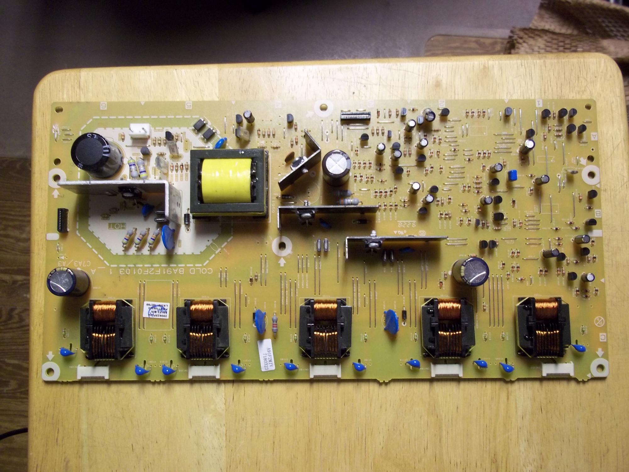

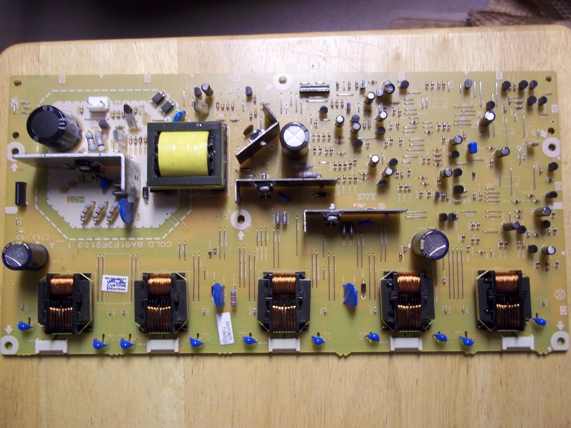

        Pictures of inverter board...
        Two shots, so if you can't see it try the other one.
        Also I hear a squelching sound coming around T1950 when being discharged *IE unplugged.* I have not tested this one.
        Any help is appreciated.

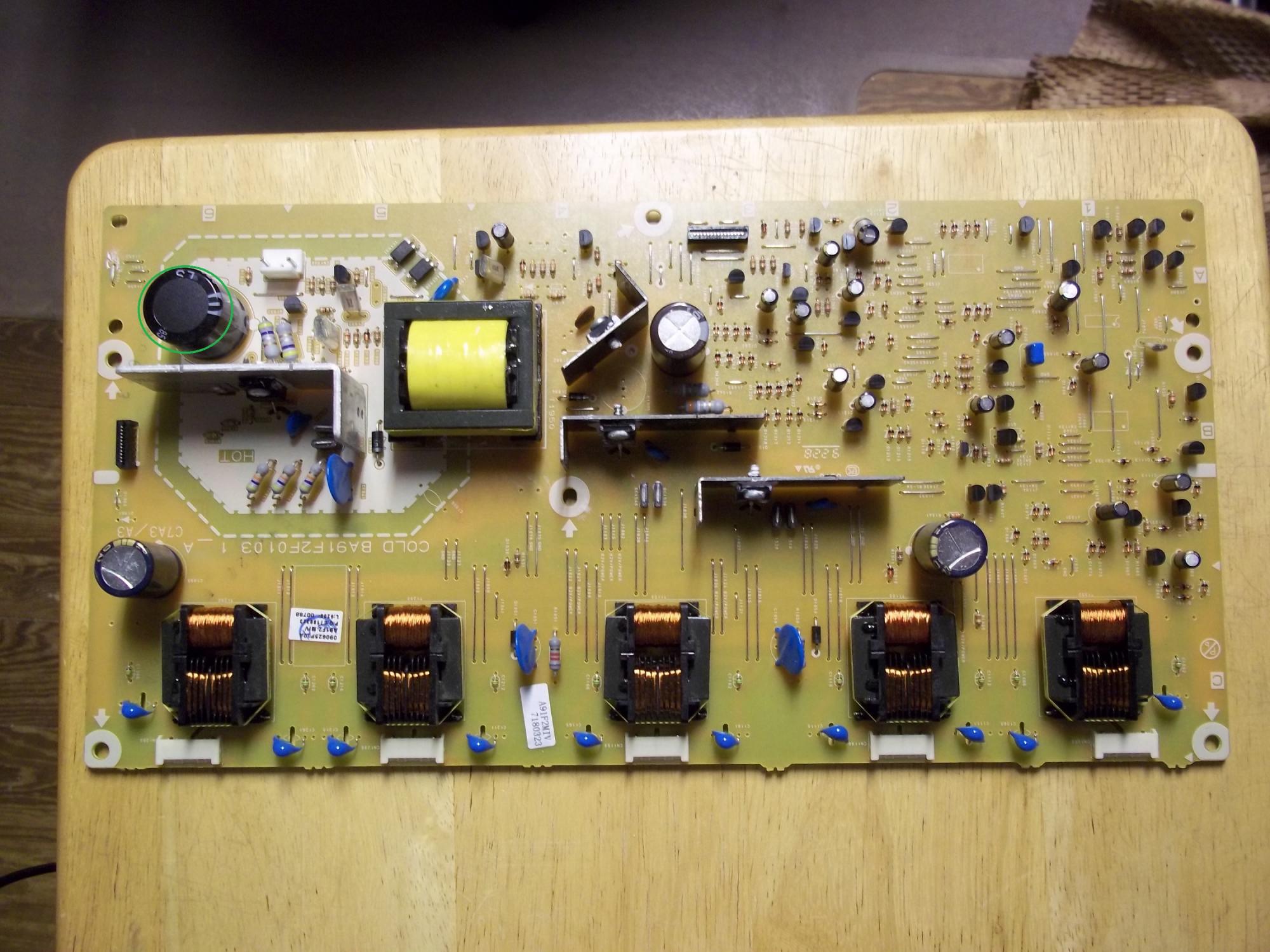

                    Re: Phillips 32PFL3504D/F7 LCD
                    So I work up the nerve to do the freeze spray and did it several times, but no components transistors are heating up fast enough to make a difference.
                    I didn't do the big ones attached to heatsinks though.
                    I'm hearing a squelch in the area circled red when the set is unplugged. I used the paper tube trick to narrow it down but I can't determine the point of origin.
                    Also I was thinking maybe that large cap circled in green on the inverter is bad. It's a HEC 270 uF 200 WV <--- whatever that means, 85*C.
                    Other markings NEG, LS, C/X22.
                    Any other ideas?

                      The MOSFET's for the inverter transformers are on the heatsinks to the right of the pictures. Did you check all 4 of those MOSFET's on the heat sink?

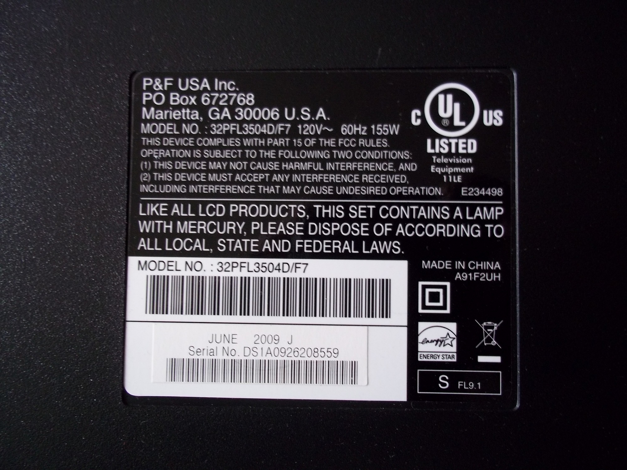

                      What is the chassis number of this TV?

                          chassis number? you mean the model? 32PFL3504D/F7

                            On the back of the TV where they put the model number, there will be "Chassis xxx.xxx.xxx" on that same tag. See picture, then you will go to www.elektrotanya.com using that chassis number to get the service manuals if they have them.

                              On the inverter board what voltage do you get across the big Panasonic caps you have replaced?
                              The squelch probably comes from the yellow transformer. Since it's a cheap-o self-resonant two transistor converter anything could happen when the supply voltage drops out.
                                There doesn't appear to be one. Picture below.

                                  The two dark blue and gold caps with the "T" shaped vent are Panasonic capacitors.
                                    Those are indeed pannys 220uF 100V FC caps they replaced su'scon SL.
