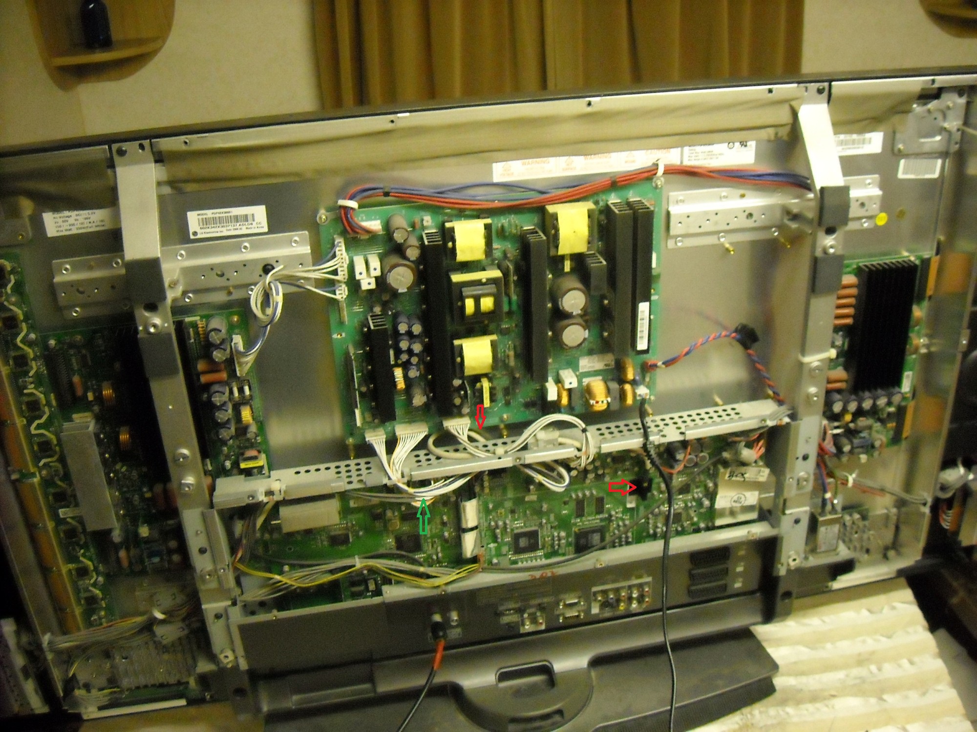

          Thanks tom66, all ok it seems. However am having trouble remembering where one of the cables goes. There are two cables that look like they are shielded data cables, one goes from the logic board to the very left hand side (marked in green) The other one marked in red, I cant find where it plugs in, one end goes on the logic board, the other - I cant remember! I stripped this set down in early 2012 so cant recall was it even plugged into anything.
          The photo attached is the original I took in Jan. 2012 with arrows pointing to where the cables are. It appears like the cable goes under the logic board, however I can't find a socket for it anywhere!
          Anyone got one of these models or an idea where this second cable goes to?
          Tried it without the cable plugged in and am not getting a picture, so am not sure if its because of the cable or something else. (the screen is black but illuminated as if there is just no video signal to it)

            Re: LG 42PX5D-EB dead
            Hi again!
            Finally got more time to look at this, turns out the cable plugs in underneath the lower PCB on another board.

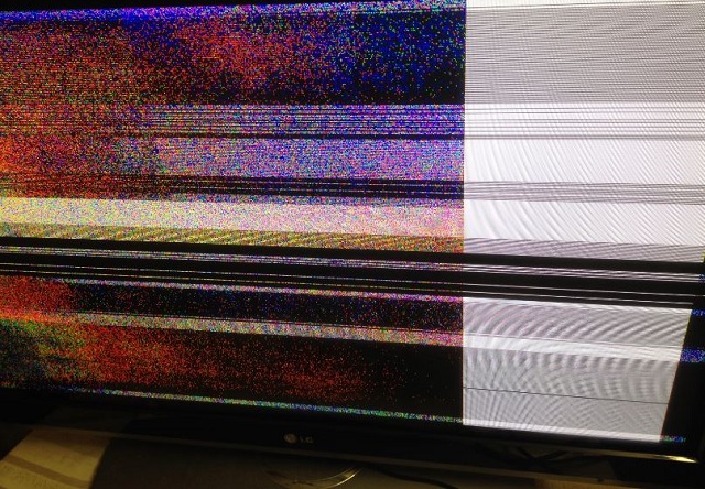

            I have just sourced a buffer board and replaced it due to the original getting a bit hot. Now I have nothing but sparklies.
            Is this a board problem or do I need to adjust the tv to suit the new buffer board? (pic was perfect on old board, just a couple of the chips were getting hotter than the others)
              Spent another evening at the LG last night, removed the board and re-seated the ribbons. Didn't make any difference.
              Will try swapping the buffer board back to the old one.
              /jim
                Swapped back to old buffer board and picture returned. Assume this was a faulty item(thankfully the ebayer refunded me)
                Will try to find another.
                  One of the MOSFETS on the buffer-board is short-circuit I expect....
