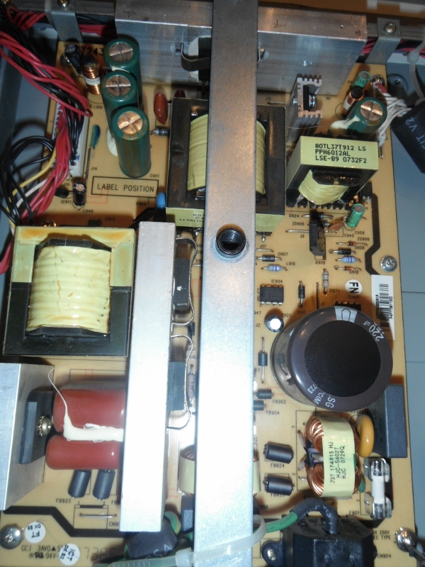

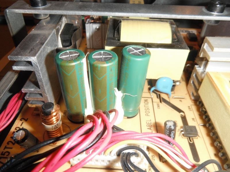

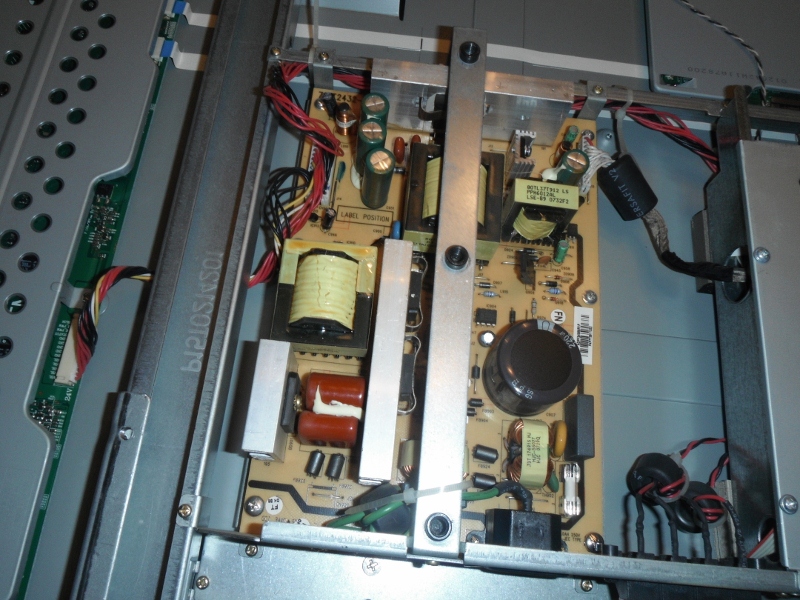

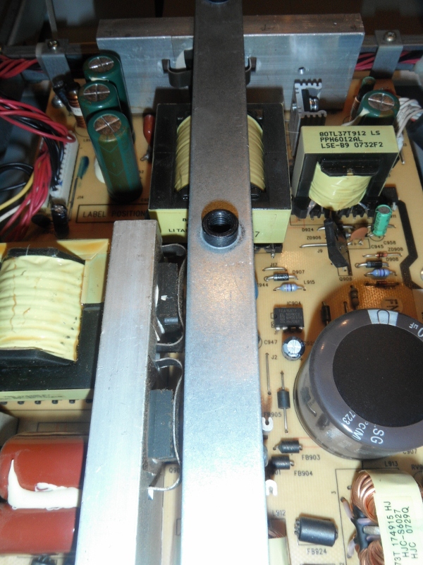

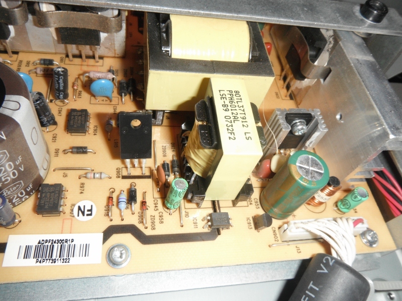

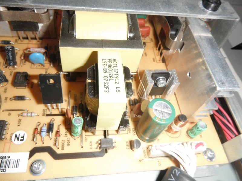

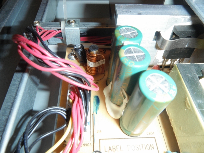

    I Came across this website today when I began searching for recall info for my 42" Philips Flat Screen. The problem started a month ago. The t.v. just goes black, but I still have sound. I can turn the tv off and then back on and it is fine, for a short time and then "poof" out it goes again.
    I have been reading all the posts from others about the same tv with the same problems. I have taken the tv off the wall, taken off the back, and taken pictures. I was disappointed to find that the caps were not bloated, but from what I read they could still be bad, right?
    Can anyone help me/ direct me to where to order the caps? I have never done any soldering, but otherwise am fairly handy for a woman....=) I'm sure I can do this with a little guidance and maybe some words of wisdom from you guys.
    The info on the 3 caps on the left is as follows:
    capXon 1500uF35v
    The info for the other cap on the right is:
    capXon 2200uF16v
    P727
    Vent
    I'm uploading pics for your inspection and eagerly await your replies. Thanks in advance for the help.
    I've tried several times to upload my pics but for some reason it won't let me. Yes, they are the correct size, and I even tried to zip them just to be sure. I will try to post the pics again tomorrow.

      • PoteauPets
        • Jan 2012
        • 65
        Re: Philips 42PFL5432D/37
        Resized the pics again. I have more if needed. Thanks..=)

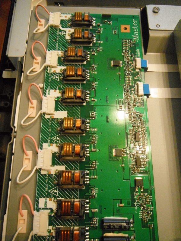

            1) To the left off your board board, there is a green board. It is probably the inverter board. We will need a picture of it.
            2) We prefer pictures in this composition (top down)
            https://www.badcaps.net/forum/showpo...94&postcount=1

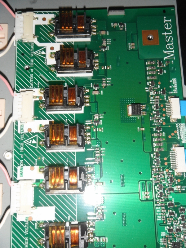

            • PoteauPets
              • Jan 2012
              • 65

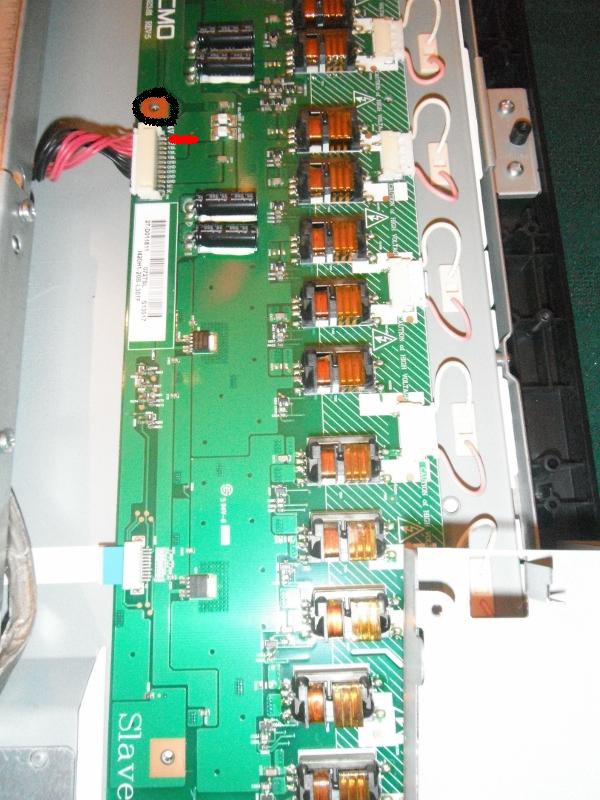

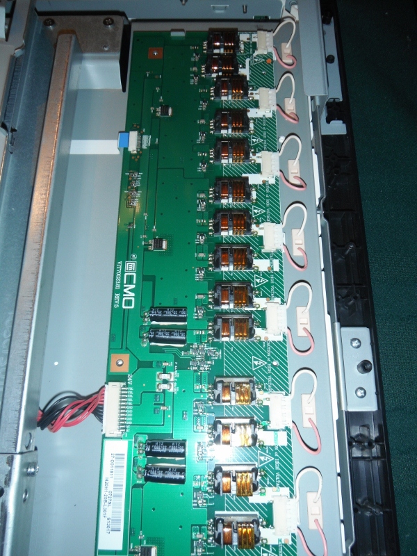

              No, I don't have a multi-meter. Here are the pictures of the inverter board. As far as I can see, everything appears to be okay.
                1) That picture says "Master" which implies a "slave" probably on the other side. We will need a picture of that too.
                2) It looks like the capacitors on the bottom of the Master board are Rubycon. They are good caps so they are unlikely to be the problem.
                3) See if you can borrow a multimeter from someone. Without one, troubleshooting will be very limited.

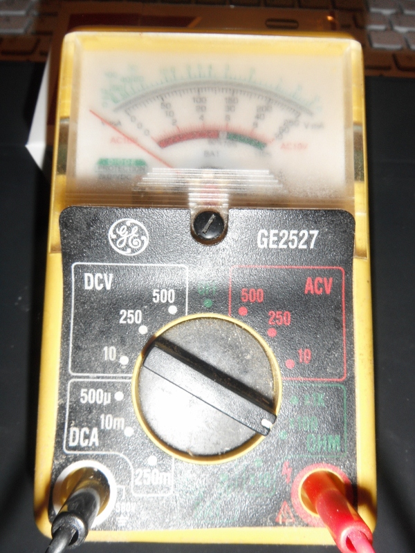

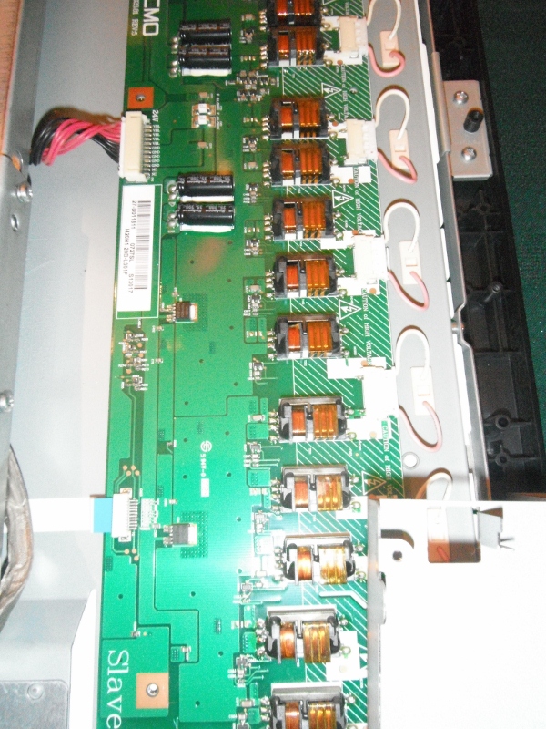

                  Thanks for helping........=) Here are the pics of the "slave" side. Looks okay to the untrained eye.
                  I do have a tester, although I have no idea how to use it.......
                    Post a picture of your multimeter. We can walk you through it.

                    • PoteauPets
                      • Jan 2012
                      • 65
                      Here it is...........

                            1) Let's make sure your analog multimeter is working and calibrated. Take a fresh AA battery. A fresh one should measure above 1.5 V and close to 1.6 V DC.
                            2) Set your multimeter to the 10 DCV setting.
                            3) Put your red probe on the positive end of the AA battery and the black to the negative. Your needle should swing and it should read around 1.5 V. As you can see from this simple test, you won't get too much resolution. On a digital multimeter, it might read something like 1.534 V.
                            Assuming the above tests fine you can now measure the TV voltage.
                            1) First safety. The power board can carry voltages as high as 330 V DC. Avoid touching the power supply including the heat sinks. The heat sinks are likely "live".
                            2) You will need to run the TV with the cover off.
                            3) Power on your TV.
                            4) Set your multimeter to the 250 DCV setting. Don't worry, we are NOT measuring 250 V. Since the master and slave boards are clearly marked 24 V, we cannot leave the multimeter setting on 10 V and thus must use the next highest range.
                            5) On the diagram below, put your red probe on one of the red pins (marked with red "paint" line). It doesn't matter which one. Just be sure to touch only one pin otherwise you could create a short and cause more damage to the TV (which might be big $$$).
                            6) Put your black probe on the ground screw (circled in black). This is your ground.
                            7) The multimeter should read around 24 V DC when the screen is on.
                            8) When the screen goes off, leave the TV on, and re-measure those same two points. If it is still 24 V DC, then the power board is likely good. If it is not 24 V DC, report the reading.

                            • PoteauPets
                              • Jan 2012
                              • 65
                              Okay, did the battery test as instructed, reading was perfect.
                              Now on to the next step. Will report back shortly.
                              Thanks again Mr. RetiredCaps.............=)
