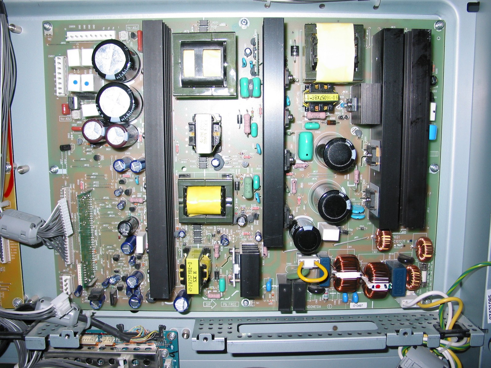

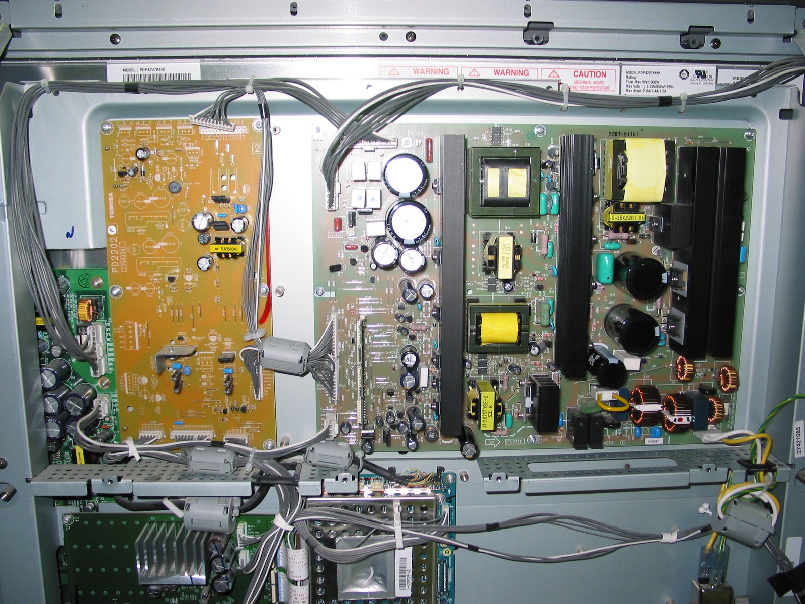

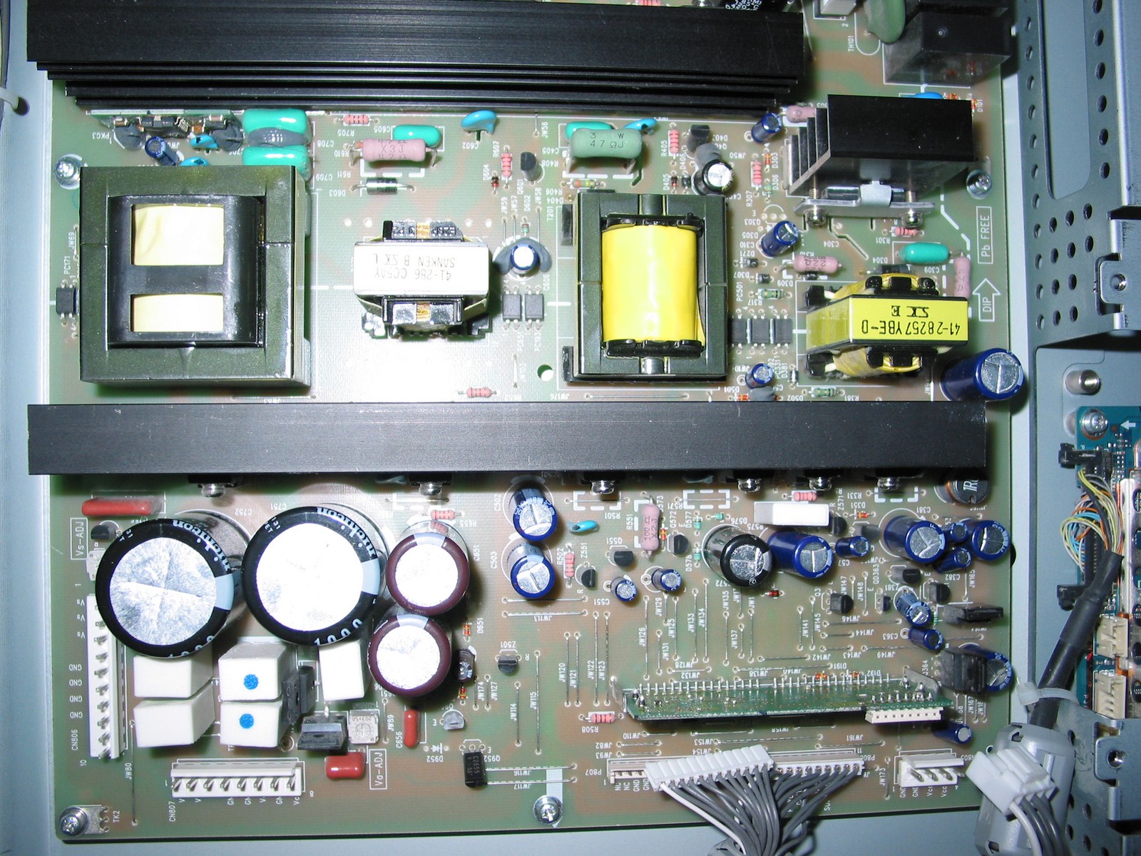

    And on to business, I have a Toshiba 42DPC85 plasma with a chassis TAC 515 that does not power on. Front panel led blinks and the relays cycle a few times.
    Replaced the capacitors (some had the usual bulging) and still nothing. I get no VSS power off the power supply. Found the service manual online (couple of different sources) but it does not seems to have the power supply diagram in the ones I found.

      This is a Sanken power supply so you will not be able to find a schematic. Check Z401, Z601 for shorts or low resistance readings and check the surrounding resistors and make sure the values are consistant with what they read on a meter. You will have to remove them from the board to get a true reading.

            ok, here is what I found:
            Z401 and Z601 are good
            surrounding resistors are good
            Ok, now the unit does seem to power on, I do get Vss for a brief moment but then the power supply shuts down - obviously detecting a fault someplace.
            Any other suggestions?

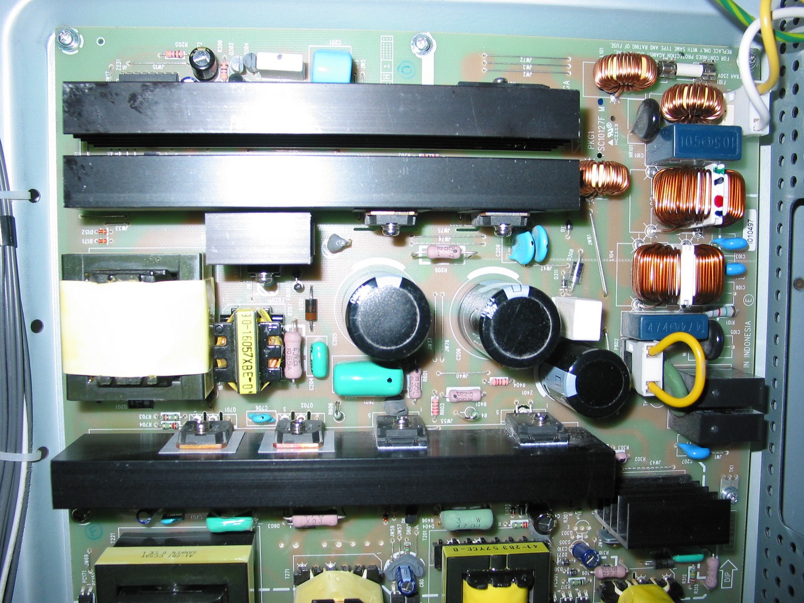

                    Ok, read through the info and that brings up another question, relating to the above posted capacitor 250uf 450v, the Capxon chart, doesn't go up to 450v. These 2 capacitors had an obvious bulge to them before they were changed - now it is quite possible that the ESR rating is higher that what was there originally, so now what? Do I just find a cap with a low ESR rating and install that, like this one: http://search.digikey.com/ca/en/prod...2793-ND/758005
                    edit - on a side note, I can heard a very high pitch 'buzz' (for lack of a better term) after the unit has gone into shut down protection - but I can't really seem to isolate the area, but if I had to guess, I would say it is in the Z401/Z601 area (basically the same area where the budged caps were).

                        ok, an update. Installed the recommended caps and still no joy, however the power supply relays are acting a bit differently, they turn on and then after some time 1 turns off. If I unplug the top connector on the board to the left of the power supply, the power supply will remain turned on. Toshiba calls this board a LOWB and that connector is just +24v and ground.
                        So it would seem to me that the supply is ok and there is an issue someplace else causing the shut down, this is where I currently stand...
