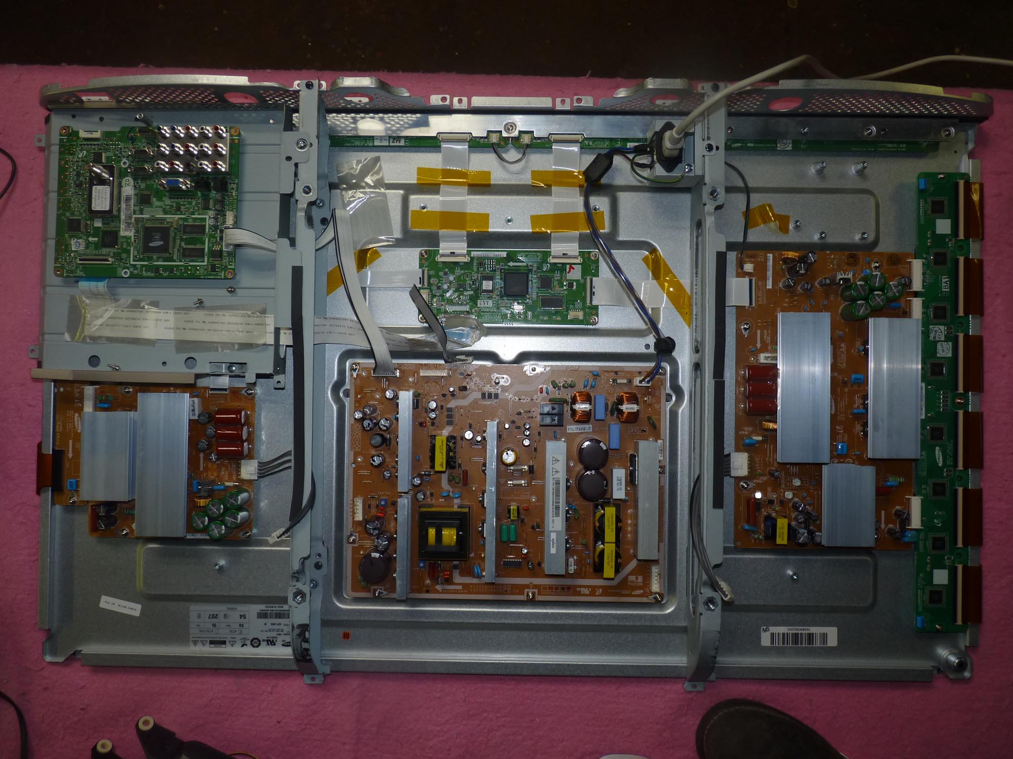

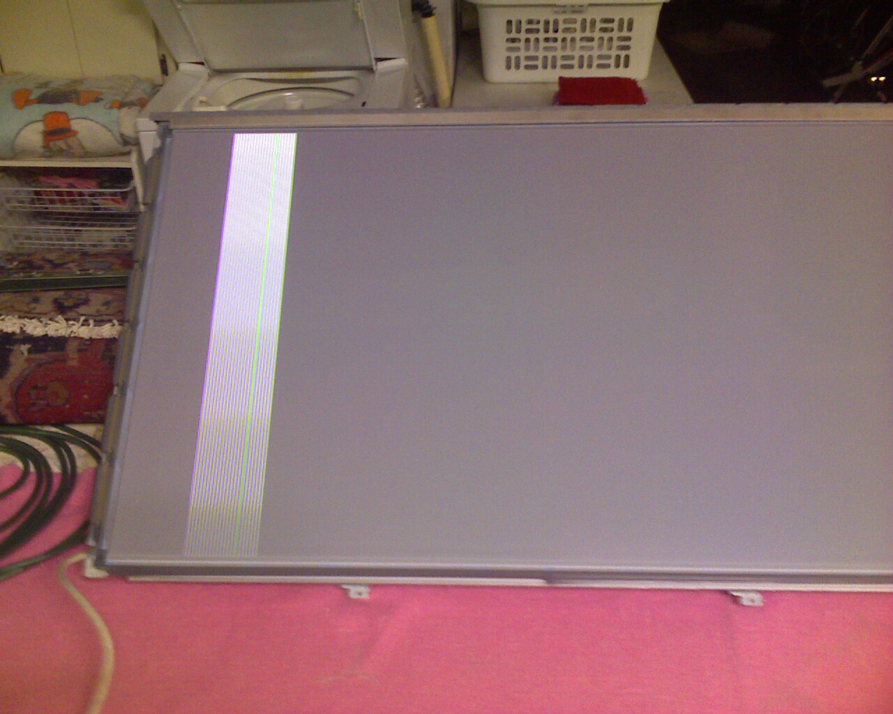

    It comes on for just over a second and the relay cuts off power (Still have 5v on standby pin). For that 1 second the screen looks off (see screenshot)
    Unplugging the power cable to all of the boards has no effect except when unplugging the board with a/v inputs (main board) in which case it does not turn on at all.
    It appears there is an overload somewhere. The cable from the central board to the board with the a/v inputs (main board) was damaged when I got the unit so some of the pins might have shorted. I have repaired the cable but this has not resolved the issue. It might be that there was originally 1 thing wrong with the tv (off picture) but while messing around someone damaged the aforementioned cable and caused the 2nd problem (power overload).
    Would anyone be able to instruct me how to diagnose for sure which components need replacing?

    Looks like a power connector isn't plugged in.
    Failing that... unplug X-main, does problem remain? Then plug X-main back in and unplug Y-main? Does problem remain?
      Re: Samsung 42" plasma fault
      Thanks for the reply. I have tried unplugging each board. both x & y mains as well and the problem remains. the only change is when I unplug the main board and then nothing happens. I just hate to pay for a main board and have that not be the problem or not be the only problem. That is why I wanted to be sure.

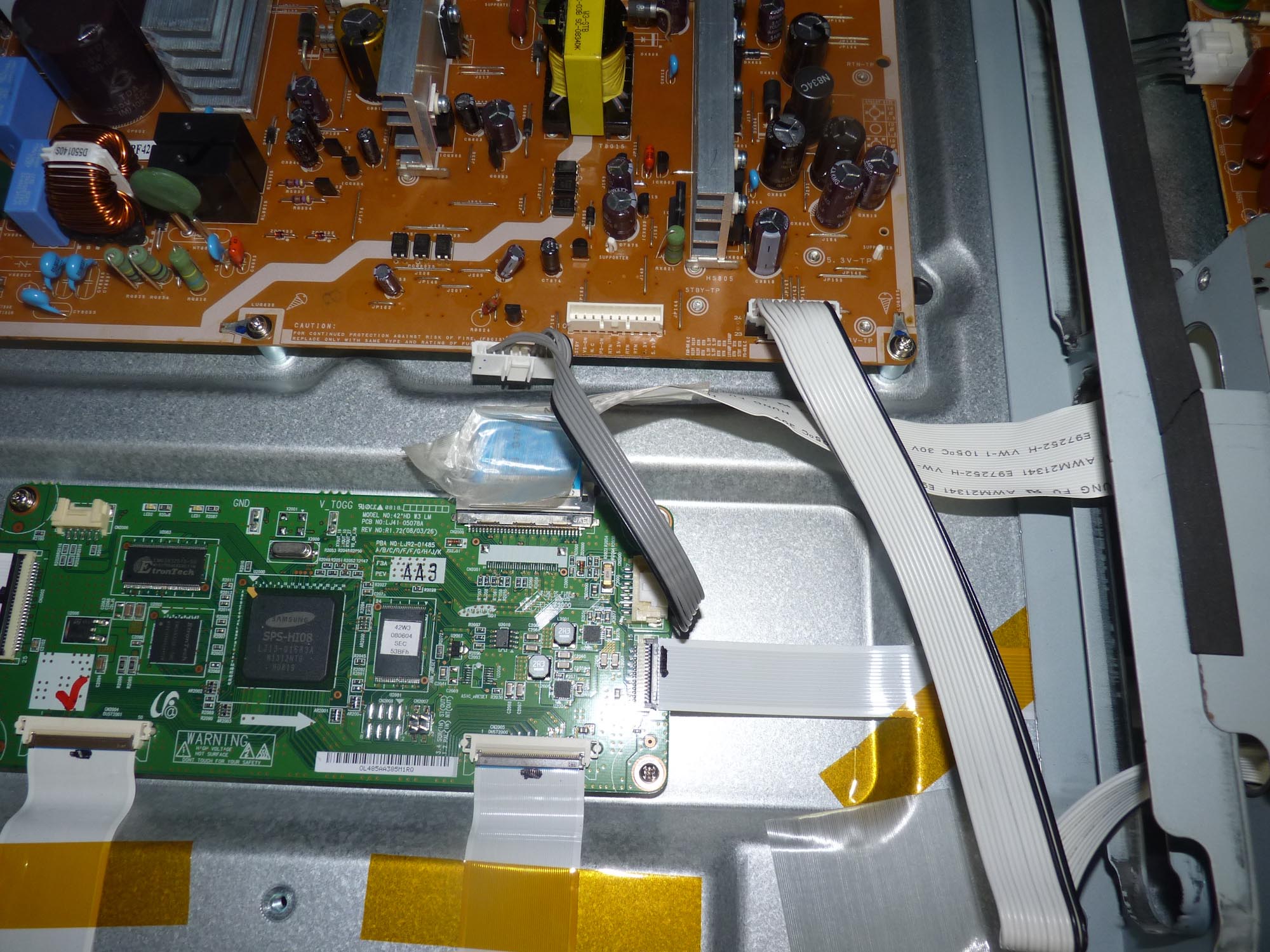

        Can you post a close up picture of the power connector going from the power supply to the logic card?

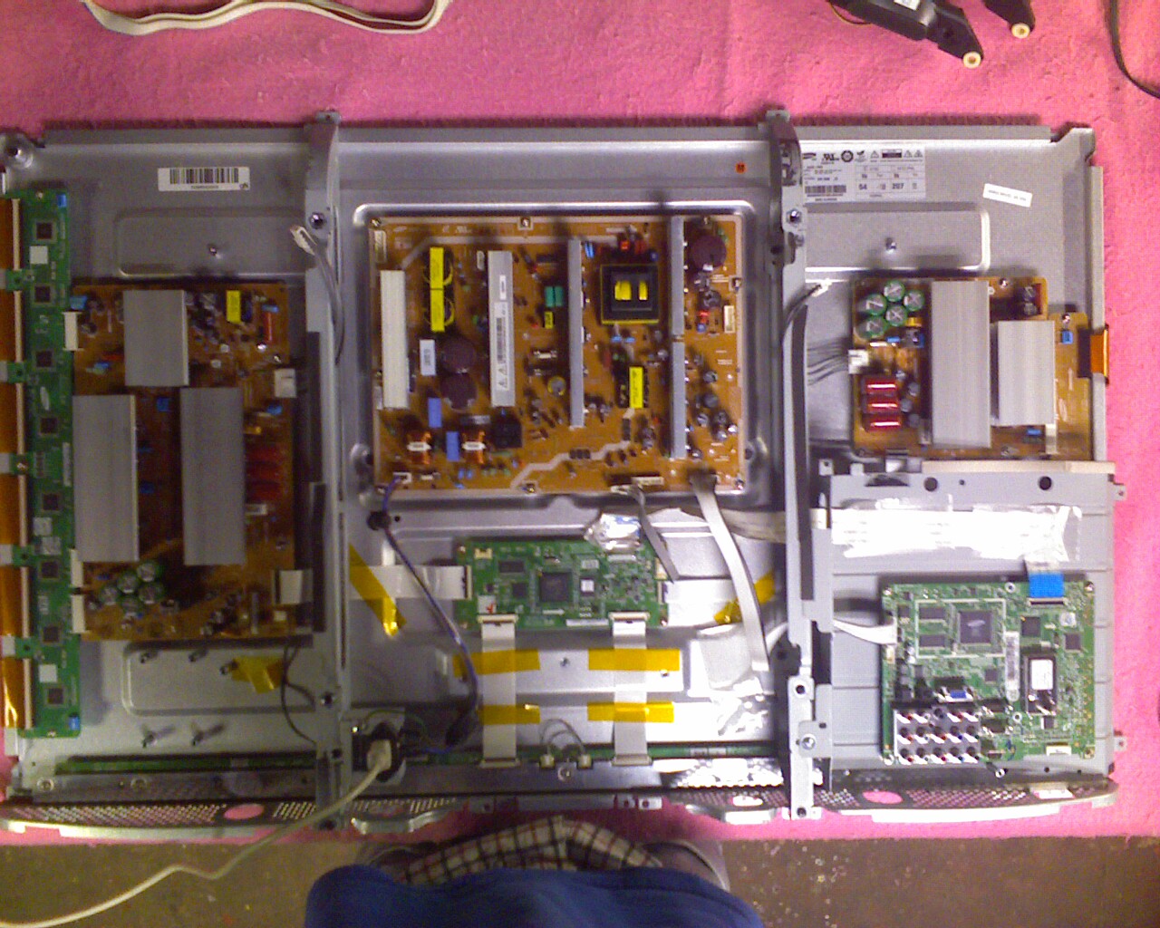

          Thanks for the response. I have attached a better picture of the connector to the main logic board from the power supply as well as a clearer picture of the overall system with enough res to zoom in. I have tried starting the system with virtually every combination of power cables plugged in/unplugged with no change - system clicks off after 1 second unless the main board is unplugged in which case nothing.

            Can you post a clearer picture so I can read the legends on those connectors?
              my camera will not focus closer. no macro mode on my camera for taking close up shots. The codes on the connectors are as follows from left to right:
              stby,vs-on,n c,ps-on,rtn,5. 3v, rtn, rtn,5.3v,5.3v
              all "5.3v" pins have 5v for the 1 second but then 0 after the relay clicks off. "Stby" has 5v throughout. However ps-on has 0v with relay closed and then 3.3 when it clicks open. This is with the connector unplugged as pictured meaning that something on the main board is causing the relay to open as it is the only board plugged in to the power supply board - see picture.

                              Miscommunication. The second picture in your first post shows an over-all view of the TV. A cable runs from a connector in the lower right corner of the power supply to the main board. Frequently the manufacturer will identify the function of each pin of that connector. That information is very useful when troubleshooting.
                              PlainBill
                                Thank you for clearing that up. The pins are as follows:
                                Fan On (0V)- NC
                                D13v(.3v) - D13v(.3v)
                                D13v(.3v) - RTN
                                RTN - RTN
                                5.3 (0v) - 5.3 (0v)
                                5.3 (0v) - 5.3 (0v)
                                RTN - RTN
                                RTN - RTN
                                13 VAMP (.3V) - 13 VAMP (.3V)
                                RTN - RTN
                                STDBY (5V) - RTN
                                PSON (4.1V) - NC
