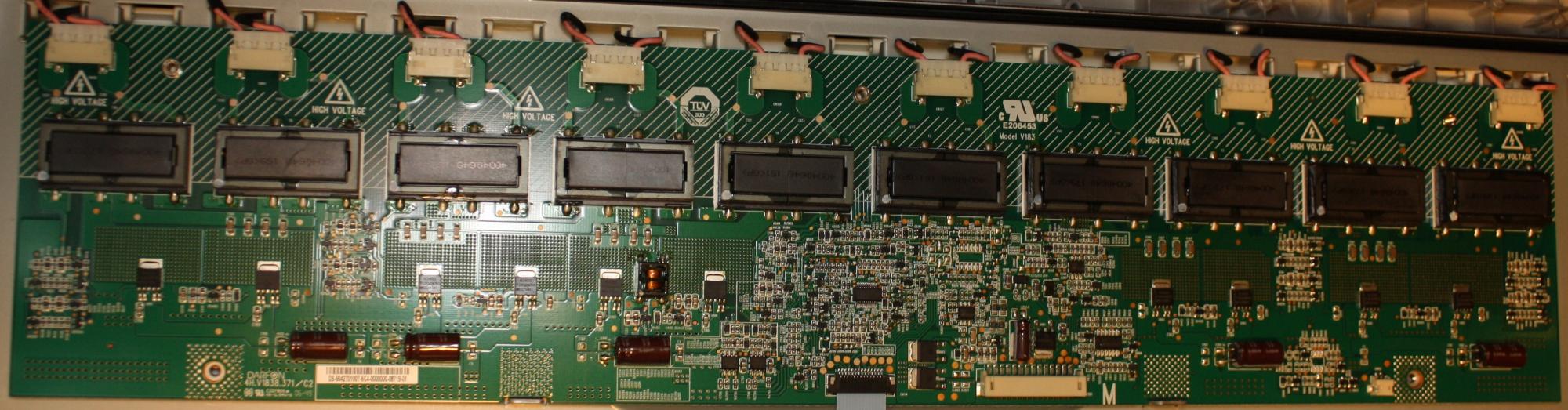

        Re: Magnavox 42mf531d/37 trouble.
        Is the back of the TV lit up white?
        Post a picture of the inverter, it's usually on the left or right hand side of the TV. Sometimes there are two.
        • Sean9275
          • Dec 2011
          • 6

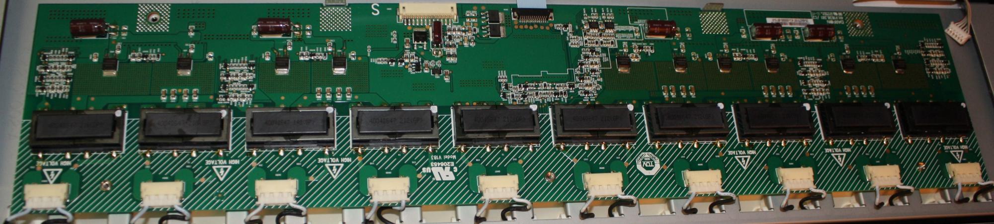

          The back of the tv is not lit up. Here is a photo of each of the inverters.
            Ah! Darfon inverters. Often fail, dead easy to repair . Repaired two previously. Usually one of the transformers fails open circuit.
            While the TV is off completely (unplugged) use your multimeter to measure the resistance between each of the two pins I have highlighted for every transformer on both the master and slave boards. Use the 20k range.
            All but one will measure nearly the same value. The one which measures significantly different (often open circuit or "1 ." has failed. Note these values down and post here.
            A new transformer is about $10 and it would be rare for more than one to have failed. Report back the part # on the transformer (looks like 4004?) so we can help you locate a good part.
            Removing the original transformer requires a bit of soldering experience to do it properly (for example, using wick) but I've done it before by just heating up each pad and using the soldering iron to pull each pin off the board... worked for me... Putting a new one on is much easier.
            You could also of course go for the approach of getting a new inverter but that often costs a lot more than a transformer.

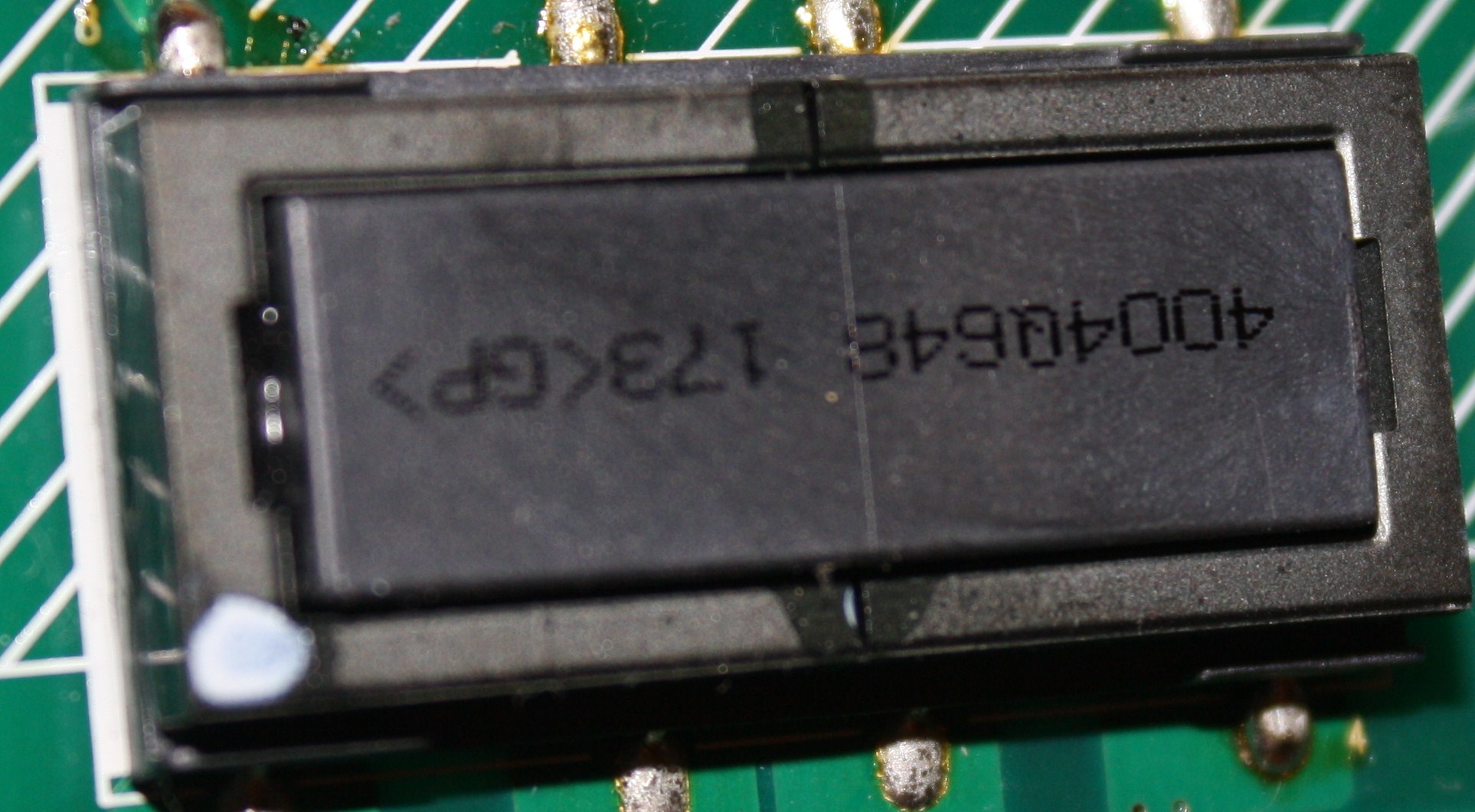

              Starting from the bottom of each board:
              RH LFT
              1) 4.16 11) 4.14
              2) 4.12 12) 4.16
              3) 4.11 13) 4.13
              4) 4.11 14) 4.12
              5) 4.12 15) 4.13
              6) 4.08 16) 4.12
              7) 4.11 17) 4.13
              8) 4.09 18) 4.12
              9) 4.11 19) 4.15
              10) OL 20) 4.10
              The part number on #10 reads 4004Q648 139<GP>.
              The picture is of #1 for reference.

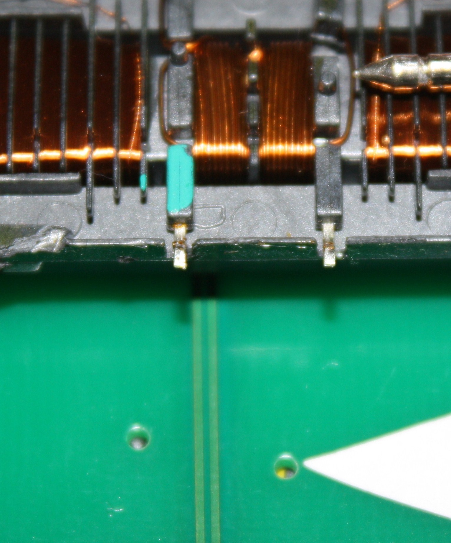

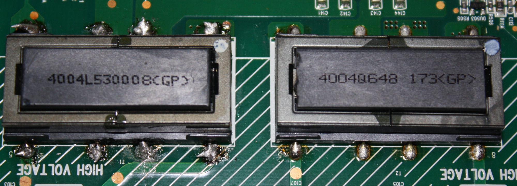

                              I've replaced the defective 4004Q648 139<GP> transformer with the ebay 4004L530008(GP) transformer. The tv still goes to black after a second, however the faint flicker before it turns black is gone.
                              My soldering gun may have been overkill for this job. Consequently, during the removal process, the small pad under pin 7 was liberated from the board. I did retrive it from molten solder, but was unable to attach it back to the board. Then I lost the little thing as I proceeded downhill at an increasing rate. I could see no visible circuit underlying pin 7 in that location or any of the adjacent transformers. Also it appears pin 6 has no circuit associated with it. Thinking I had nothing to loose, I proceeded to solder the replacement transformer in place and build up some solder on pin 7 and hoped for the best. Reassemble tv, fail. Moving right along, I tested the replacement transformer as well as several others (both the defective one and a couple good ones still on the board).
                              DMM set to 20k ohms
                              Column 1 Terminals
                              Column 2 Replacement: 4004530008(GP)
                              Column 3 Other one in picture: 4004Q648 173<GP>
                              Column 4 Defective 4004Q648 139<GP>
                              8-5 4.29 4.10 O.L.
                              1-8 1.47 1.35 O.L.
                              4-5 1.48 1.36 1.35
                              1-5 2.82 2.72 O.L.
                              4-8 2.82 2.71 O.L.
                              2-7 0.01 O.L. O.L.
                              3-6 0.01 O.L. O.L.
                              One other difference between the replacement transformer and the replaced is the plastic alignment nubs on the underside. I used the soldering gun to melt the one that was preventing flush mounting. In retrospect, was this the first clue of something wrong?
                              What is the next step?
                              Thanks for all the help so far.
