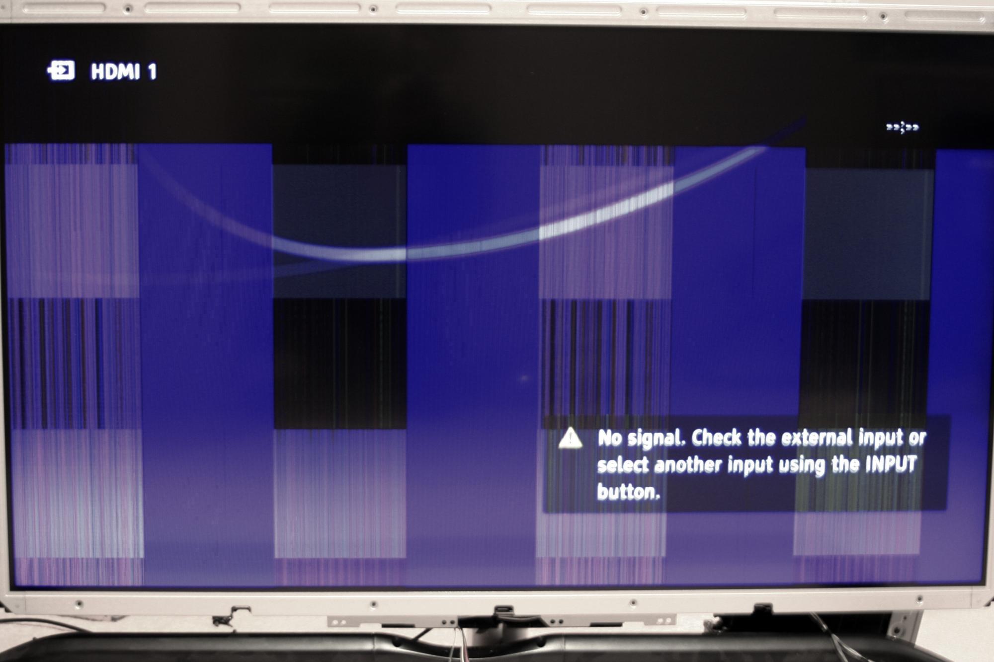

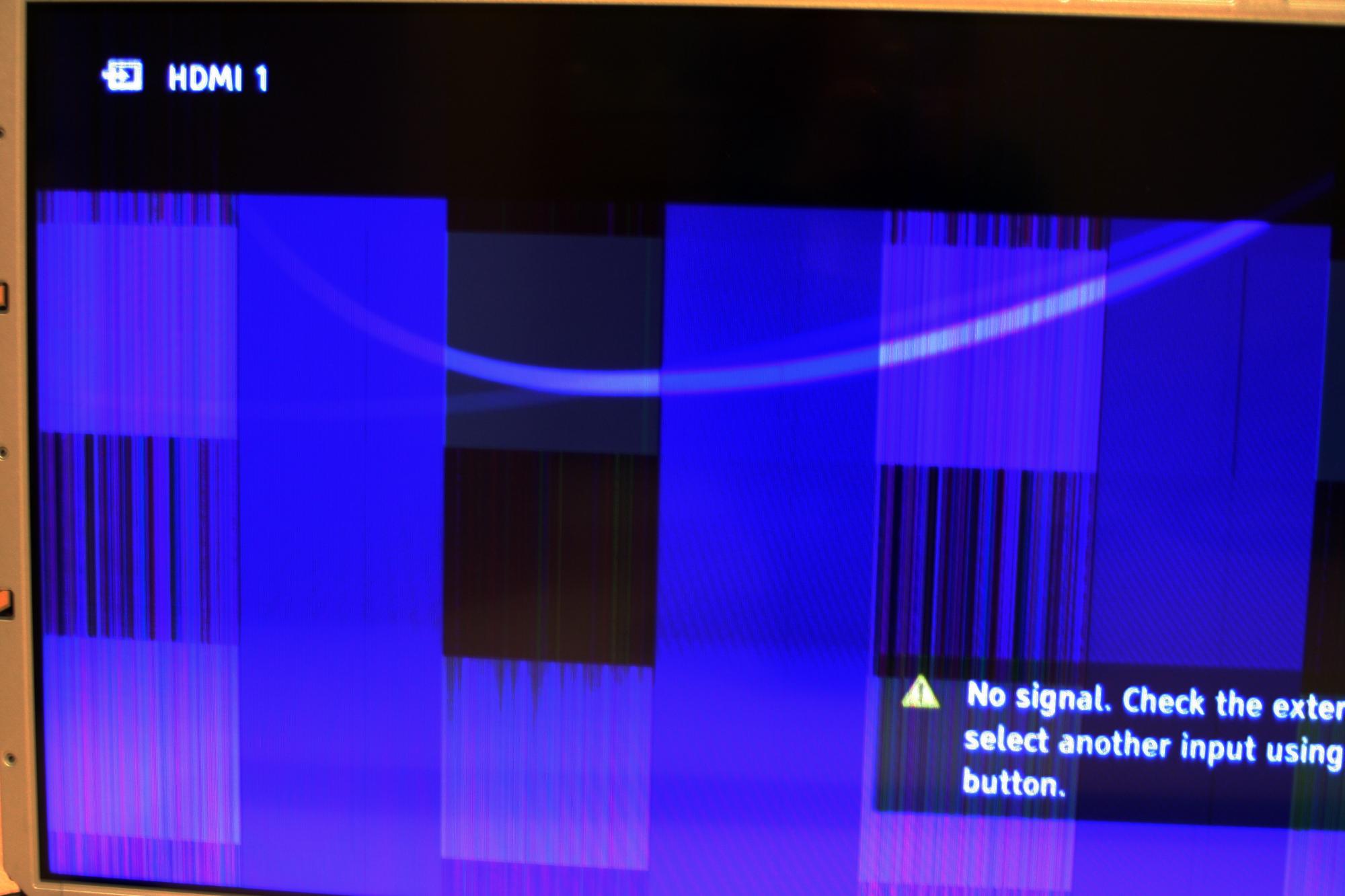

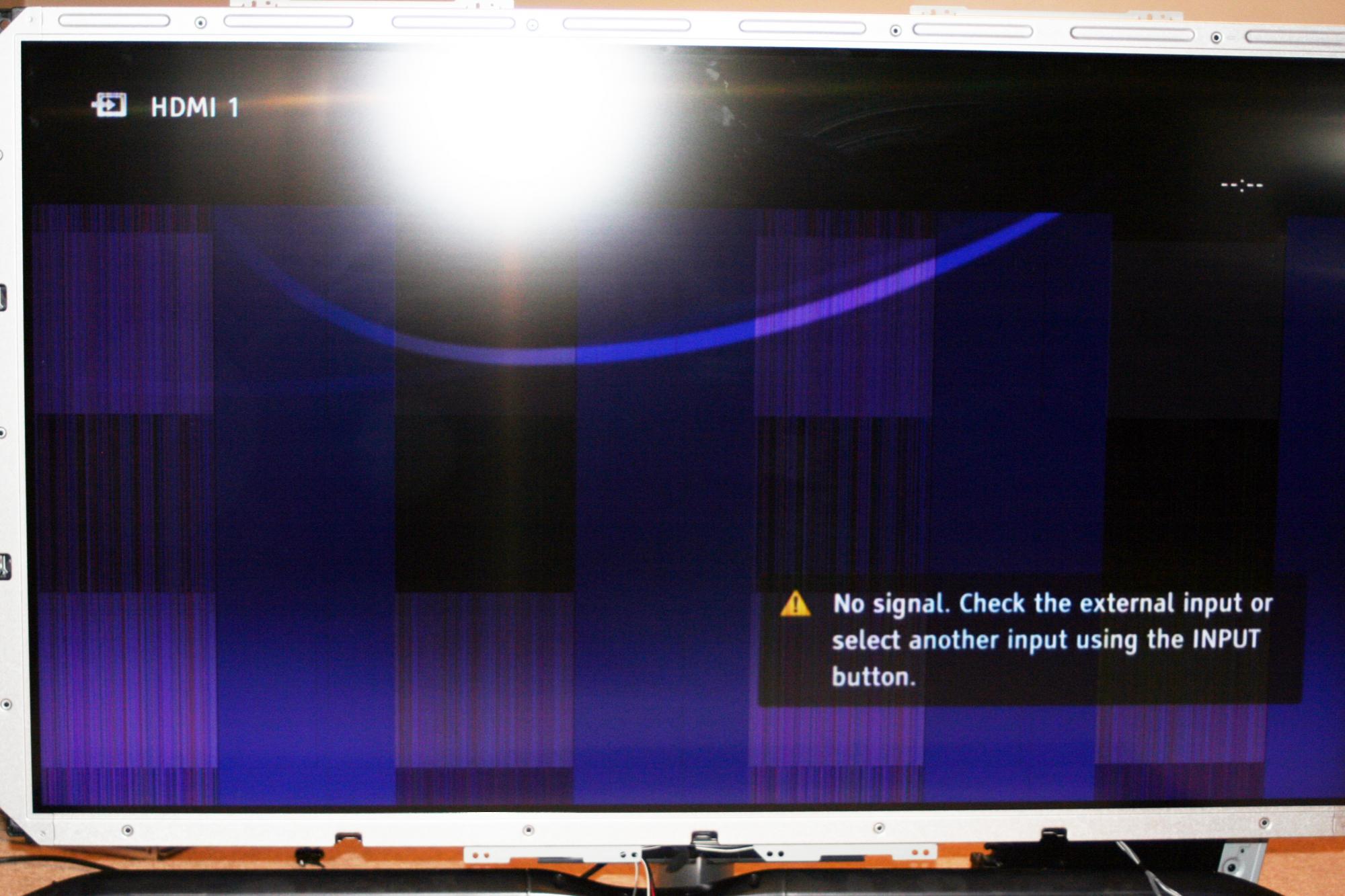

    I have a Sony KDL XBR6 that has lines in 6" wide sections. I tried heating up the plastic stripes on the panel, improved a little. Attached are some pictures of what it looks like now. When it first powers up the whole left side is all lines and then you can slowly see them fad away to what the pictures are. The menu does look to be clear. The built in sample photos that are loaded on the tv look like the screen in the picture. Some are clear and some show the lines. All inputs do the same thing. Twisting or moving screen around does not change (like some other post suggested) Do you think this is a T-con board or the main board issue or both? Any help will be appreciated.

    If the OSD (i.e. menus) is clear it is almost certainly the main board; the main board is the only part that can distinguish between source video and OSD graphics, the panel and T-con just display what the main board tells them to. However, the symptoms look a lot like a bad panel. Can you try getting up a menu that covers most of the screen; do the glitches affect the menus?

      You can see the lines thru the menu more so when it is white, colored lettering doesn't seem to show the lines as bad, you have to look close to see them. So it sounds like the panel is bad? Is there a way to check the main board?

        Try my suggestion of getting a menu which covers the whole screen (or a good amount) to come up. It doesn't look like a panel problem. Looks like maybe a damaged RAM chip. (Not easy to repair, but the main board can be replaced.)

            Well, I got the new board today and installed it. Same problem as before. All lines on left side and after a few minutes it looks just like the pictures in original
            post. Could it be T-con board or is the panel itself bad?

              It could still be the T-con, but a bad panel might be able to cause the same symptoms. Did you see if a menu had the same problem?
                Re: Sony KDL XBR6, rows of lines
                The menu looks be clear, I don't have anything on the menu that fills a lot of the screen. But what I can see seems to be clear. I had the tv on and I took off one ribbon at a time off the T-con board, there are four ribbons that go to the panel, when I take the outside ones off the screen turns white about 1/4 of the way in on each side and don't see the square pattern. Then I took off one of the inside ribbons and half the panel was white without square looking pattern. So I am thinking it might be the T-con board.

                  The T-con is the only board left which could easily cause these symptoms. I don't think the panel is bad but wouldn't guarantee it.
