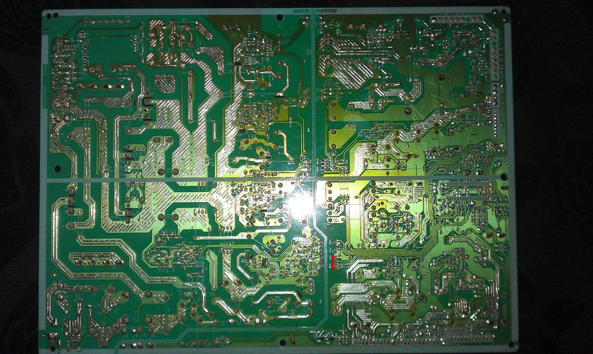

                        Re: LG 42PC1D plasma - clicking repeatedly
                        Please don't post pictures inline.
                        First check if AC detect switches off or is unstable. It should be a fixed 5V.
                        I think it is these two optocouplers but just to be sure they are the only two on the board facing the other way around. Bridge the pins on the secondary side using some solder.
                        This will disable AC detect so you may get a popping sound when the TV is unplugged while running but that will not happen if it is switched to standby or unplugged in standby.
                          It was the two above the red markings, in case someone else is trying this out. Worked great for me. Thanks a million.
                            #33
                            Great to hear! Sorry I got them wrong but you figured it out in the end. Clearly, it seems to be a common problem .
