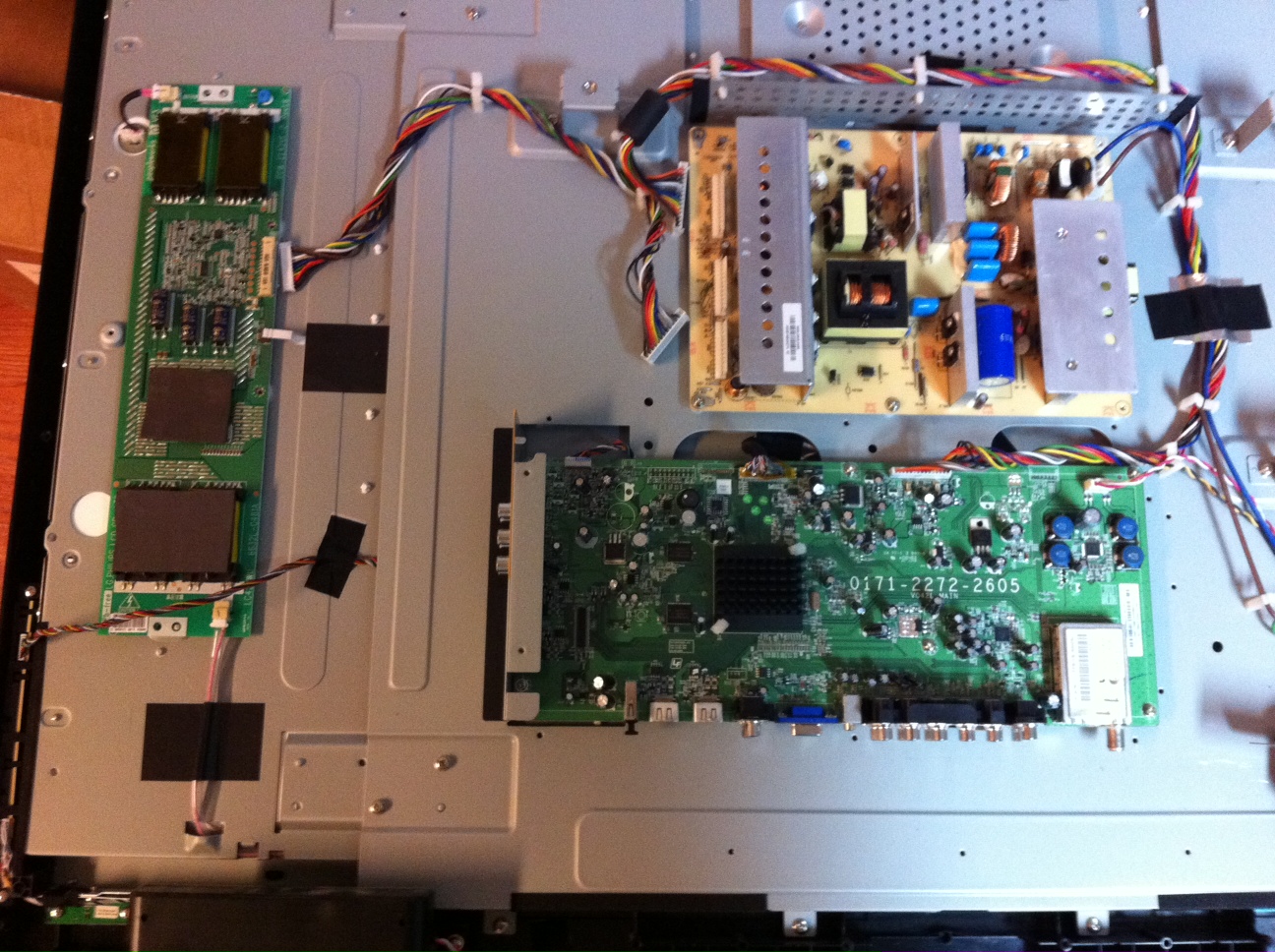

    Vizio VO42L will not come on
    The Vizio emblem is in orange, and turns white when I hit the power button.
    On the power supply I have observed that +5VSB is at 5V, PSON is at 0V, and stays there when I hit the power button, A1 is 3.3V when "on", B1 is 5V when "on", otherwise A1 and B1 are 0V. Does that mean the problem is with the main board?
    I unplugged the inverter board which had no effect.
    What do I need to do to start troubleshooting the main board (assuming that's what the above symptoms point to)?

    Re: Vizio VO42L will not come on

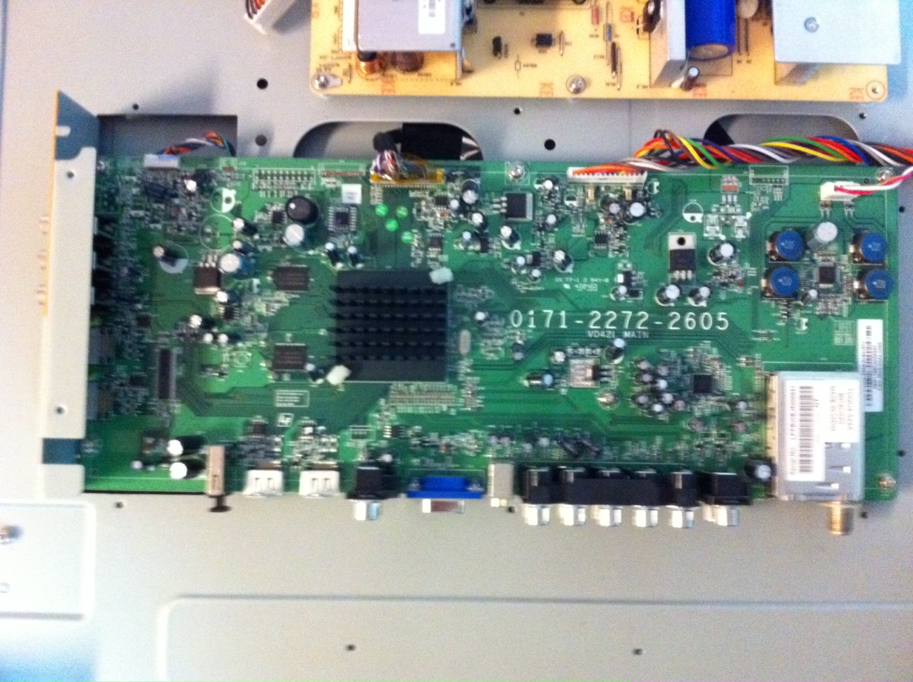

    Little more info... Please let me know if anything else would be helpful... I was going to post better pics once the board problem is a bit more clear.
    After reading through all the Vizio posts I saw a lot of references to U33/AMC1117. U33 is an 8 pin chip on my main board so I dismissed that.
    F1 and F2 on the main board checked out fine.
    TV screen stays completely black when I turn the tv on.
    Caps all looked good.
    Here is a picture of the overall back of the tv:
        Do you get any backlights at all?
        If no - Check with a flashlight to see if there is a picture in the background.
        If yes - Check all of the 1117 LDO's on the mainboard and post the voltages.
        Just some basics to get started. There is lots more that you could check and not really what I would check first but... I'm going to bed now. rush rush

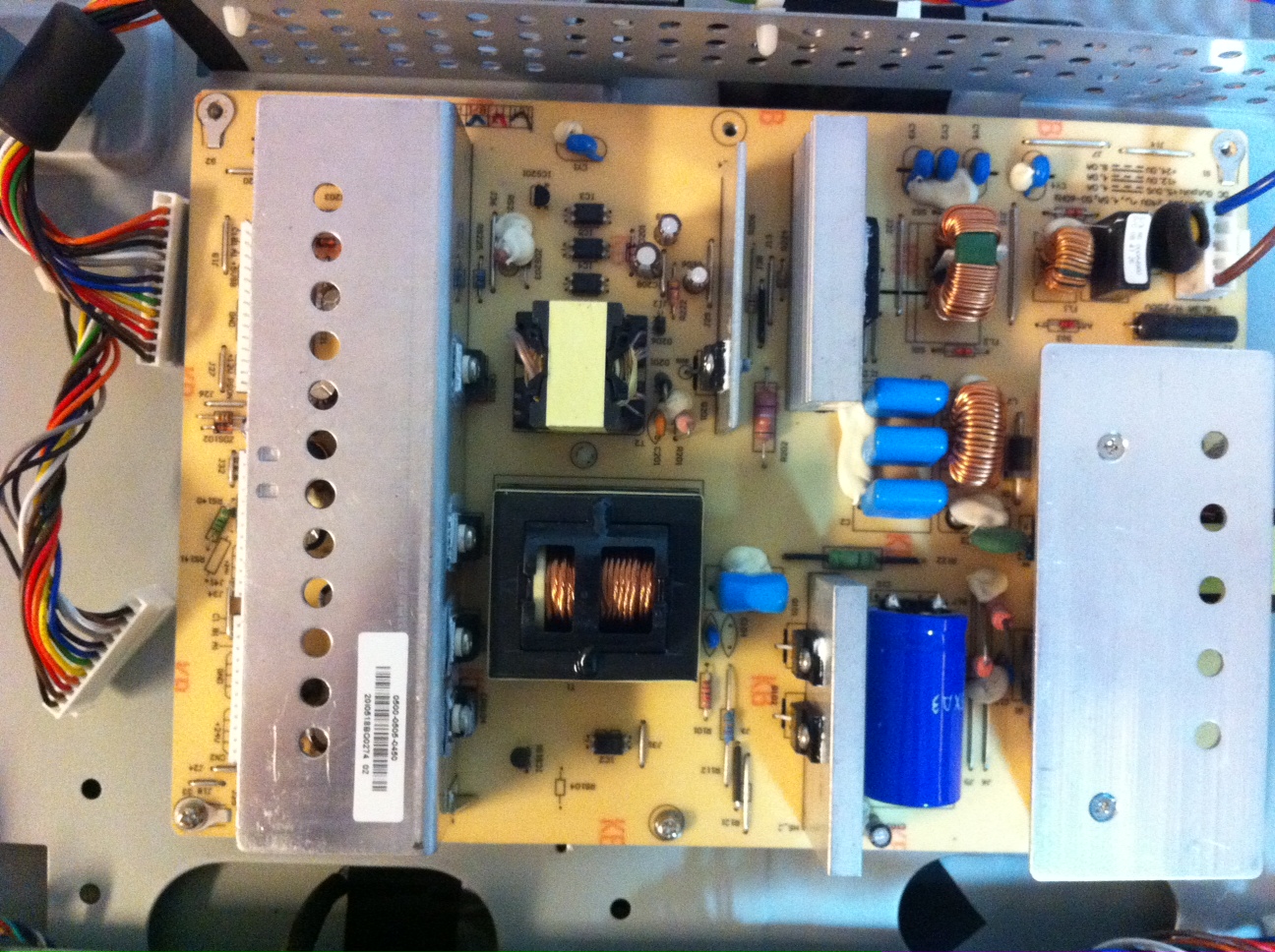

          I've been avoiding this type of thread lately. My excuse is I've been busy with outdoor projects now that it's finally cool enough to work outside. But that is just an excuse.
          Based on the information you gave, the problem is the main board. And there is the problem. A quick look at the main board shows it to be a typical design with a Standby and Main supply, and a PFC front end. However, there have been a few instances where the labels on a power supply connector ware misleading. In other words, is PSON the control input to the power supply?
          A successful repair of a main board is possible, but it is often very difficult to troubleshoot. About the best we can do is check the LDO regulators.
          I was reluctant to make suggestions because I'm forced to rely on the information you gave. The pictures don't show the legend on the power supply output connector, and the picture of the main board isn't clear enough to identify possible LDO regulators. So why should I bother?
            I see no backlights. Even with a flashlight I don't see anything.
            I can't seem to get pictures that are clear enough to read the writing... Will try more tonight. Here is the voltages on the LDO's when the tv is "on" (Vizio emblem turned white). 2 of them don't have input voltage so they obviously aren't regulating but the others seem fine...
            LDO's:
            U19 G1117 (pin 1 gnd, pin 2 VO, pin 3 VI)
            2 - 1.24
            3 - 3.85
            U21 G1117 (pin 1 gnd, pin 2 VO, pin 3 VI)
            2 - 1.24
            3 - 2.5
            U44 G9117 (pin 1 gnd, pin 2 VO, pin 3 VI)
            2 - 0
            3 - 0
            U22 G1117 (pin 1 gnd, pin 2 VO, pin 3 VI)
            2 - 1.24
            3 - 3.08
            U17 G1117 (pin 1 gnd, pin 2 VO, pin 3 VI)
            2 - 1.24
            3 - 3.06
            U16 G1117 (pin 1 VI, pin 2 gnd, pin 3 V0)
            1 - 0
            3 - 0
            U21 1084 (pin 1 gnd, pin 2 VO, pin 3 VI)
            2 - 1.25
            3 - 3.03
            U20 1084 (pin 1 gnd, pin 2 VO, pin 3 VI)
            2 - 1.25
            3 - 2.75
            Here are the power supply connector pinouts:
            Main board cable:
            C1 - not connected
            B1 - 5V when tv on, 0V when tv off
            A1 - 3.1V when tv on, 0V when tv off
            +5VSB - always 5V
            GND - duh :-)
            12V - always 0V
            PSON - always 0V
            Inverter board:
            C1 - not connected
            GND - duh :-)
            24V - always 0V

              Huge thanks to you dgtech and plainbill.
              I wound up buying a new main board which fixed my issue.
