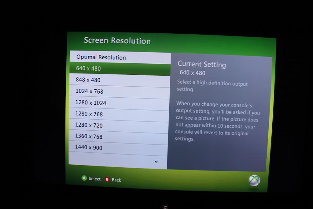

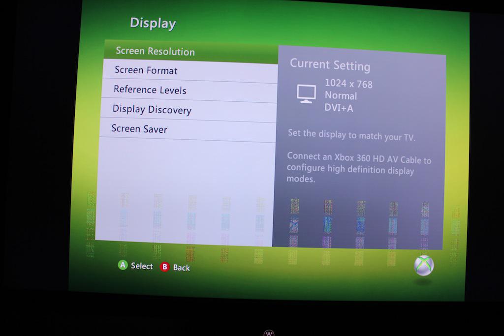

    Glad I stumbled upon this forum--looks like a lot of helpful folks here. I've got a Westinghouse LVM-42w2 TV (actually it's technically just a monitor as it lacks any kind of TV tuner) that in the last month has developed horizontal "stripes" (for lack of a better word) of pixels. I tried all the usual stuff of unplugging from power for a few hours, making sure it had adequate cooling, and resetting all settings to defaults with no change.

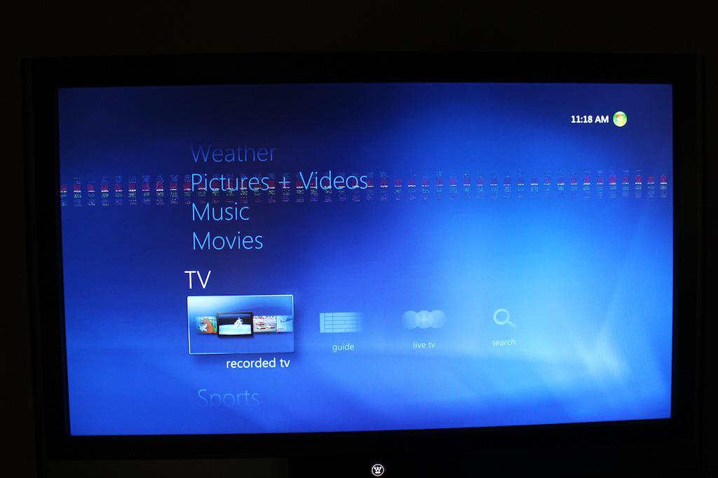

    So I went to work testing all the inputs and resolutions. The first thing I determined is that they are not "stuck" pixels on the panel. I was able to make the stripes go away by switching to 640x480 resolution, on any input. The pixels also also change color and "dance" around on the screen. On some of the lower resolutions like 1024x768 and 1280x720 the stripes are present, larger, and towards the lower half of the screen. On 1920x1080 (the panel's native resolution) the stripes are smaller and show up towards the top of the screen. The stripes show up no matter what input I am using--HDMI, VGA, component are the ones I've tried (so both digital and analog inputs).
    Otherwise the picture is stable. I've watched various things despite the line for a few hours at a time with no other apparent problems.

    I've attached some photos of the effect I'm seeing. Would love to be able to get this set running again since it's only about three years old.

    By your description this looks more like a scalar problem than a tcon problem. The scalar takes the input signal, scales it to fit the screen, then sends it to the LVDS cable to the tcon. The tcon translates the incoming LVDs signal into appropriate horizontal and vertical drive signals.

        The scalar is part of the main board. It may be a separate chip, but I'd expect the function has been integrated into the graphics processor by now.
        I'd say it's time to see if you can purchase a main board.

          I found a matching mainboard on ebay pulled from a set which had a cracked panel (advertised as tested working). It arrived today and I just finished installing it. Problem solved!
          Thanks to you PlainBill I didn't waste time and money trying to replace the T-Con board first.
