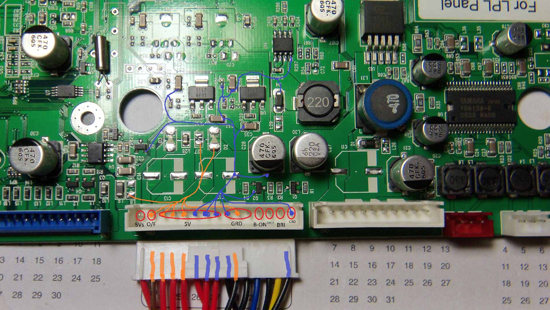

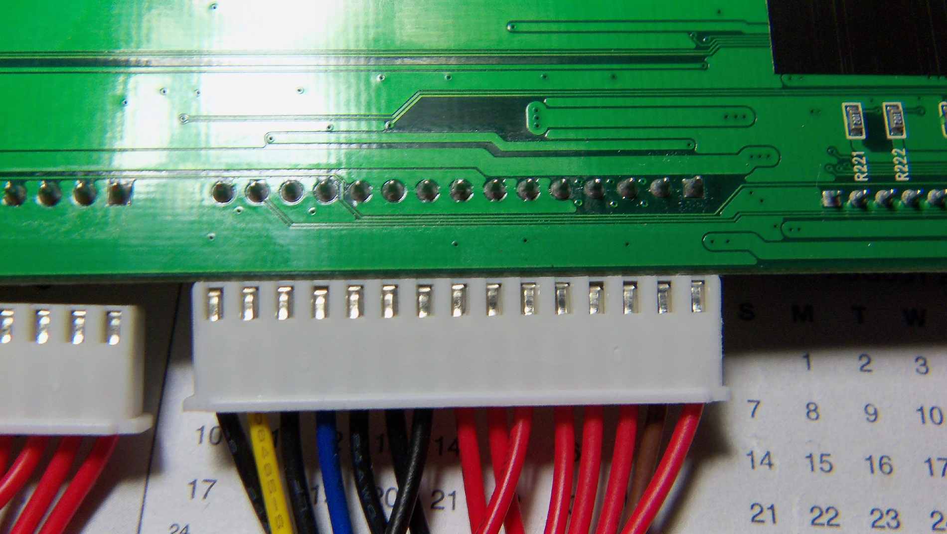

      Ok, I checked the lines, but I dont really know if Im looking for anything specific.
      I took and edited the picture of where the cable plugs in, I have both sides.
      I dont know if this is what you were asking, but here you go
      The O/F (brown) line is connected to some other lines on the connector. I made them orange in the picture (according to continuity)
      The blue lines are also connected together.
      I wasn't able to really find where the orange lines go on the circuit, they didn't show any obvious signs of connection anywhere in the proximity of the connector. though I did get the occasional split second beep from the continuity meter when checking along the whole board, but that only happened in maybe 3 or 4 places.
      The blue is also traced out, that one was much easier and it even goes on further than what I labeled.

        The two pins of interest are 5Vs and O/F. Just above the connector are two LDO regulators. The one on the right is U8; I don't see the identifier for the one on the left. The pins are numbered 1, 2, 3 from left to right. What are the voltages on each of those ICs? Those regulators provide the voltages for the standby processor, which turns on the main power supply. This may be a multilayer board, If so it will be a big problem tracing the O/F signal.
        PlainBill
        • Robbiebaby
          • Aug 2011
          • 31
          Re: Olevia 342-B11 No signs of power still.
          The pins in U8 measure:
          1. 1.265v
          2. 2.519v
          3. 5.06v
          The other one (U9) measures
          1. 2.085v
          2. 3.333v
          3. 5.06v
          Would you say this is a problem with the main board? or should I send the replacement PSU back? Or...We dont know yet? :-)
