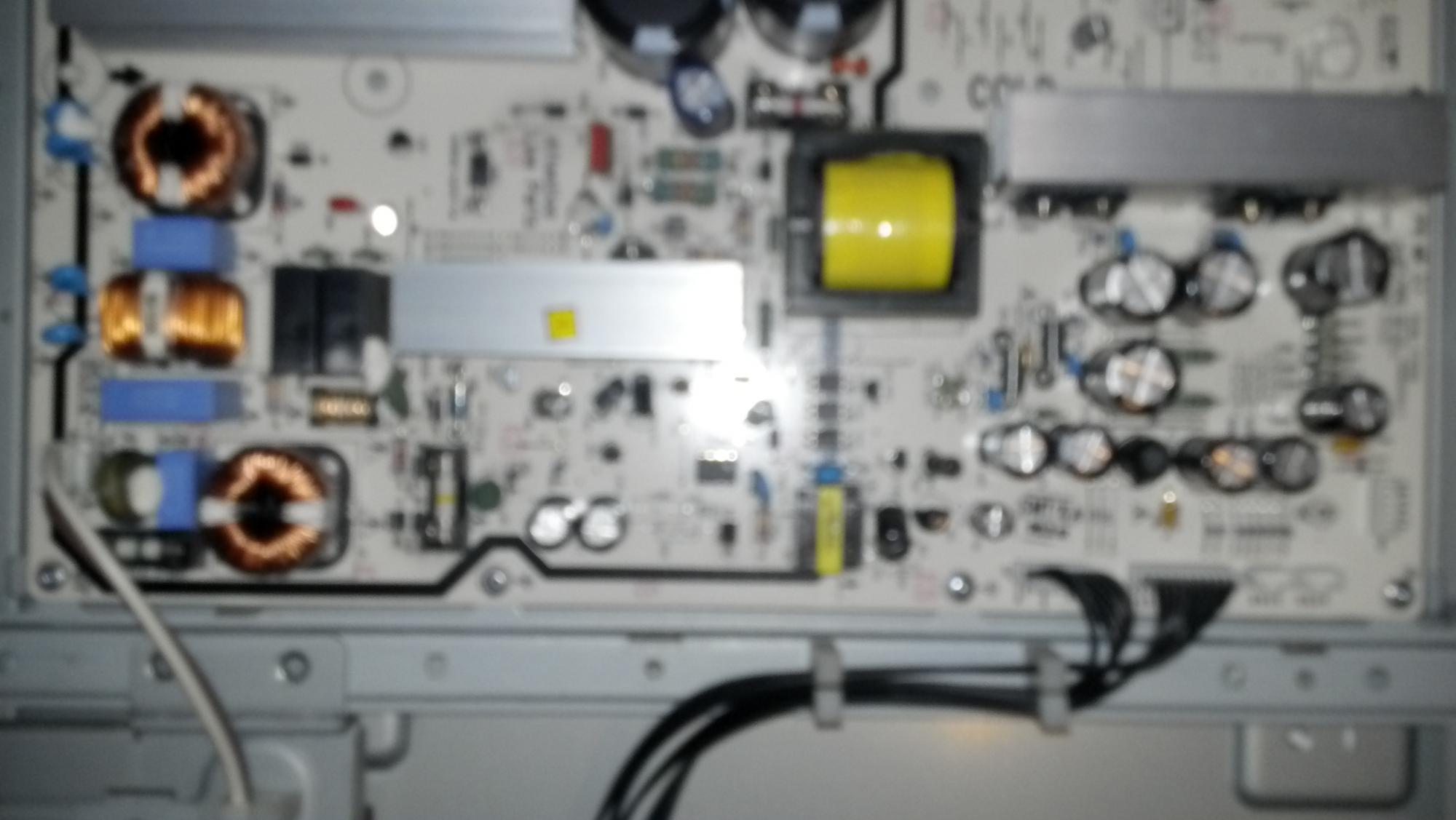

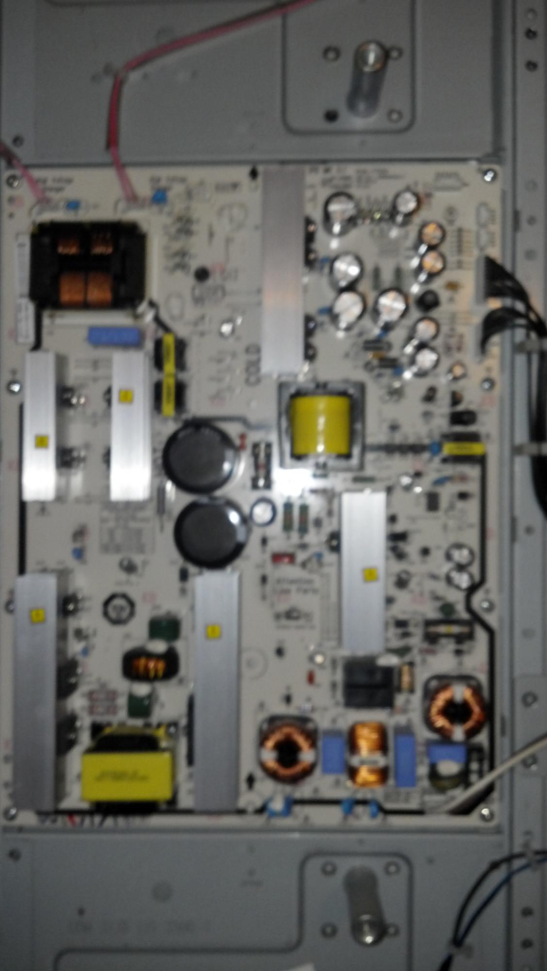

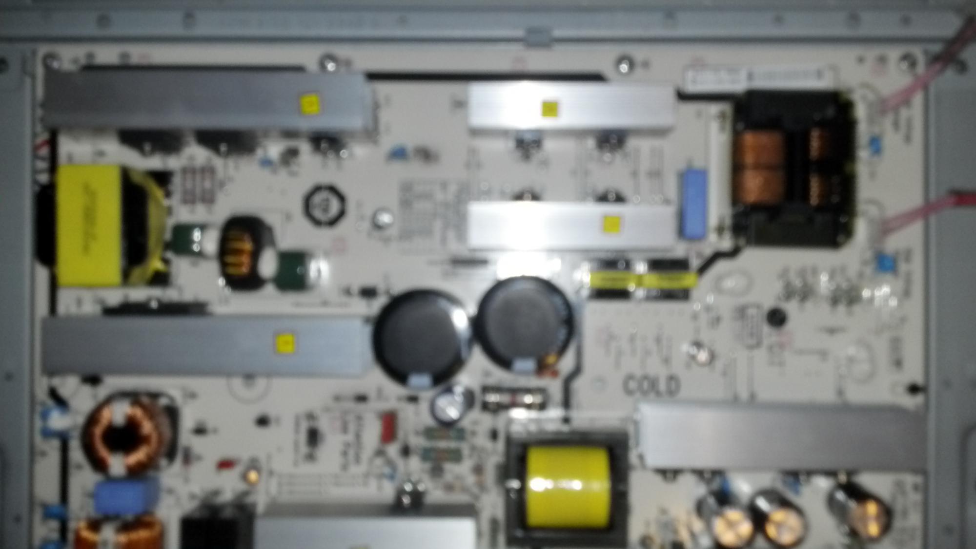

    Around 3 years ago I bought the Phillips 47" 47PFL3603D/27 from walmart. The problem I am experiencing is when the TV runs for about 5-10 minutes it turns black but you can hear the sound still. I can turn the TV off/on and it fixes the situation for a few more minutes and then it turns black again. I have been reading around this forum as well as other sites on the web and have come to find this to be a common problem with these models.
    Now adays this tv would go for about 400 bucks but back when i bought it, i spent around 1600 on it and would like to fix it. After reading many other websites I was going to spring for the power supply from bestbuy.com for around $190 but then I found this forum where people seem to be very helpful with others where they didnt have to replace the entire power supply pannel.
    I have attached the pictures of my power supply which I see no damge to. If anyone would mind looking at them and telling me if i need to get a new one or whether I can replace some burnt out chip that would be greatly appreciated.
    Thanks in advance,
    Nick

    Frankly, the pictures you uploaded are useless. I MIGHT be able to spot a cap with a bulging top, but I wouldn't bet on it. I suggest you look at those pictures, then compare them to the one I've attached. We need pictures of the quality of the one I attached.
    Next, I am not sure that this is a power supply problem. There are a couple of tests you can make, but to suggest them I will need better pictures.

      If I remember correctly these TVs do not have separate inverter boards and the problem is on the inverter section of power supply. Unless you have good desoldering/soldering skills I would say this is not something you will be able to fix as not only are the FETs on the inverter section most likely bad but also several SMD diodes and transistors on the back of the board. I have run across this problem a few times recently on these Philips and Magnavox TVs. Each time the TV was powered on it had a dim screen and after about 30 seconds the backlights would shutdown completely. You will have to test for shorted components on the inverter section to be sure this is your problem.

        PlainBill, thank you very much for you response. I did notice while I was uploading them they were a bit fuzzy. I apologize and will get new ones uploaded here tonight.
        Rayrod - from what you outlined in your post I can tell i do not have the knowledge or skills to fix this myself but I do have a few questons.
        By buying a completely new power supply and installing it, might that still not clear up the problem?
        Could an experienced tv technician possibly be able to fix this with a few smaller parts (and labor obviously) instead of replacing the entire power board.
        Thank you both,
        Nick

          An experienced TV tech can repair this but it may end up costing much more than you would want to spend. Most TV techs are gonna charge at least a couple of hours of labor to repair your TV. While the parts may only cost $15-$20 you will still end up paying $200 or more depending on the labor rate.
          If you buy a multimeter and learn to use it to check the components on the power supply you will save a lot of money and will be able to identify the problems yourself. You can buy them fairly cheap at Radioshack or any hardware store.
          Also, $190 for this power supply is about a 300% mark-up. You can find this board for around $50 to $75 with Google. Just search the part number from the white sticker. Never buy this from a retail electronics outlet because the prices are ridiculous.
