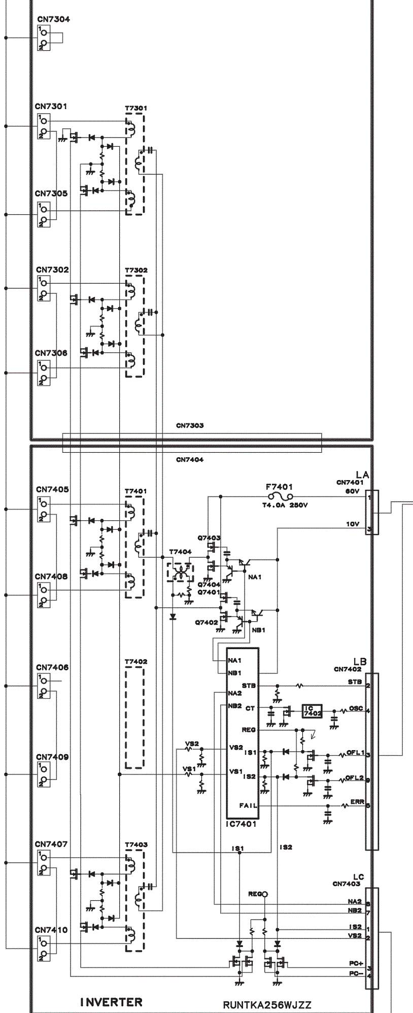

      There *IS* a return line from the inverter to the main board. It's on pin 5 of the 9-pin "LB" connector. In the block-diagram for the inverter controller, you can see that it has a "FAIL" pin, that's pulled up through a resistor. I measured that LB pin 5 today, and it sits around 1.35v at stand-by, and my multimeter caught a maximum of 2.8v before the relay clicked off and it entered that two-red-flash protection mode.

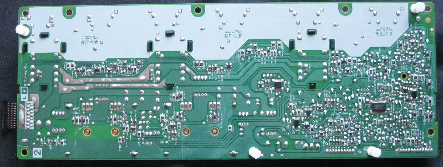

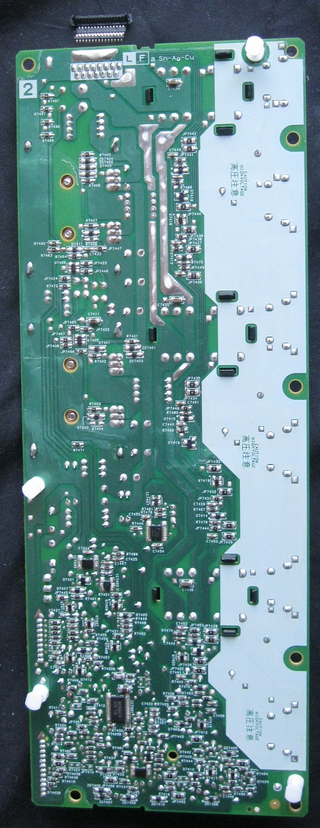

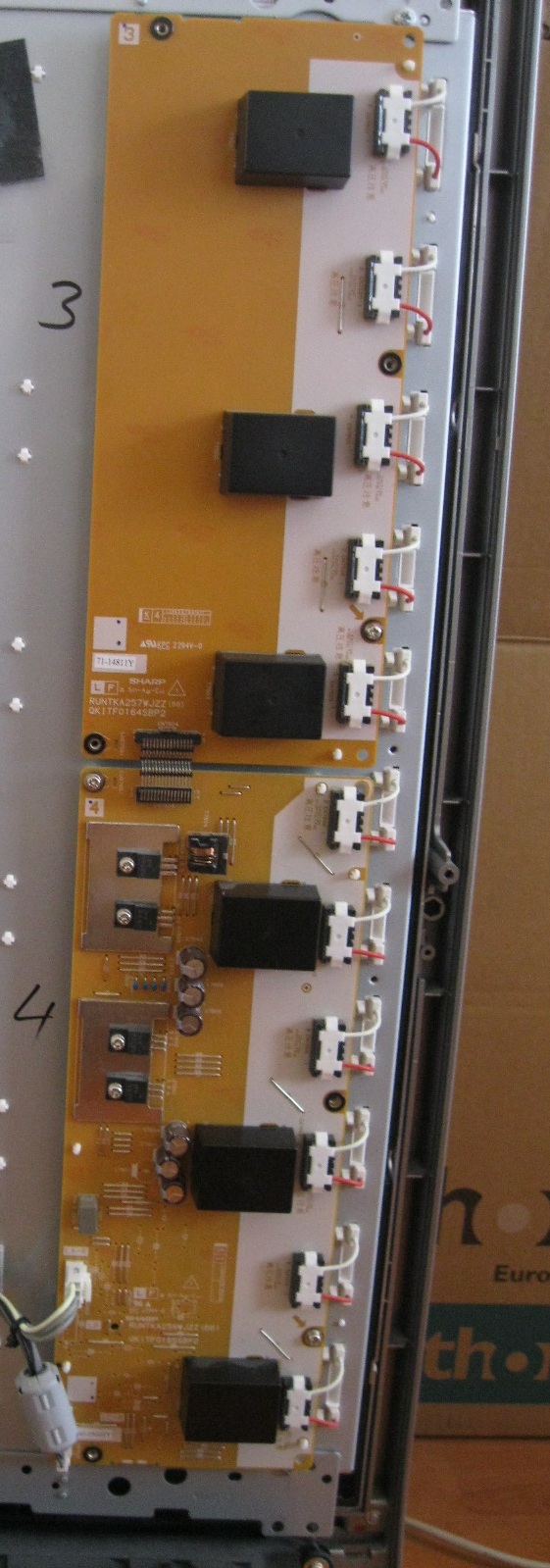

      The inverter is made up of four boards. Board 1 (top left, seen from the back of the tv) has two transformers and six lamp connectors, board 2 (lower left) has three trafos and six lamp connectors, and also contains the inverter controller. Board 3 (top right)similar to board 1, but with three trafos and six lamp connectors, and board 4 (lower right) is nearly identical to board 2 (as in, it has two pairs of switching FETs, but it gets the signals from board 2).
      I'm attaching a "stitched-together" simplified schematic of the inverter boards 1-2, as well as a couple of shots of the actual thing, including two shots of the solder side of board 2 (with the controller).

        The schematic didn't come through. I did look through the partial schematic and noted a 'BL_FAIL' signal line. I also noted a 'backlight on' control line

          The schematic should be in the .zip file (since the .gif wouldn't get attached full-size).

                      Could you perhaps indicate where on the schematic you found the "BL_FAIL" and "backlight on" signals?

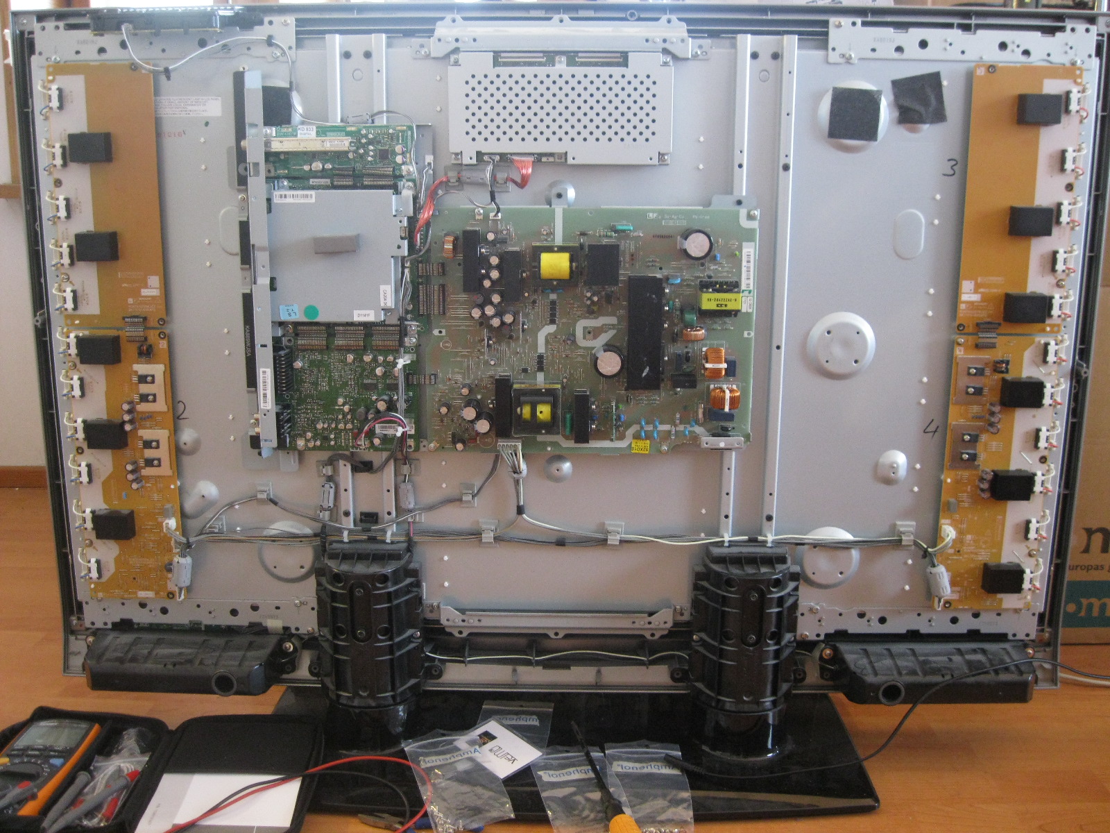

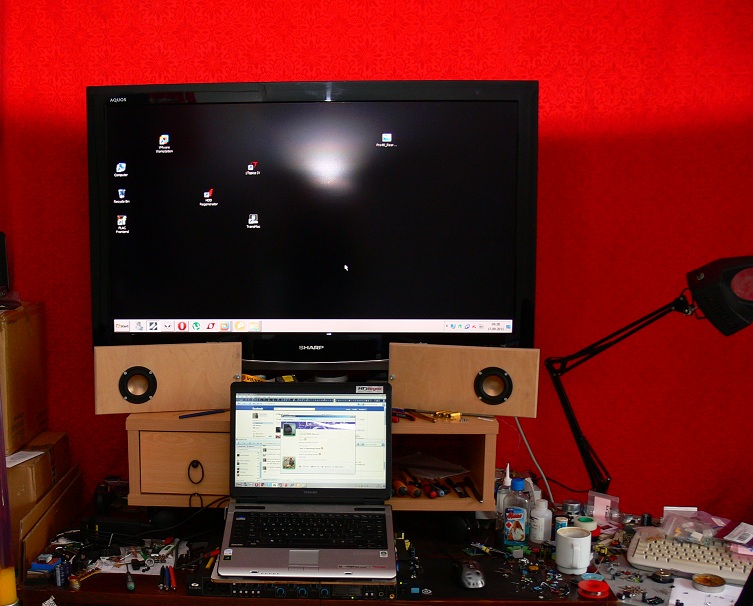

                                        Spare mobo arrived yesterday (ebay.co.uk ), popped it in, and it took right off
                                        Last night, with the help of a neighbour, i propped it up on its "pedestal"
