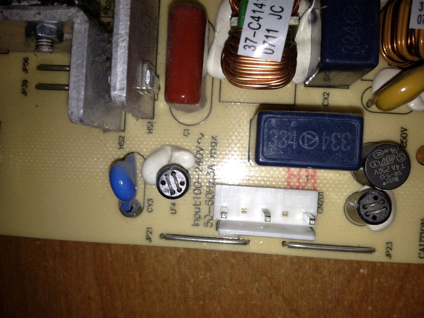

                        hi all have any of you guys found any new developments on the 2 seconds to black condition i 2 have recaped the board and replaced the transformer that was burnt tested all the ccfls looking for any thing else to test or try to get her up and running thanks in advance
                          #72
                          Re: Westinghouse SK-32H240S Continued problems

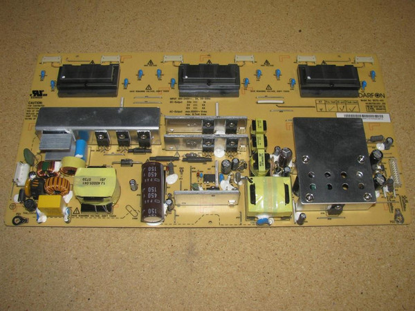

                          hello all i am trying to get a new psu/inverter board for my WESTINGHOUSE SK-32H240S the board number is 4H.B0700.051/B1 / B070-401 i know that thare is 2 difrent boards for this tv my question is are thay interchangeable i have attached a pic of the board i have now i appreciate any in put thank you all in advance. the number on the barcode is 5604264011g74900274bp1b
                            #73
                            You need to match the number on the barcode sticker, that is the part number of the PCBA (Printed Circuit Board Assembly), the other numbers as printed directly on the board is the P/N of the blank board before it is stuffed with components, they can use the same blank board for making many PCBA. So what are the numbers as printed on the barcode?

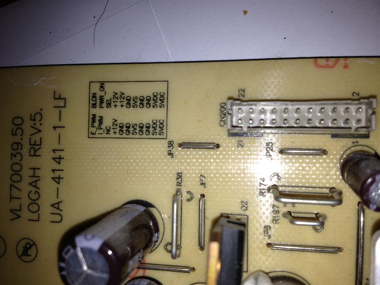

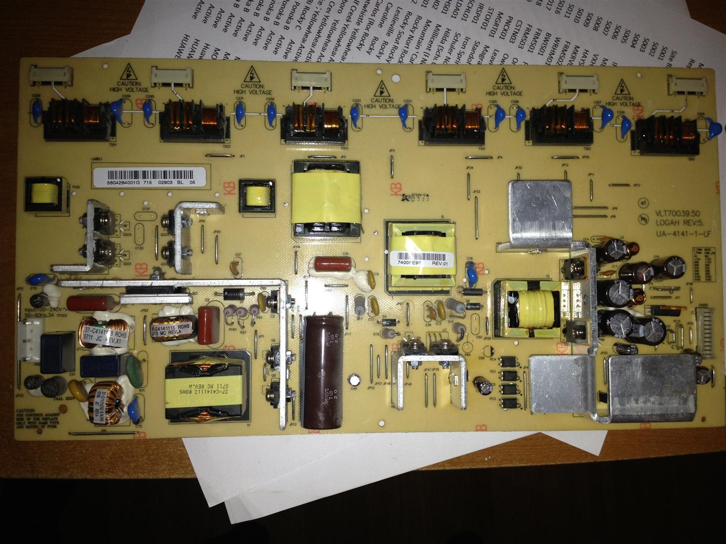

                              Hello gentleman,
                              we are trying to figure out if the PSU board that I have will work in his TV.
                              Plugin's etc seem to be the same,but board component etc different,eventhough it's the same make model TV !!
                              I took pics of the board and barcode and legend for the 22pin plug...

                                #75
                                the number on the barcode is 5604264011g74900274bp1b thank you for your help.
                                  #76
                                  http://www.shopjimmy.com/catalogsear...use+sk-32h240s, he has a sub for the your board.
                                  http://www.shopjimmy.com/westinghous...t-inverter.htm
                                  You should contact SJ for verification.
