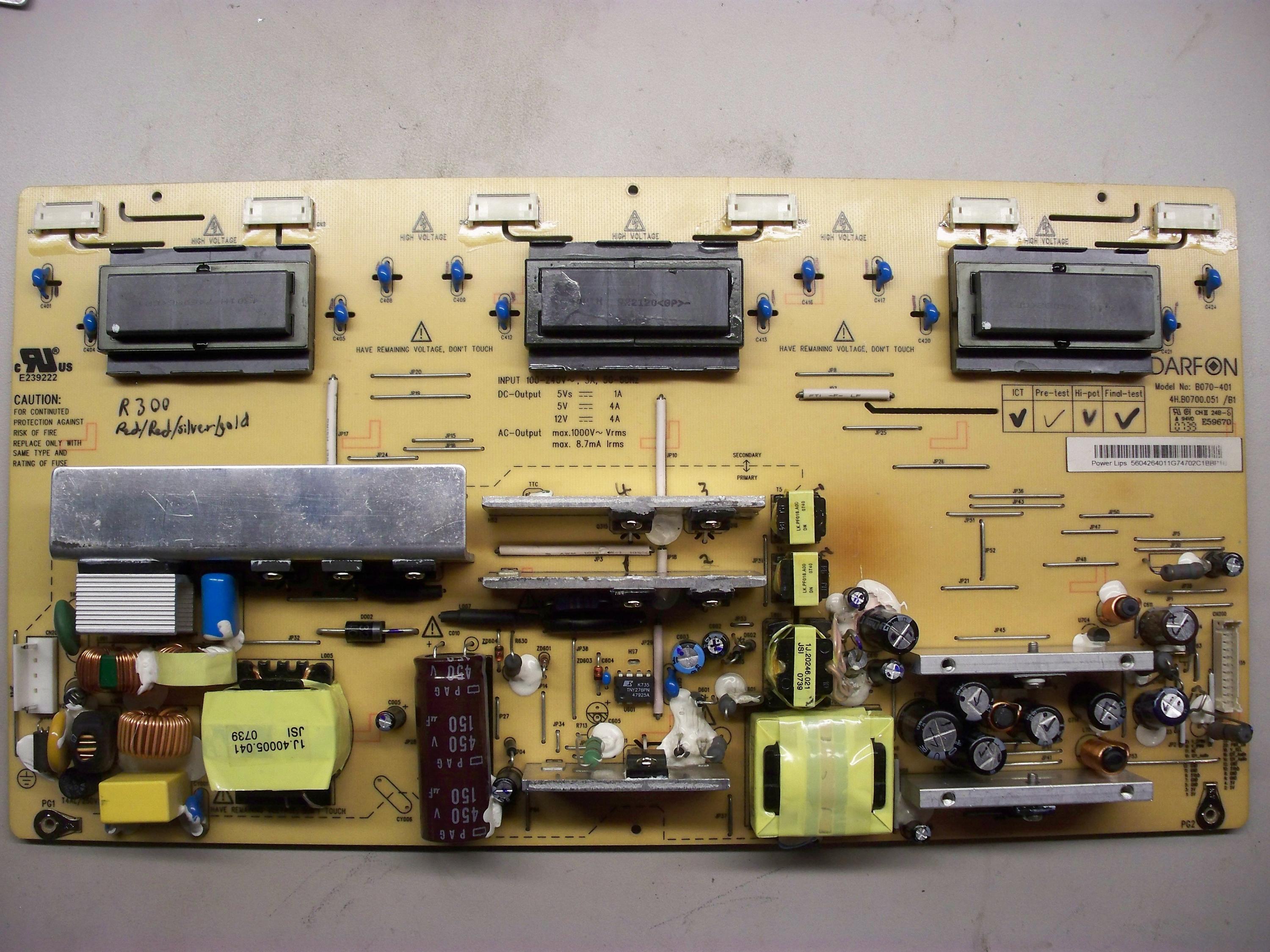

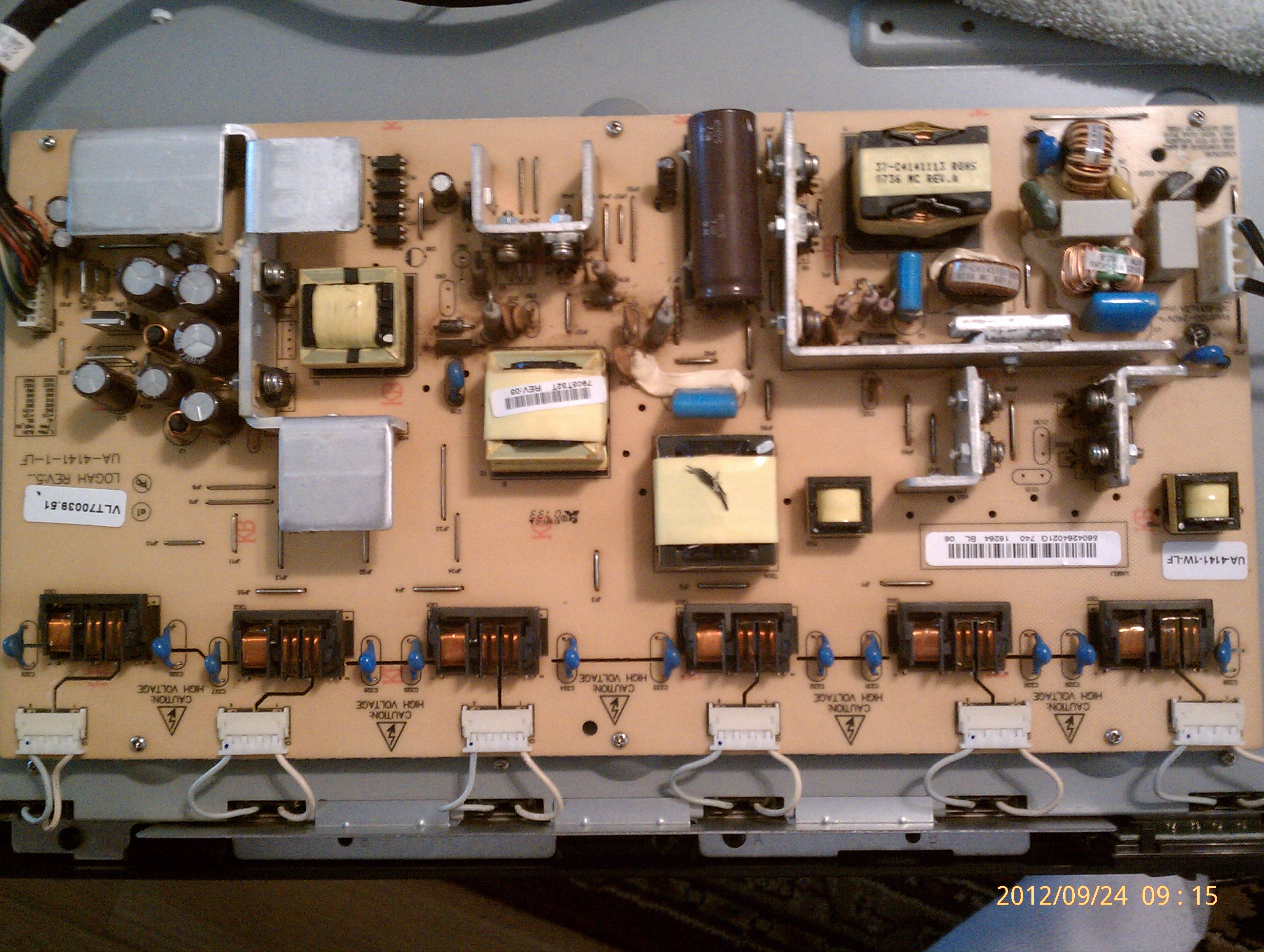

                I just picked up this same model TV for $20, it appears to have 2 different issues. The one is a garbled screen with random veritcal lines that appears to be a LCD/or connection issue. Secondly, the backlight comes on there goes off after about 10 seconds.
                I suspect one of the transformers as it tests differently then the others, but Im not sure actually what pins to test. I recently got a blue ring tester aswell but do I have to pull the transformer off to see what's what??
                The only #'s I can see on the side of the transformer are:
                42-M41411P08
                LITEON 0739 MC REV A 6

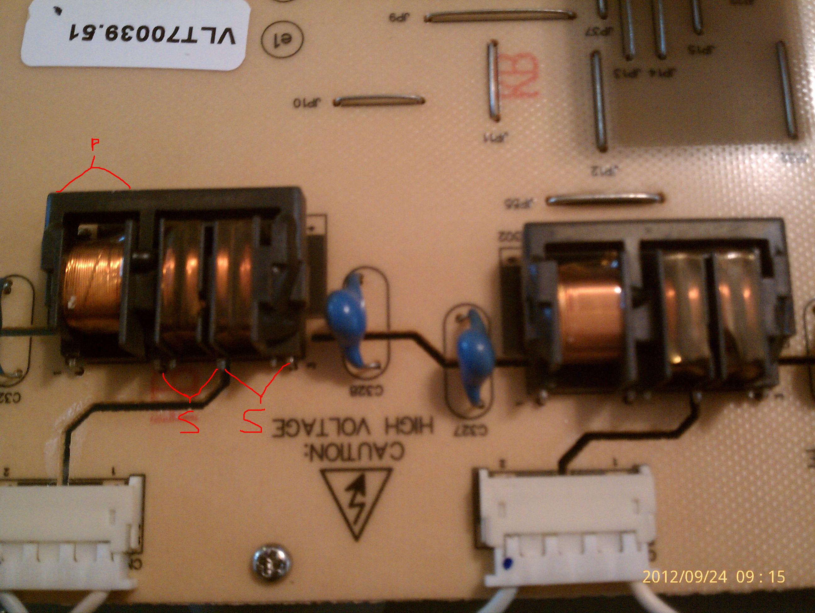

                  Ok I took one off just to see how it's layed out.
                  I tested each primary winding with ring tester and full green LEDS, also resistance was 2.2 - 2.3ohms on each transformer.
                  Not sure if I measured secondary correctly, seems to be 2 windings with a common pin in the center. Here's results for each one with meter set to 2k, measuring with probe on center to each side of windings.
                  T303 - .539, .536
                  T302 - .539, .541
                  T301 - .538, .541
                  T203 - .525, .526
                  T202 - .521, .525
                  T201 - .541, .541
                  Did I do this correctly? Also, putting ring tester on same pins lights 1 yellow LED.

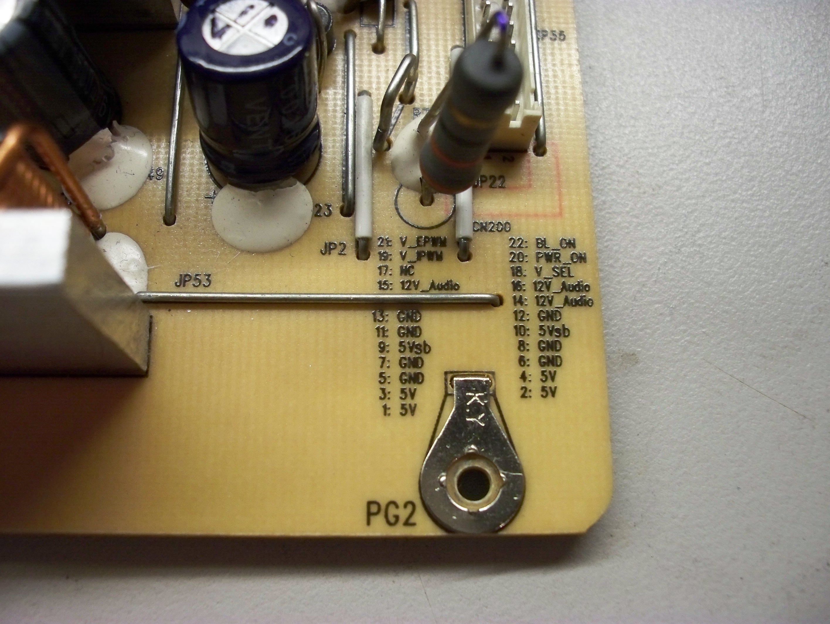

                    #29

                      Re: Westinghouse SK-32H240S Continued problems
                      Is there a BL_ON signal going from main to PSU?
                        There is 4.3v at BLON, until backlight shutsoff after 10-15 secs, it goes to 0v. But, by hitting one of the volume or channel buttons on side of tv, backlight instantly lights up and 4.3v returns to BLON.
                        Does 4.3v sound a little strange? And jumping from 5v standby to BLON, keeps backlight on.
                          Sounds fine for a BL_ON signal; I'd look at the main board.

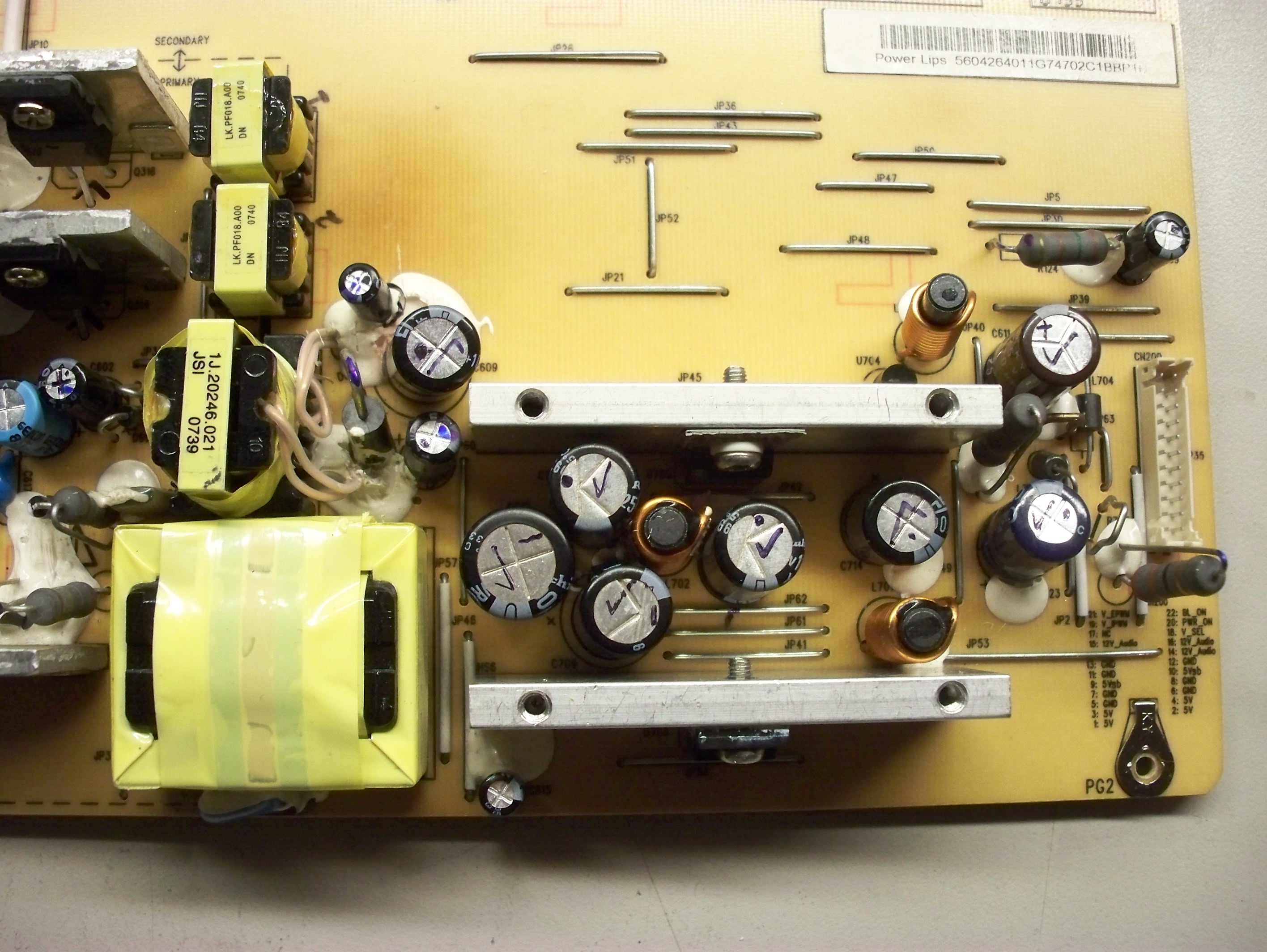

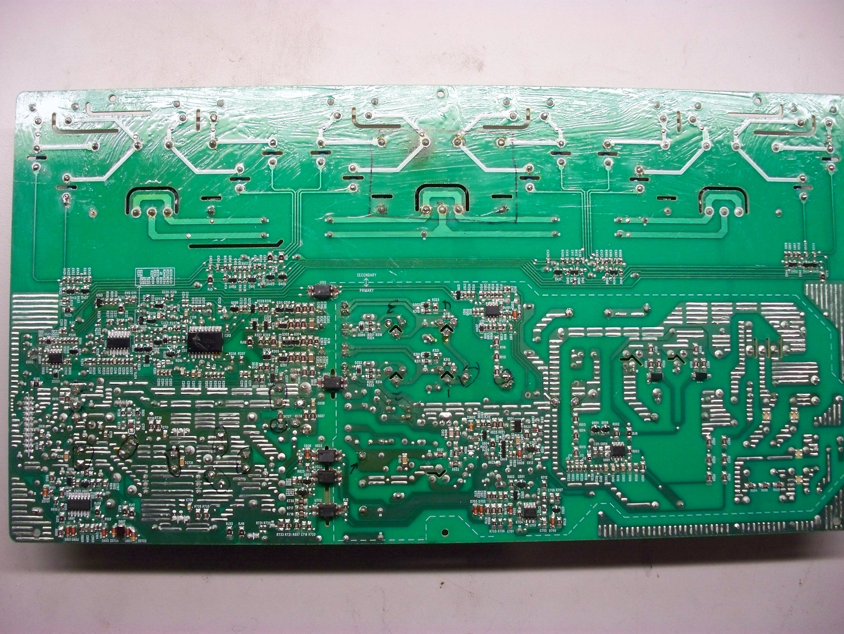

                                    I have a Westinghouse SK-32H240S with the same problem as Xavier Renowned and Mike95inNJ (which is “2 seconds to black” But its 2 flashes of the back light. 1 flash shows the ‘W’ logo then another flashes the TV input then backlight stays off. You can see the picture if you hold a flash light up to the screen, and I do get sound.)
                                    I had a burnt transformer and puffed up caps. I replaced the 1 bad of the 3 transformers, and a few bad caps. I've checked most of the caps with ESR meter and the rest seem okay. I checked the transformers resistance on the primary and secondary and there isn’t much difference. I've tested the ccfls with PlainBills method and another of my own. I used an old LCD pc monitor inverter board to light up one ccfl on this tv at a time (and 3 on my old monitor to balance it), and made sure I could get each ccfl on this TV to stay on as long as I wanted, using this method for all 6 ccfls. (Of course I had to feed the monitor a signal from my pc through the VGA port to make it work tho.) I also tried the opposite, lighting different ccfls with this tv inverter board. I hooked 2 of the ccfls on my old LCD monitor to 2 of the connections on each transformer on this TV’s inverter board. And it lit up but still did same thing the tv always did, lit up and went out.
                                    I checked the BL_ON pin and it’s getting 5 volts
                                    I’m not really sure where to go from here… any advice? Am I on the right track? Do you think my way of testing the ccfls was an accurate measure? Is there any other diagnostics I could perform?
