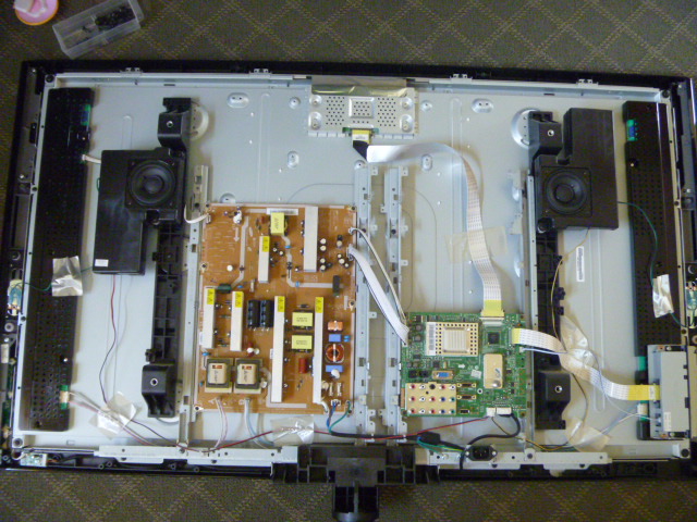

    I get Samsung LN46A530P1F from craigslist the guy sale TV his said "doesn't turn on"
    when I go home last night plug to outlet is working on DVD play & TV about 2 hours total from last night & today
    when I bring TV to master bedroom & my kid hook up to Computer is working about 1/2 hour & screen had most vertical rainbow and shut off tv & Standby LED red light blink I can heat relay is click try turn on

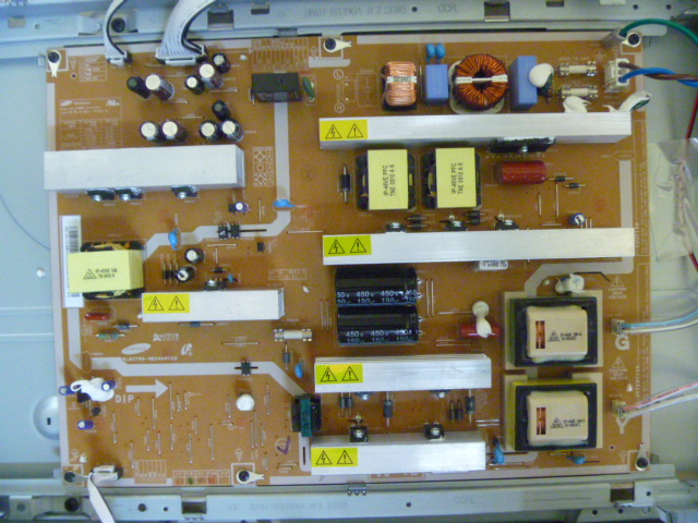

    I open the TV check the power board had not bad cap but I changer all caps
    here the caps on power supply
    2 820uF 25V
    2 1000uF 10V
    2 470uF 35V
    1 100uF 50V
    3 47uF 50V
    4 10uF 50V
    after I replace, TV turn on is final on PC & about 10 min screen had more vetical line and shut off front of TV red LED blink but can heat relay click try turn on (same thing before I changed cap)
    Any one had some Ideal?

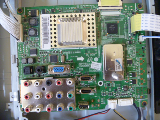

    Look like my TV had MAIN BOARD parts# BN94-01723A or BN97-02449A is bad (I think the PC input area at mainboard had some bad components, because when I plug PC to TV the will shut down & can't turn on again. Had unplug TV about 2 hours or more to reset)
    when I take a look on service manual at PC input section at mainboard maybe some electronic components bad or leaked to ground
    I will check late
