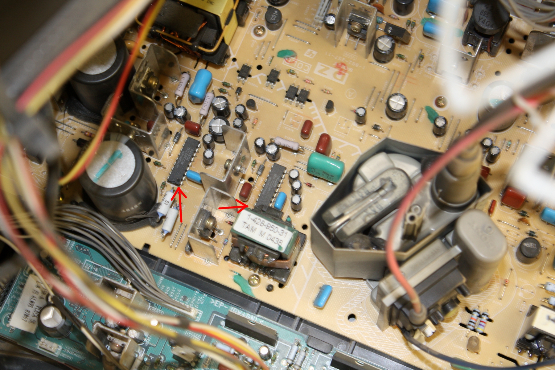

    I recently picked up a free Sony KD-34XS955 TV. I already own the XBR equivalent of this model so I know it's a really nice TV. Even though it's a CRT TV which many feel is "old technology," it has nice features such as full 1080 resolution, digital turner, widescreen, and HDMI input.
    Anyway, the problem with this TV is sometimes when you turn it on nothing happens except a blinking LED on the front. I know from searches on www.agoraquest.com that the problem is most likely the two MCZ3001D ICs on the "D" board. I've already ordered two chips and sockets. I have plenty of soldering experience so I know once the board is out I can desolder the old and solder in the new.

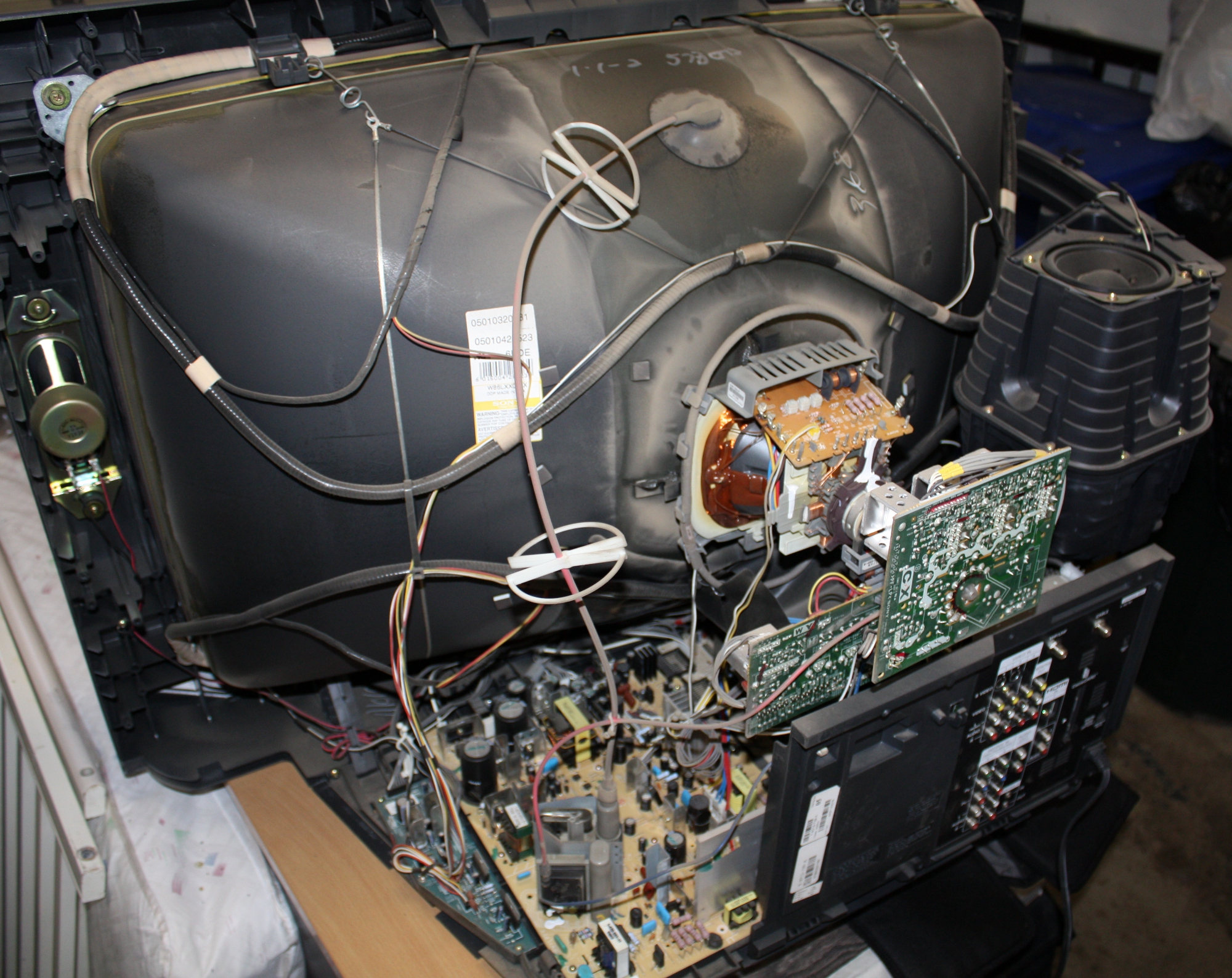

    My question is discharging the CRT. I know these CRTs can hold a lot of charge on them and need to be discharged before you can safely work on them. From what I can tell the recommend method is as follows:
    1. Attach a thick wire to an insulated flat blade screwdriver.
    2. Use an alligator clip to attach the other end of the wire to a ground point.
    3. Slowly work the screwdriver under the anode cup and make contact with the metal to discharge.
    4. Repeat step 3 several times.
    That's all well and good, but I can't find details on where to attach the alligator clip. Some people talk about a metal spring and/or wire surrounding the CRT. Also, do I need to connect the TV to ground to earth ground when performing this?
    FWIW, this TV has been off and unplugged for over a week, and from what I can tell Sony Trinitron tubes self discharge in about 30 seconds. But I am not about to make any assumptions, I want to be darn sure it's safe to work on this TV.
    Below are pictures of the back of the set as well as the two ICs I'm going to replace.

    Don't do it that way - there is an excellent chance of damaging the CRT.
    Instead, rig it up so there is a 1 megohm resistor between the screwdriver tip and the anode. This will discharge the CRT slowly. As far as a point for the grounding clip, clip it to one of the spring loaded cables across the back of the CRT.
    Normally there is a very high resistance between the 2nd anode and ground, so discharging the CRT is unnecessary. Still, it IS better to be safe than sorry.

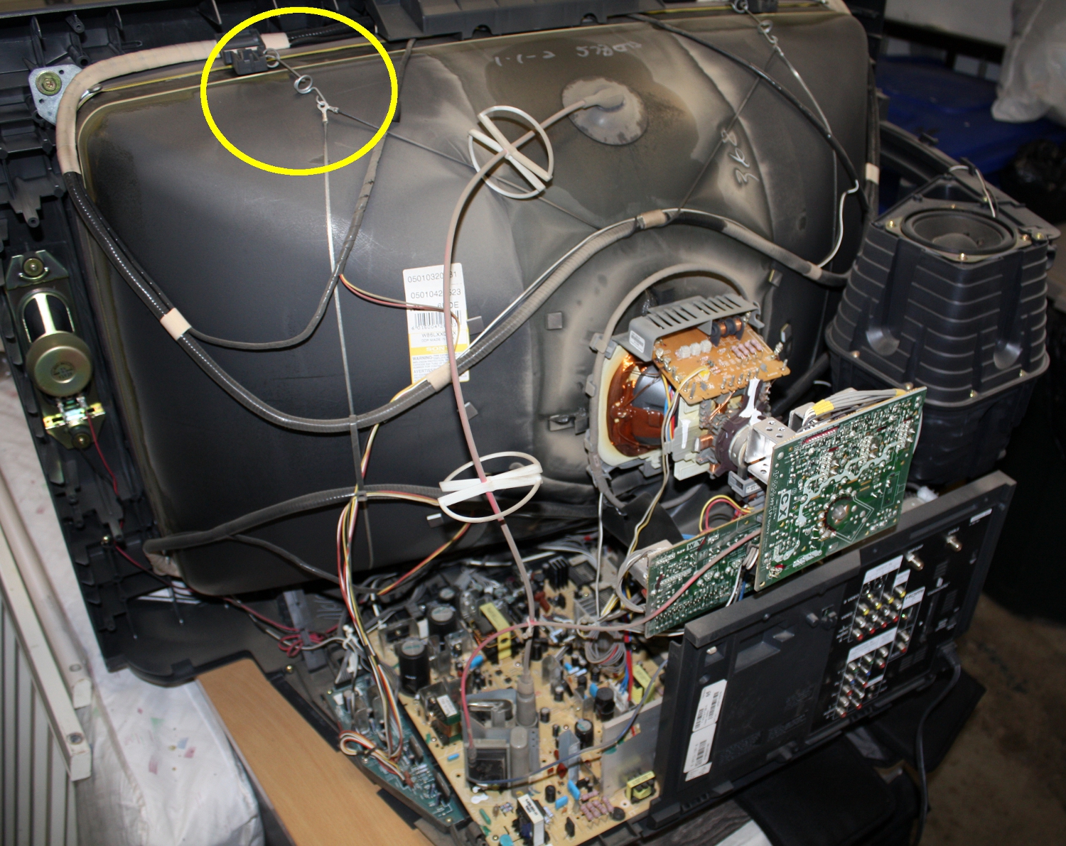

      Just to be clear, you're saying to clip to the area circled in the image below? As for the resistor, my thought is to solder a 1 MOhm power resistor inline in the wire between the screwdriver and the grounding point. This provides the necessary resistance but without having to rig a resistor on the end of the screwdriver.
      Thanks for your help thus far. I'll report back on this project later.

        I'd hook the clip to either eyelet, not to the spring. A resistor in the ground lead is ok, just make sure you have a well insulated screwdriver. There won't be enough current to kill you, but it will wake you up!!

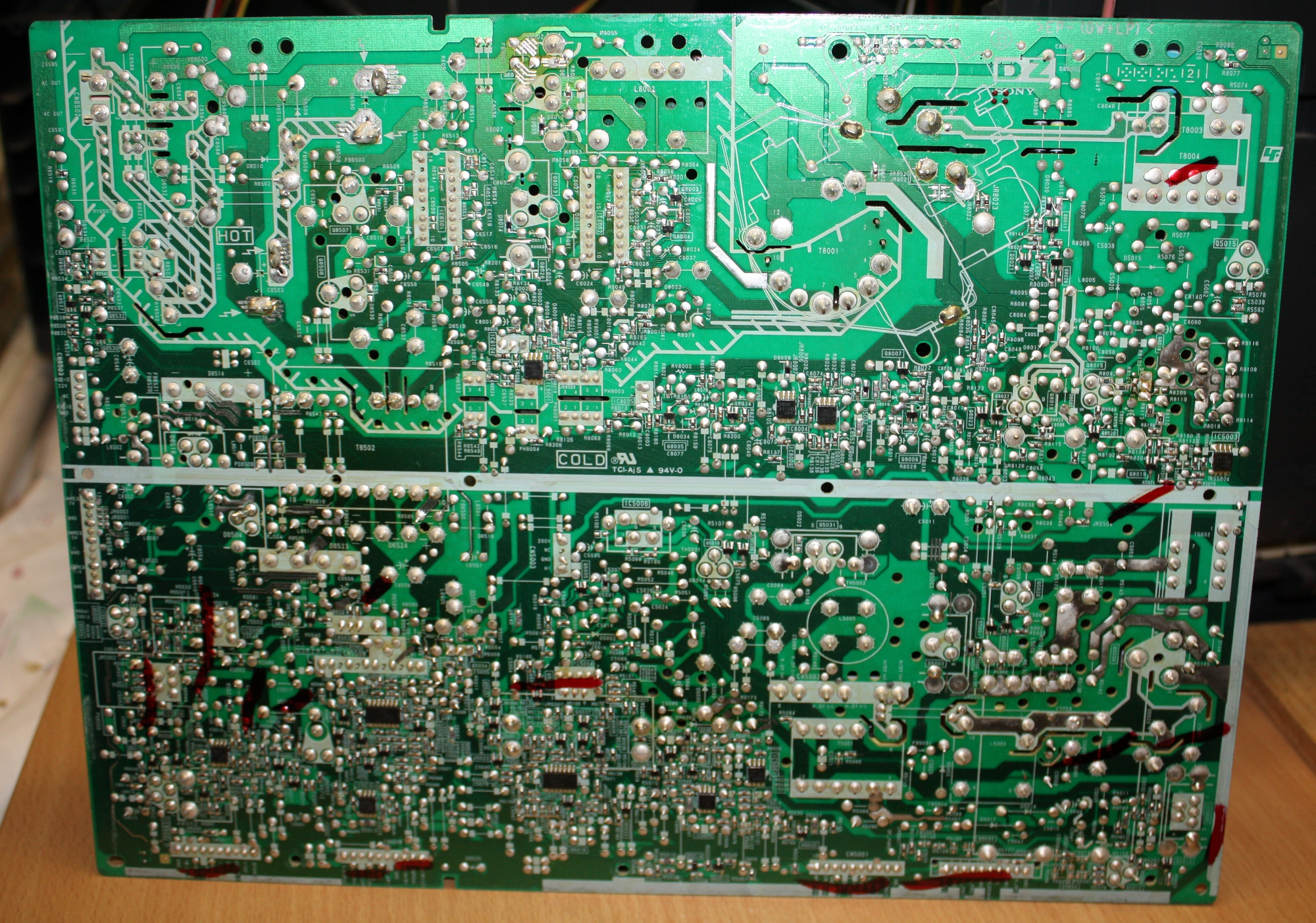

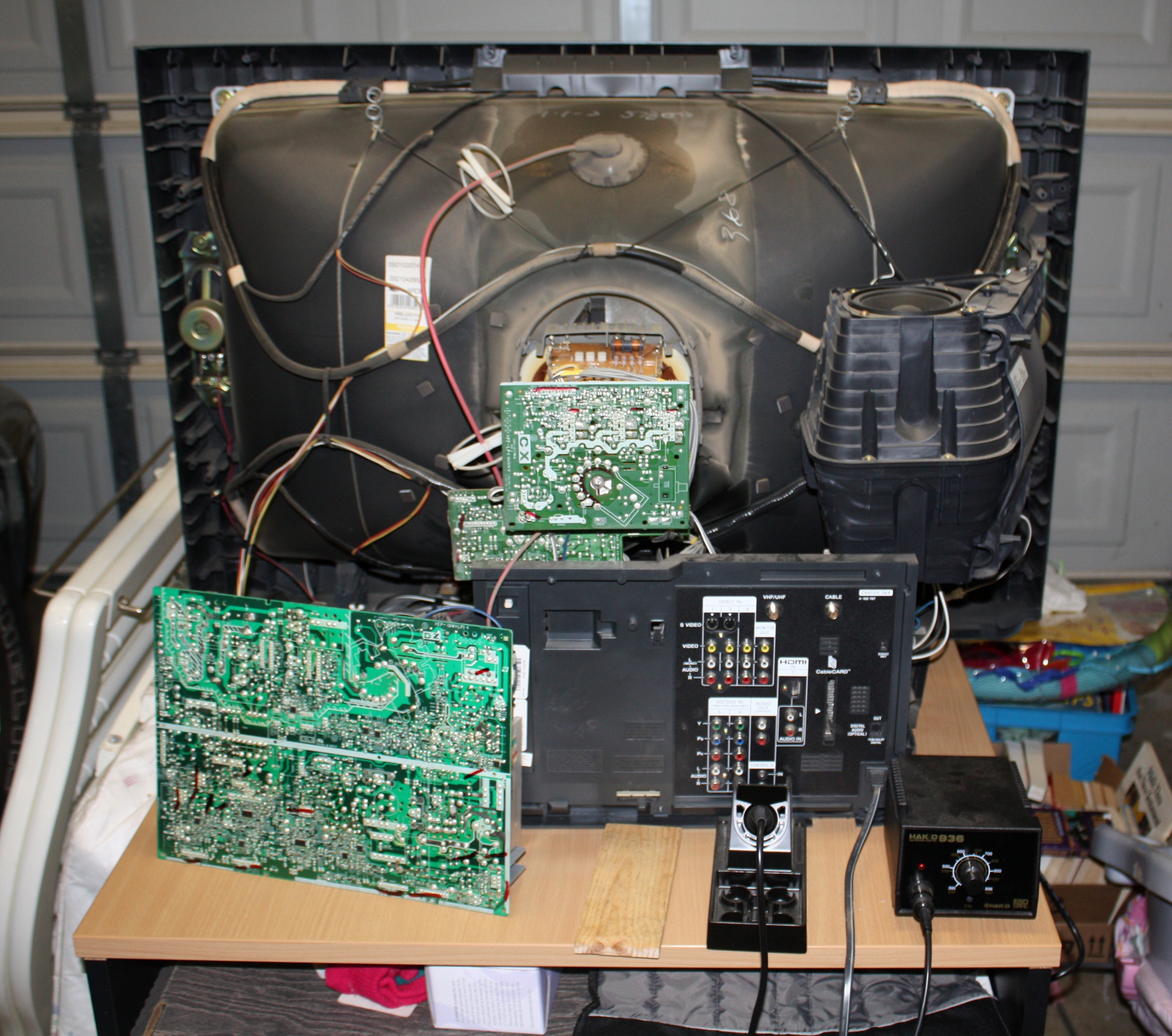

                Success... mostly. I decided to follow the advice of "weirdlookinguy" and did not completely remove the board from the TV. I disconnected all the cables that had clips, removed the screws, and then pulled the board out as far as I could (leaving the FBT wires still connected). I propped the board up against the TV and desoldered the chips from there. Below is a picture of the board semi-outside the TV, and another close-up shot of the back of the D board.
                Removing the two ICs was a piece of cake. In all the desoldering work I've done, these two ICs were the easiest to remove. I soldered in the new ICs, put the board back in, and reconnected all the wires.

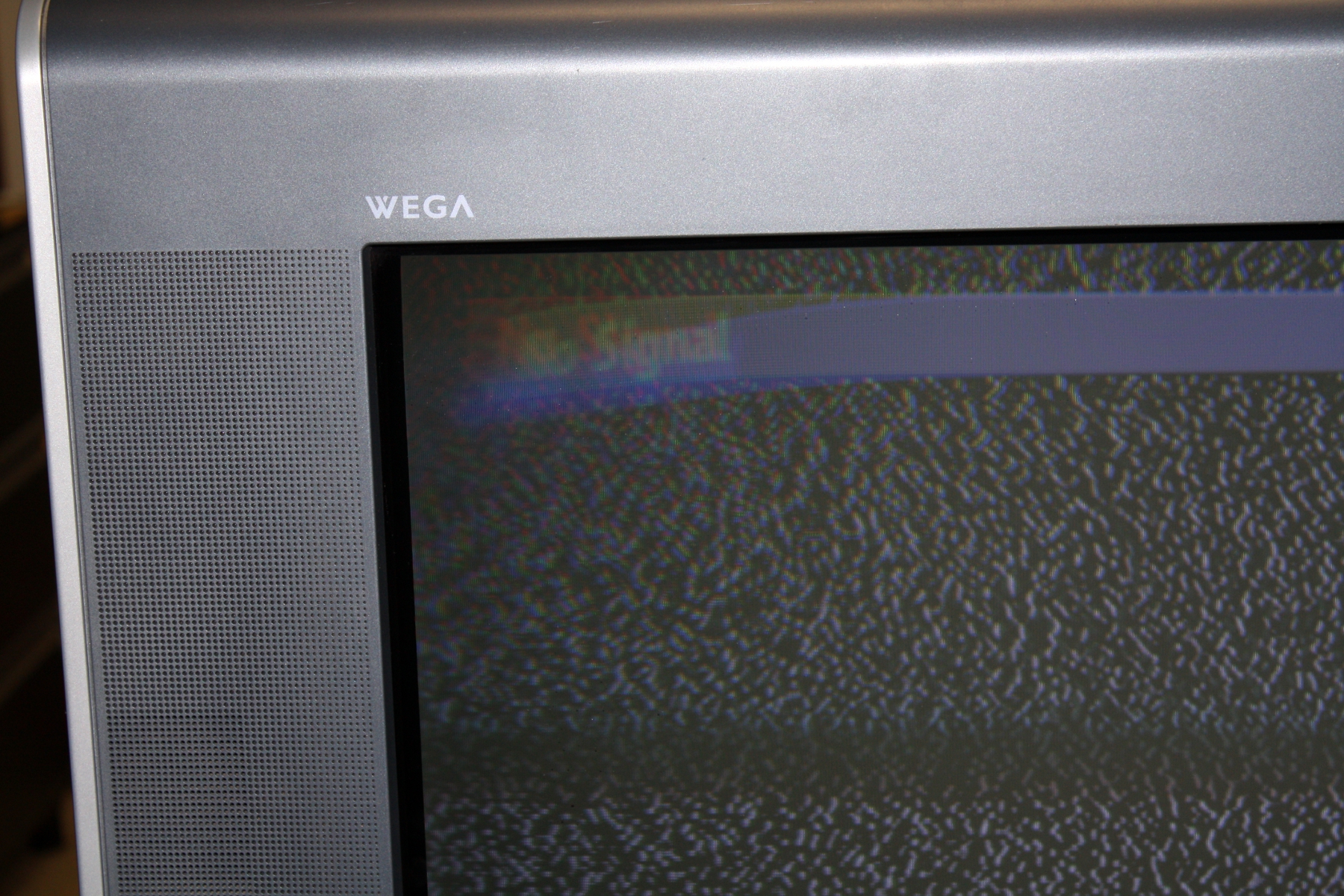

                Powered on the TV and it works great... for the most part. The one issue I'm seeing is the extreme upper left hand corner, the red, blue, and green images are not properly aligned. However, after the TV has been running for about 20 seconds the three color plains come into alignment and the image is perfect until the next time you turn it on. Below is an image of the issue I'm describing.
                My question is, when I was working inside the TV did I bump some calibration knob/screw? If so, does anyone know what to adjust to correct this? Or is it better to just live with this problem since it corrects itself after a few seconds?

                  It's unlikely you caused this by bumping something.
                  I'd suspect a cap in the convergence circuit is a little dodgy, or POSSIBLY a bad solder joint. I'd download the service manual from Elektrotanya and look over the schematic of the dynamic convergence section.
