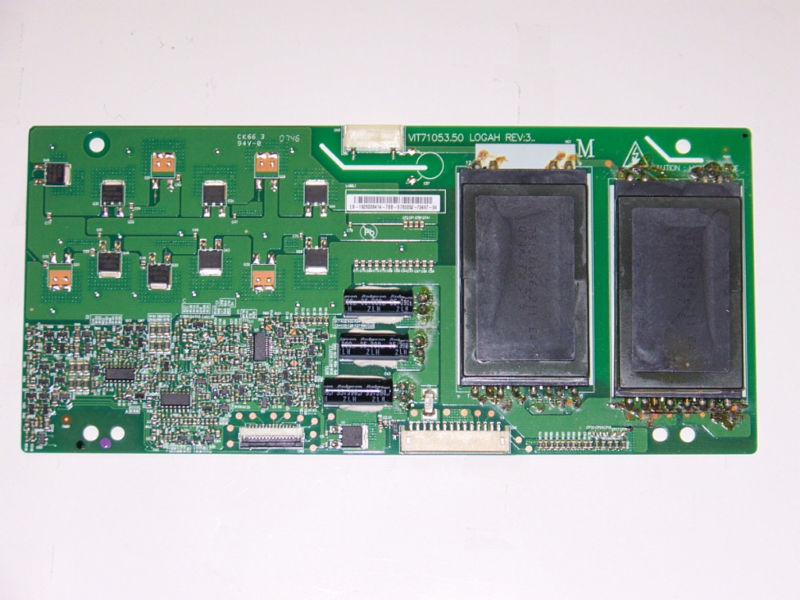

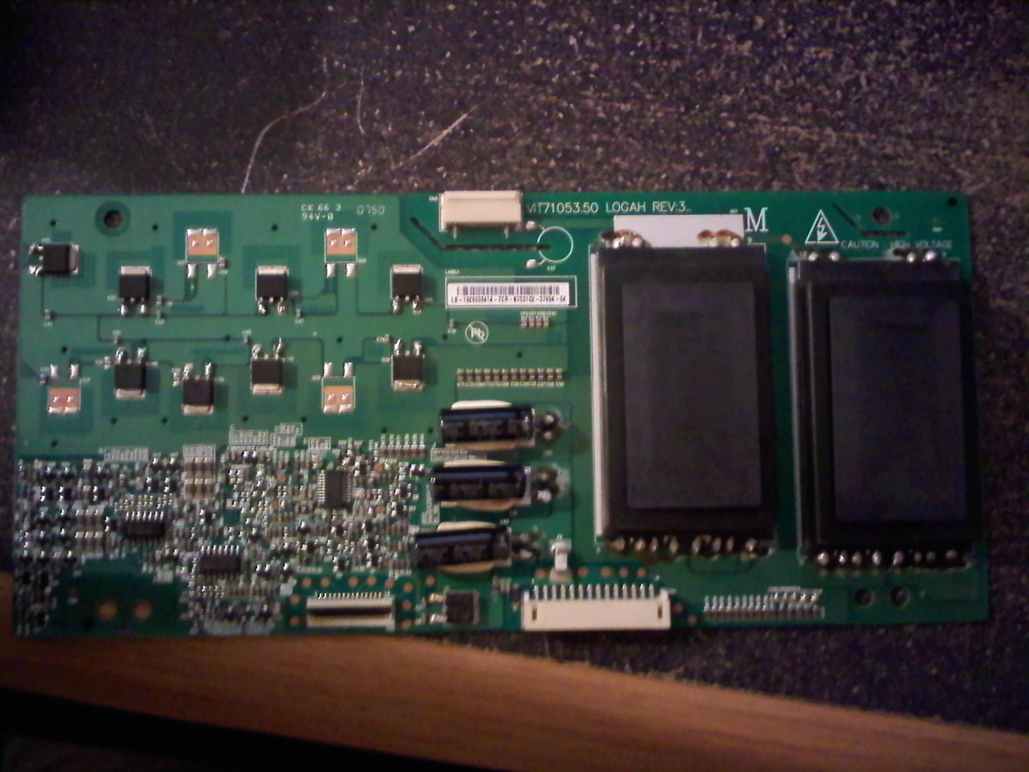

          here is my master inverter that i believe is causing the problem.With the inverter disconnected from the bulbs and turned on i cant get a voltage reading on my meter it just errors out my meter and puts it in hold mode.If i do the slave on ac voltage the meter reads 33volts for a sec then drops to almost nothing.
          • PlainBill
            • Feb 2009
            • 7034
            Re: Lg 42lg30 need help with inverter question
            Where are you trying to measure the voltage?

                Not the brightest thing to do. The output is close to 2000 volts at 40 Khz and can provide 40 mA or more. More than enough to provide a life ending event for your DMM and for you.

                    You don't test the output of the inverter, it's very difficult without a high voltage probe or something similar.

                      Tom66 is correct. Although in a sense you have already tested the master output and it is good. Now the slave inverter SHOULD have behaved the same way.

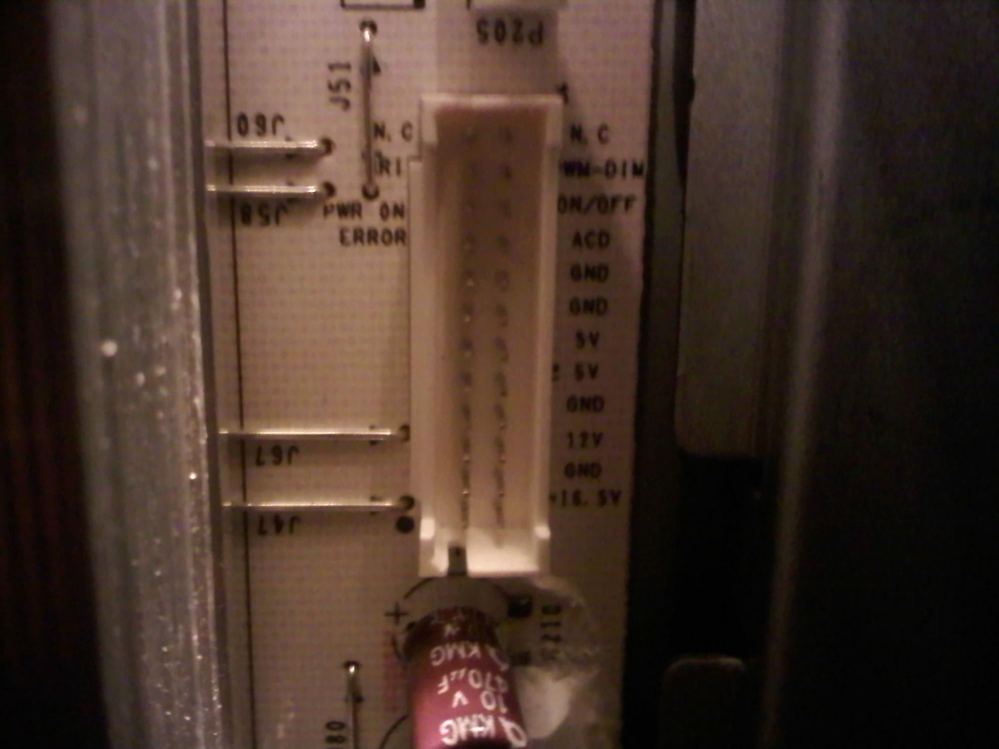

                          I was doing some poking around tonight on the tv and happen to come across something and wanted to know if anyone can give me an idea of if the way this is reading is wrong or right.
                          on the connector from the power supply to the mainboard there is a pin marked acd (ac detect i am guessing?) now the connector has another pin across from the acd that is marked error. When i test to ground on the power supply connector i dont show a ground on either of these two pins but when i check on the mainboard where this connector goes to the error pin is showing ground.Is that normal? or is this causing me an issue with my backlights? I also dont understand that when i plug the tv in without touching anybuttons the status light flashes red twice then goes solid blue and thats when the backlights come on for a sec buzzing and shut off and light stays blue.If i hit the power button again the tv repeats the flashing and on for sec with buzzing then off.
                          any help would be great but again i know i get confusing and its hard to understand a problem across the net.just looking for ideas to look at. i will add a pic of the connector now.

                            All of the problems I have had with these AU-OPTRONICS panels were bad ccfl bulbs and slave inverters.
                            You will get symptoms of a bad inverter (2 seconds to black) even if you un-plug the slave inverter. The backlight will stay on longer (3 seconds).
                            I was getting 1200 volts on my industrial fluke.
                            If you don`t make a solid firm connection it will ark and smoke the test meter. (I have done this in the past)
                            When you take apart the panel you will see the bad ccfls. (darkened or burnt spots)
                            The slave inverter will have shorted mosfets.

                                I'm not real familiar with the design of this type of backlight system, but it appears the voltage is getting too high. This is based on the fact that an arc forms. This might be due to a flaw in the inverter, or in whatever circuitry balances current through the CCFLs.

                                  If you leave a gap it will jump it and the v will skyrocket out of control.
                                  Some of these bulbs are plug in and the spring tabs are junk at best.
                                  Some of these are soldered (much better) You can solder these.
                                  Most mosfets will have a base/ collector short (fail on) and easy to detect with a simple meter
                                  I will need to dig up an old board and let you know
                                  The better set up is the l/g inverter single board It will also work on this panel you will need a longer lead wire (special) if you go this route.
                                  There are tons of parts for these and they are cheap.
                                  All of the model 30s have very much in common.
                                  you can use a 32lg30 mainboard in a 26lg30 and I have also used the 32lg30 mainboard in a 42lg30-ua for testing the panel
