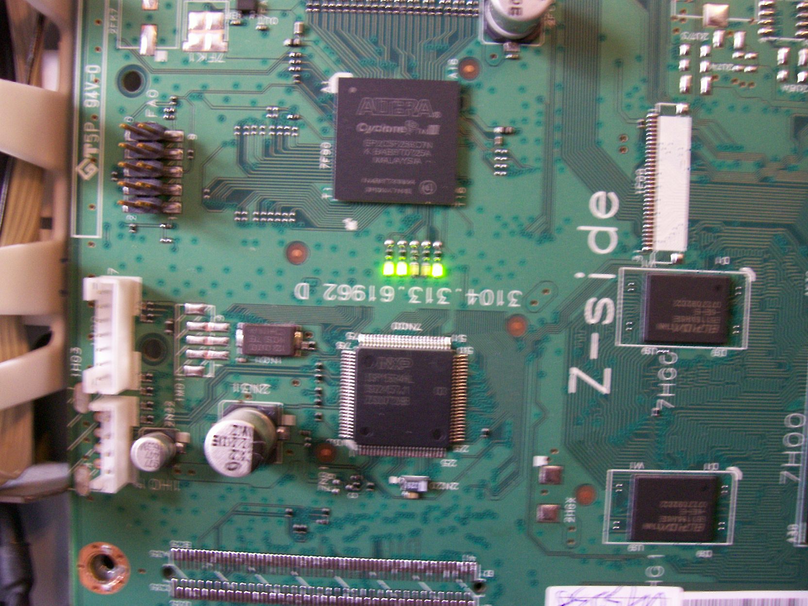

    When the unit is initially powered:
    1. the blue power light turns on
    2. there are 5 micro led lights on the component board (not sure of the correct name, it consists of RCA, HDMI cable, etc inputs) the first, second and fifth light up.
    3. the relays click (on the display power board)
    4. everything turns off (including the micro leds) and the red light blinks its sequence.
    If anyone could pin this problem down to a specific board that would be great, or if we can get it figured out at the component level that would be fan-didlly-tastic…..

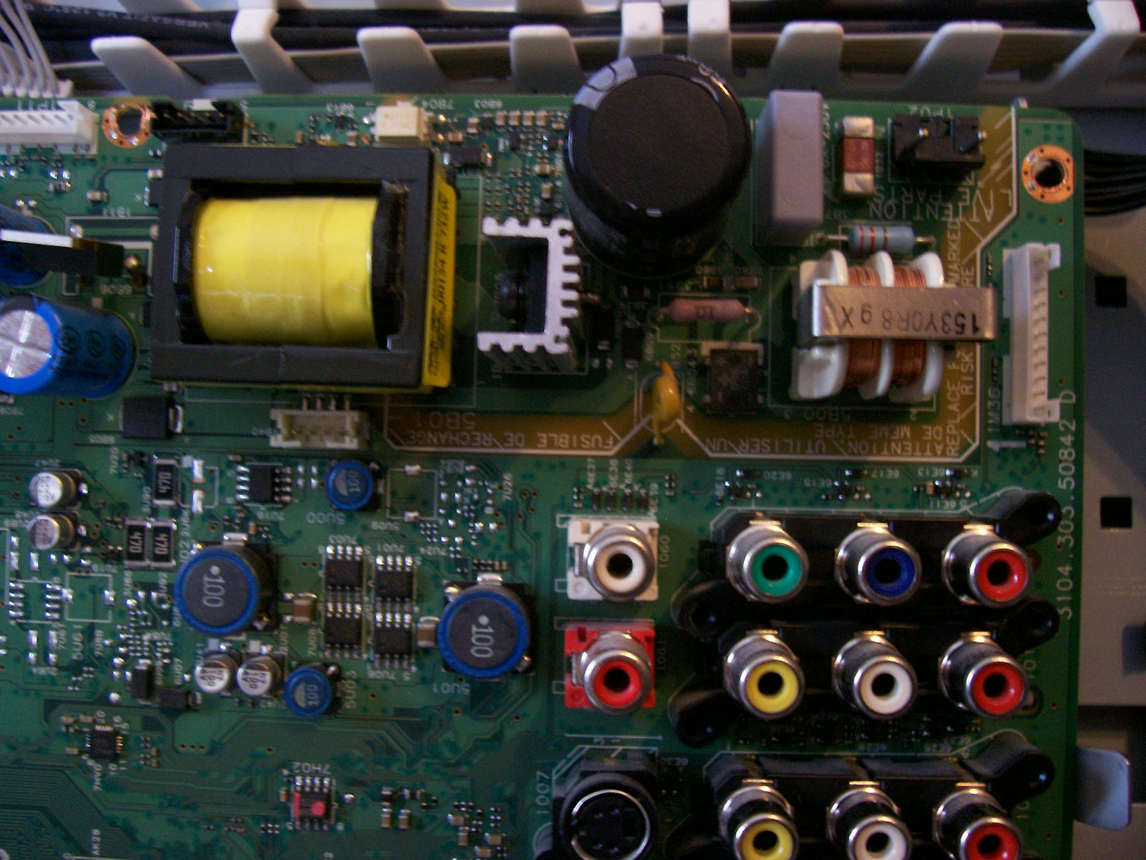

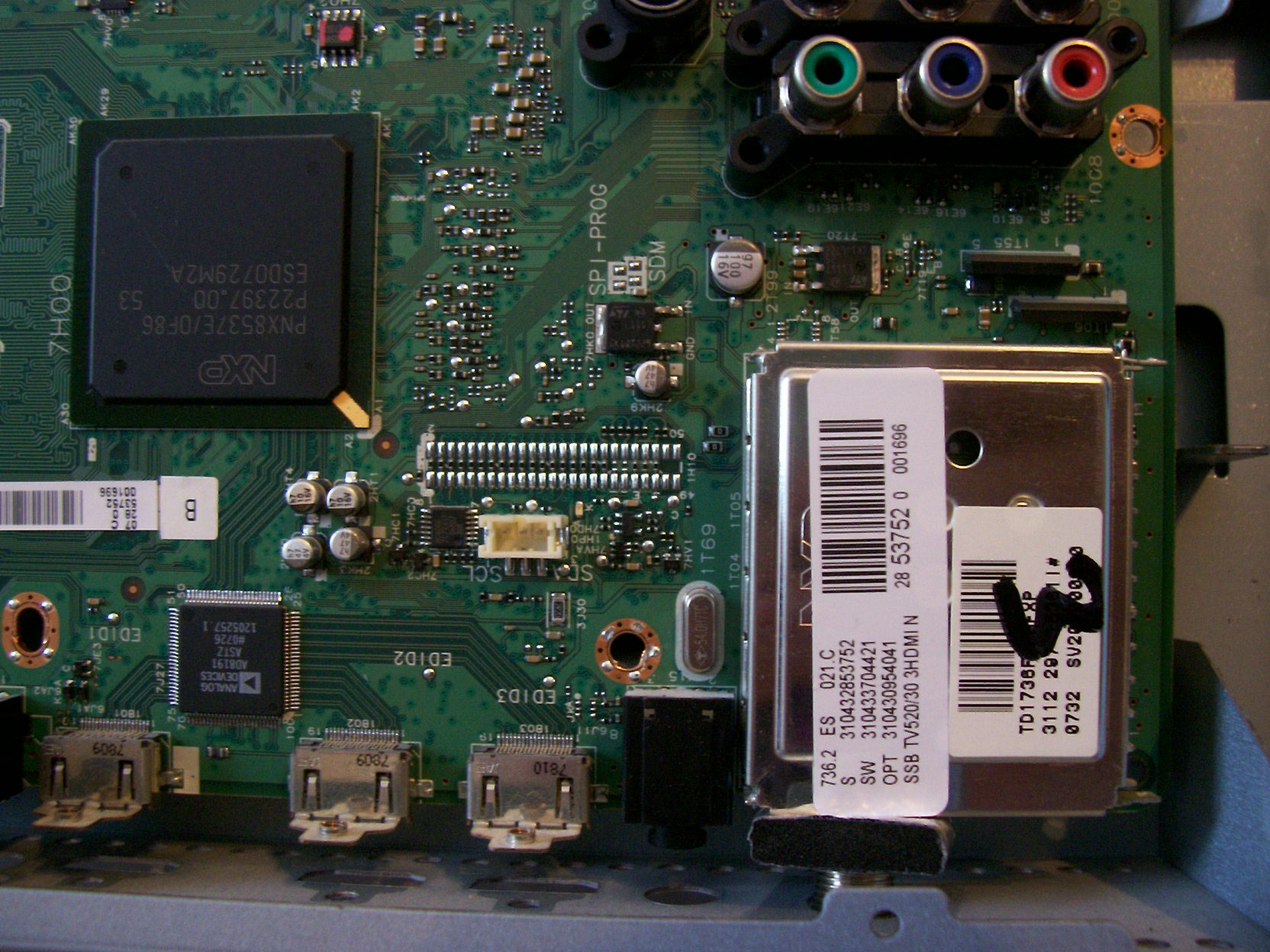

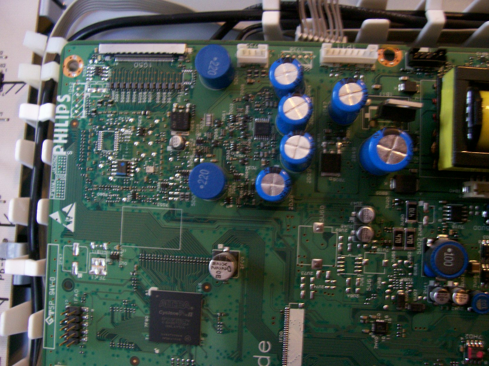

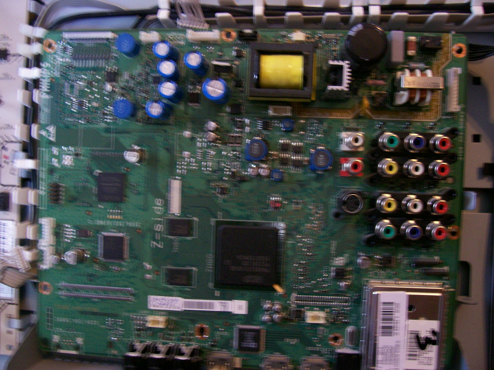

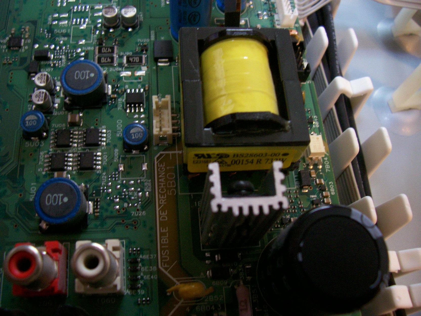

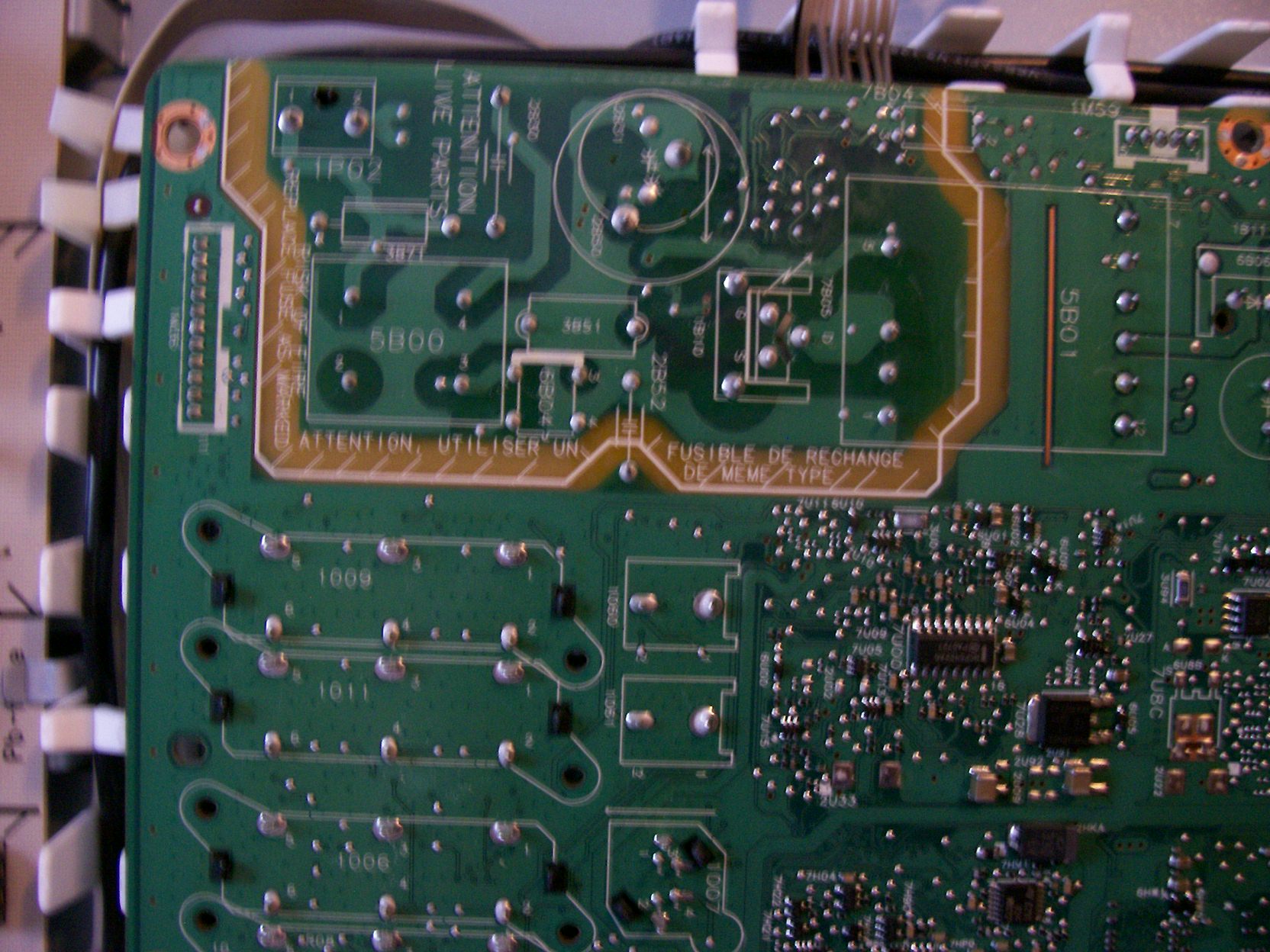

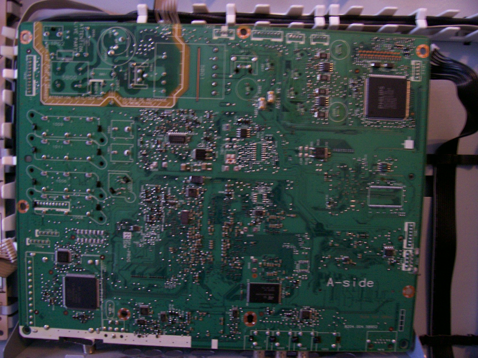

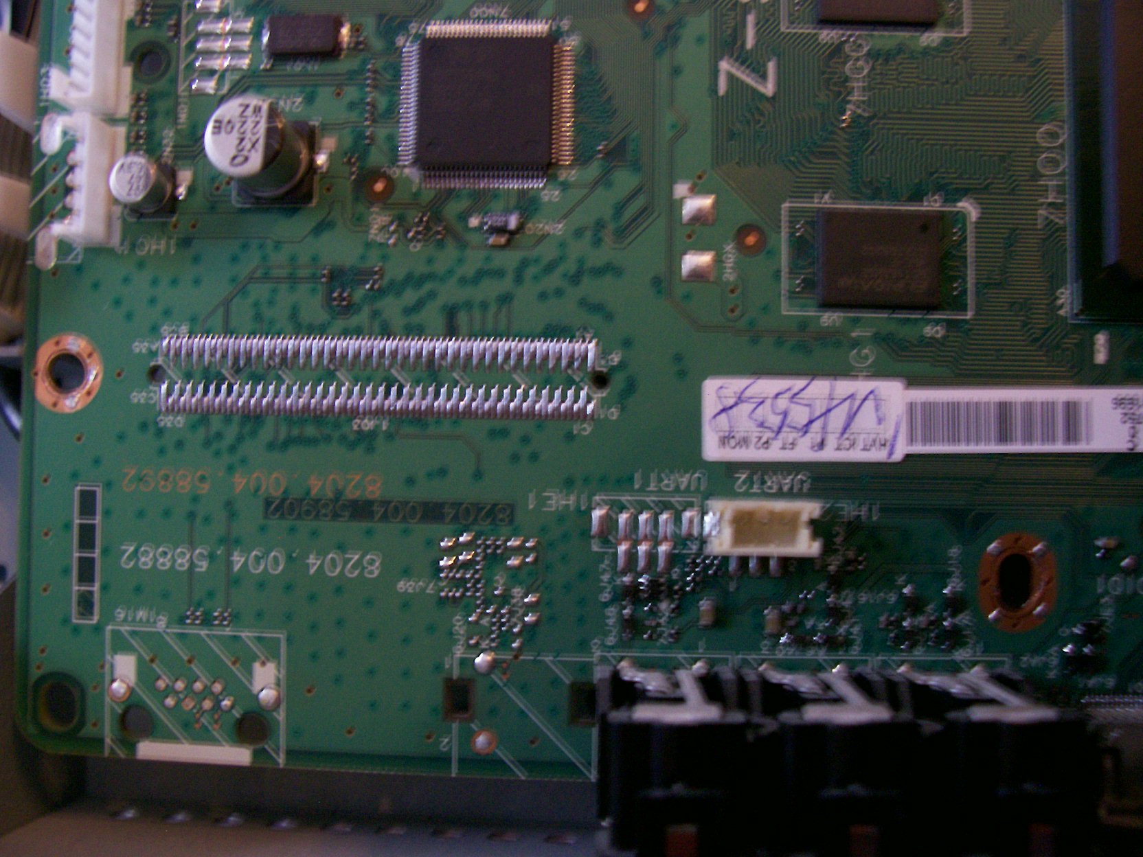

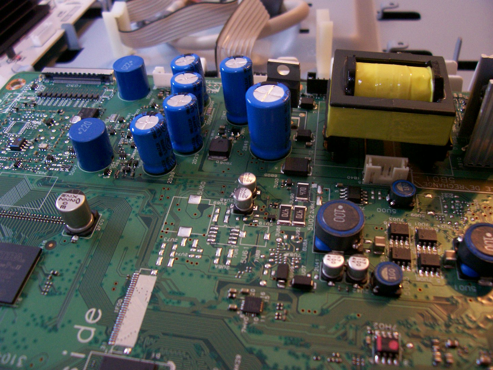

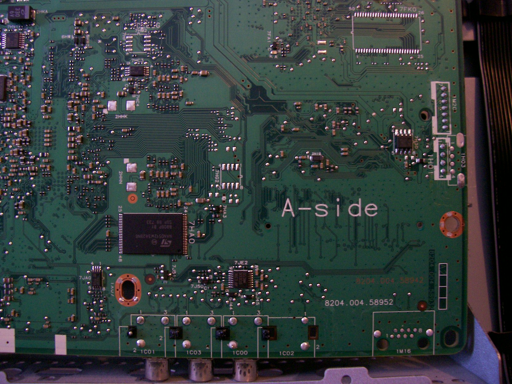

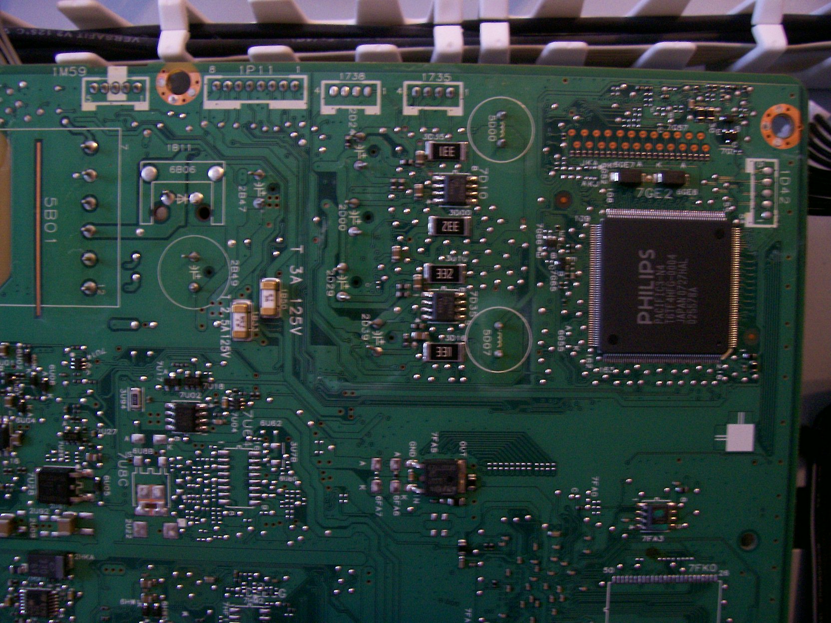

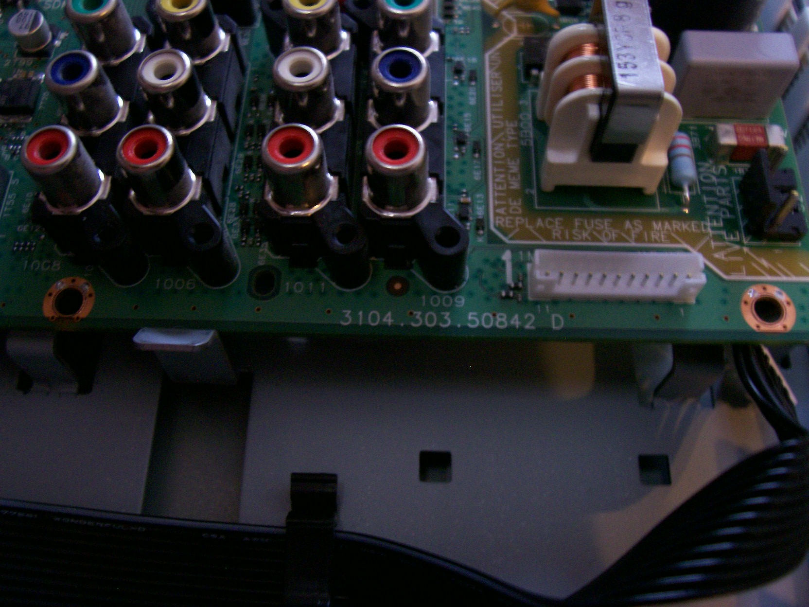

              I have included some pictures of the SSB board if anything is unclear or new pictures are needed please advise and be specific. In particular take a look at “Philips 017” there are five micro leds on the SSB. When the unit powers up, before the fault light begins to flash, three of the five leds light up. Should all five light up or is this normal?
              I checked 1P11 on the SSB I noticed that the 12vDC signal is not responding as expected (pins 4,8), 2.79vDC when the unit is plugged in, then nothing when the unit begins to flash the fault light. So I started checking from the 120vAC at the board and worked my way down stream to the 12v transformer. Im assuming that 5B01 is a transformer. We have 165vDC (is this correct?) between pins 5 and ground but there is no 12vDC signal coming out of it on the secondary side between pins 7 and 8, or 8 and 9. I did not cycle power during the testing phase, does something turn the transformer on during normal operation?
              I could not find a datasheet on the transformer to verify my findings, looks like the model number that I have is BS28603-00. Does anyone have access to component data sheets, or at least one for this transformer? I looked on digikeys website among others and found nil. Is this transformer to blame or are there other underlying issues? Is there a way to test this transformer? This diagram is provided on page 75 of the service manual.
              If anything is unclear feel free to take a look at the notes taken during the testing procedure, they may not be clear but provided myself with information as to not have to repeat my steps and provided me with some degree of sanity. Some things may seem obvious but after reading about faulty power cords, I decided that its better to test too many items than not enough.
              Any input would be appreciated.
              thanks

                Re: Philips 47Pfl7422D/37 blinking 6 then 3
                I've downloaded the Service Manual and have been picking my way through the schematic. Picking may be the wrong term - in some ways it resembles trying to swim in quicksand - a lot of effort, very little progress. I'm still trying to figure out where the Power-OK line originates.
                Aww, crud. Power-OK originates on the power supply!!! I've been chasing around the schematic for the power supply, and finally broke down and read the description. It turns out the 47" power supply is a different unit. Apparently that supply only provides power for the LCD panel and the inverter.
                To make things even more delightful, the SSB has it's own power supply, and that one seems to produce 12V also!!
                I haven't given up yet, but the only suggestion I have at this point is to verify that the 12 Volt supply out of the Panel supply does (or does not) go to 12 volts.

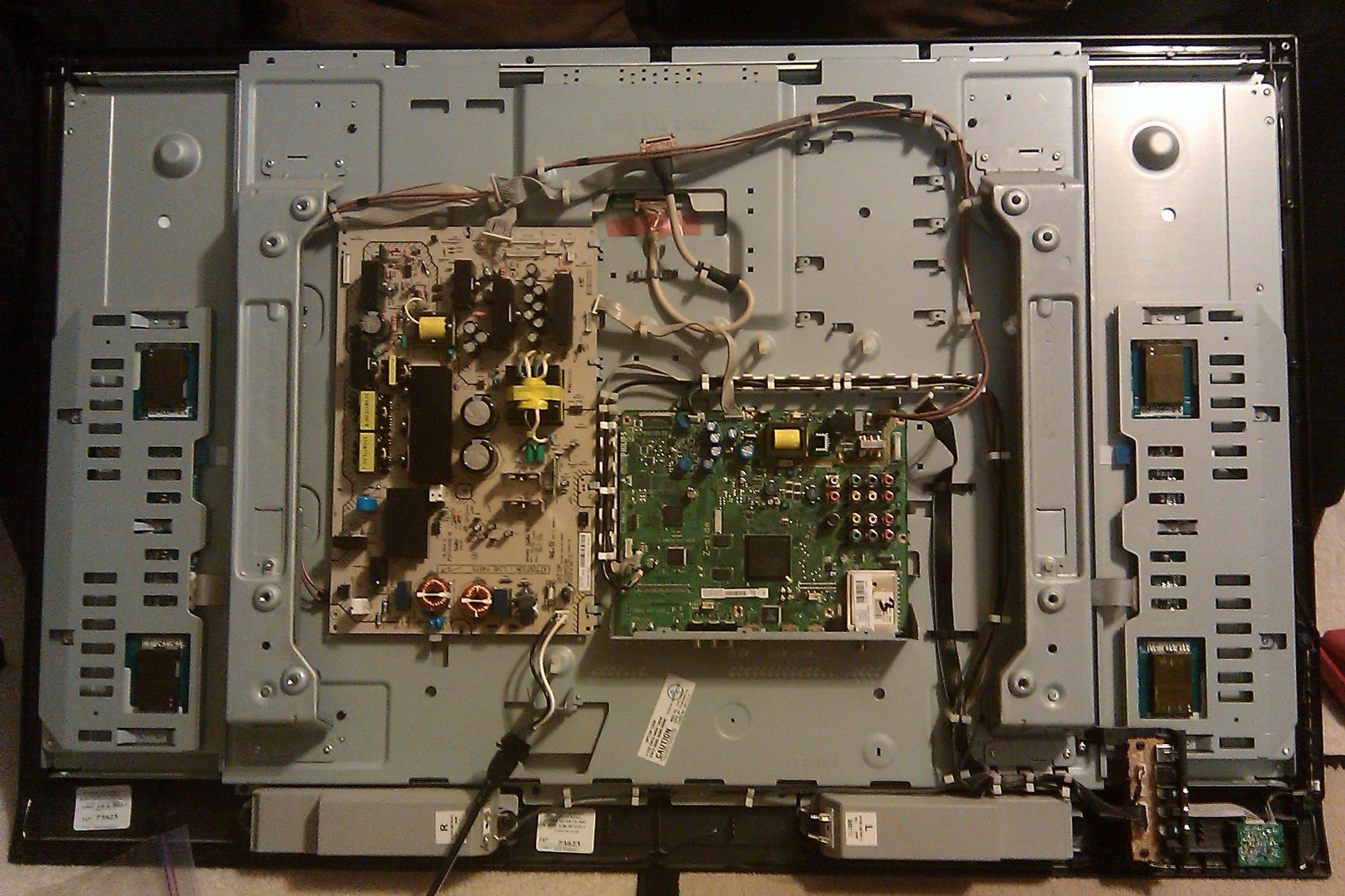

                              • Losdog
                                • Jul 2011
                                • 23
                                Find the service manual on line and read thoroughly.
                                The user manual calls it "display supply".
                                Search for pin 1316 and it will take you right to it.
                                i have uploaded a picture to my album, its the tan board left of center.
                                apparently this unit uses several boards:
                                Inverter
                                SSB
                                Side IO
                                Keyboard control
                                IR/LED/Light Sensor
                                "Display Supply"
                                enjoy
