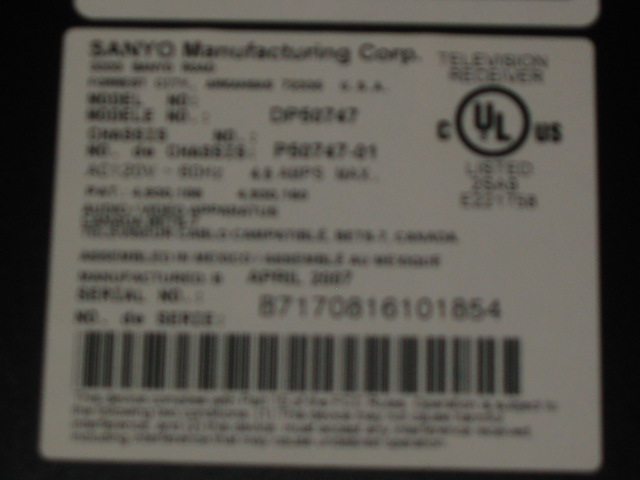

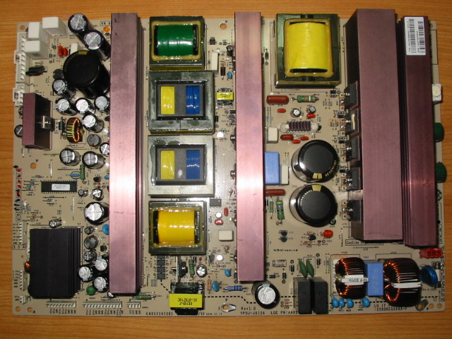

    I'm posting this new thread hoping to see the light after a dark tunnel..!
    This Sanyo TV had a problem with shutting off after a few min. I did a visual inspection on the main P/S and found 9 caps (680mf 10V) bad (the top popped). These were replaced and fixed the original symptoms of shutting the set after a few min.
    We connected the set to the cable box and everything looked fine, except the video started to blink only on HD channels, regular non-HD worked ok. After a few days the video was gone and same with the audio.
    Back on the bench, a visual inspection shows the previously replace caps were fine. Testing the voltages at the connectors low voltages 5v, 3.3v, 24v etc all test fine. The only connector with no voltages is CN206 stencil with Vs, Gnd, and Va. This connector extends over to the left side board; I believe this to be the YSUS board.
    I replace all 6 power MOSFET transistors SD20N60, just a wild shoot on the dark, still no voltage at the Vs and Va connector.
    The PDP Service Manual attached by a member of this board on a differnet thread show Vs to be 188v-198v and Va to be 56v-61v. Without a P/S manual I'm at a lost trying to trace the path for either source.
    The P/S part # stencil are YPSU-J013A and LGE PN:AAX30284301.
    Any help with a P/S service manual or possible solutions is appreciated it.

      By your description of the repair done, you replaced only the visually bad caps. If this is the case, I'd advise to go all the way with the cap replacement. Make sure that these caps are low ESR caps when you order them.

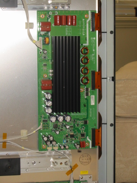

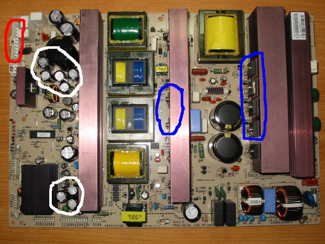

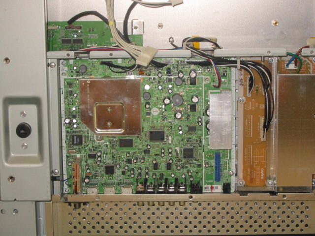

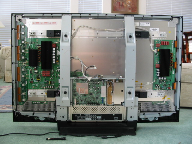

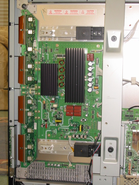

        I'm attaching several shoots of the rear as you requested. The P/S is missing from these pictures as I have it on the work bench, so a separate snapshoot is included.
        The YSUS is listed as LGE PN:EAX34151601 Rev C and the ZSUS is listed as LGE PN:EAX34151801 Rev B.
        I circled the items replaced on the P/S, the blue circles shows the MOSFET replace all are the same , the white circles shows the replace set of caps, and the red circle shows the CN206 with Vs and Va stencils.
        Hope this helps...!
        Dgtech,
        The P/S caps were replaced with same specs as the previous ones. I made a small error these are 3300nf @ 10V, not 680mf @ 10V on my initial post.

          That's definitely an LG design, but not one I'm familiar with.
          3300 nanofarads??

            3300 nanofarads??
            PlainBill
            Oops typo 3300mf...!

              If I were you, I'd finish replacing the rest of the caps. If you found 9 visually bad, I would think that all are either bad or close to it. They can be bad without being visually bad. If you go forward troubleshooting without clearing the obvious possible solution first, you'll end up spinning your wheels.

                    That is a power supply or main board problem. I Googled DP50747 schematic and got hits from the usual (pay) sites. One may be available at keepandshare.com; something about the site rang my alarm bells. Use your own judgement.
                    Other than that, I suggest the usual procedure. If the output voltages of the power supply are labeled, verify all the voltage, especially those below 20 volts. Several repair services for the power supply are on eBay, that would tend to indicate a power supply problem.

                          I have a quick ? for the 680uf under the bank of 3300uf's on the right side. I got a replacement today for the 680uf. The old one has the silver strip with a "-_ign. The new replacement has the silver strip with an "0" sign. Are they the same or is it positive and negitive?
                          • dumpystig
                            • Jul 2011
                            • 485
                            Re: Sanyo DP50747-01 no video or sound??
                            The 'silver line' is always negative (-) on an electrolytic. And elctrolytics are polarised so should be connected correctly in circuit.

                                  We have TV! But im back to square one because im still waiting for the 3300uf and a 1000uf. But i can watch TV until they get here.

                                    OK folks,
                                    I’m re-opening my thread once again after further troubleshooting.
                                    So far I had the P/S repair and all seems to be ok, however one note on the voltages from my previous post.
                                    The Va and Vs (57V and 190V) are now present if the P/S connector P800 (AC-O, RL-ON, 5V sb, DET, Vs-on, 5V-D and GND) which goes to the Main Board @ K6P is removed. If the connector is in place after powering the set the Vs and Va drop down to about 1.5V.
                                    In reading other threads on this model the indication on the Ctrl board LEDs for a working set should be D2-D5=off D3-D4=on. However my Ctrl board has D2=off and D3-D5=on.
                                    Logic dictates there could be a problem with the Main board may be shorting/disabling the Vs-on pin back to the P/S, but with D5=on it could well be the Ctrl board too?
                                    What fault would a D5=on represent?
                                    Any suggestions?
