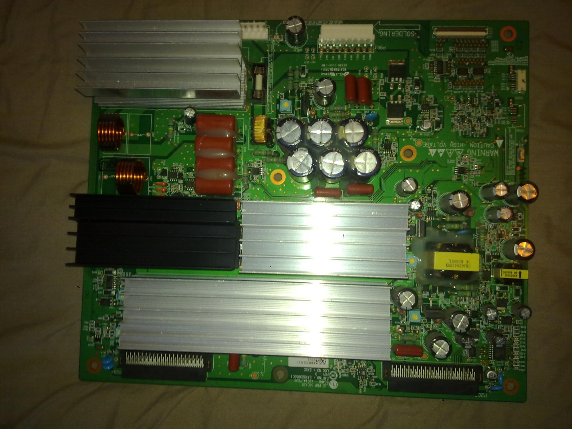

    Newbie to this and have been doing alot of reading.
    Have the above named PDP42G1 panel which is not showing any picture.
    Check the Va and VS and they are correct from the power supply board.
    When the unit starts up the YSUS and ZSUS boards sound like they are "priming" as in they humm, quiet loudly actaully.
    Nothing on the screen and nothing when shining a light on it. ZSUS is feed from the YSUS board.
    Checked the VSETUP/-VG as labelled on the board and it looks as if there is something wrong there, but i dont know what the expected values are:
    On the panel it has:
    -187/140/NA/100
    but im not sure which values correspond to which. My readings are:
    VZ=81v
    VSC=2.1v
    -VG=nothing
    Should I be looking at the YSUS board or maybe the controller board not giving the signals to prime the YSUS --> ZSUS up properly??
    Any help appreciated.

    Re: LG PDP42G1 panel help
    Vz is a little low but that would not cause the problem. I am assuming -Vg is supposed to be -187V and Vsc is 140V. The fact that they are reading so low leads me to believe that there is a problem on the Y-sustain or shorted buffers.

      I disconnected the ZSUS for testing, just in case it was something down line that was drawing current.
      All the main transistors test fine and there is no visual issues with the buffers I can see. What area of the YSUS should I be looking at next?? For the guys who do component level repair to the YSUS boards, what normally fails?
        On any Y-sustain it is usually mosfets and diodes that fail. Pictures of the boards would help without them there is nothing more I can suggest.
          I have attached a pic of the board. I have checked the FETS and they all seem to be fine after comparing same FET and thier readings.
          Checked the most obvious diodes, but many cannot be accessed unless the heatsinks come off.
            Yeah it is possible and very likely that there may be shorted FETs under those heatsinks. It would be necessary to take them off and test the components underneath.
              So i pulled some of the FETs off to test independant of the board. Found that i have two 45F122 which give different readings. Now is there a special way to test these FETS??? Should I be expecting a single junction only?
                    It's an IGBT if that helps. Toshiba GT45F122
                    This video helped me test my 45G128 http://www.youtube.com/watch?v=AfV7gYChILc
                            Originally posted by tom66
                            Can you tell us what the failure was, for future reference?
                            Yes, tom.
                            The failure was on the controller board. IC201 was not driving YSUS board properly, hence the voltage drop on VZ which was measured at about 80V. Factory value is 100V !
                            On the top right of the controller board, there are some status LEDs. If
                            the board is working, at least LED D103 should light up.
                            Hope this helps...
