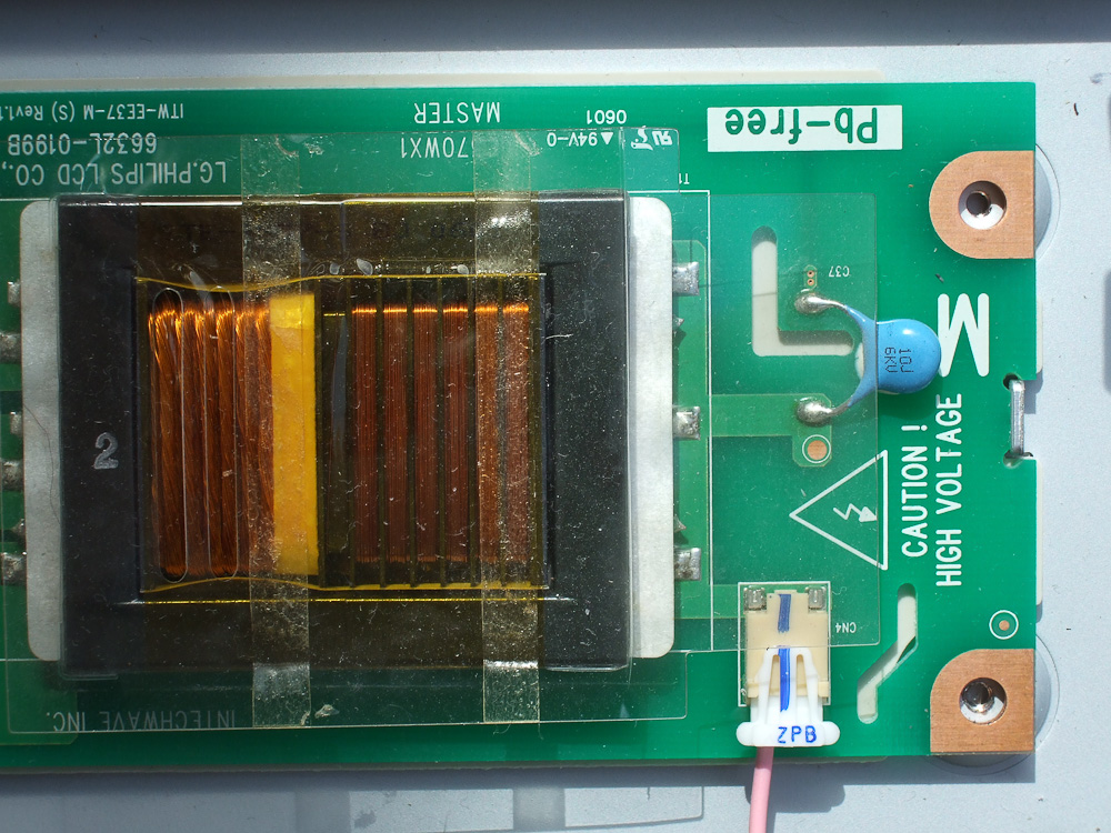

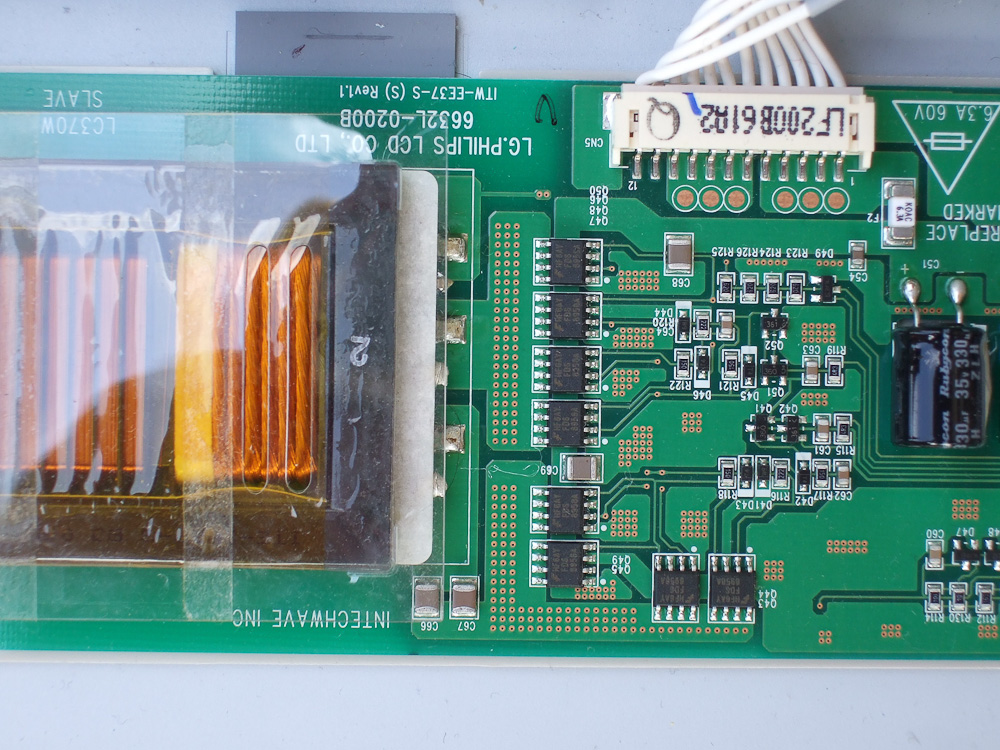

                Also, could you post some real close up pics of each inverter board. This could be done in sections. The only reason I continue on with the inverter boards is cause I've had more failures with them than I have with power boards on Philips, LG, Vizio, and Magnavox TV's.

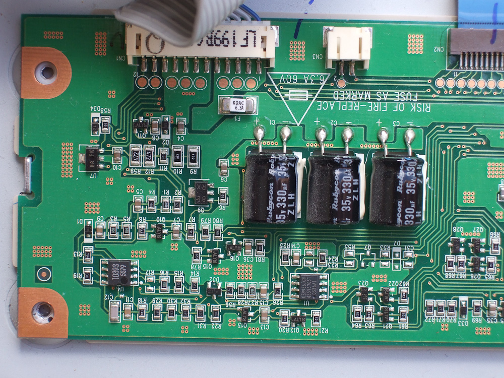

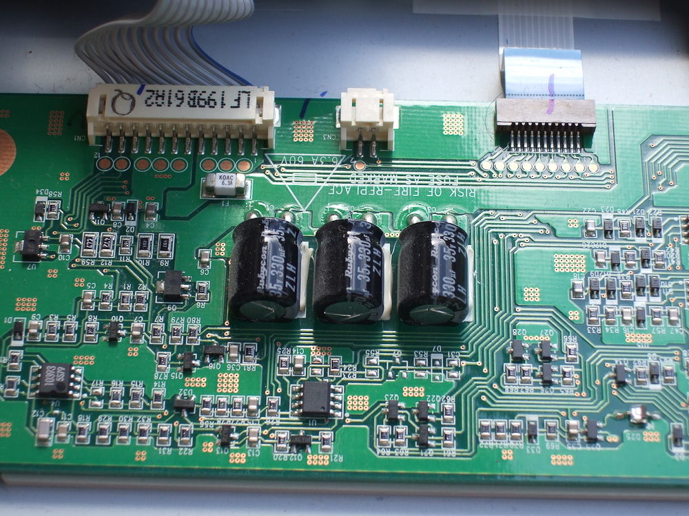

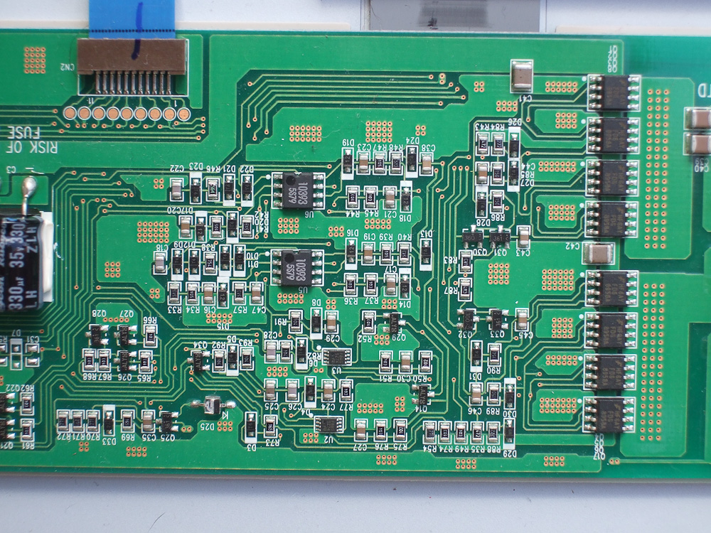

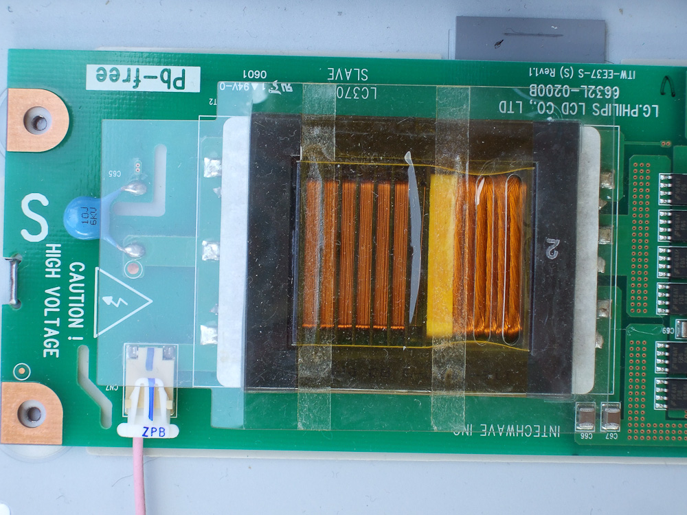

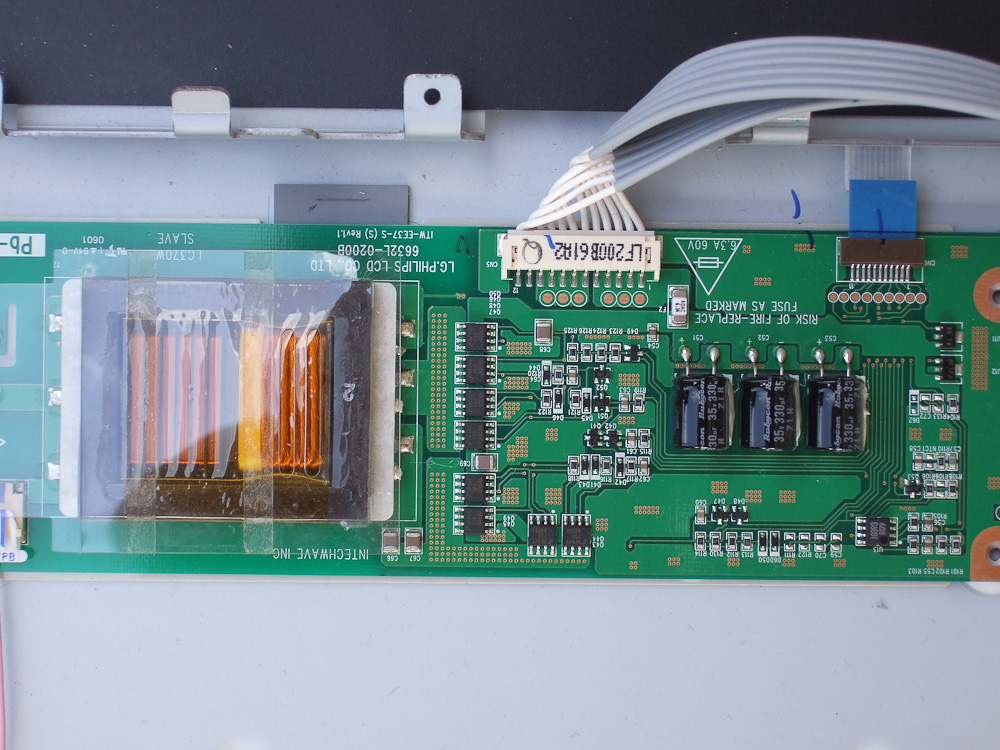

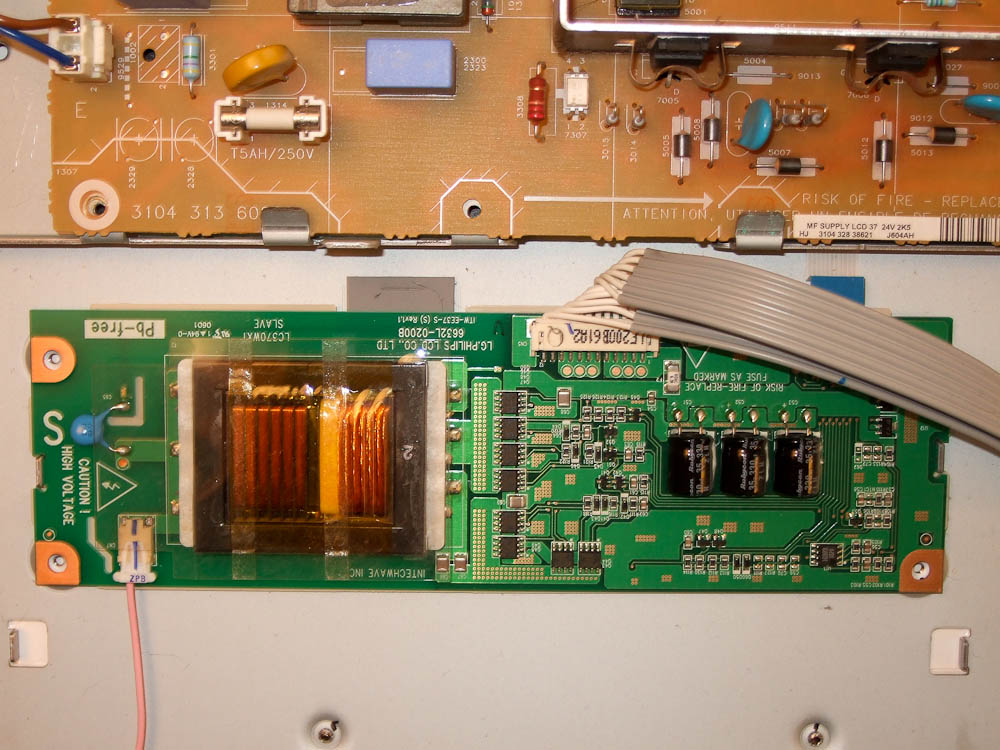

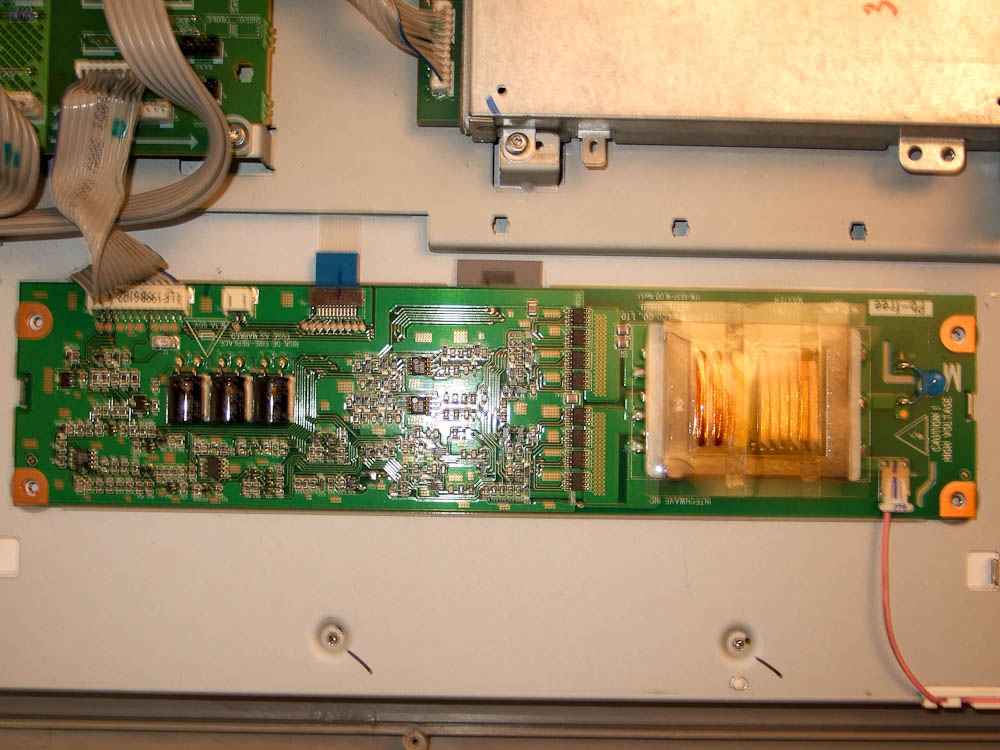

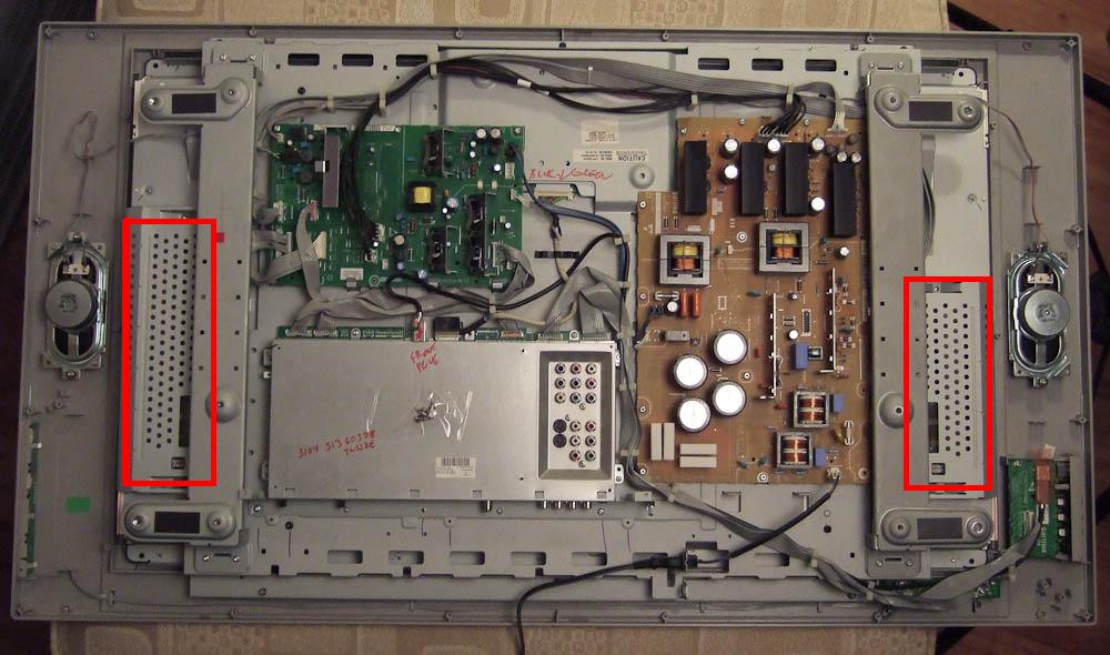

                  • RobPhotoPro
                    Learning Fast
                    • Jun 2011
                    • 34
                    Re: Fixing Phillips LCD TV 37PF7320A

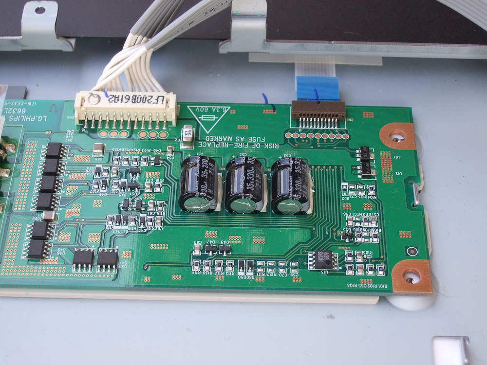

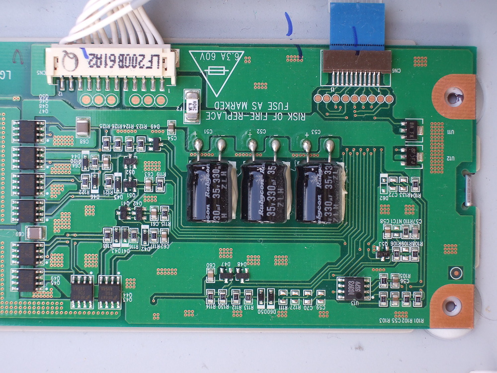

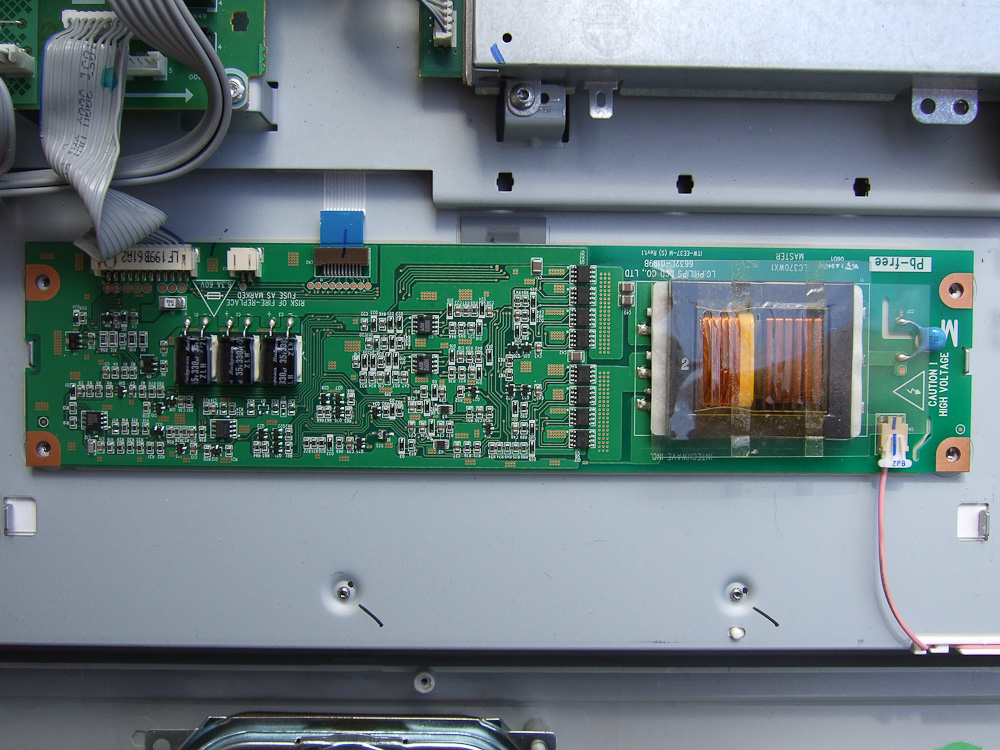

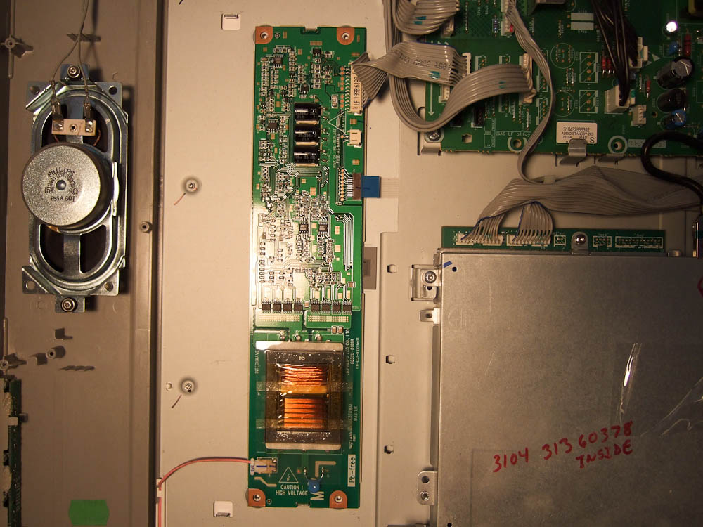

                    Here are the detailed shots of both inverter boards. First five images is the main inverter board, the other five images is the slave board.
                    Thanks!
                    • PlainBill
                      • Feb 2009
                      • 7034
                      Originally posted by RobPhotoPro
                      I was wondering, when I disconnect one or both inverters, the TV has the same symptoms. Doesn't it mean, the problem is in the power supply board?
                      Thanks a lot!
                      No, it means the problem is NOT in the inverters. An inverter fault would either be ignored by the main board, or reported as an error - a flashing LED.
                      Step 1 is to check the output voltages of the power supply.
                      Step 2 is to isolate the BL_ON (or equivalent) signal to the inverter and turn the backlights on manually.
                      Step 3 is to check the voltages on the main board.

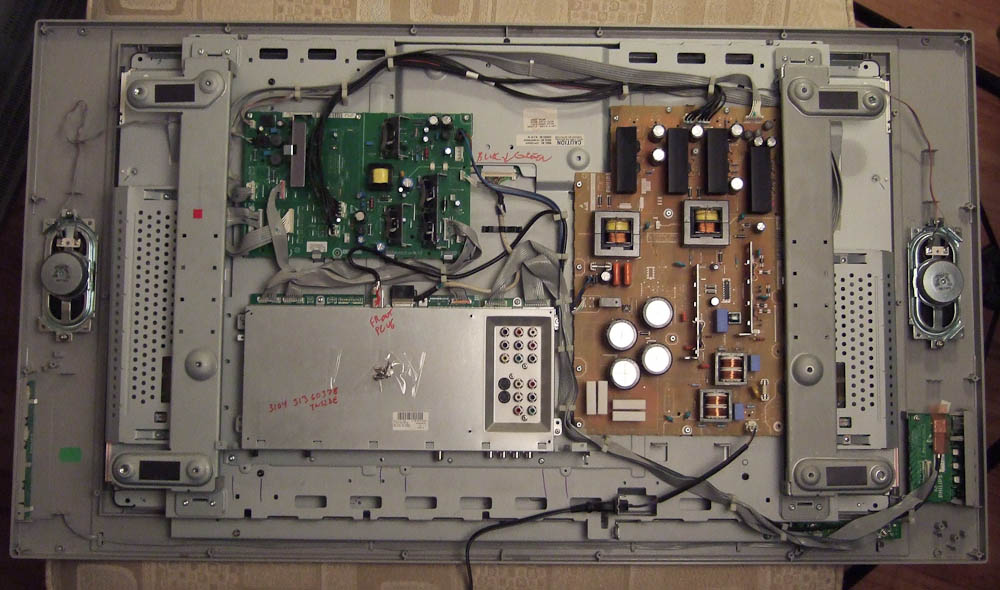

                              1. All output pins (It may be easier to check the power supply inputs of the various boards. They should be easy to identify them on the schematic).
                              2. Pins 11 & 12 on the larger input connector are On / Off and Brightness. Measureing the voltages can give a clue as to which is which. (The On/Off will usually be at 3.3 volts to turn the backlights on.) Possible ways to isolate the control line include removing the wire from the connector, cutting the wore in the ribbon cable. The first attempt should be trying to pull it high by using a 1K resistor to 3.3V.
                              3. The main board is the one inside the metal shield.

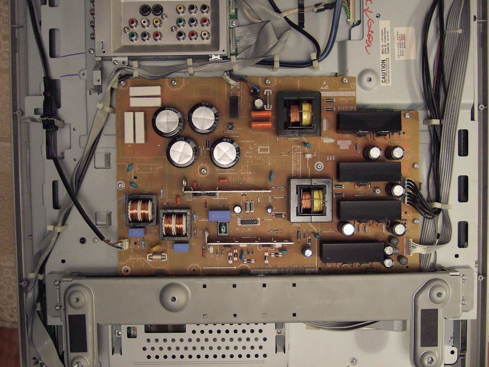

                              • RobPhotoPro
                                Learning Fast
                                • Jun 2011
                                • 34

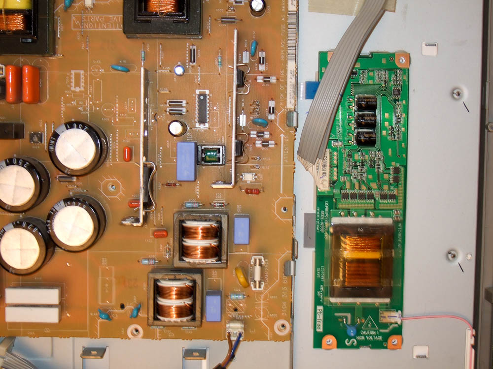

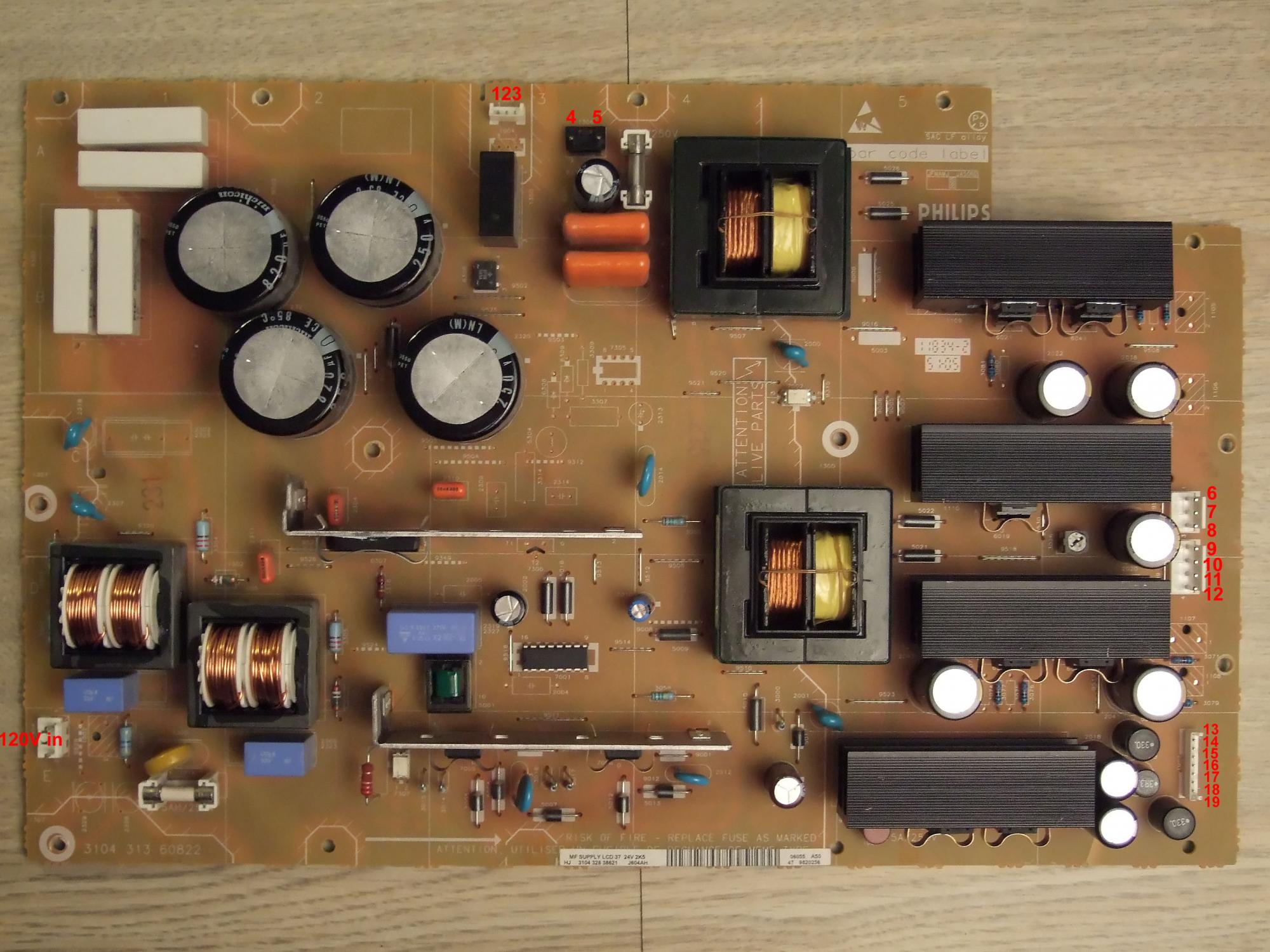

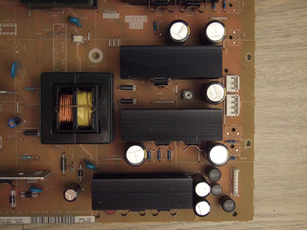

                                Okay, this is step 1 - Voltages on Power Supply Board
                                I numbered pins in the picture attached and the voltages are in Volts (Standby/PwrOn):
                                pin1 - 5.2/0.29
                                pin2 - 5.2/5.2
                                pin3 - 5.2/5.2
                                pin4 - -75/-75
                                pin5 - 75/75
                                pin6 - 0/0
                                pin7 - 0/0
                                pin8 - 0/0
                                pin9 - 0/24
                                pin10 - 0/24
                                pin11 - 0/11.8
                                pin12 - 0/11.8
                                pin13 - 0/0
                                pin14 - 0/18
                                pin15 - 0/18
                                pin16 - 0/0
                                pin17 - 0/0
                                pin18 - -0.5/-18
                                pin19 - -0.5/-18
                                Any suggestions?
                                Thank you!
                                • PlainBill
                                  • Feb 2009
                                  • 7034
                                  pin1 - 5.2/0.29
                                  pin2 - 5.2/5.2
                                  pin3 - 5.2/5.2
                                  pin4 - -75/-75
                                  pin5 - 75/75
                                  pin6 - 0/0
                                  pin7 - 0/0
                                  pin8 - 0/0
                                  pin9 - 0/24
                                  pin10 - 0/24
                                  pin11 - 0/11.8
                                  pin12 - 0/11.8
                                  pin13 - 0/0
                                  pin14 - 0/18
                                  pin15 - 0/18
                                  pin16 - 0/0
                                  pin17 - 0/0
                                  pin18 - -0.5/-18
                                  pin19 - -0.5/-18
                                  Any suggestions?
                                  Thank you!
                                  Let's try to identify the functions...
                                  On / Off and power to the power relay
                                  pin1 - 5.2/0.29
                                  pin2 - 5.2/5.2
                                  pin3 - 5.2/5.2
                                  Power to the auxiliary power supply.
                                  pin4 - -75/-75
                                  pin5 - 75/75
                                  Ground
                                  pin6 - 0/0
                                  pin7 - 0/0
                                  pin8 - 0/0
                                  Inverter power
                                  pin9 - 0/24
                                  pin10 - 0/24
                                  Main power
                                  pin11 - 0/11.8
                                  pin12 - 0/11.8
                                  Almost certainly power for audio amp.
                                  pin13 - 0/0
                                  pin14 - 0/18
                                  pin15 - 0/18
                                  pin16 - 0/0
                                  pin17 - 0/0
                                  pin18 - -0.5/-18
                                  pin19 - -0.5/-18
                                  Shoot, this thing has an auxiliary power supply. OK, I've seen that before. This is a more modern version of an LCD TV I repaired a few years ago. It gave me fits.
                                  I'd say the best way to move forward on this is to see if the BL_ON and brightness change when the TV is turned on. I would have to dig through the schematics and identify the signal path through the auxiliary power supply. And there are several other projects waiting for my attention.
                                  PlainBill

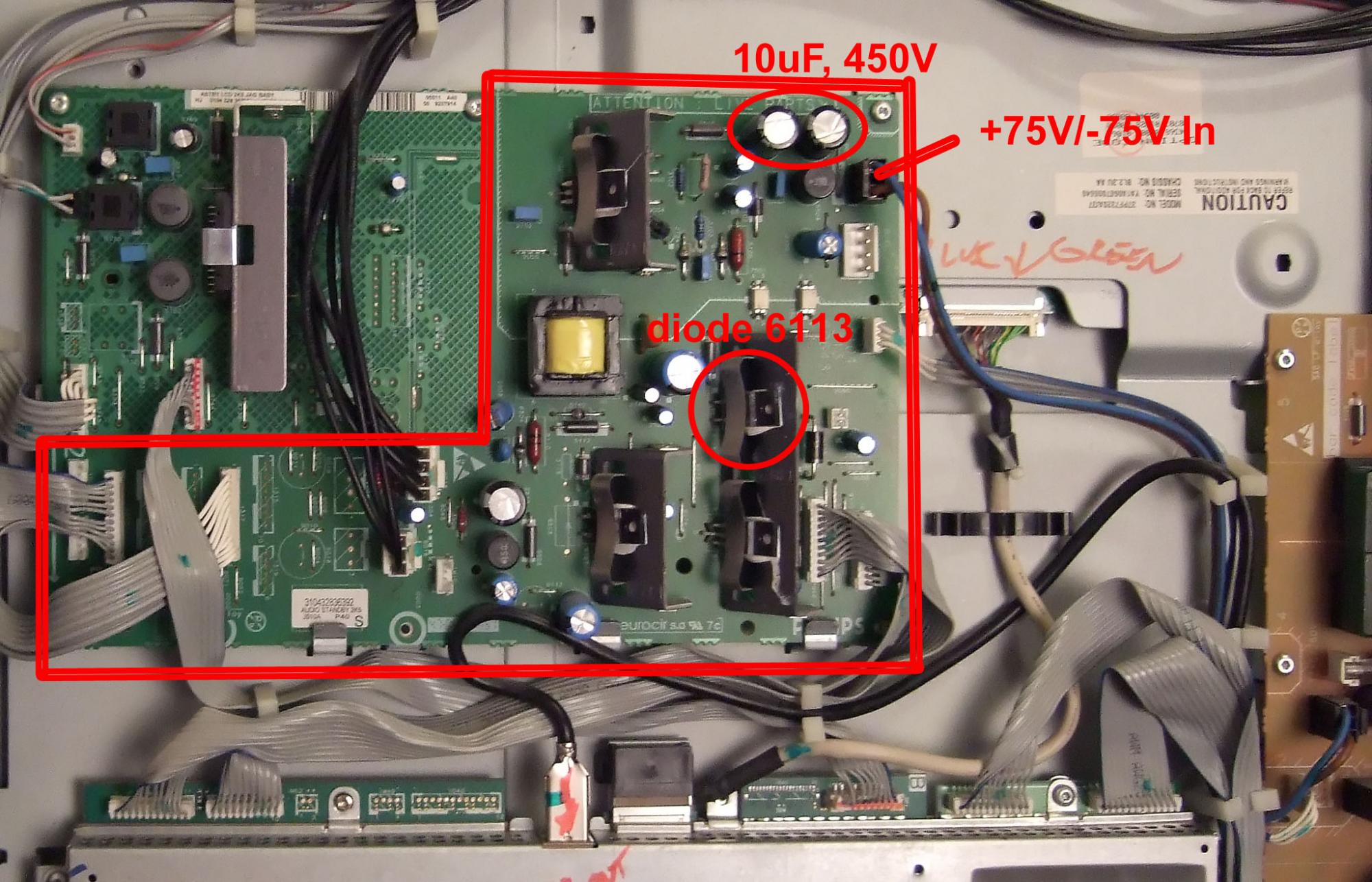

                                    • RobPhotoPro
                                      Learning Fast
                                      • Jun 2011
                                      • 34

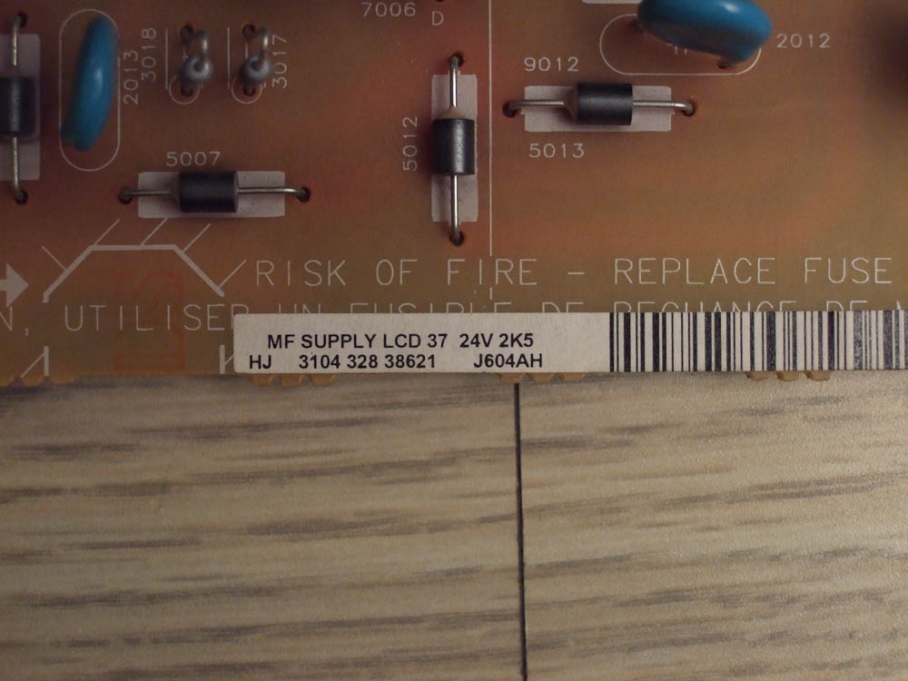

                                      I attached an image with what I think is the aux power supply. I circled two possible faulty components - 10uF, 450V capacitors and a diode (6113). I measured the diode using ohmmeter and it reads 0, like it's shorted.
                                      Please let me know your thoughts.
                                      Thanks a lot!
                                      Rob
                                      • PlainBill
                                        • Feb 2009
                                        • 7034
                                        Thanks a lot!
                                        Rob
                                        1. I'm not sure you need my assistance, you are doing well on your own.
                                        2. $%#%@$@!! That looks like the same secondary supply that was used in the TV I repaired. The schematic was a mess!!!
                                        3. Check the diode out of circuit, but a shorted power diode could easily cause the problem.
                                        PlainBill
