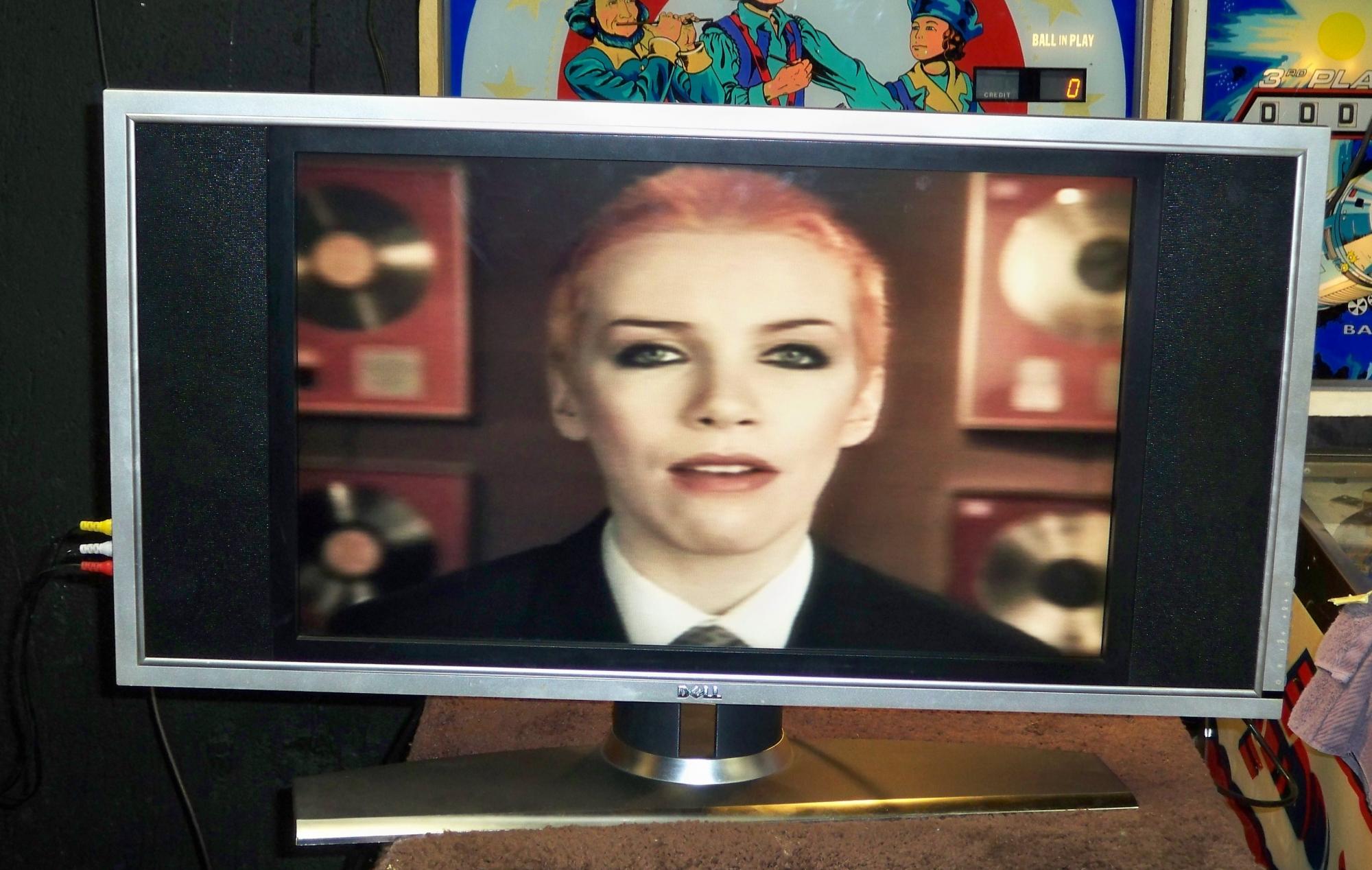

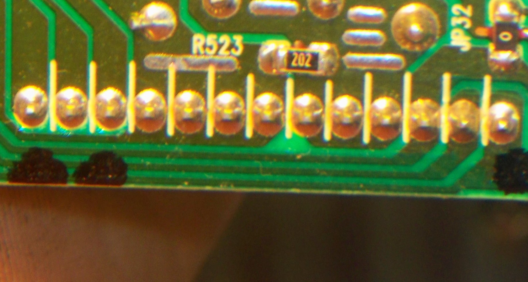

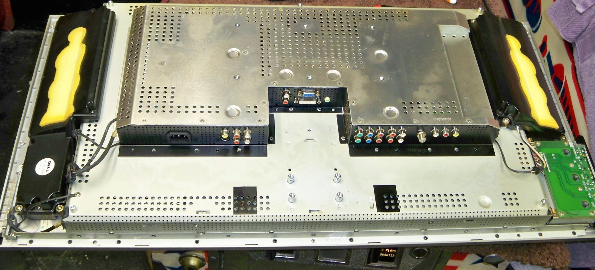

    Picked this up tonight. WIll be pulling it apart tonight. FOrmer owner says the tv has become fussy, sometimes will not power on. Once attemped to power on several times sometimes it will power on. Once on, it stays on..
    I suspect caps or something but will see tonight. SO far ive been running it tonight and its been happy.. The guy said this was a 46" LOL NOT!!
  • cadillacman
    • Feb 2011
    • 524
    Re: dell w2600 power issues
    ***OOPS THIS IS A W2700 ****

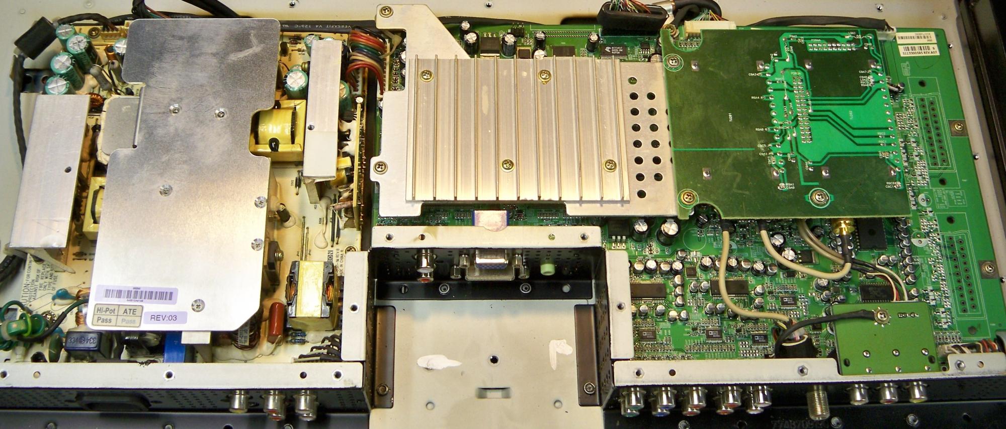

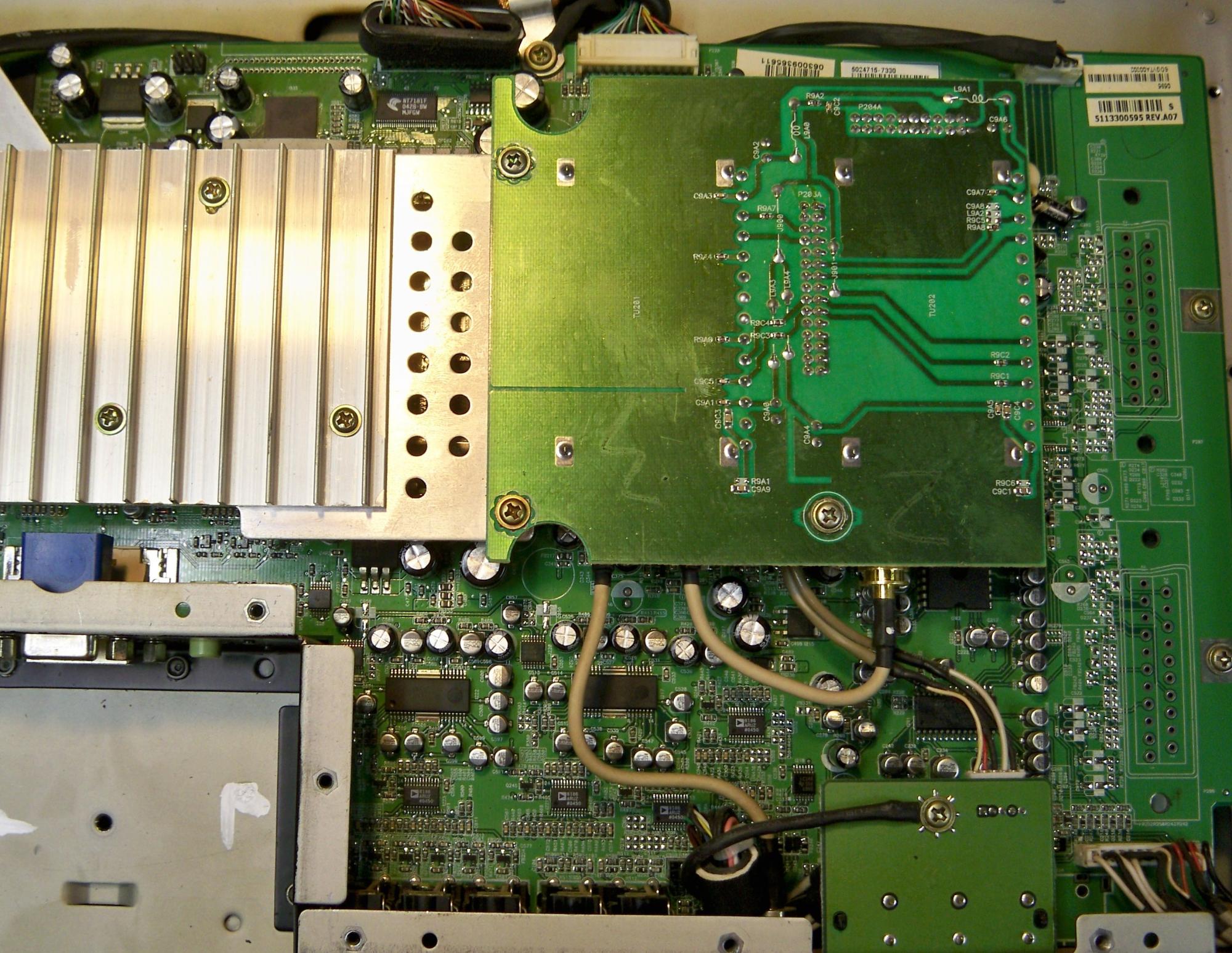

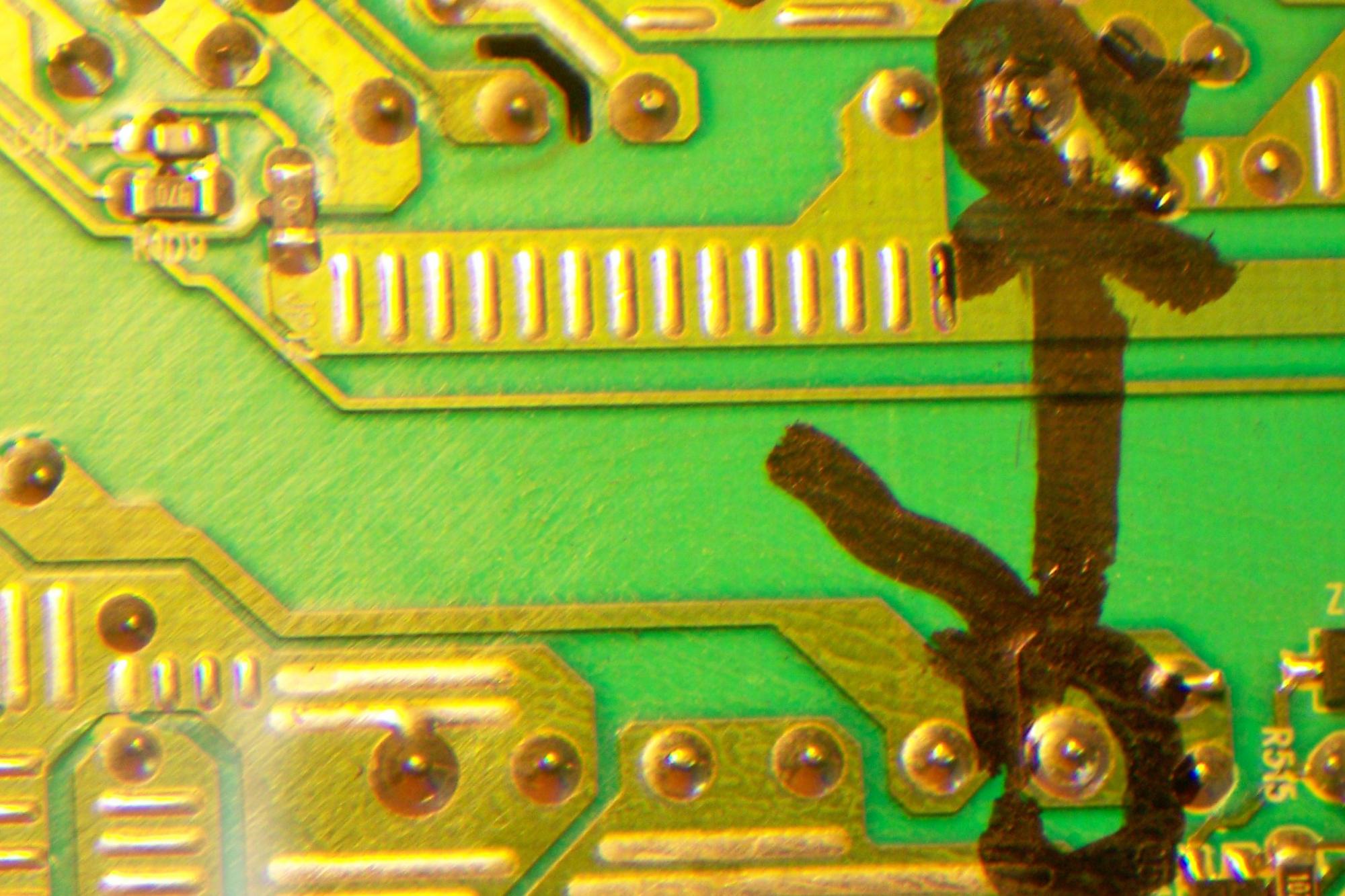

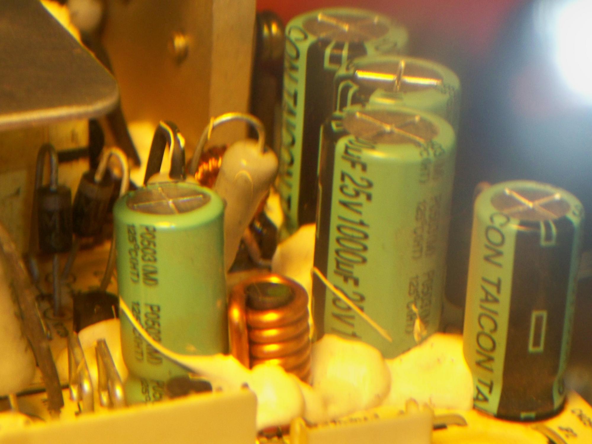

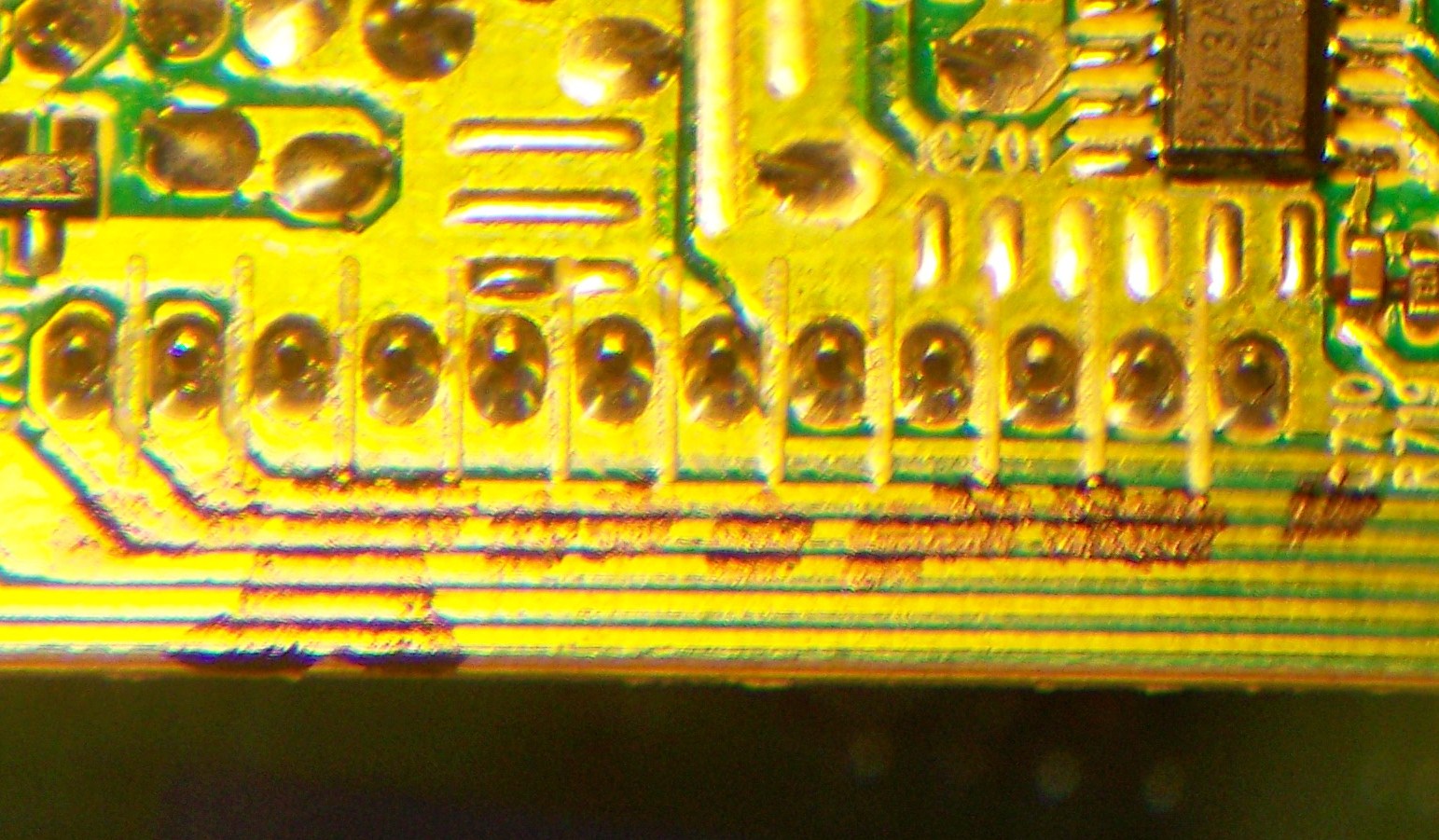

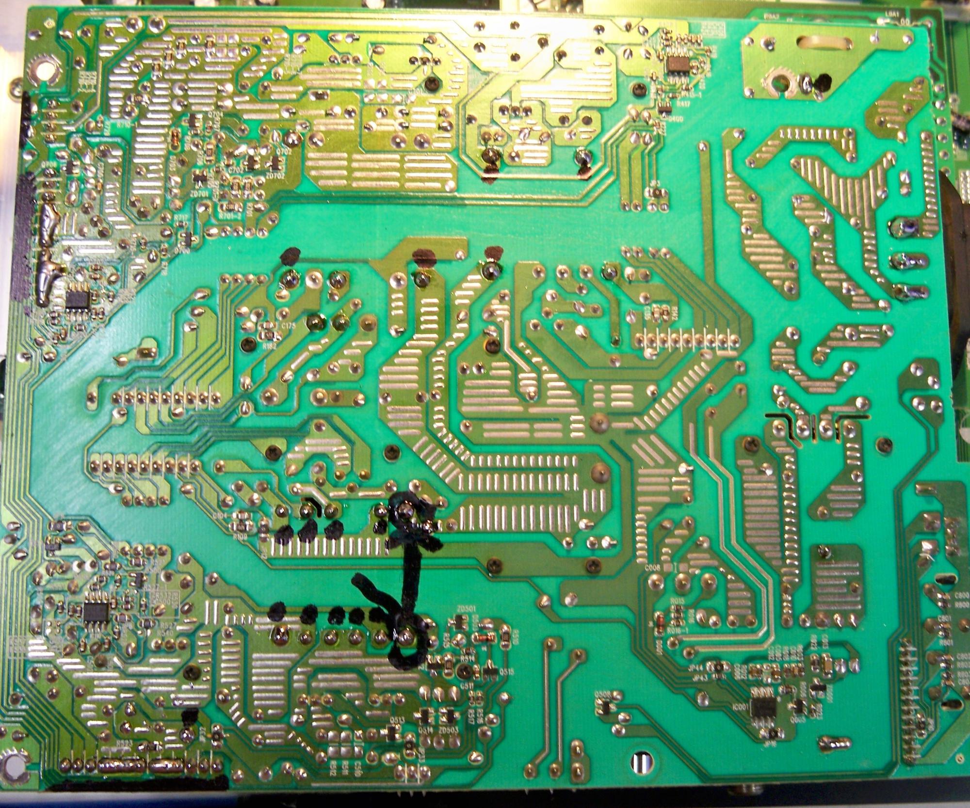

    Ok this ones fixed. I wish they were all this easy. I powered it on, and after pulling covers of course started gently wiggling connectors. When i touched the connector for the "power cable" that goes from the power supply to the mainboard, the tv shut down. I pulled the ps. TONS of cold cracked solder joints. Most prevelant at the header pins for the connectors(all of them) but also found cold solder joints at the transformer joints, as well as other random places. Reflowed it all and so far its happy. Try as i might, i cant get it to break now so im pretty sure i got it.
    heres some pics. black spots are permnant marker, so in the last pic with everything reflowed you can see where most of the bad joints were.. I should also note that i used some old cap lead and bridged the header pins togther wherver they shared a common trace. THis helps improve durability, they are less likely to develop cold solder joints again in the future.

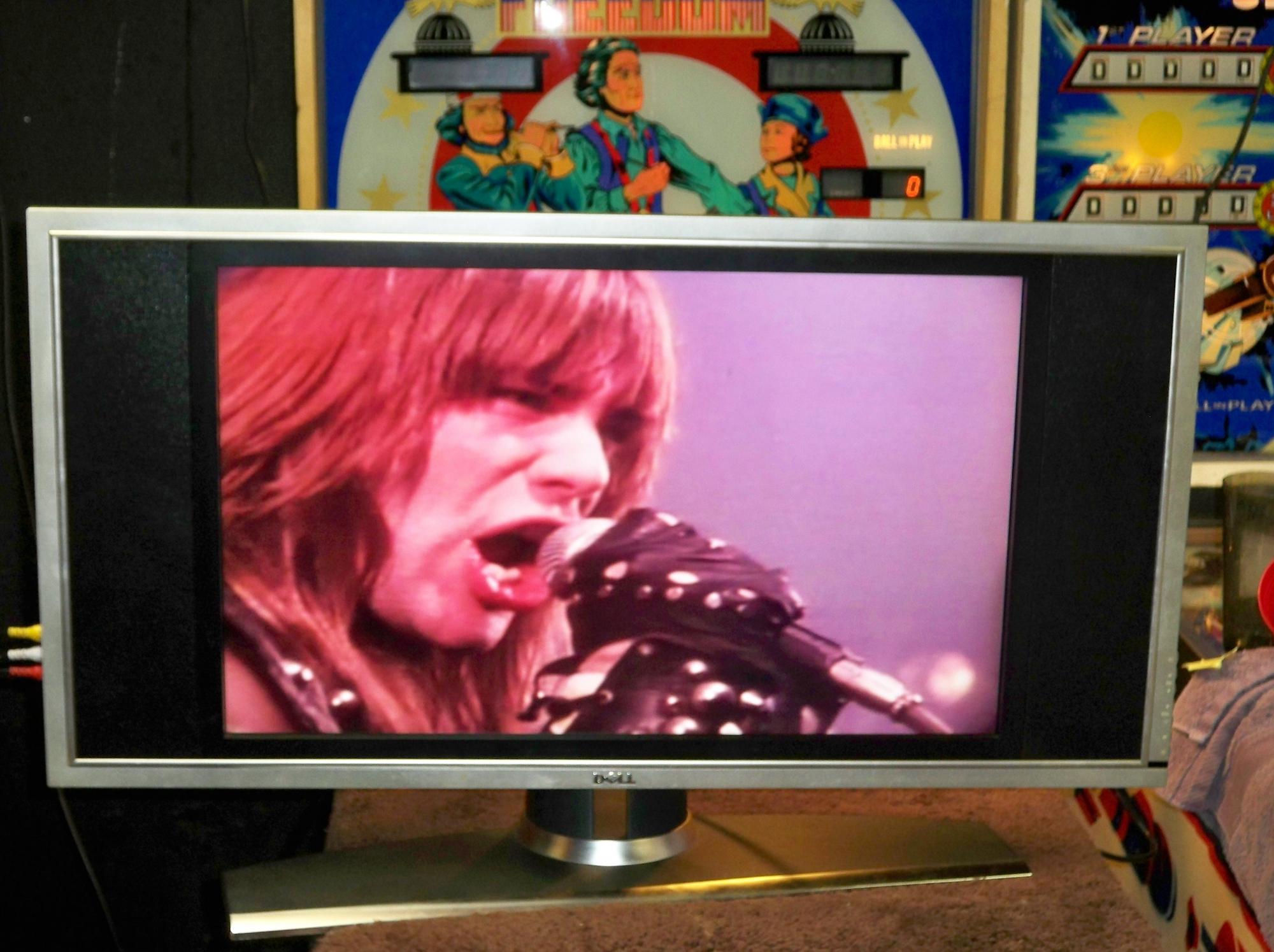

      THis has been my personal tv since repairs.. Still going strong. My 2 year old son powers it on and down at least 20 times a day lol so im also getting some power cycles in.. Im calling this good. I wish they were all this ez to fix.

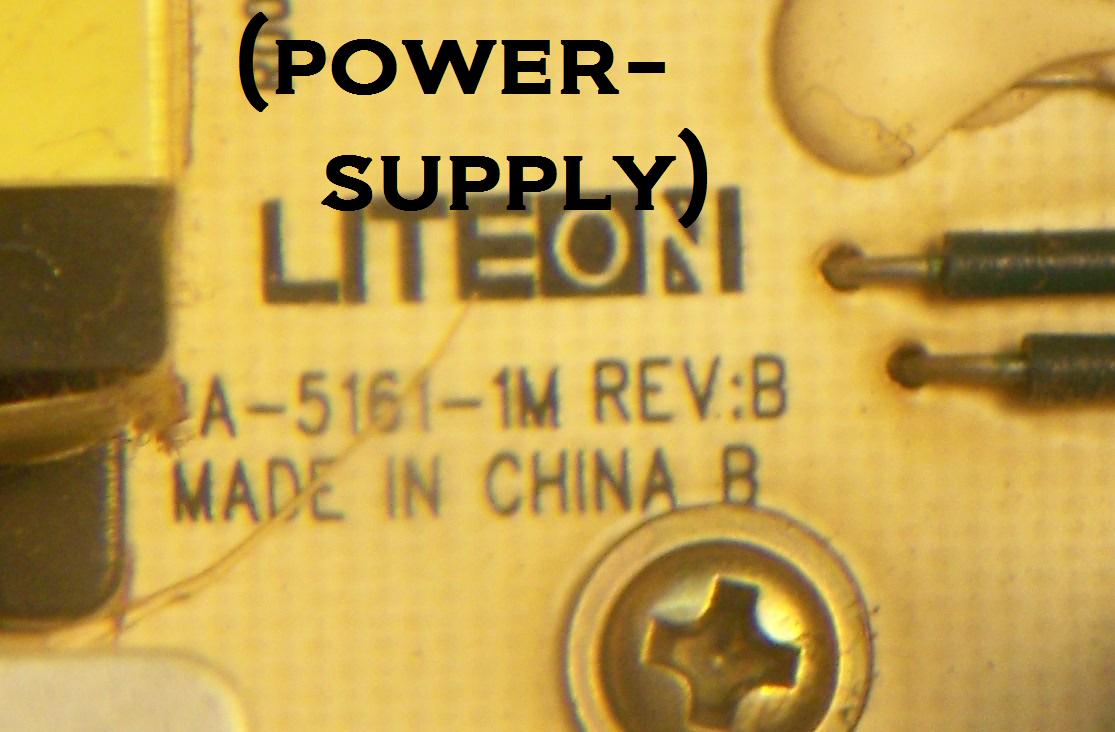

        Congrats on the fix!
        All of the Lite-ON power supplies I've worked on or opened have always used lead-free solder and the soldering never looked good. Even their early power supplies from the Pentium-II days seem to use lead-free solder.
        Probably explains the cold solder joints you got.

            I would not really say lead free solder is the same as getting low quality joints. We have used lead free from when the regulations told us to and if the soldering profiles are followed, which generally means you'll had to boost the temperature somewhat during the soldering process, you'll get high quality joints, just like the good old days with lead.
            So I believe the crappy quality in the Lite-ON psu's is more or less the result of other factors in the process, but doing good lead-free soldering work is harder than with lead, that's for sure.
