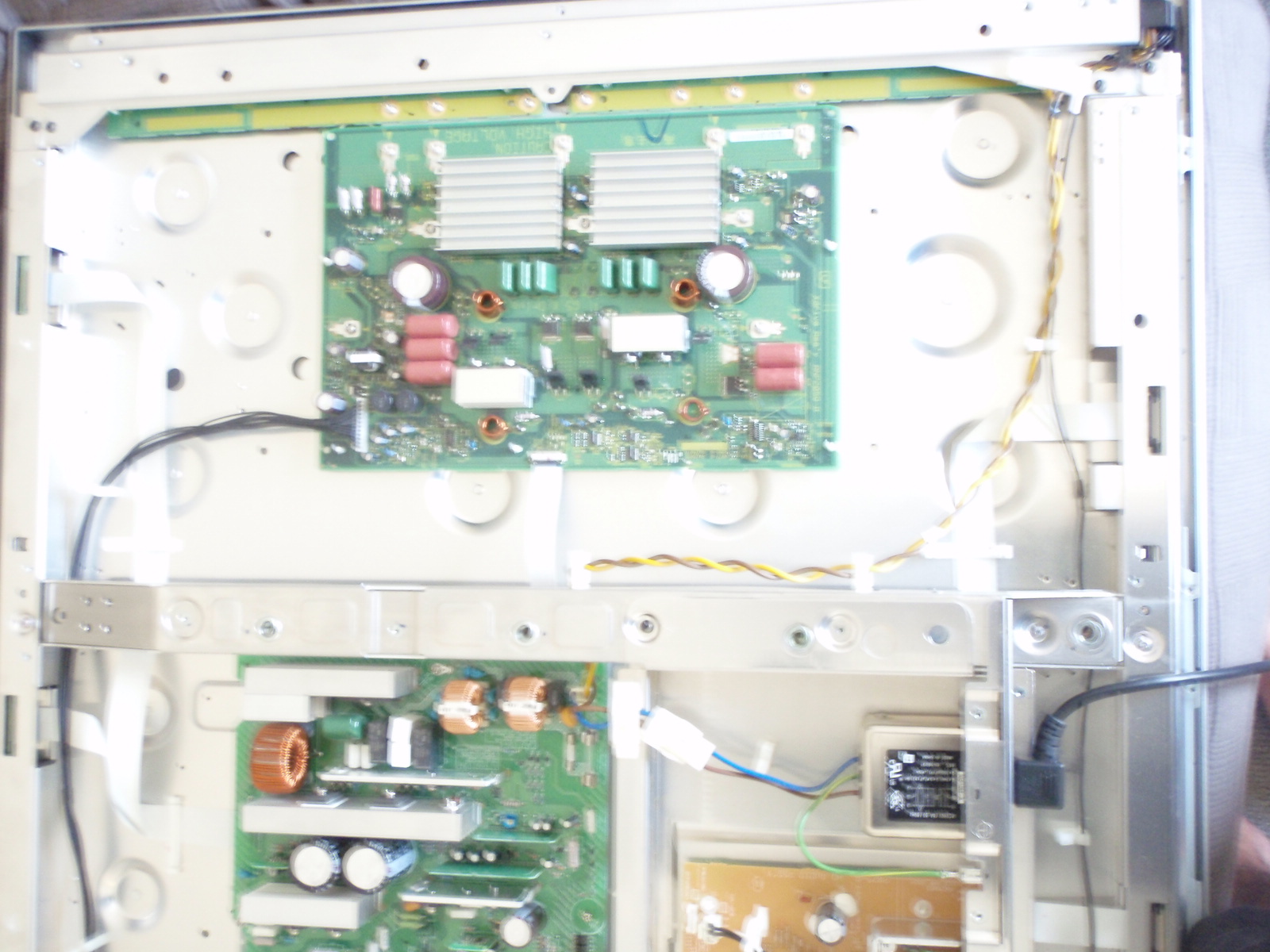

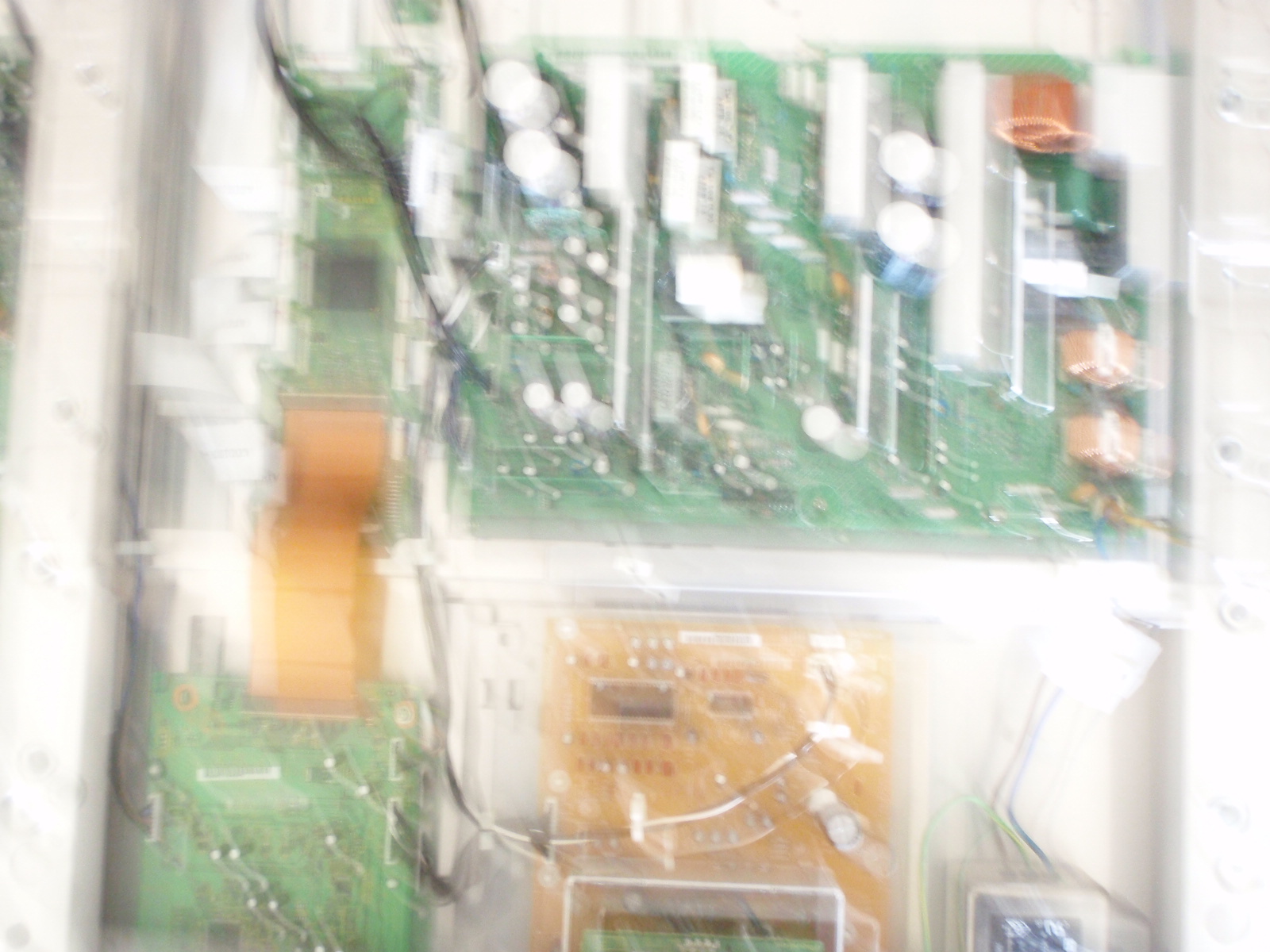

      • confusedall
        • Jun 2011
        • 19

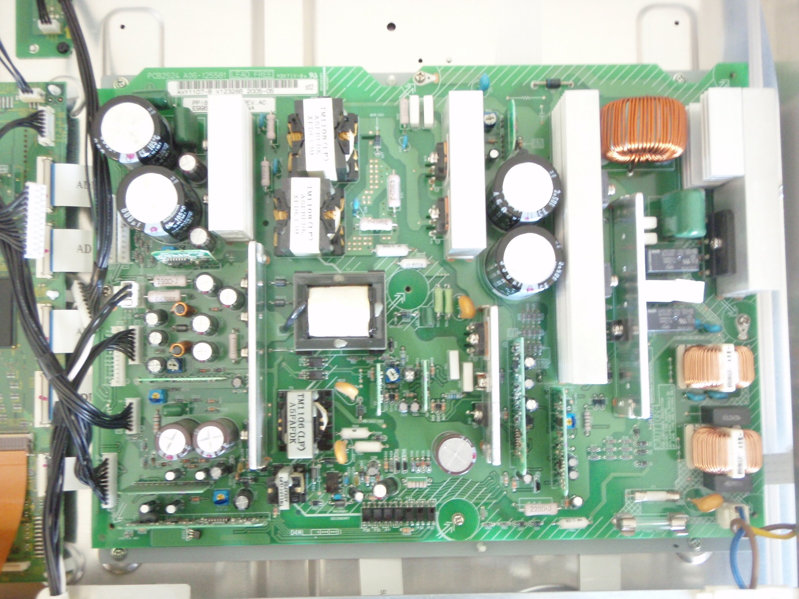

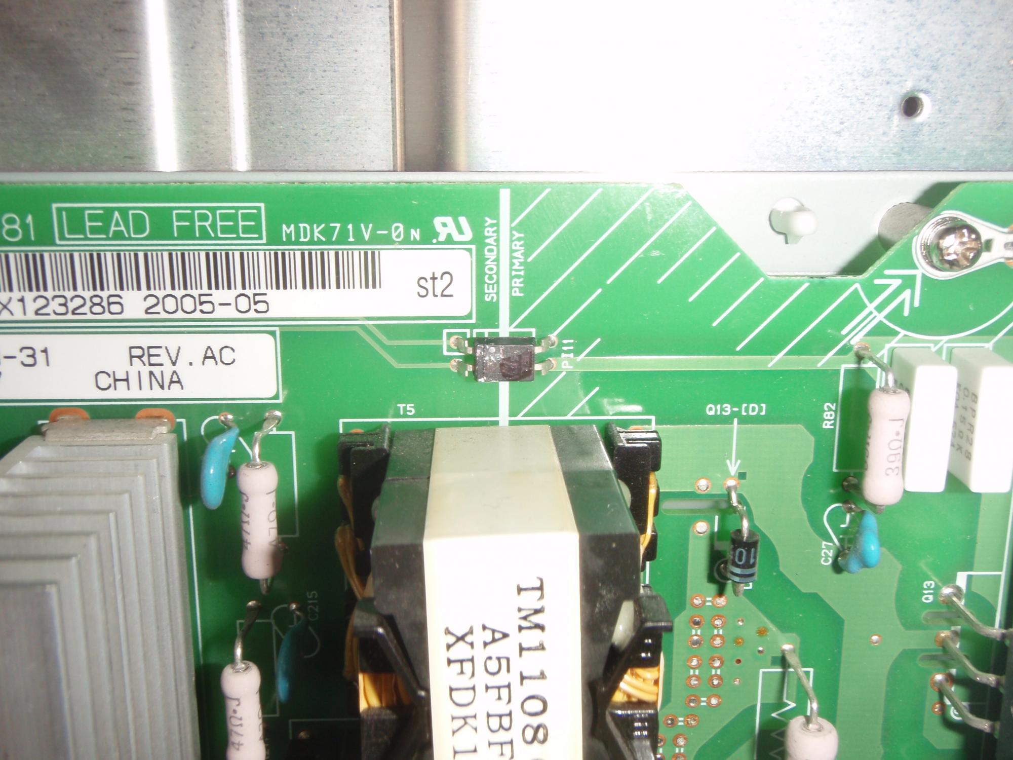

        Re: pioneer pdp505pg plasma help

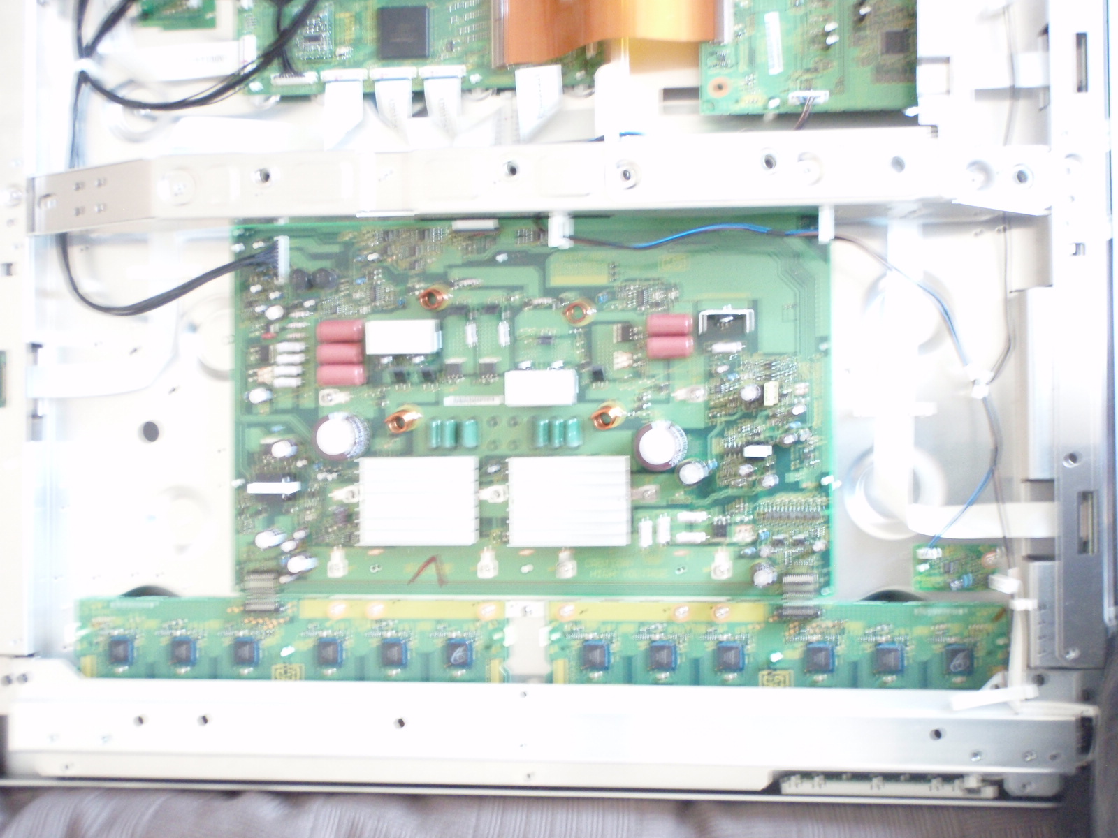

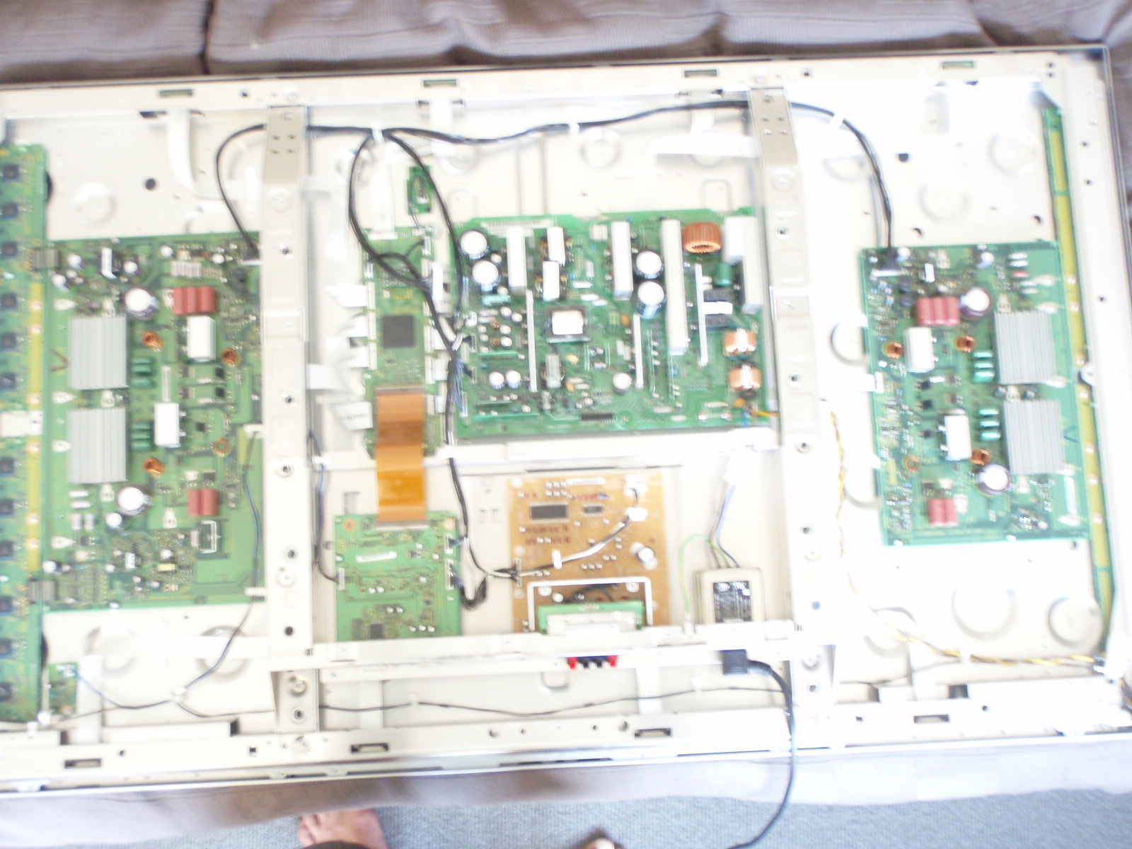

        hope these help, in my endeavour to get better and more pics the battery went flat in the camera, will upload more when it has charged.
        thanks
        • retiredcaps
          • Apr 2010
          • 9271
          I'm not sure what camera you have, but most of those pics are horribly out of focus. You seem to have enough light (indirect sunlight gives good results), but it seems like you are shaking. If your camera is showing 1/60 that is probably not enough light. Try to get at least 1/125.
          If your camera has it, enable macro mode (most do) and optical stabilization (newer models).
            yea, sorry about that, im trying to stand wtih a torn knee ligament#@$ and currently charging camera battery, the service manual you suggested has exactly the same boards and power supply thanks

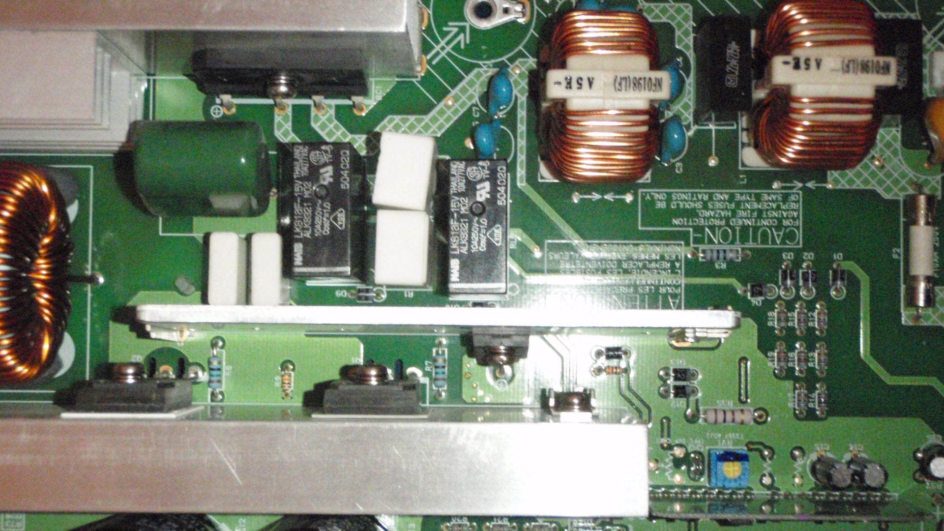

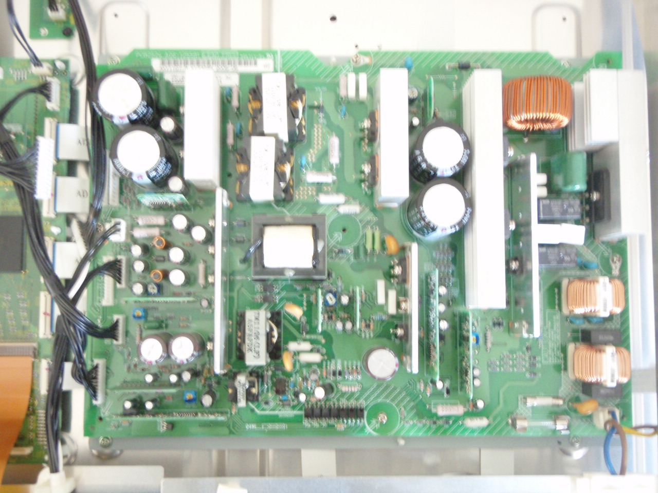

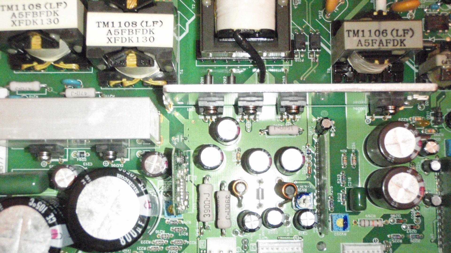

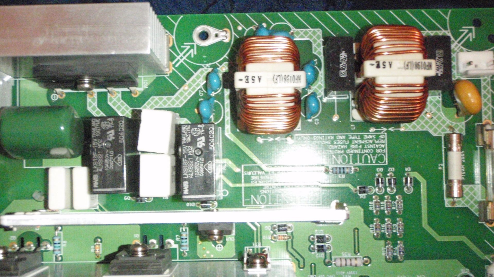

            • confusedall
              • Jun 2011
              • 19

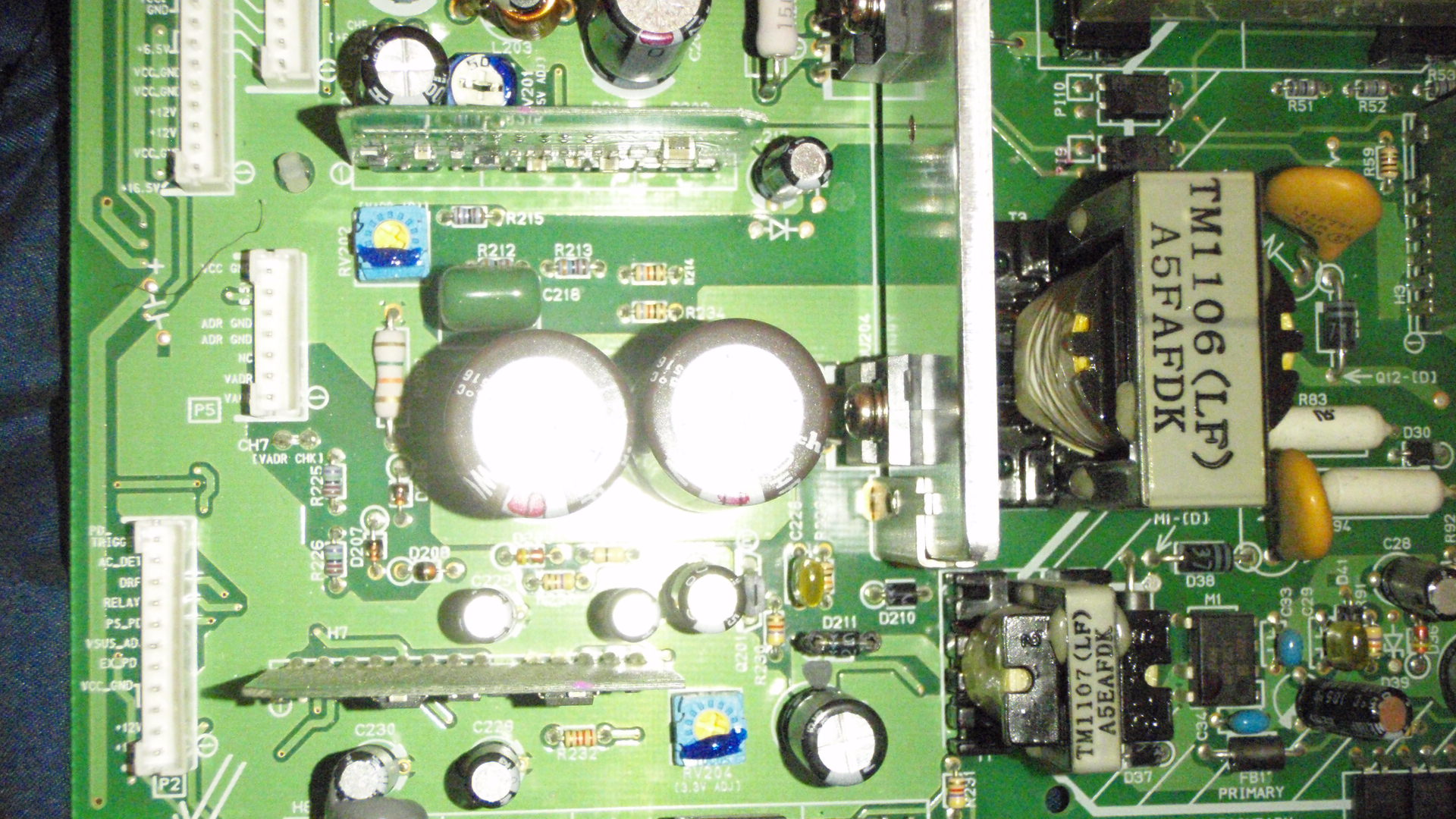

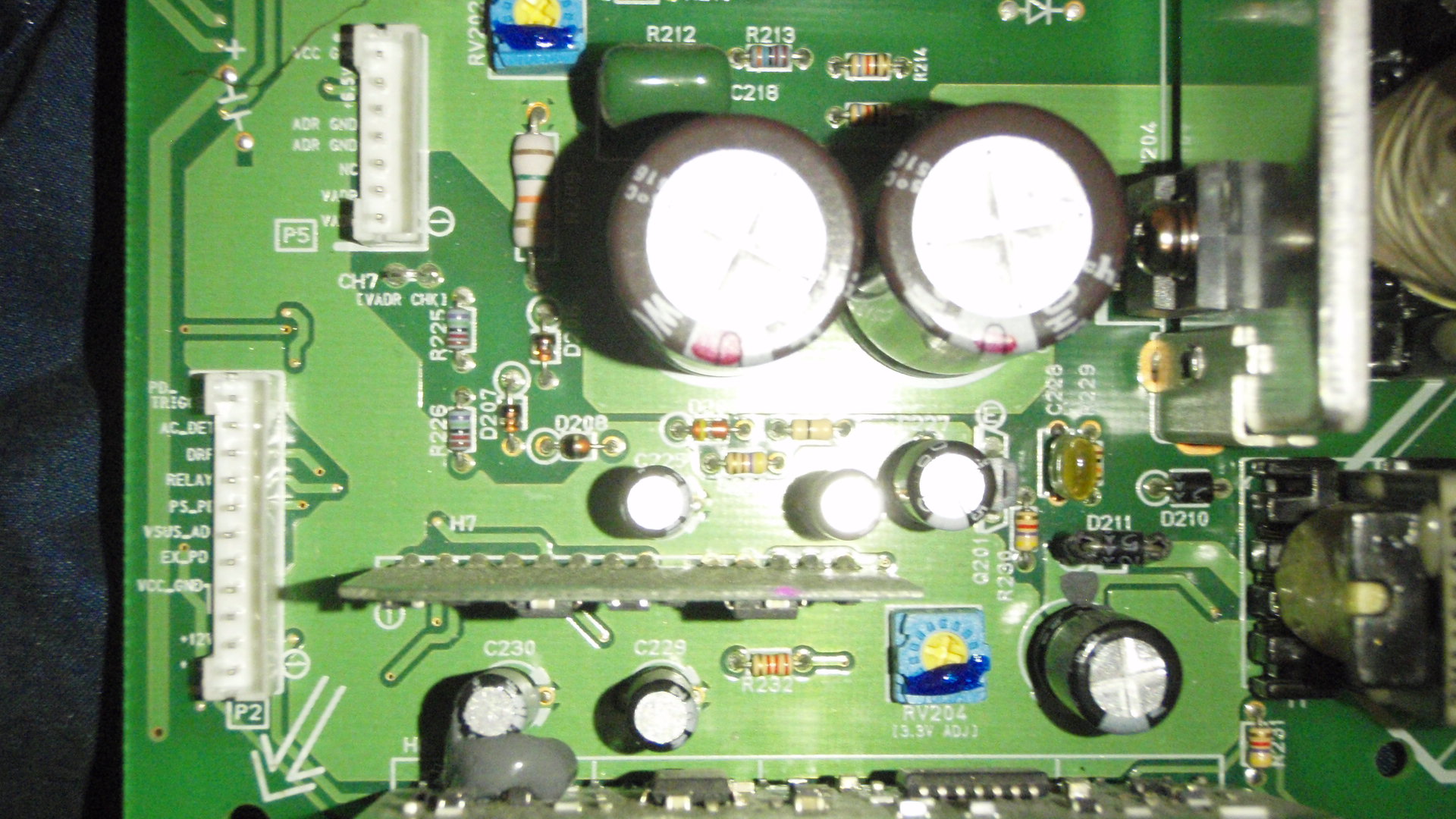

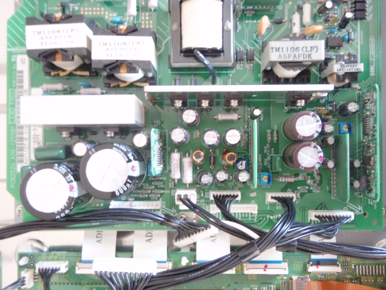

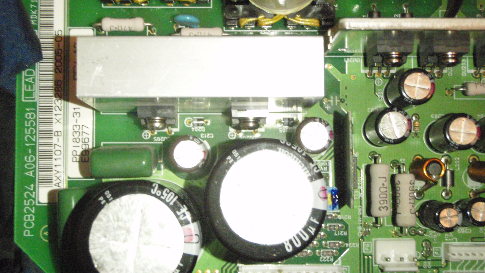

              here are some better images of the power supply, the camera battery again went flat before i could get some of the back of the board.
              thanks for you help

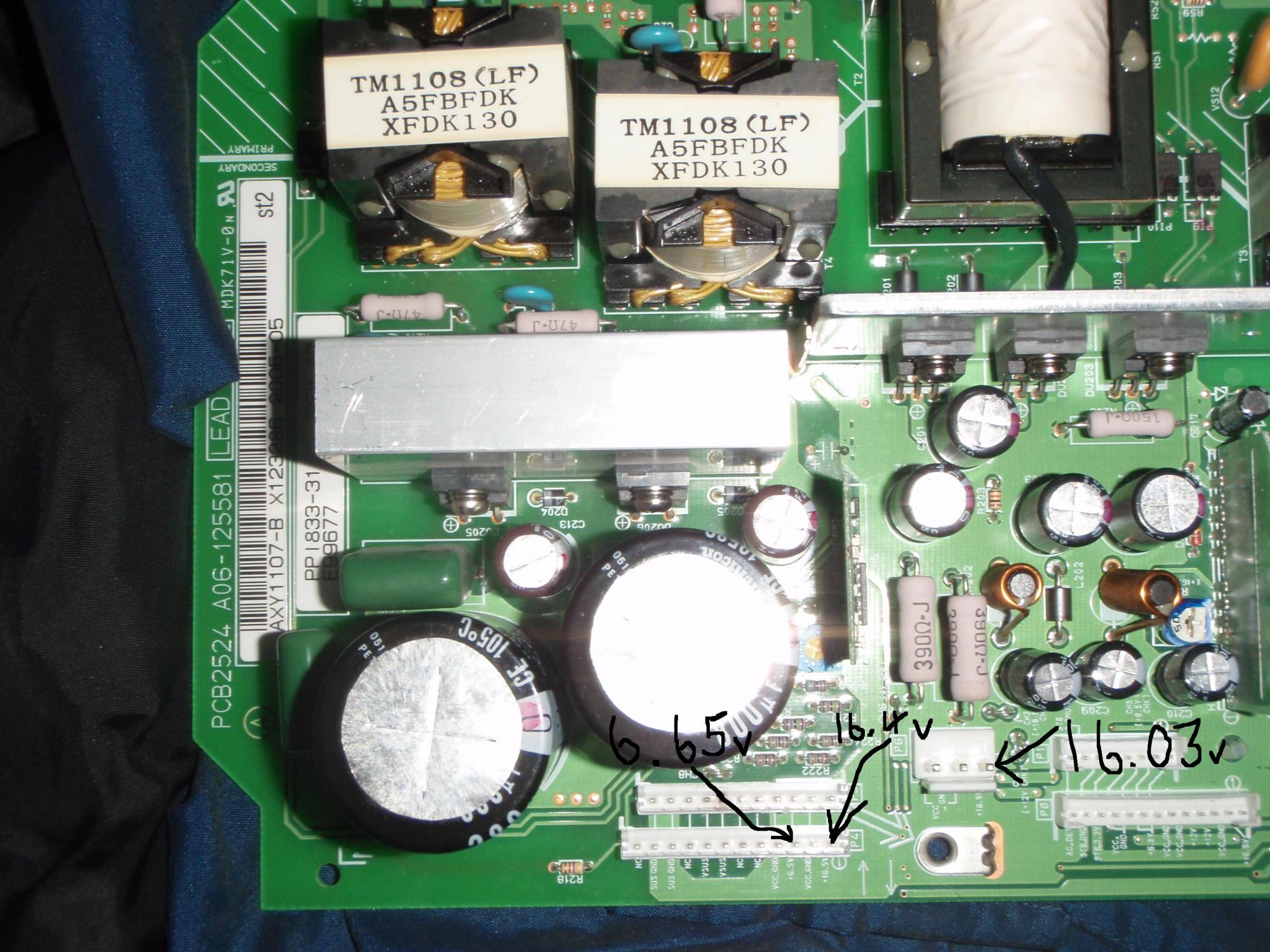

              • confusedall
                • Jun 2011
                • 19

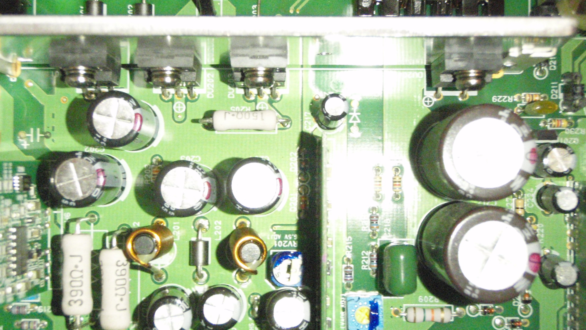

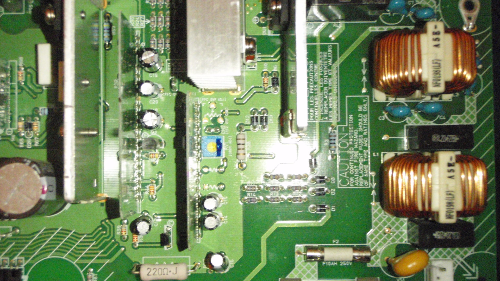

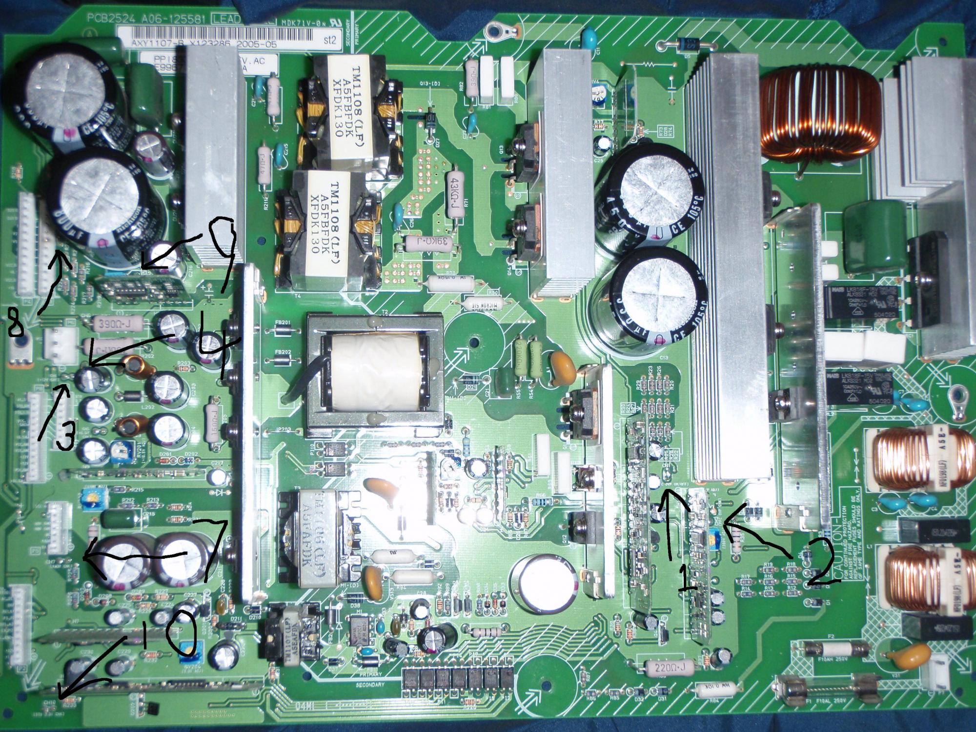

                there are chk points on the board which Ive numbered,there details are
                1, PFC OVP ON/OFF
                2, PFC OVP CHK
                3,+16.5V CHK
                4,+12V CHK
                7,VADR CHK
                8,VSUS CHK
                9,RV203 VSUS ADJ
                10,STB 3.3V CHK
                There doesnt seem to be a 5 or 6??

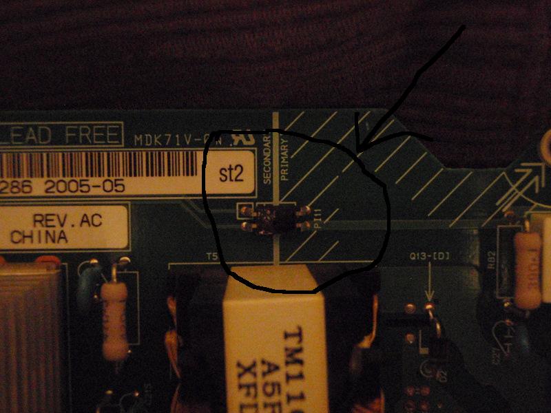

                also (second image) there is white residue on this component,i cannot read whats written on it, it is hard to scrap off, and no other compnents have it??
                if these photos are good enough for now, I will put the board back in and chk the volts again and report back??
                thanks then and now and
                in advance
                • confusedall
                  • Jun 2011
                  • 19

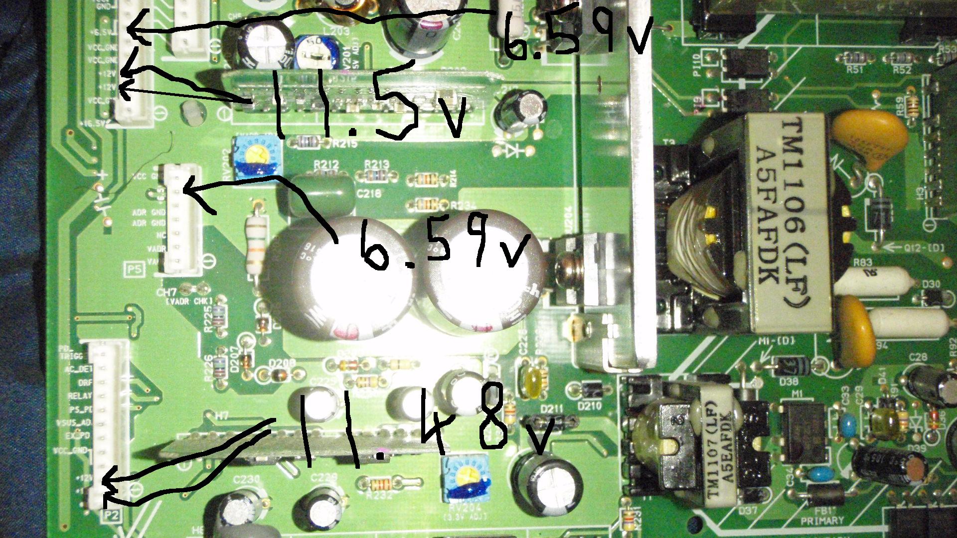

                  I measured the outputs while switching on in the short time it stayed on I got these results, shown on images,
                  • confusedall
                    • Jun 2011
                    • 19
                    everything is powering up, all the 6.5volts went slightly higher,would this be the problem?? such a small amount over??? I did notice the volts raced up with all the 6.5 v outputs until powerdown while the 12 and 16.5 volts slowed the closer they got to the amounts i ended up with
                    thanks then and now and then

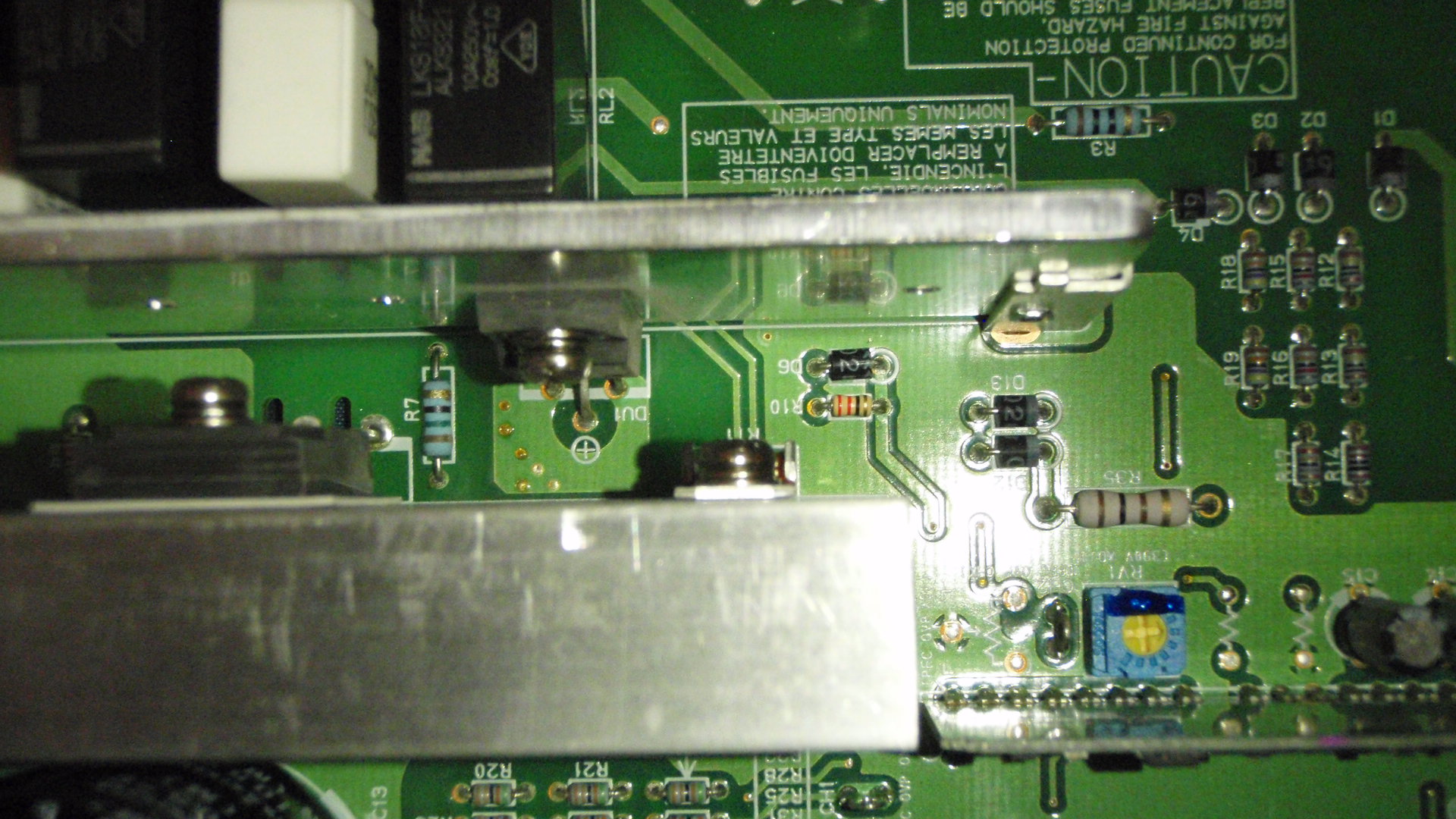

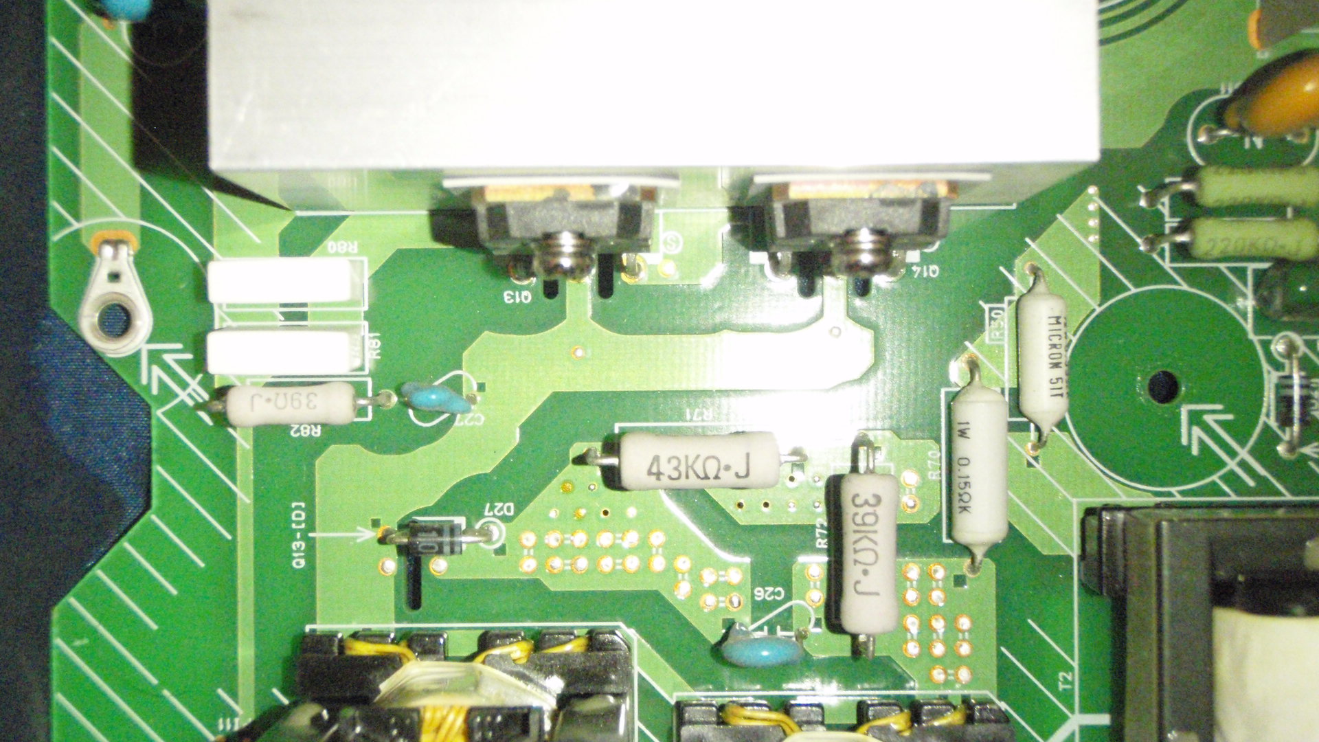

                      here is a better image of the component that has white stuff on it.
                      Thanks in advance for any help

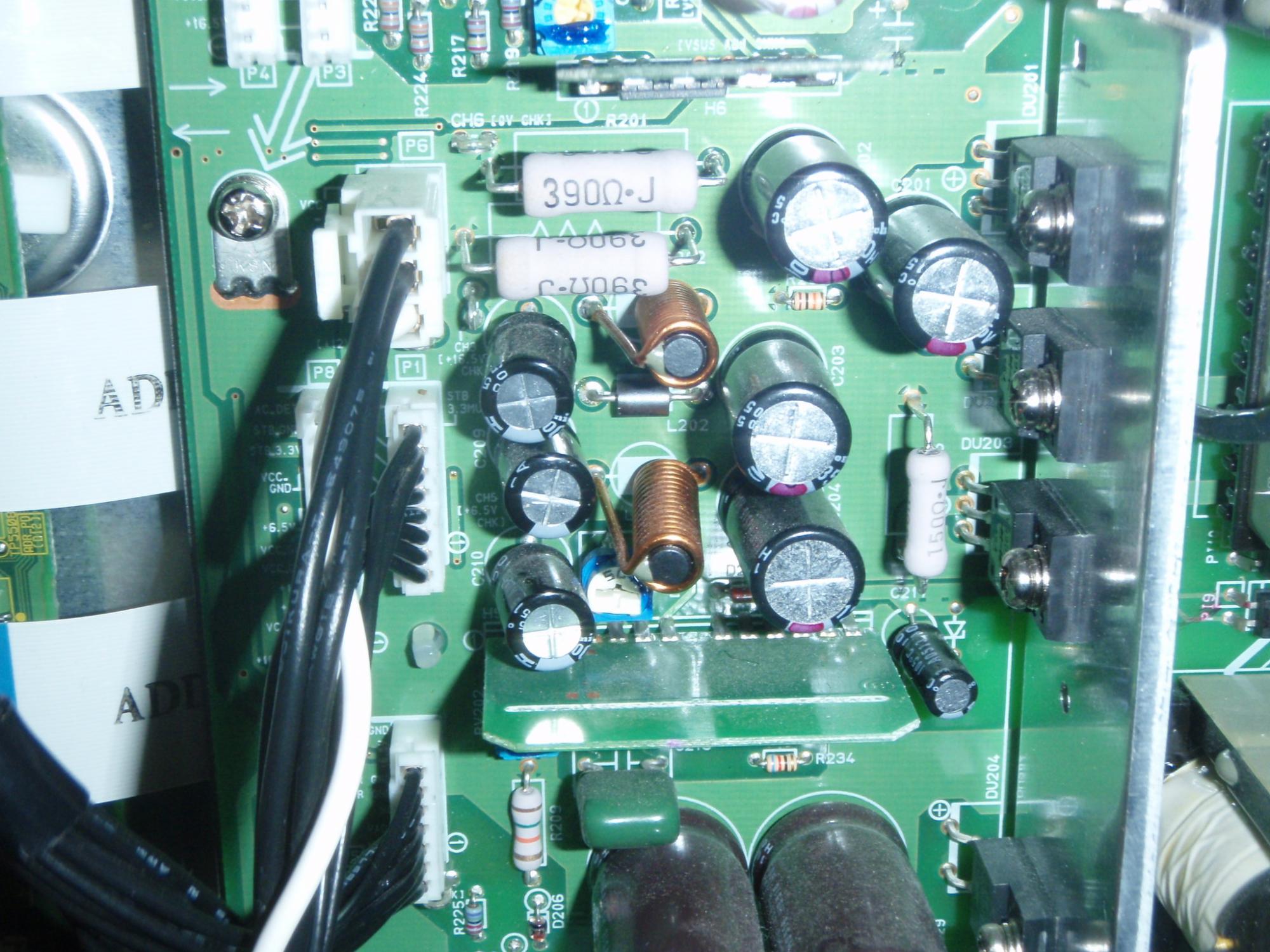

                            • confusedall
                              • Jun 2011
                              • 19

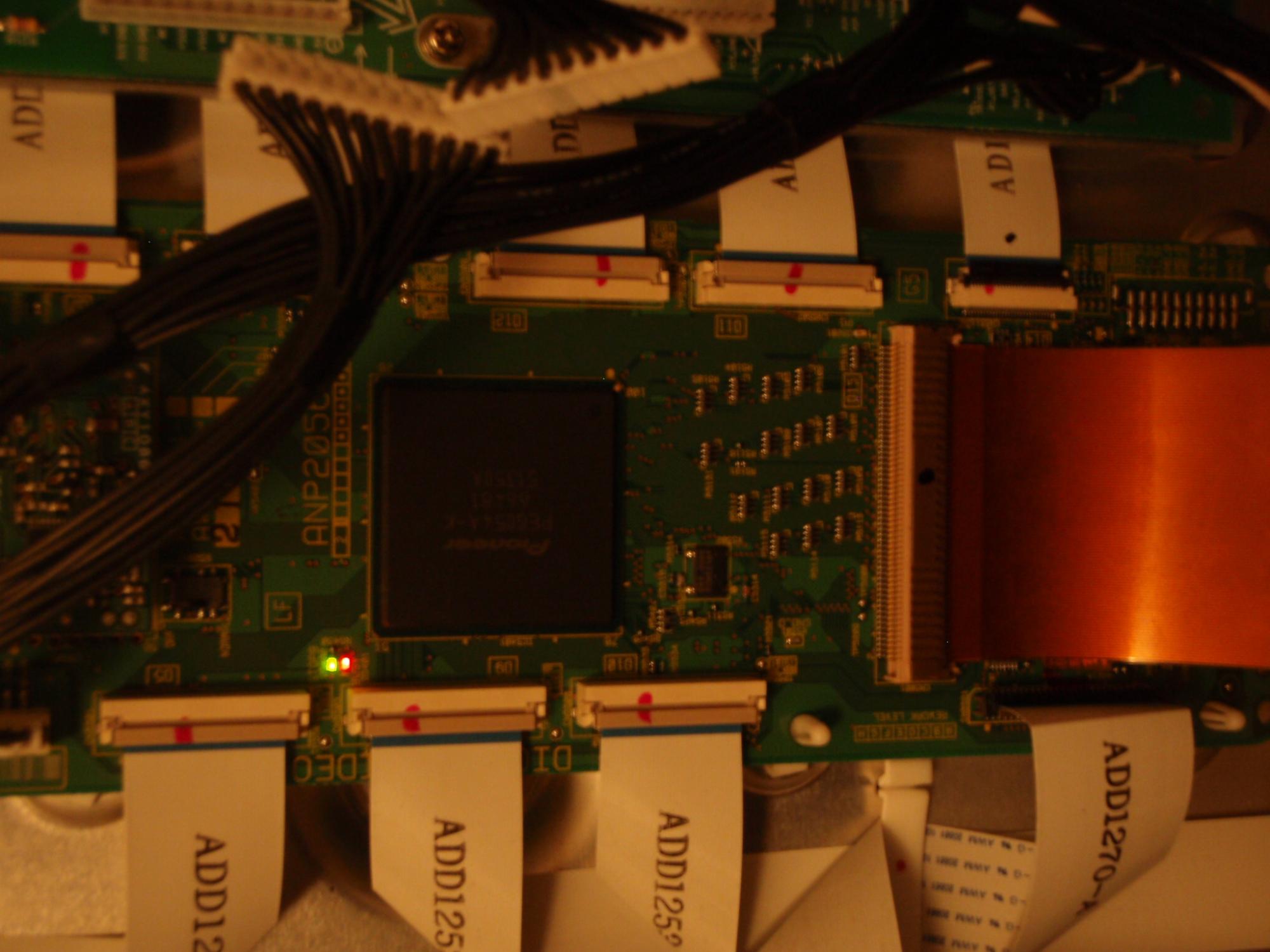

                              I am pleased to report a little progress,with the x and y board unplugged I have turned off a switch on the digital,video board (which in the service manual says turns off all high volts and lets only the small volts thru) and the power supply stays on for a good whopping 15 secs then turns off completly (not power down) the ps board will turn back on by pressing the normal stanby/on button.
                              small acheivment i know ,but a change in the normal power down pattern
                              image 1 showing green led on dig,video board(a glimer of hope!!)hope so.
                              image 2 is showing two resistors 390 ohms, Ive measured these and only get 180 ohms on each is that because they are in parallel???
                              more help would be appreciated thanks
