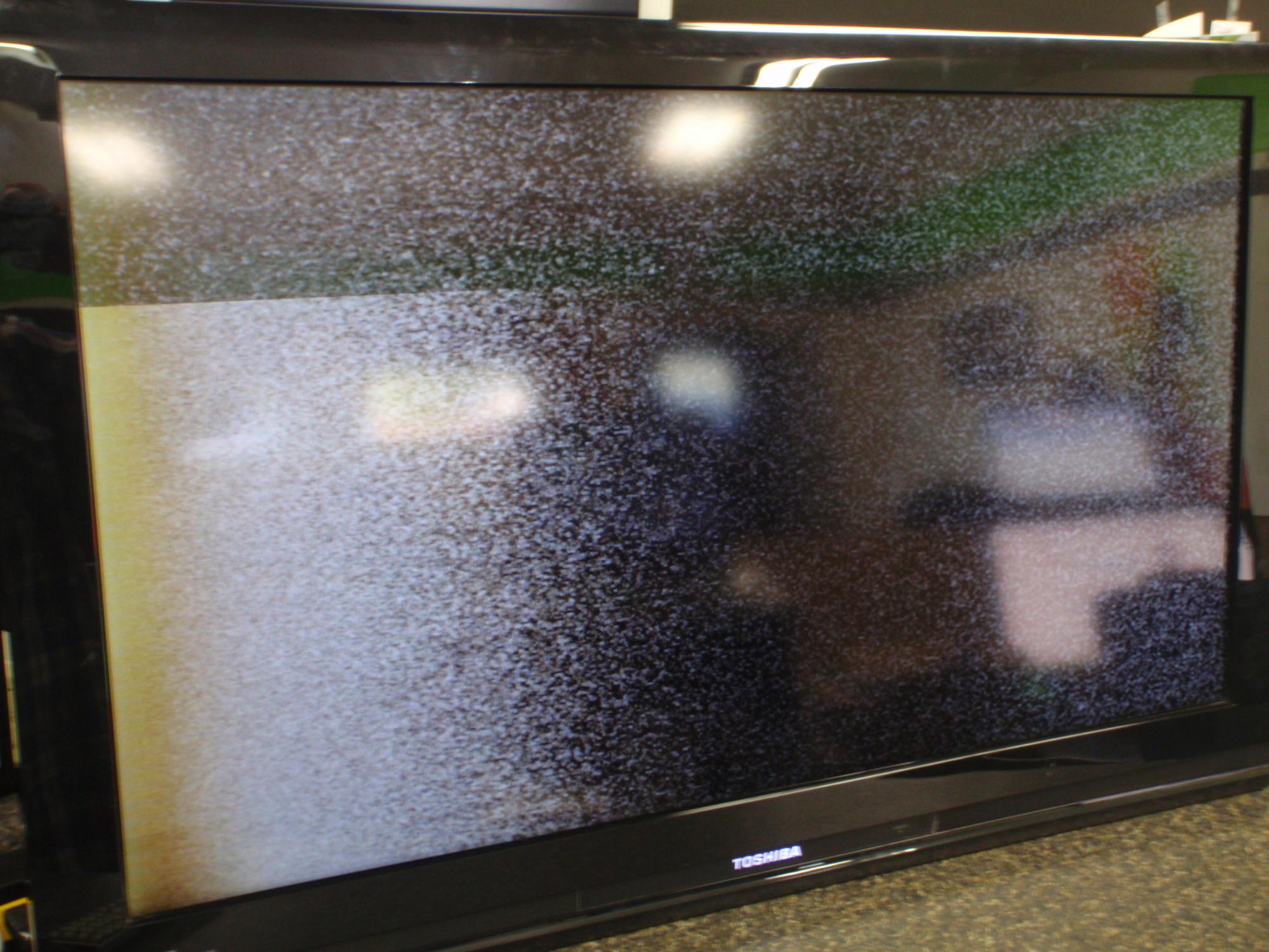

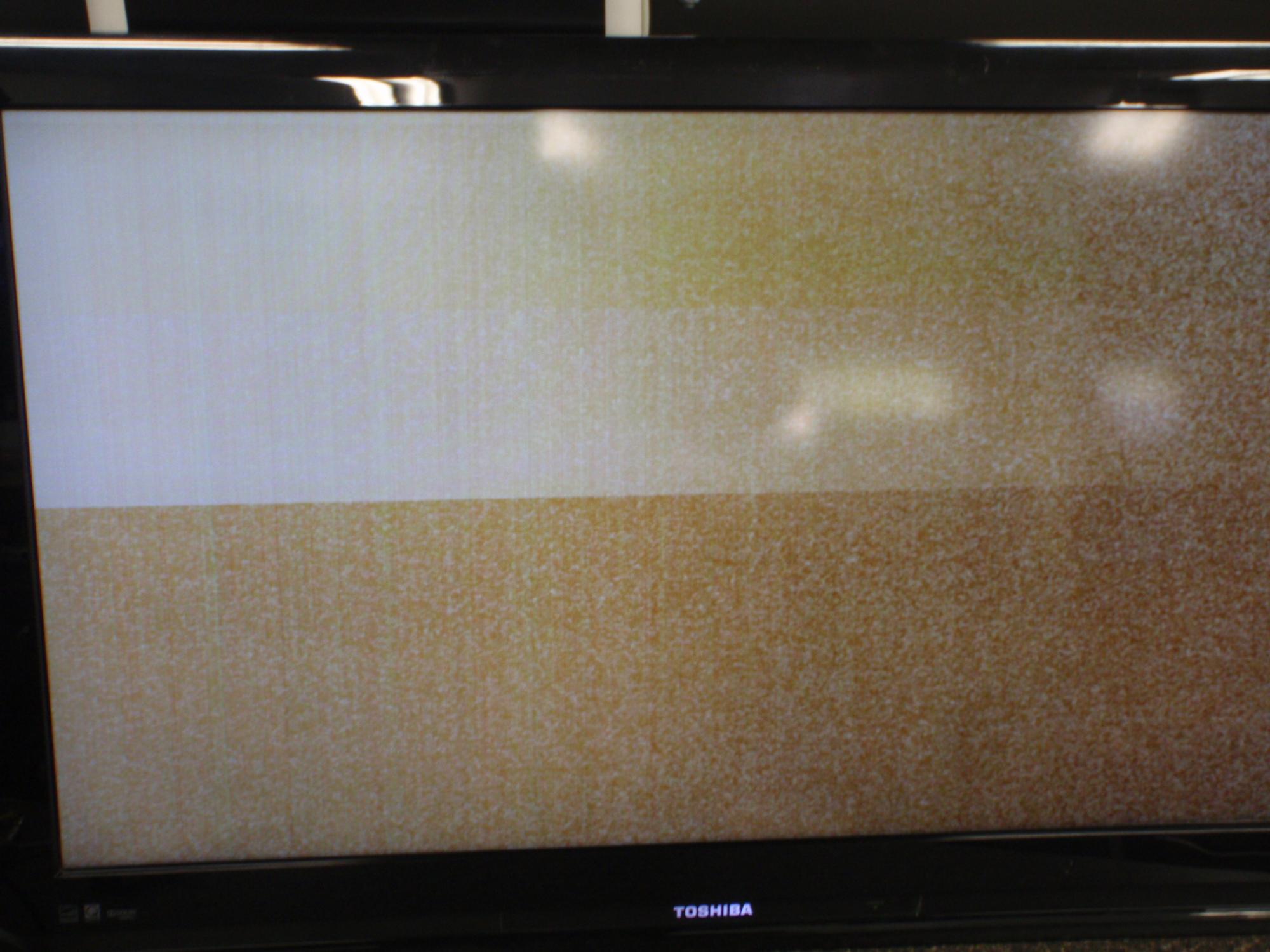

    Hi guys, sad day for a friend of mine- the dog somehow walked by and knocked over his 40" lcd.... he brought it over to me and fired it up;
    The LCD is not cracked, but the screen shows a strange tan/whiteish panel that fades accross, then within minutes the entire panel starts fading tan/white.
    Nothing is obviously broken or disconnected inside.. is this thing toast or might it be salvagable?

    Strange looking failure for that type of scenerio. Since it was a drop, theres nothing I can think of besides a break in solder joint or those darn tab bonds. Keep with it, I think you'll find something.

        im thinking check tcon, cables to and from tcon, boards on top of panel, ribbon cables from the boards top to the glass panel.

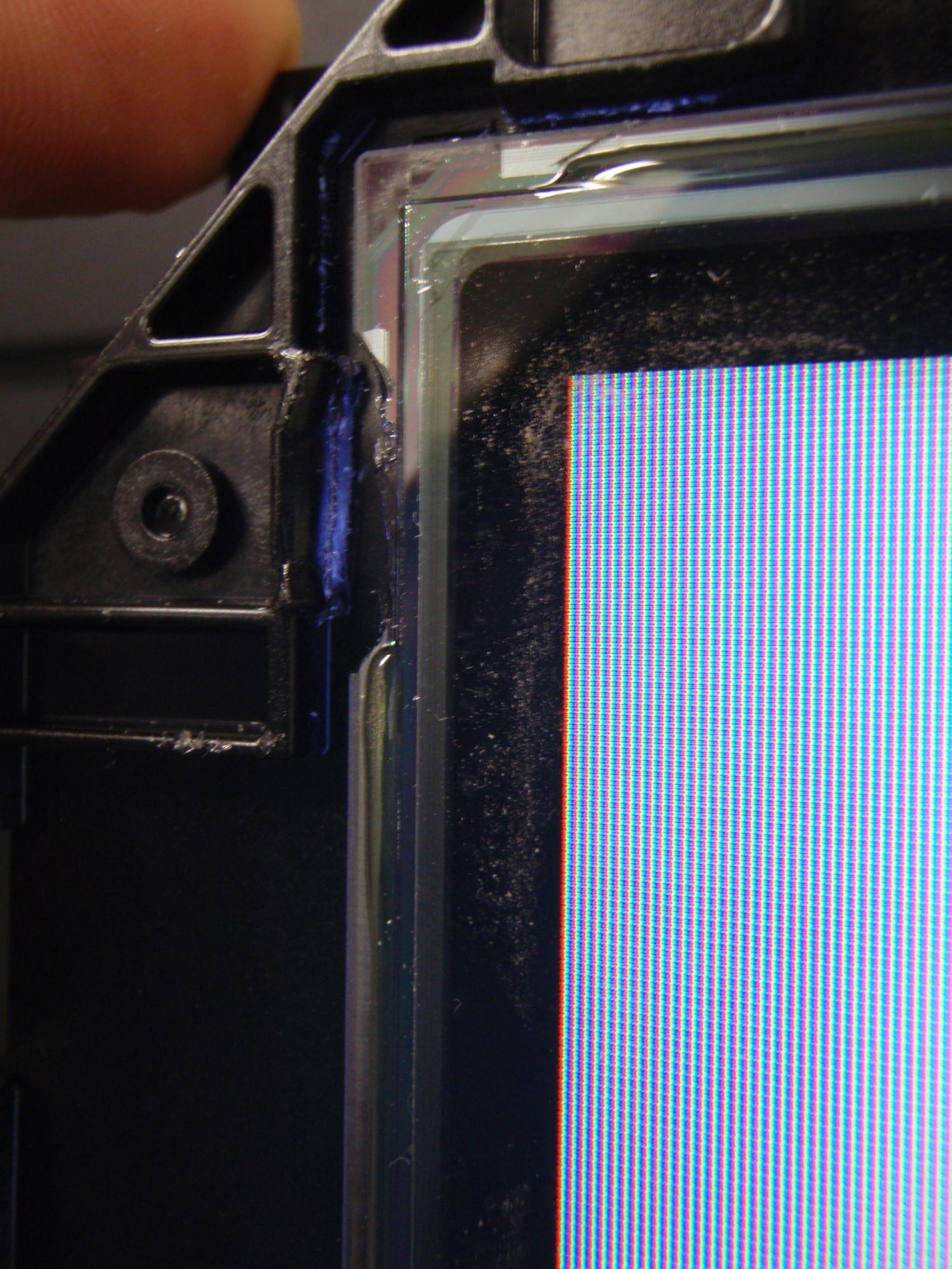

          OK so I got down to the glass and found the top left corner is chipped, I'm guessing there is a trace that sends data along the edge of the glass there?
          If I press around this left edge if affects the whiteness but it never goes away...

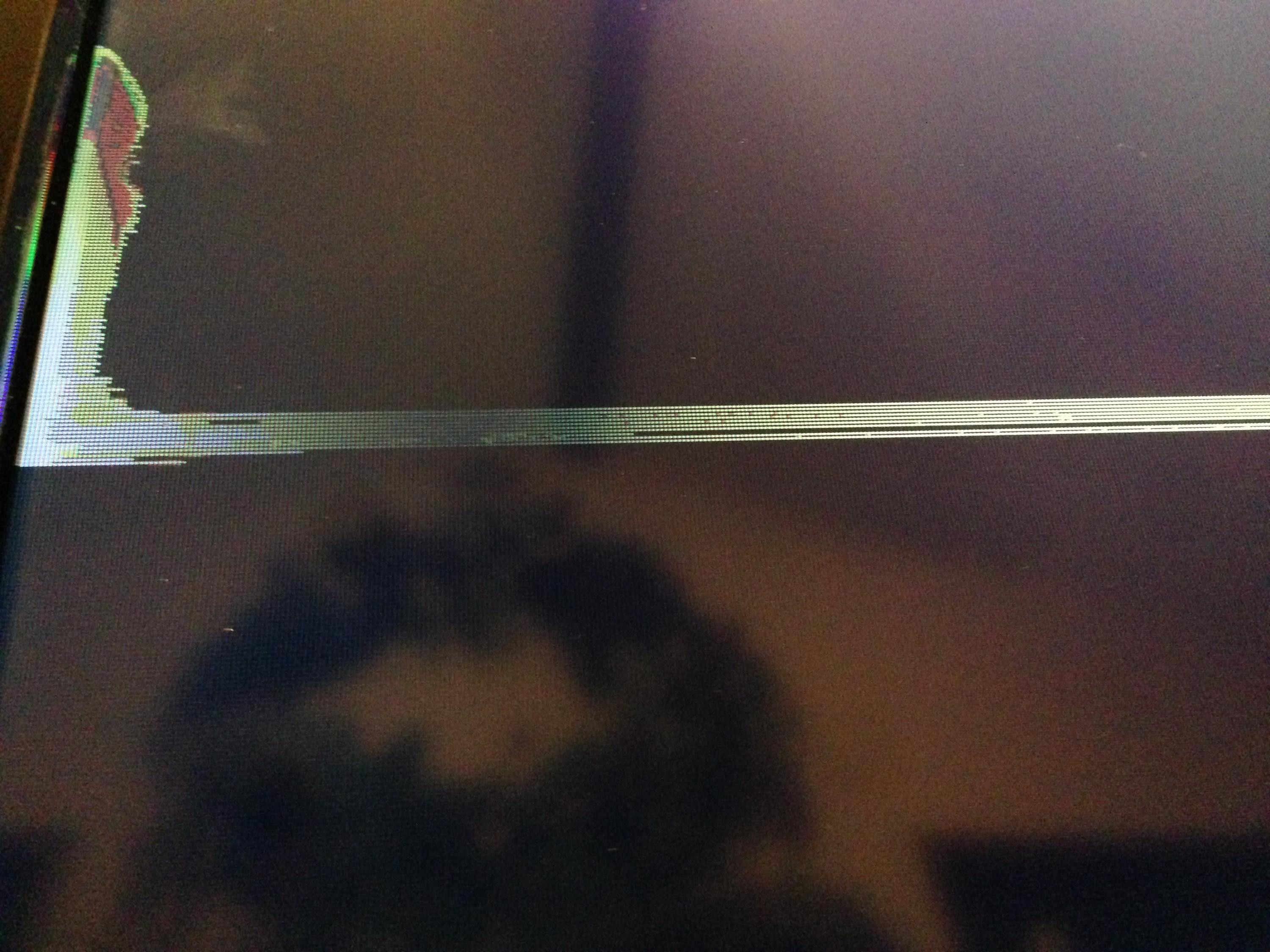

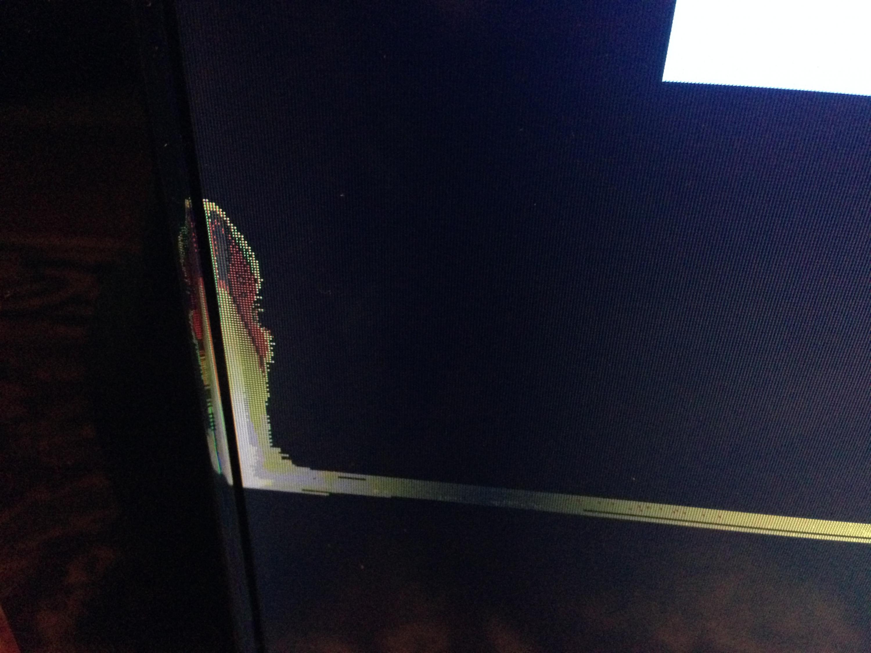

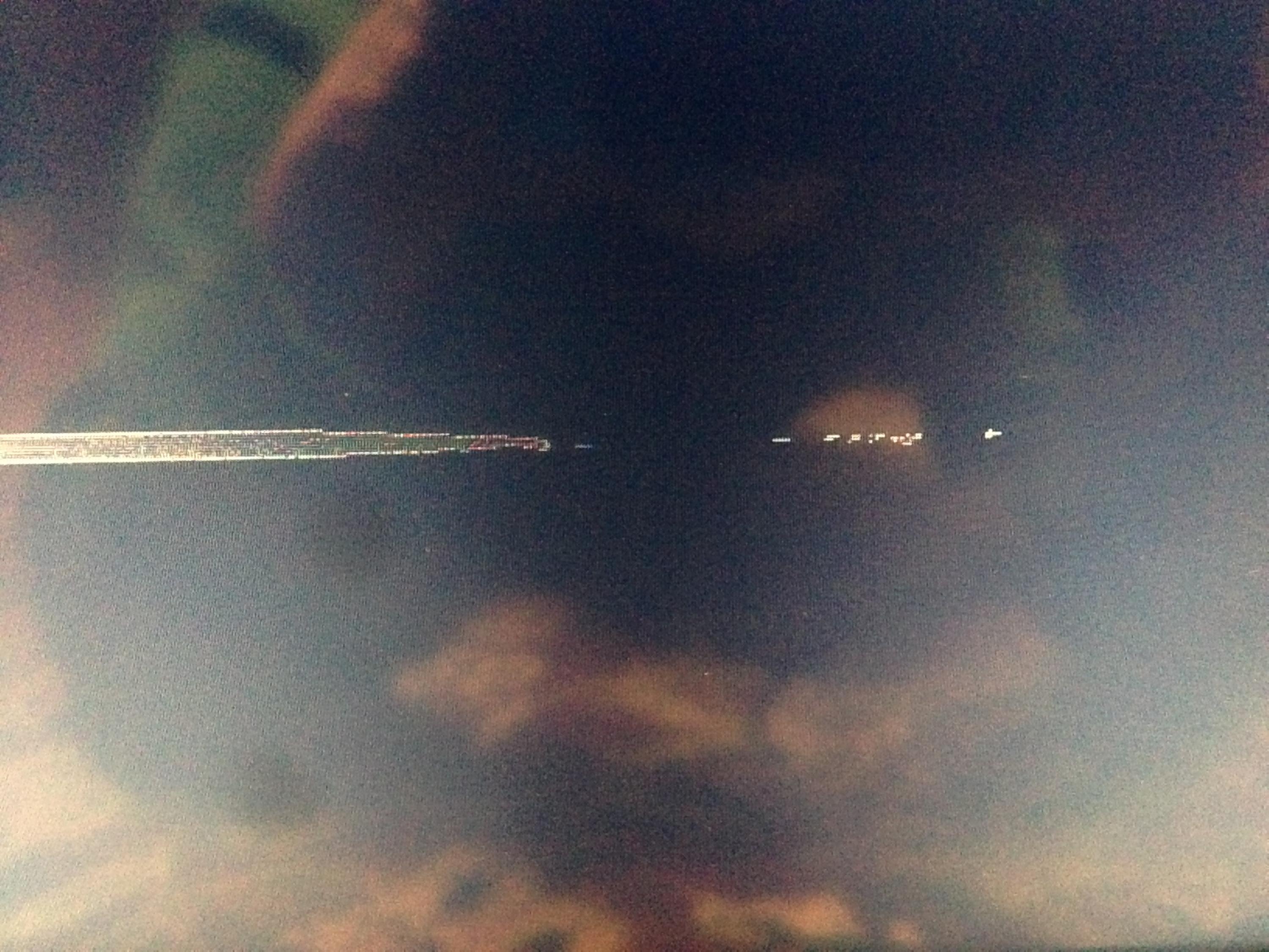

                Hey y'all I don't know how to start a new question but I have a Toshiba 40RV525R that looks like it has experienced a de-lamination of the LCD screen.
                Could someone confirm or tell me what to look for?
                Thanks in advance !
                I got this tv with a bad back light inverter & when I got it running this is what I found !
                The mark does not go the entire width of the screen.

                  almost looks like it cracked, but I doubt it did. I'm thinking the zebra strip/ribbon cable coming out of the tcon. where it attaches to the glass some times becomes unsoldered.
                  I'd try going over it with a pencil eraser or something and push it gently into the glass to see if the solder broke. if you see a change in the picture then id push it down with silicon or something and apply heat from a soldering iron or something to solder that part on the ribbon cable back onto the glass.
