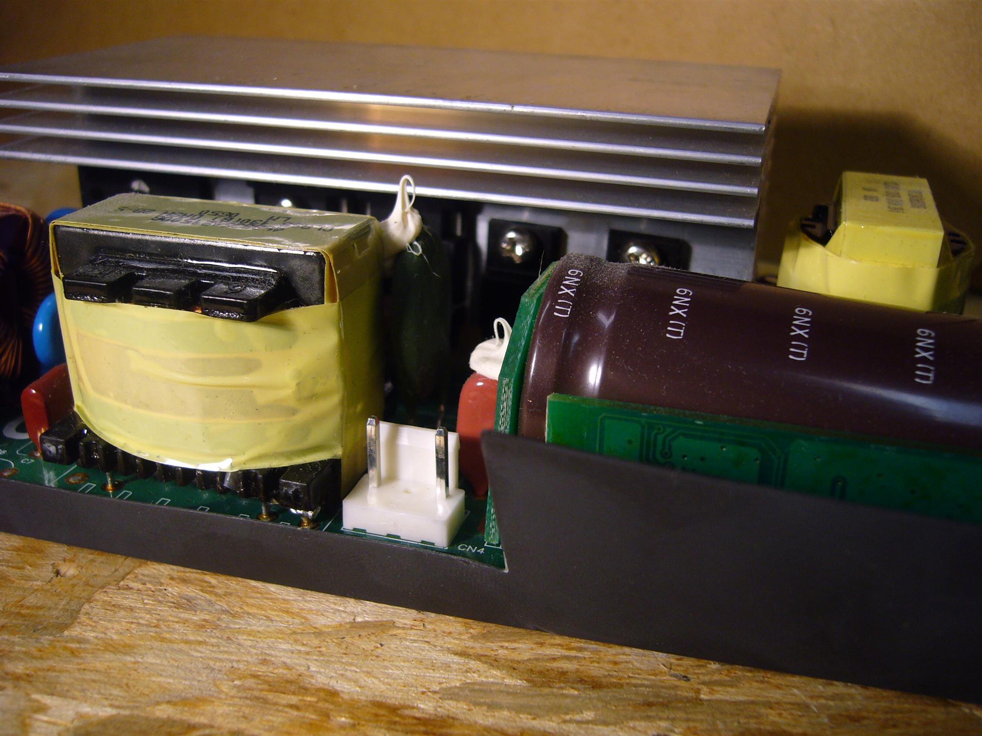

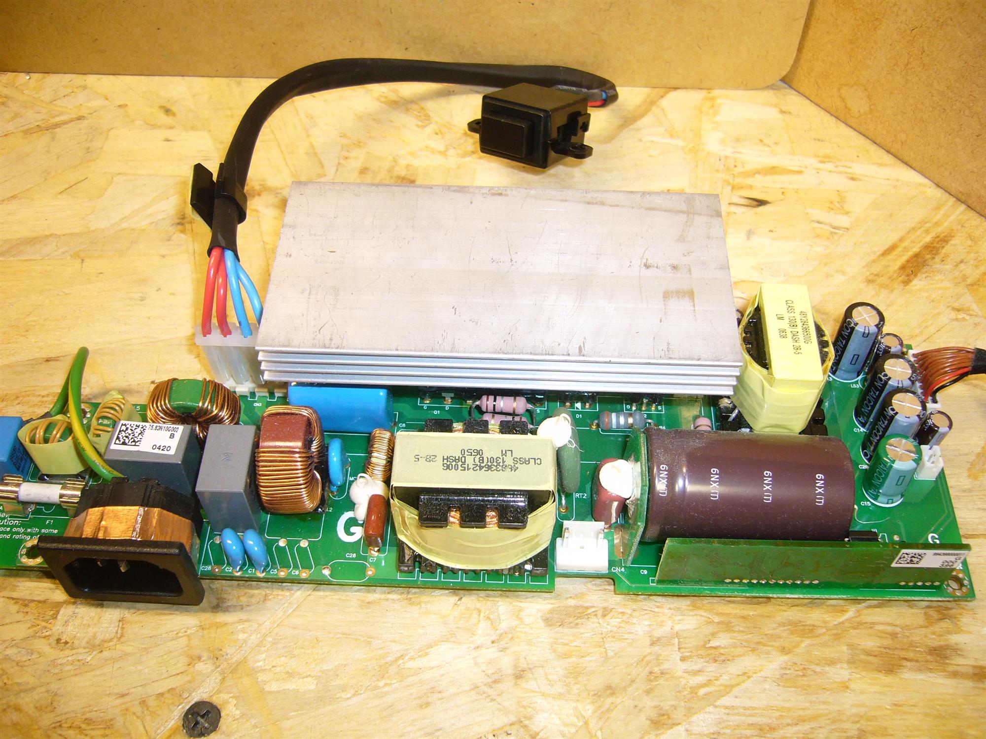

    No sign of power - normally a single LED lights when connected to power.

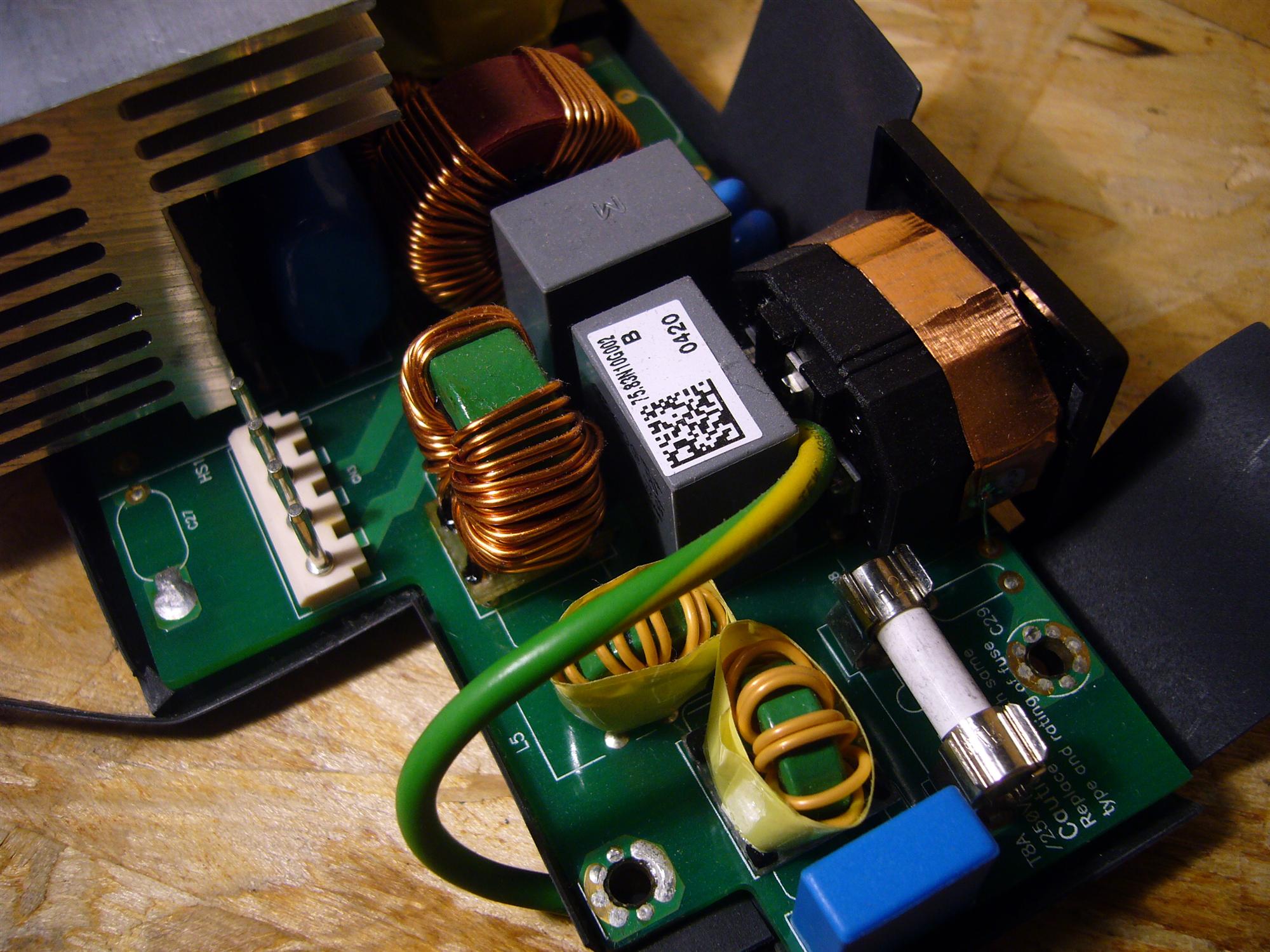

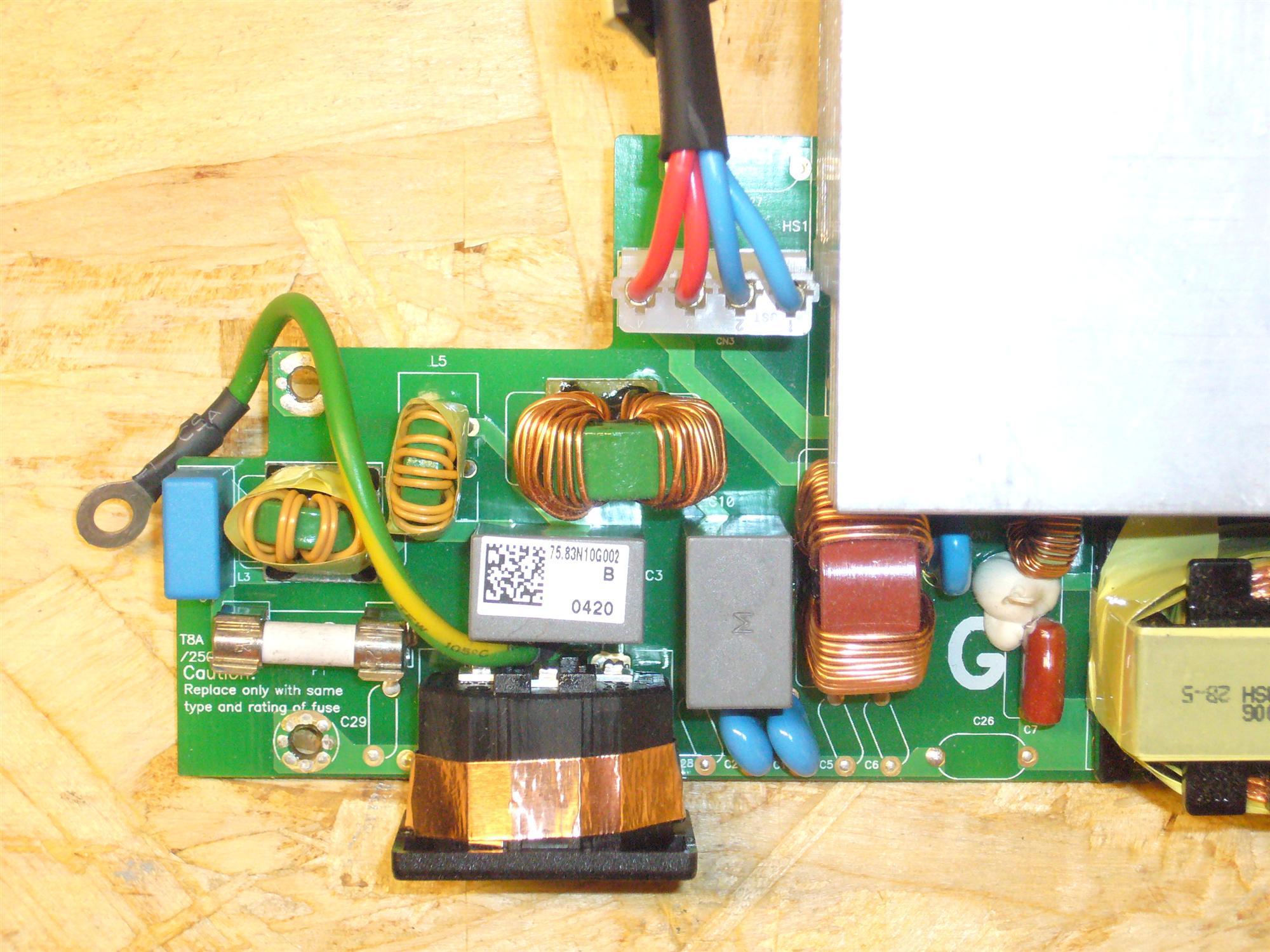

    *Main AC input fuse OK.

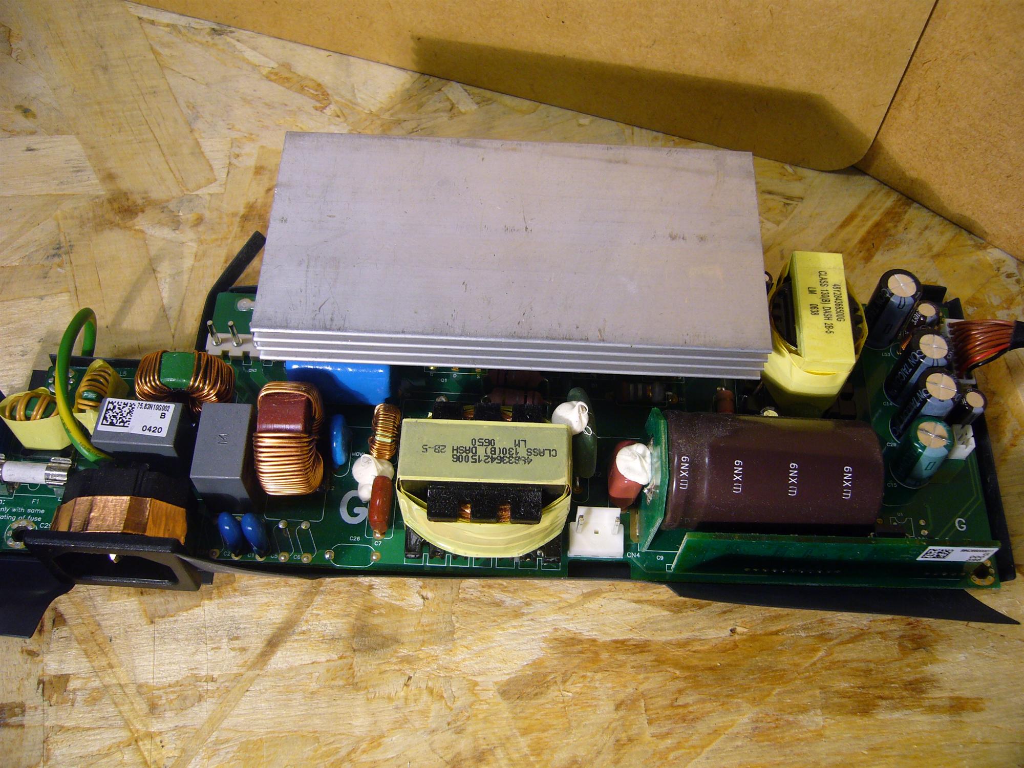

    *Power supply visually OK - picture attached.

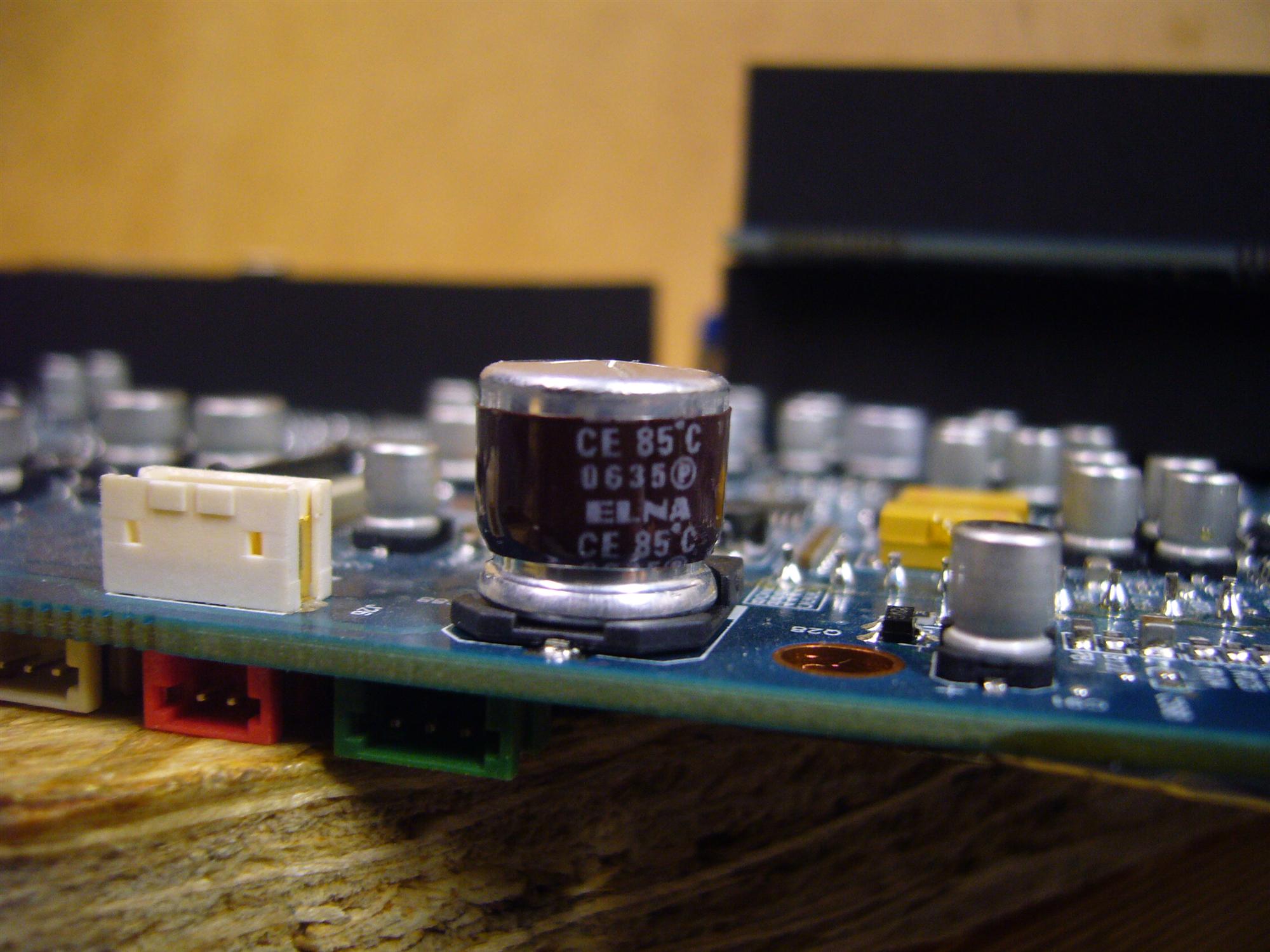

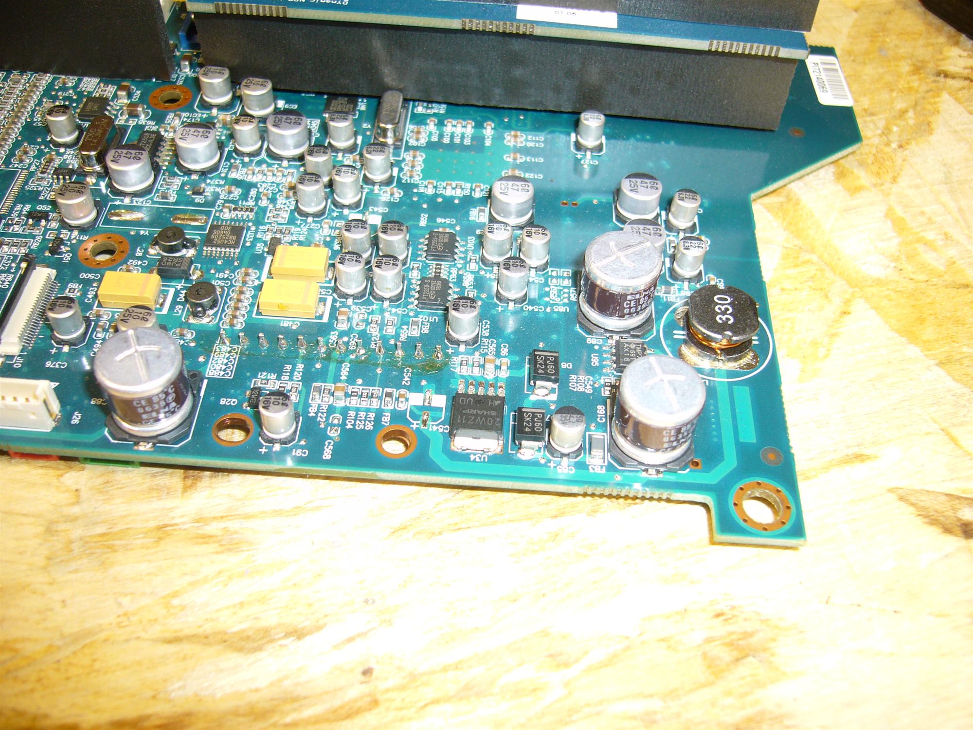

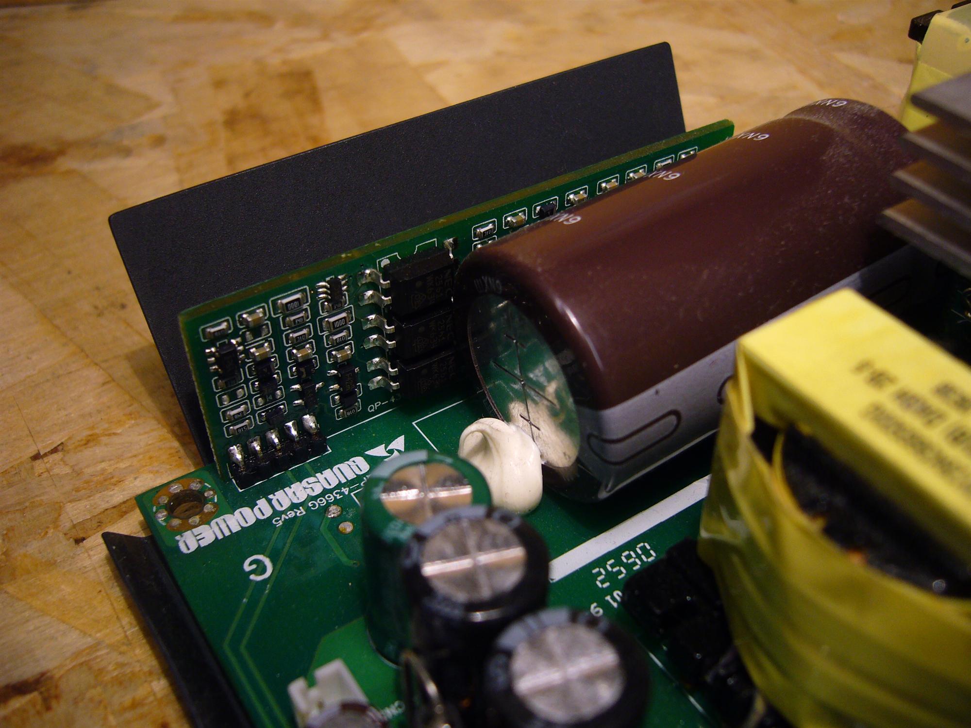

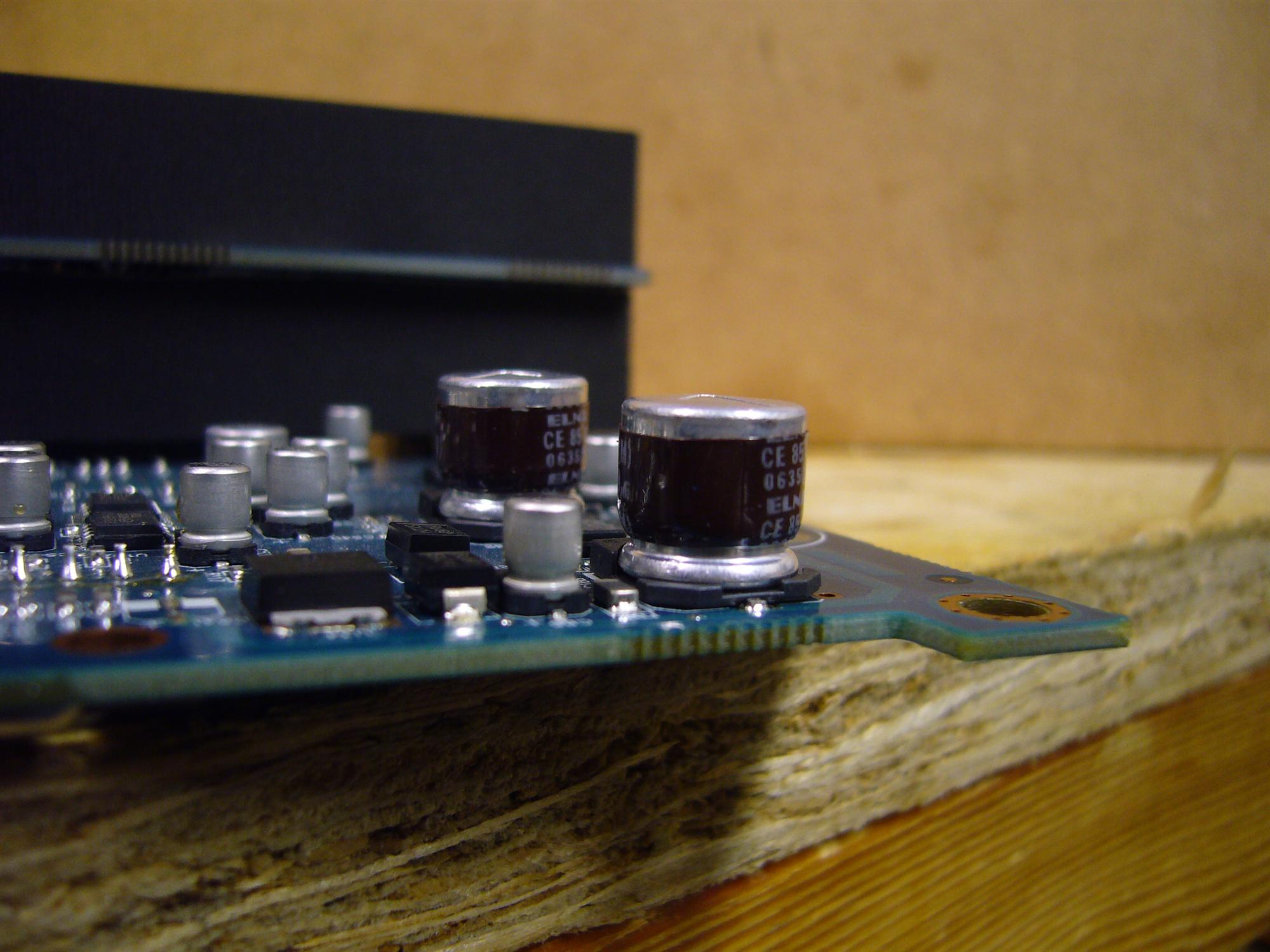

    *Main board has three bigger surface mount electrolytics that I'm questioning - pics attached for comments.
    I know these things have too many brains as far as not powering up if bulb is bad, etc. but bulb looks good.
    Any ideas?

    I guess a good start would be to measure the voltage over the big filter mains cap
      Re: Acer PD726W DLP Projector - No Power
      Only 3.7vAC...? Definitely something wrong. There is an interrupt switch I saw in the service manual that I'm going to check first - with the power supply out, that's unhooked. I'm not sure what exactly it "interrupts," but it very well could be main power.
      I'll let you know what I find out.
        Well, with the switch pushed, I get 65v between either side of cap and ground. With the switch in its normal position, the it looks like it went from 3.7 up to roughly 9v at the main big cap.
        Pictures of interrupt switch attached.
          Across the main filter capacitor, you want to measure DC V across the legs.

            Yes, voltage is the expected 170v when interrupt is pressed in.

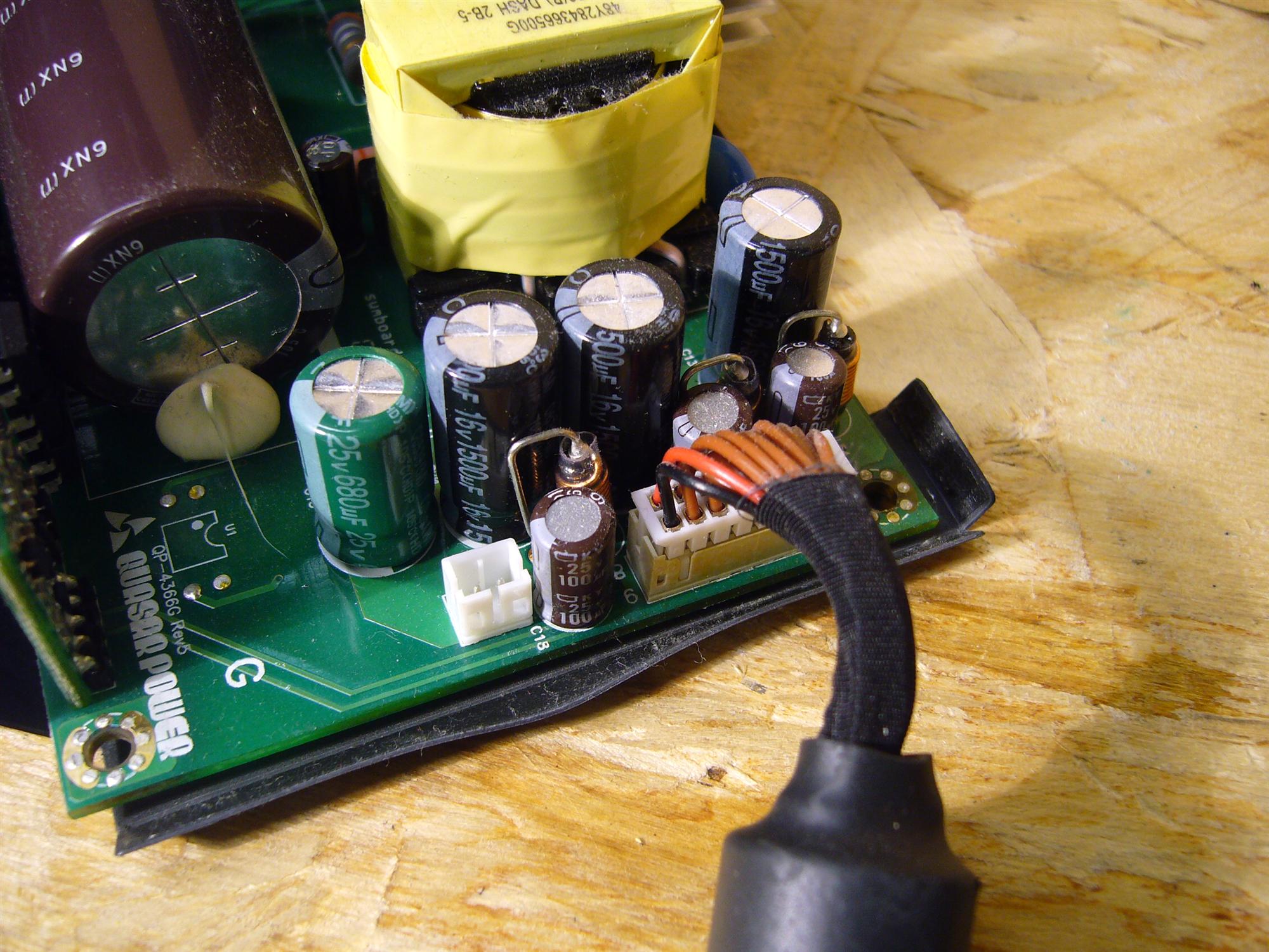

              Okay, 170V DC is good.
              There is a connector with 7 caps next to it (UCC KY, Green cap, and maybe 3 Capxon caps).
              Are there any voltages on the pins of that connector?
              If yes, what are they?
              If no, is there any DC voltage across those 7 caps?
                The three big surface mounted caps are bulging.
                  When I first saw those pictures, I had the same thought, but I think those caps are supposed to look like that?
                    Yeah I'm on the fence too - they're odd little buggers. They don't immediately look bad, but they're not flat either. Here's a picture I found from an ebay listing, and they definitely look flat here, but I'm still not sure. I suppose without an ESR meter, I can't really tell for sure, eh?
                      I haven't seen a cap that was intentionally manufactured with a domed top. You could test them to make sure. The cap will have high ESR and low capacitance if it really is bad.
                        Retiredcaps - yes there are common voltages on the small connector - 12, 5, 3.3, etc. I'm guessing power supply is fine, for now anyway. I don't have a pinout of what is supposed to be there, but it looked normal enough.
                        Sounds like these caps are a good place to start? I'm guessing they could cause it to act (externally) as if there was no power to the main plug?
                        I've replaced lots of through-hole capacitors, but no surface mount. Not sure on the difficulty or procedure here.... anyone have any pointers or suggestions?
