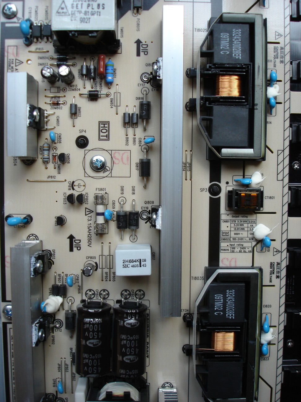

        Samsung LE40B750 flickering UPDATE

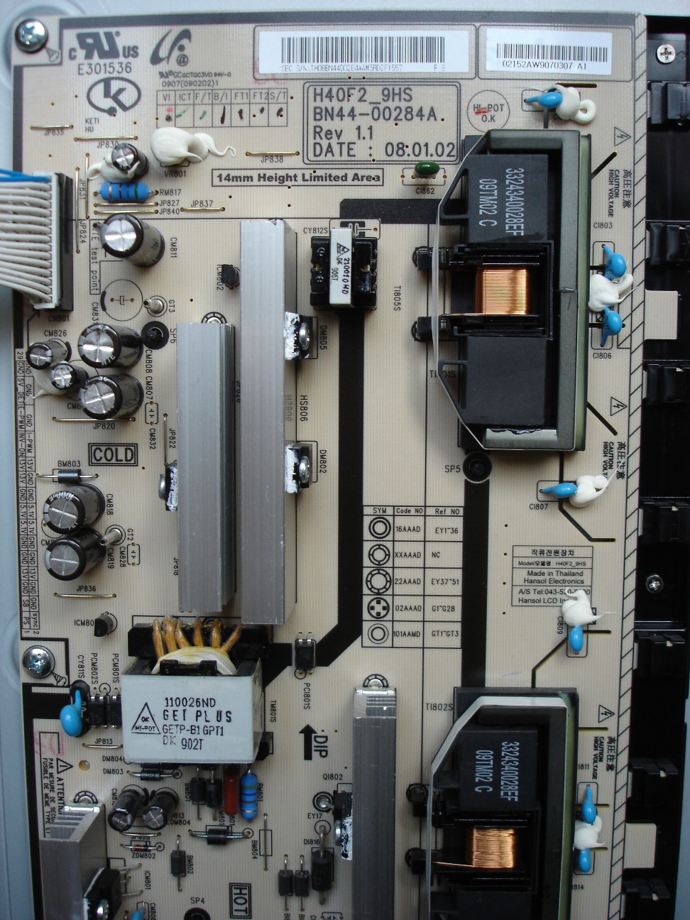

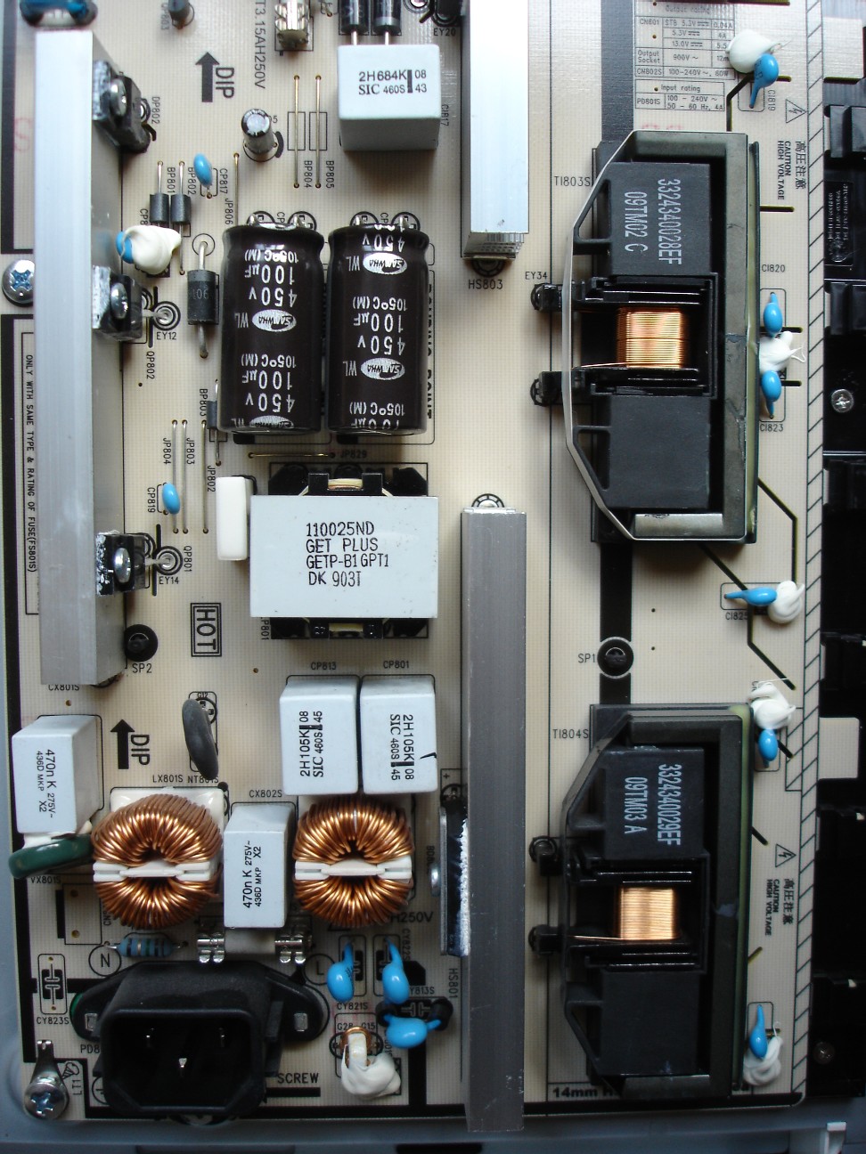

        OK, it's been a while since my original post but I've had a chance to get some photos of the IP board of my TV.
        To update - the TV appears to work very well from cold, but after 10-30 minutes the backlight begins to flicker quite badly and eventually goes out completely.
        When starting from Standby mode the backlight does not light up at all??
        I do not know if it is significant, but the heatsink marked HS806 (at the top centre of the board) is very hot to the touch - a lot hotter than any of the others.
        In order to answer a few other questions I have measured the output voltages on the connector at the top left hand side of the board and these seem to be ok.
        5.1V reads 5.22V
        13V reads 12.78V

                BTW it is normal for that particular heatsink to be hot as those two diodes carry the full current for the inverter and probably dissipate about 10W each.

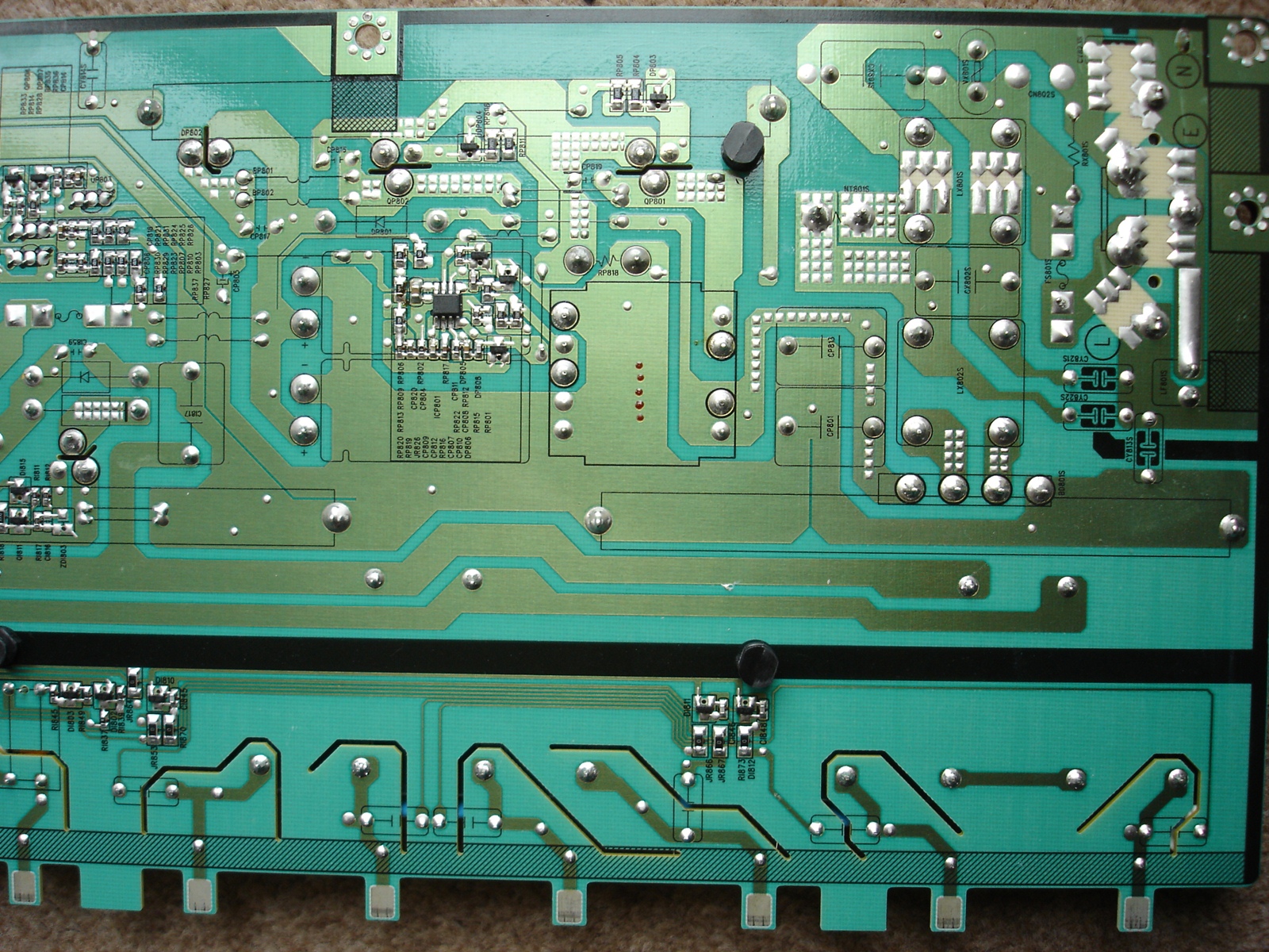

                    Those are good pictures! Please take one of the bottom of the board. The failure after it heats up could be cracked solder joints on the inverter transformers. Or possibly somewhere else...
                    The inverter is smart, and that's why you get the "two seconds to black" when not all the bulbs are connected. It sees that something isn't right, and shuts down to protect itself. Don't connect or disconnect bulbs with the power on. If you have another LCD panel with the right CCFL connectors, the bulbs in it can be used to see if an individual bulb in the Samsung panel is bad.

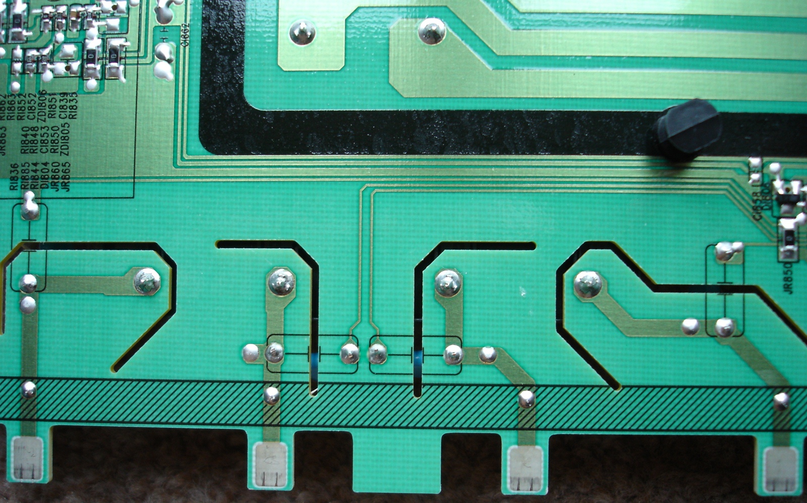

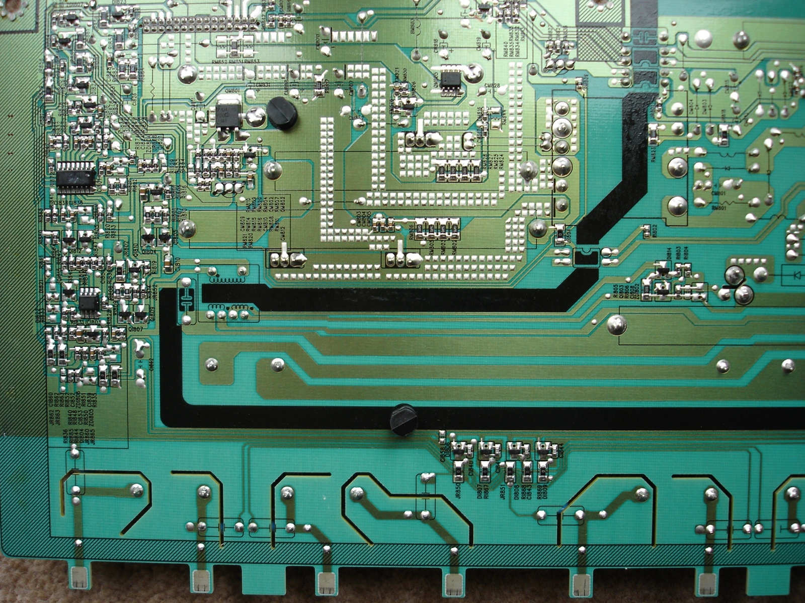

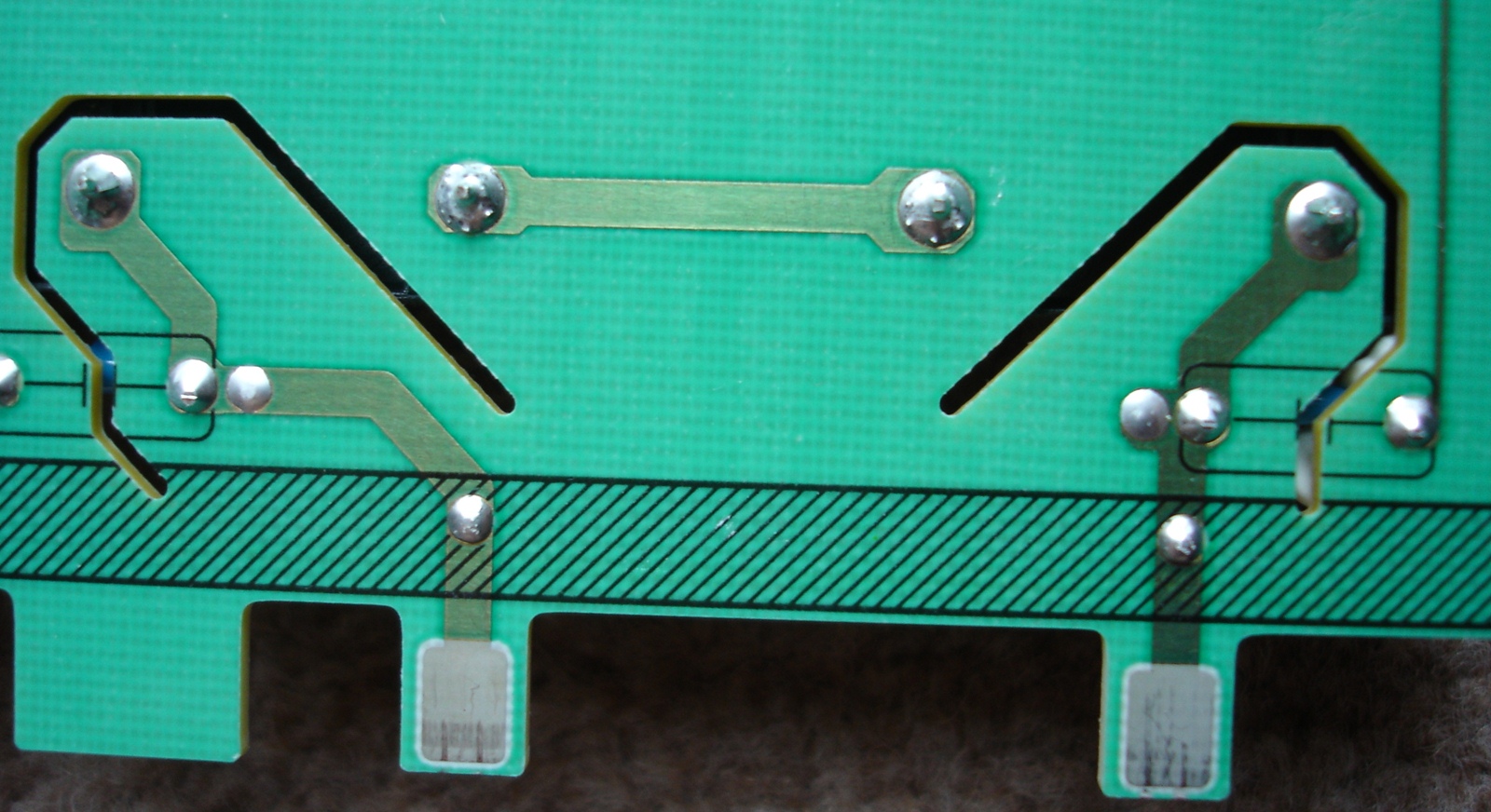

                      As requested, I've attached some pictures of the bottom of the board which hopefully are good enough. There are some close ups of the worst looking solder joints, but to my naked eye they still appear to be ok. Hopefully someone can spot something.
                        Re: Samsung LE40B750 flickering
                        Possible suspects imo (there might be many more of those)
                        Could be a cold solder joint somewhere. Try to get some kind of magnification and a bright light and go over the board. Even though your pictures are very good we dont get the "3d" of looking at it so it might be hard to spot if its not heating up and leave a trace behind (blackened board or similar).
                        Check the caps closely as well, some brands are known to bulge downward, dont remember if Samwha is known to do this but better make sure and check.

                          Those grommets/inserts make it harder to see cracks. A unit that stops working after it warms up suggests cracked solder joints, but capacitor characteristics change with temperature, too.
                          Replacing all the electrolytic caps except the two large 100uf 450V ones is cheap and would eliminate them as a possible problem.
                          Something I hadn't noticed before: the TV is 1.5 years old, but the power supply board has a 2008 manufacture date! That makes the chances of a recap fixing the problem even better.
                          PS: please use good, low-ESR caps. Anything sold by the badcaps.net store is good. Many people like Panasonic FM/FR/FC series, too. If you post your location, people can advise specific sources.
