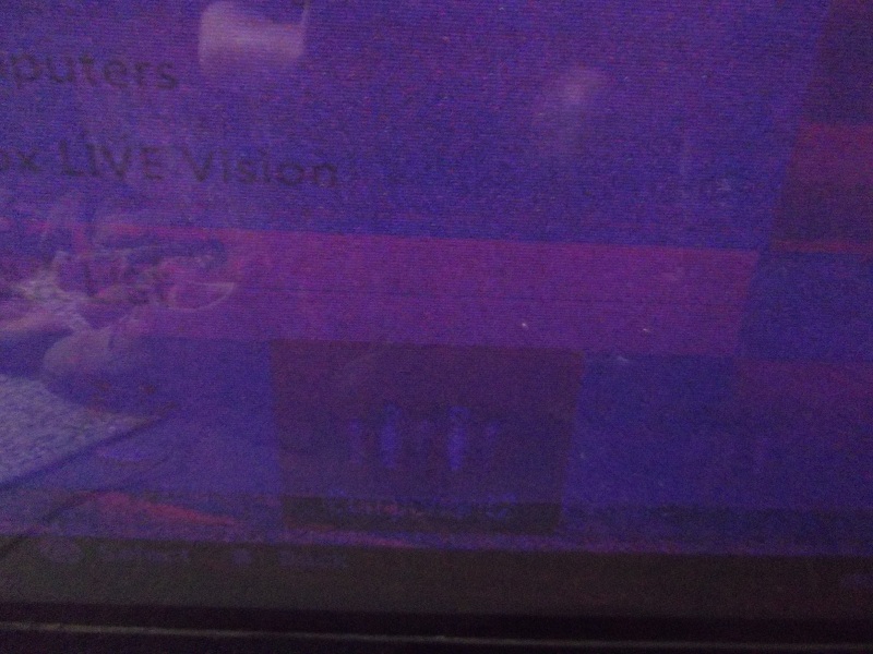

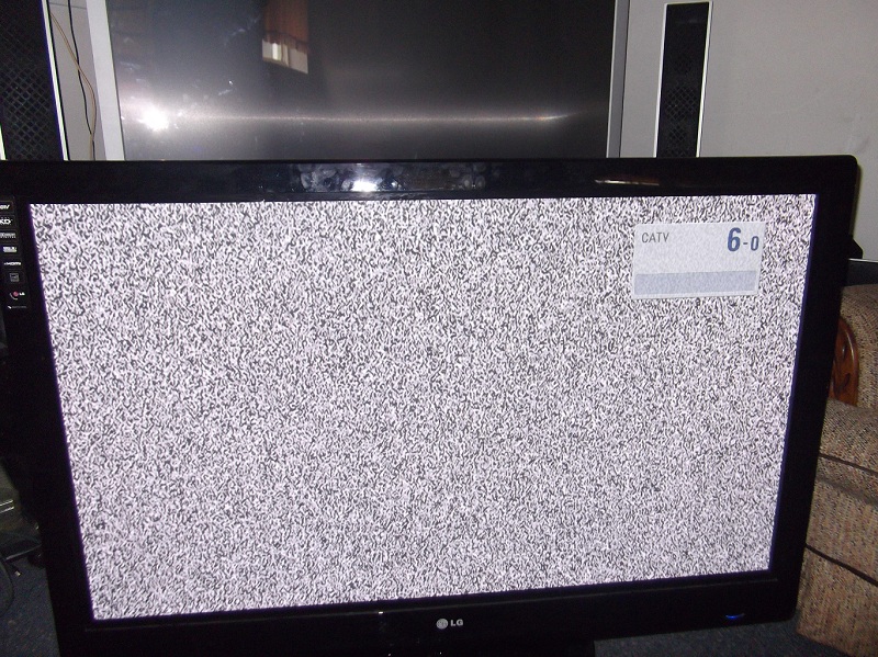

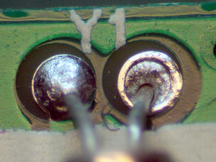

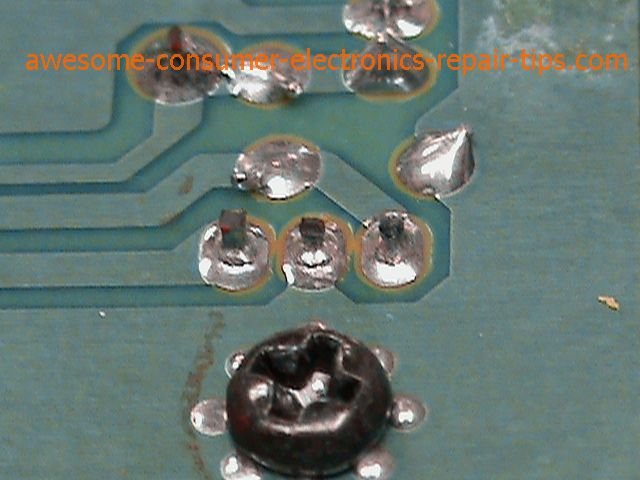

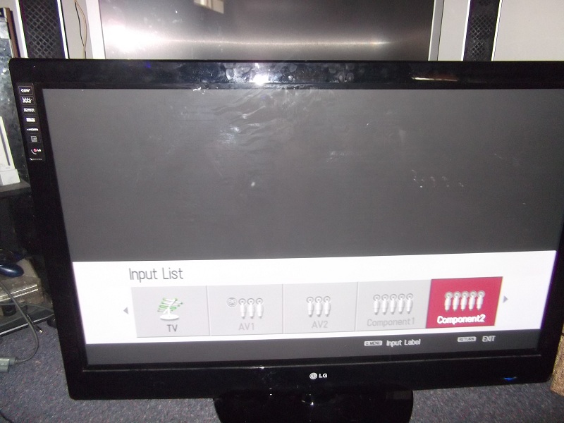

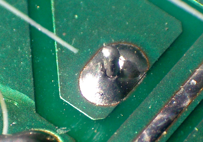

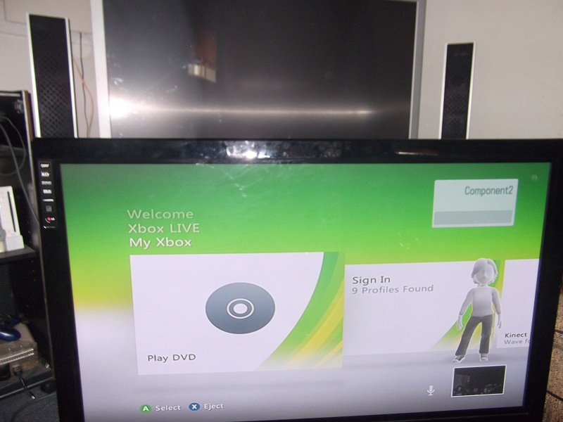

LG 50PG20 Plasma "weird display only with inputs"
  • PhyChris
    • 4
    LG 50PG20 Plasma "weird display only with inputs"
    Hi im Chris and i will start by saying hi to this grate community, hopefully i can save this grate tv from this hart-breaking situation. :'(
    Ok so the Tv is a LG 50PG20 Plasma and it displays the menu system and Snow fine (when RF is selected with no input) but as soon as i apply any inputs after a few minutes the TV Displays a darker image with garbage and overlapping (back-light is still on) i can power cycle the unit and the display is fine again for a few minutes but the problem returns.
    on close inspection i can see that 1st LED on the input board is yellow (green and red together) and the 2nd LED comes on green but shuts off shortly after power.
    any help in narrowing the problem to a specific board so i can replace it is greatly appreciated.
  • PlainBill
    • Feb 2009
    • 7034
    Re: LG 50PG20 Plasma "weird display only with inputs"
    Originally posted by PhyChris
    Hi im Chris and i will start by saying hi to this grate community, hopefully i can save this grate tv from this hart-breaking situation. :'(
    Ok so the Tv is a LG 50PG20 Plasma and it displays the menu system and Snow fine (when RF is selected with no input) but as soon as i apply any inputs after a few minutes the TV Displays a darker image with garbage and overlapping (back-light is still on) i can power cycle the unit and the display is fine again for a few minutes but the problem returns.
    on close inspection i can see that 1st LED on the input board is yellow (green and red together) and the 2nd LED comes on green but shuts off shortly after power.
    any help in narrowing the problem to a specific board so i can replace it is greatly appreciated.
    Service manual
    I don't trust 'eyewitness' descriptions; frequently they are inaccurate. I'd suggest posting several pictures. Note links in my signature and use 'Manage Attachments' (below the text entry area).
    1. A picture of the TV with the menu displaying.
    2. A picture of the screen with an OTA signal displayed as soon as power is applied.
    3. A picture of an OTA signal displayed after the picture goes bad.
    For what it's worth, all analog and digital inputs are processed on the main board and sent to the logic control card. Menus are also generated on the main board.
    PlainBill
    Last edited by PlainBill; 04-30-2011, 04:41 PM.
    • PhyChris
      • 4
      Re: LG 50PG20 Plasma "weird display only with inputs"
      Thank you for the quick reply. here are some Pic's of the tv
      this is the tv menu
      here is the tv when CAT is selected with no cable attached
      this is the tv with input before the problem (the image stays fine for 4-8 min's)
      and this is the tv after the problem (as you can see the TV's menus suffer from this effect as well)
      • cadillacman
        • Feb 2011
        • 524
        Re: LG 50PG20 Plasma "weird display only with inputs"
        dark pic...... zsustain issue?????
        • PhyChris
          • 4
          Re: LG 50PG20 Plasma "weird display only with inputs"
          ok so i have a test in mind that might help i just need an opinion if its a good idea.
          the control-board has an "auto-gen test pattern" that i can trigger (power off unplug main board power on and short two points on the board) so i turn the tv on with inputs and wait till the problem occurs then unplug the main-board (with power still on and hands insulated well) and run the control-board "auto-gen test pattern" to see if it generates a good picture.
          anyone else think this is a good idea? or can i damage more components trying to remove cables from an already powered set?
          Last edited by PhyChris; 05-02-2011, 04:46 PM.
          • PlainBill
            • Feb 2009
            • 7034
            Re: LG 50PG20 Plasma "weird display only with inputs"
            Originally posted by PhyChris
            ok so i have a test in mind that might help i just need an opinion if its a good idea.
            the control-board has an "auto-gen test pattern" that i can trigger (power off unplug main board power on and short two points on the board) so i turn the tv on with inputs and wait till the problem occurs then unplug the main-board (with power still on and hands insulated well) and run the control-board "auto-gen test pattern" to see if it generates a good picture.
            anyone else think this is a good idea? or can i damage more components trying to remove cables from an already powered set?
            Bad idea; REALLY bad idea. I would disconnect the LVDS cable from the main control card, pt on the jumper and let it run. If it fails after some time you can be sure the problem is NOT the main board, and you have a merry chase figuring out what is bad. If it does not fail, the problem is almost certainly the main board.
            PlainBill
            • PhyChris
              • 4
              Re: LG 50PG20 Plasma "weird display only with inputs"
              ok so i ran the test the way you said and have some results! The problem still happens after a few minutes so i sat behind there and found that the 'Z-SUS' was making a buzzing noise that increased when the screen was displaying a full white picture and when the problem would occur that the 'Z-SUS' would go silent as if it shut down.
              so i ran another test, I powered up the TV with the with the 'Z-SUS' board disconnected and boom the screen looks the same way it dose when it have my hart-breaking problem
              to break it down encase i did not come across clear i can reproduce the exact same issue by powering up the tv with the power supply disconnected from the 'Z-SUS' board
              ok so how do i go from here? is there any way that an adjustment on the 'Z-SUS' board or power board can fix this? or should i just go and buy a replacement Z-SUS Board?
              • cadillacman
                • Feb 2011
                • 524
                Re: LG 50PG20 Plasma "weird display only with inputs"
                the safe bet, yes replace the z zuztain board if you can find a new or good used one FROM A REPUTABLE SELLER.
                However... this may be worth looking at with a magnifying glass..
                Bieng this keeps working cold, and stops hot, you *might* have a cracked
                ( a.k.a. "cold") solder joint on that board. Resoldering it will fix it if that is the case, so this is worth checking..
                You will see various things but i will post some obious ones, caracterized by a ring or circular crack in the solder. In rare cases the solder will actually be fried and tarnished looking compared to the rest.
                Best of luck and happy hunting!
                ( also check power supply board pins where the power cable connects toat goes to the ysustian)
                • mrcrazynutz
                  • Apr 2014
                  • 9
                  Re: LG 50PG20 Plasma "weird display only with inputs"
                  Did anybody ever figure this issue out?? I am having the same issue on my lg 50pg20...
                  Don't want to have to start a new thread if the problem is already described on this thread!
                  My TV works great for the first 15-30 mins. but then looses the brightness and gets a pink/bluish pixelated look afterwards. Have to unplug it for a few days before it starts working well again and then looses the picture once again... what should I check first?
                  Try first? Could this be a power board issue?
                  • rccrasher65
                    • Mar 2014
                    • 622
                    Re: LG 50PG20 Plasma "weird display only with inputs"
                    Start your own thread, you'll get a better response. If you need parts, I have working good parts from my Lg 50PG20.
                    • Ted29946
                      LG 50PG20-ua Plasma TV repair help
                      by Ted29946
                      I'm new to this so I hope I'm doing it right So....I picked up a LG 50PG20-ua Plasma TV (Someone's throwaway pickup) First power up no picture or sound
                      Found power board to be bad and I repaired it. (Bad caps) Now all power volt readings are good. Still no picture or sound. I plugged in power cord, no click and the standby light on the on/off button comes on blue as soon as it is plugged in and does not turn off when button is push. I then pulled the main board off to look at it better and the initial inspection (front and back) I cannot see anything bad. Before I put the board back
                      10-24-2024, 11:12 AM
                    • LITEZONER
                      Panasonic TH-65PF9UK 65" plasma display weird issue
                      by LITEZONER
                      forgot to put the model number in the last post, could not edit it, guess I waited to long. anyway, has anyone seen this weird issue on one of these plasma sets, I was thinking maybe a loose ribbon, but wanted to check if anyone had seen this before. thank you...
                      10-22-2021, 09:27 PM
                    • Loki_Fido
                      (Weird) BIOS info for HP Pavilion Aero 13-be1021AU
                      by Loki_Fido
                      Hi folks,
                      This HP Pavilion Aero 13-be1021AU came to me for a repair. And it seems to have a weird BIOS chip. (Pic attached)
                      I asked my CH341A to read it and doesn't even know what to do with this. We are both very confused.
                      BIOS - XMC 25RU128CH10 (1.8v)
                      What the heck is this? I looked all over the MB. This is the only bios.
                      When I asked the NeoProgrammer to detect it, it just pops up an empty screen, and asked me to enter the bios number. And when I did, it doesn't do anything. NeoProgrammer showed me just this SPI ID: 204418. Don't know what...
                      03-20-2025, 01:57 AM
                    • paulstef
                      Weird blurry -no-picture on Plasma TC-P60S30
                      by paulstef
                      Hi
                      This TV has no picture, or nothing that resembles a real picture, just some slowly changing blurry forms and pixels. It ends up having a jumping white square in the middle, presumably the "no source connected" message, I guess.
                      Front LED turns on normal. Vsus is 209.8V. +15Vc is ok also.
                      Power semiconductors on all boards tested, ok. SS and SC board LEDs are lit. (Tnpa5400 and Tnpa5399)
                      I should mention the TV was extremely dusty when I got it.
                      What else could I test?
                      Thanks...
                      12-23-2020, 03:30 PM
                    • ArMaaN376
                      Samsung PS51E550 Plasma TV
                      by ArMaaN376
                      I am having Samsung PS51E550 Plasma TV. While the TV was working, a crackling sound heard & video went off with audio still ON. After switching it off & ON, the red LED on TV blinks six times & then off.
                      Opened TV cover & observed foll
                      a) Green LED on the small PCB blinks at @5-6sec ON & off for 3-4 secs. Red LED on logic board ON
                      b)Vs & Va on power supply board raises momentarily to 209v & 58v resp & then drops.
                      c) Cold test on Y-main board shows all 3 pins of FGPF4536 IGBT short to Grnd.
                      How to confirm Y -Buffer board...
                      06-19-2024, 04:05 AM
