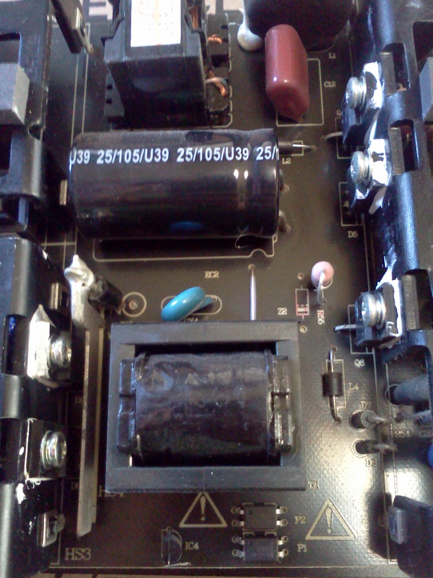

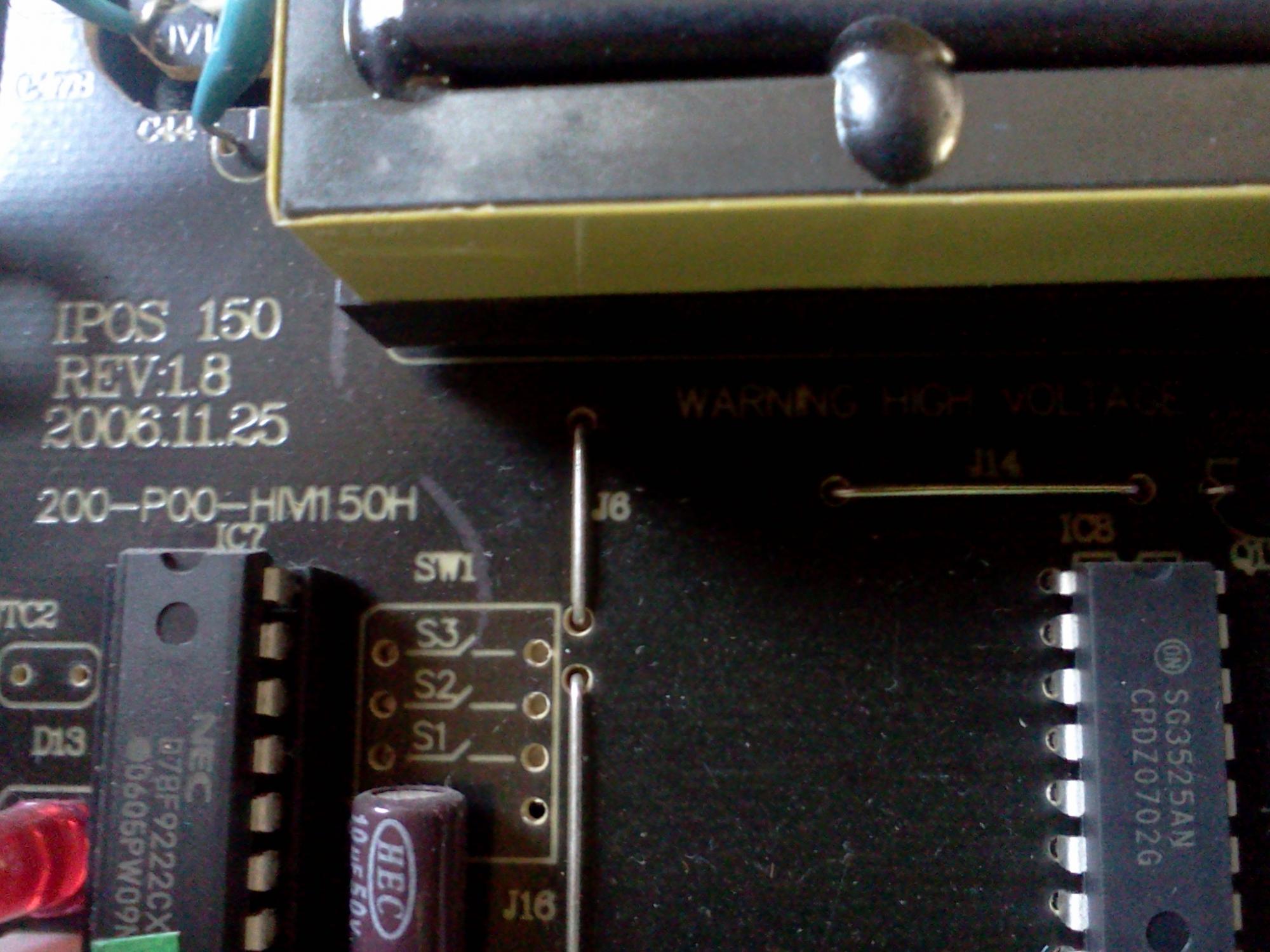

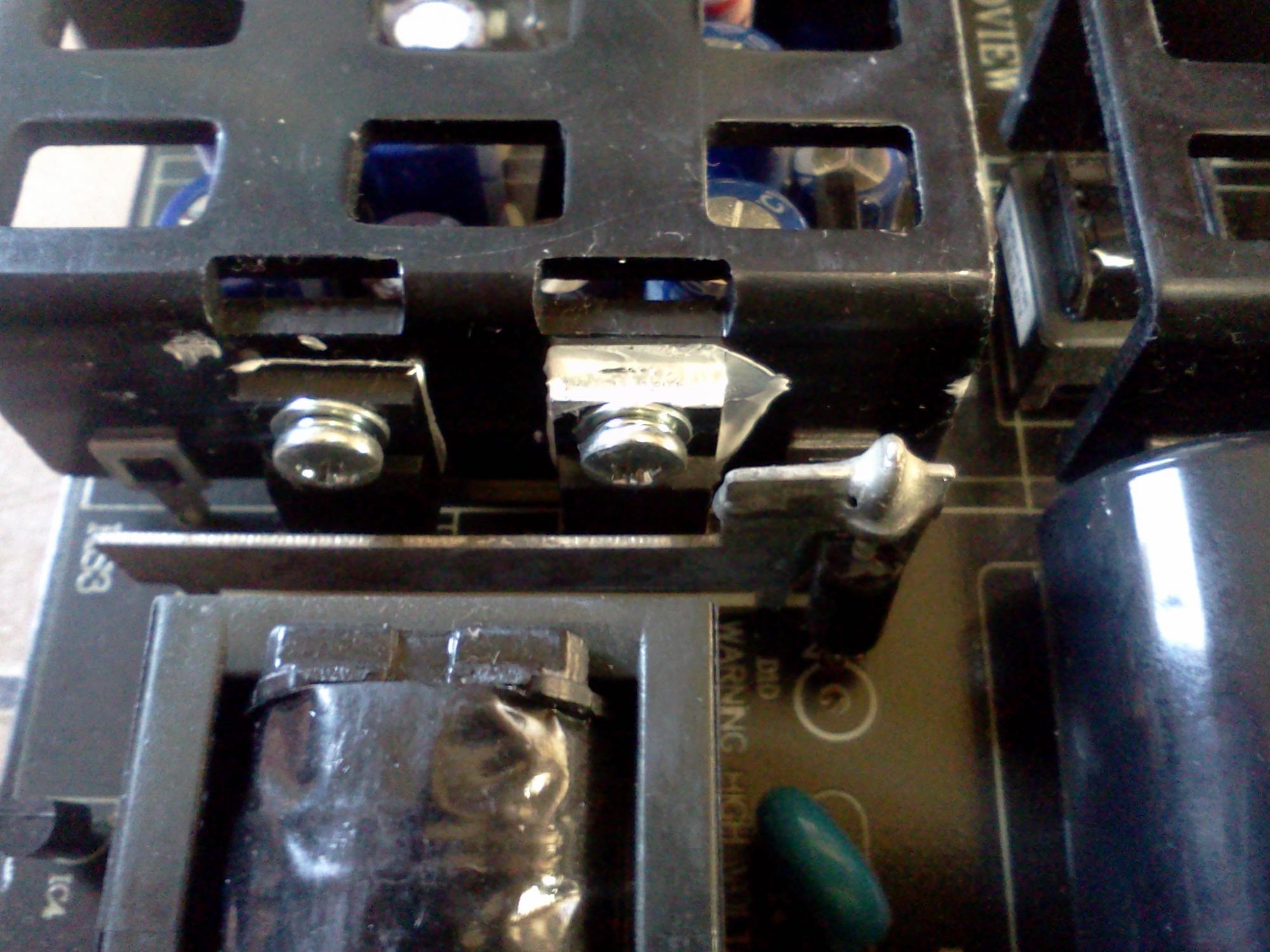

    I just got this Tv from a neighbor today. He said he plugged his computer into it and when he turned it on the screen went blank he said it had happened to him once before but he left it alone for a while and it worked fine. Now its toast so i took it off his hands.
    Iv torn the tv apart and looked at everything. The PSU is a IPOS150rev1.8 with no signs of dmg except one on the bottom of the board pic 1. the tv will power on with a red light and nothing else you can hear the speakers kick on but that's it. I've done some research on these forums and a few others and found that D10 is usually to blame I don't have a multimeter at my disposal as of yet. So I cant test voltages. "see what i can do to find one" on the bottom of the board where the leg of the Diode D10 connects the trace seems to be lifted off the board slightly. is this irreversible dmg to the board or can i just solder a new trace? Any help on this would be great would love to put this tv in the living room.

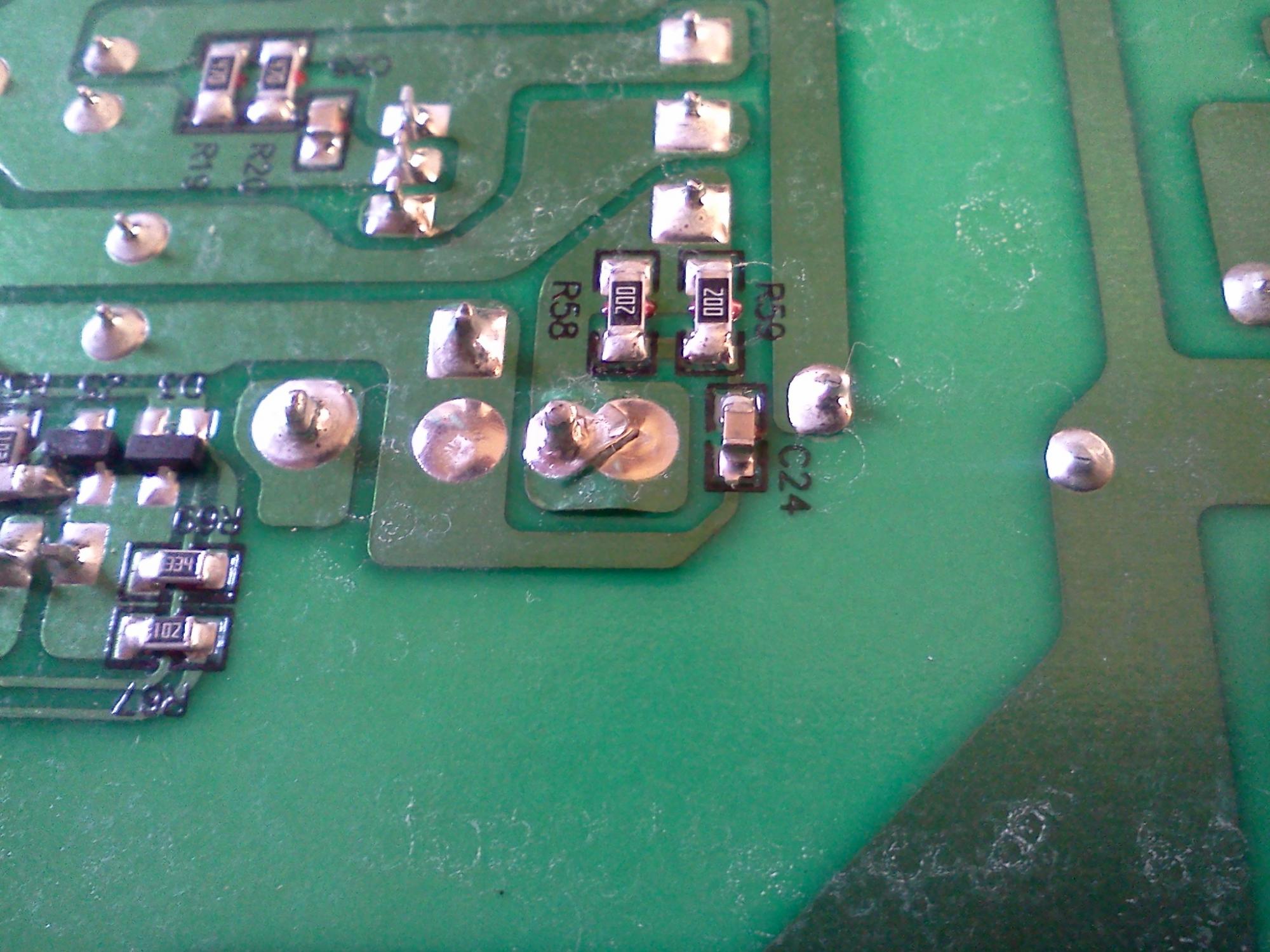

    Re: Polaroid 21-860-AZO-IPOS150H Rev1.8 Issue
    The trace being lifted isn't hurting anything. As long as the pins are soldered to it good. The trace isn't broken. You can put a drop of super glue under it and hold it with a small screwdriver till it dries or leave it as it is. I guess that's D10 that is connected to the heatsink (pic 3). The heatsink looks like it got pretty hot. What's the number on the side of the diode?
      Thanks for the fast reply.
      the number on the side of the diode is
      B608
      R303
      pretty much what i thought about the trace just double checking. everything els on the PSU and the main board look fine nothing out of the norm that i can see. trying to get my hands on a mutli.

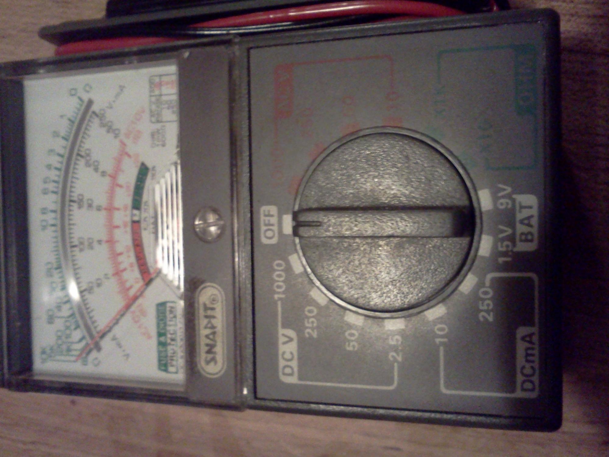

                Ok so i got the Multi but im not used to this type of mutli and its been a while since iv used one. any direction on exactly how to use this one to check this diode and other components would be greatly appreciated "a refresher of sorts "
                • OCybress
                  • 23
                  lol answered my own question. So i tested the Diode with x 10Ω and the reading was 0Ω with the black connected to the anode and the red connected to the cathode. same when reversed both read as 0Ω.
                  Testing a diode with an ANALOGUE multimeter
                  * Set the analogue multimeter to a low value resistance range such as x 10.
                  * It is essential to note that the polarity of analogue multimeter leads is reversed on the resistance ranges, so the black lead is positive (+) and the red lead is negative (-)! This is unfortunate, but it is due to the way the meter works.
                  * Connect the black (+) lead to anode and the red (-) to the cathode. The diode should conduct and the meter will display a low resistance (the exact value is not relevant).
                  * Reverse the connections. The diode should NOT conduct this way so the meter will show infinite resistance (on the left of the scale).

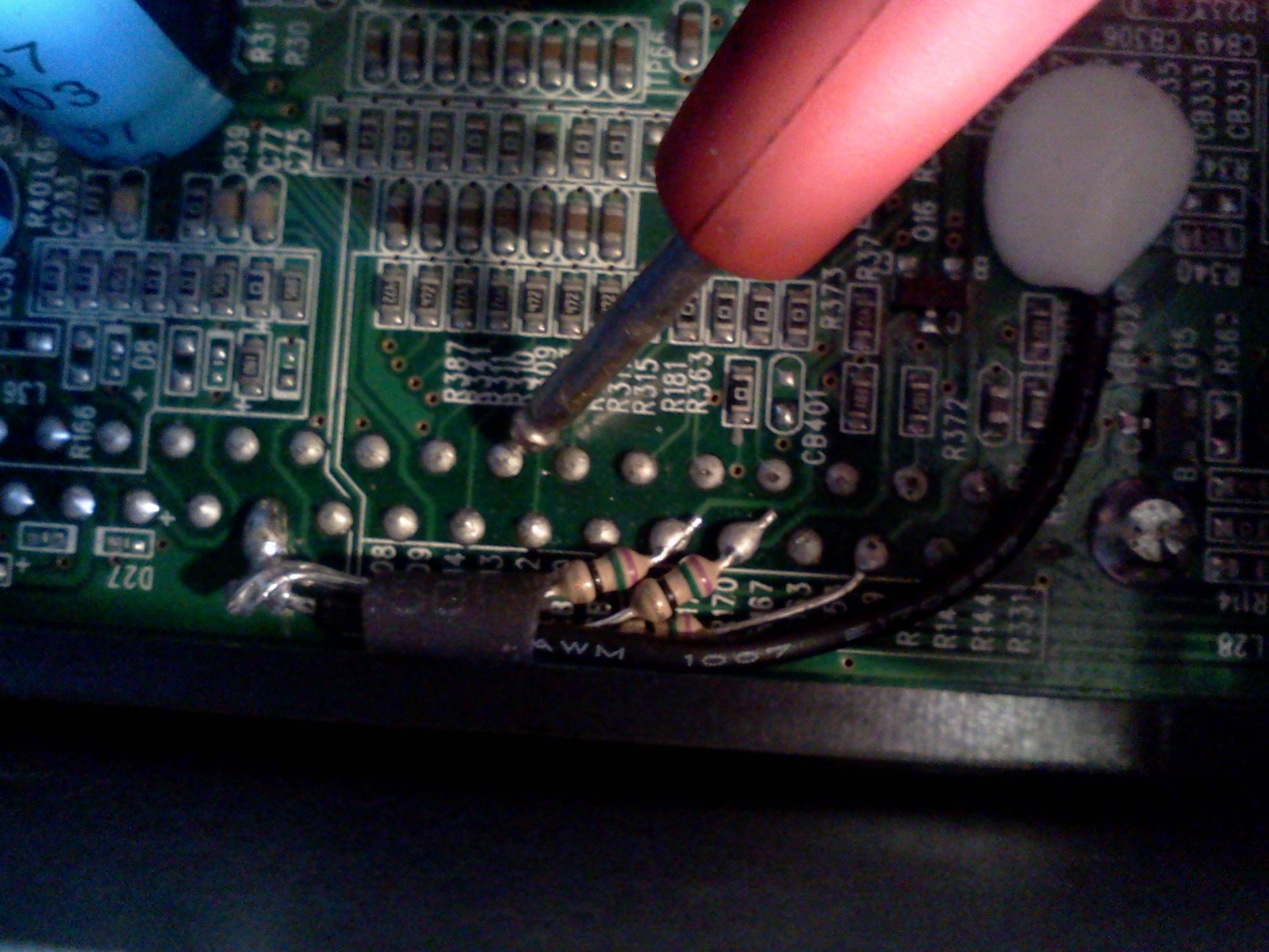

                      Got a digital Multi now. Ok so i pulled D10 and got a 7.8ohms and 0ohms reversed "pretty sure im not very good at testing diodes lol". so i put it all back together and started testing
                      CON3
                      20V = 23.7vdc
                      AGND
                      GND
                      GND
                      12V = 11.5v - 11.6vdc
                      5V - no wire
                      5VSB = 5.09vdc
                      STB = 4.7dc
                      CON4
                      GND
                      no wire
                      BK_ON = 0.0vdc
                      no wire
                      no wire
                      APWM = 3.0vdc
                      none of those values change when i hit the power button cept on the point in this pic. when i push the power button it goes from 3.5vdc to 0.0vdc. and it looks like it has been referbed at one point in time. left of the point im checking are 3 risisters. connected to one point i get 0.0v on all.
                      anyhelp? would be great. and if im doing anything wrong plz let me know so i dont waste time trying to replace something i thought was bad.
                        The digital meter probably has a diode checker on it. On the ohms scale you just read it on , it is shorted. Most digital meters have a diode symbol, you may have to hit range switch or function or something to go to diode (which should show on the display).
