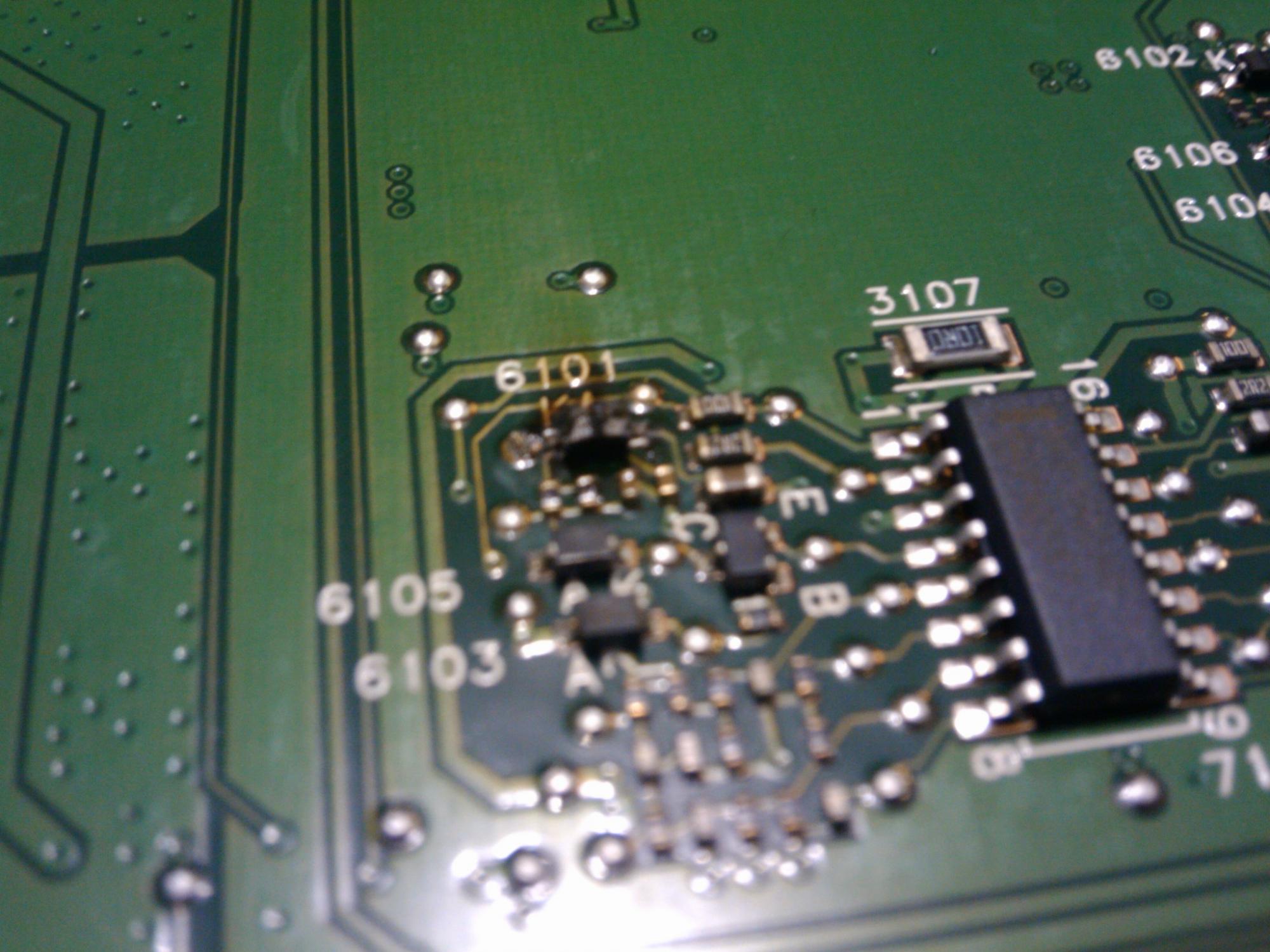

    So now I decided to remove the SSB (or at least that's what I think they call it) and discovered that one of those conductive foam thingy had dropped behind the SSB and shorted two points on the solder side...

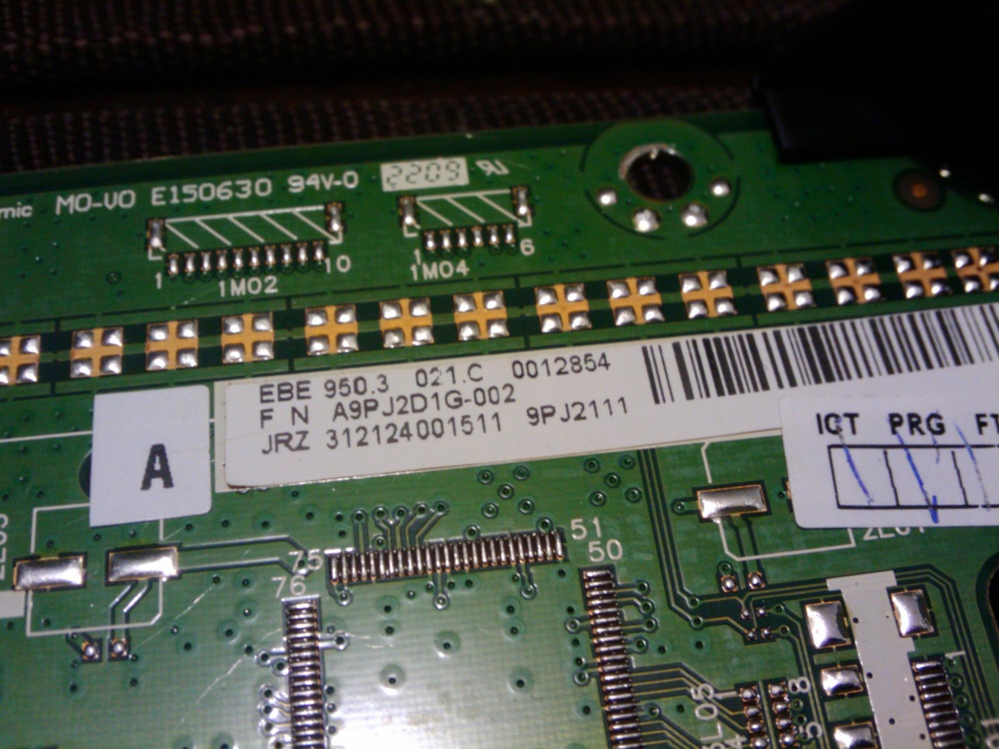

    fyi, label on SSB: EBE 950.3 021.C 0012854 F N A9PJ2D1G-002 JRZ 312124001511 9PJ2111

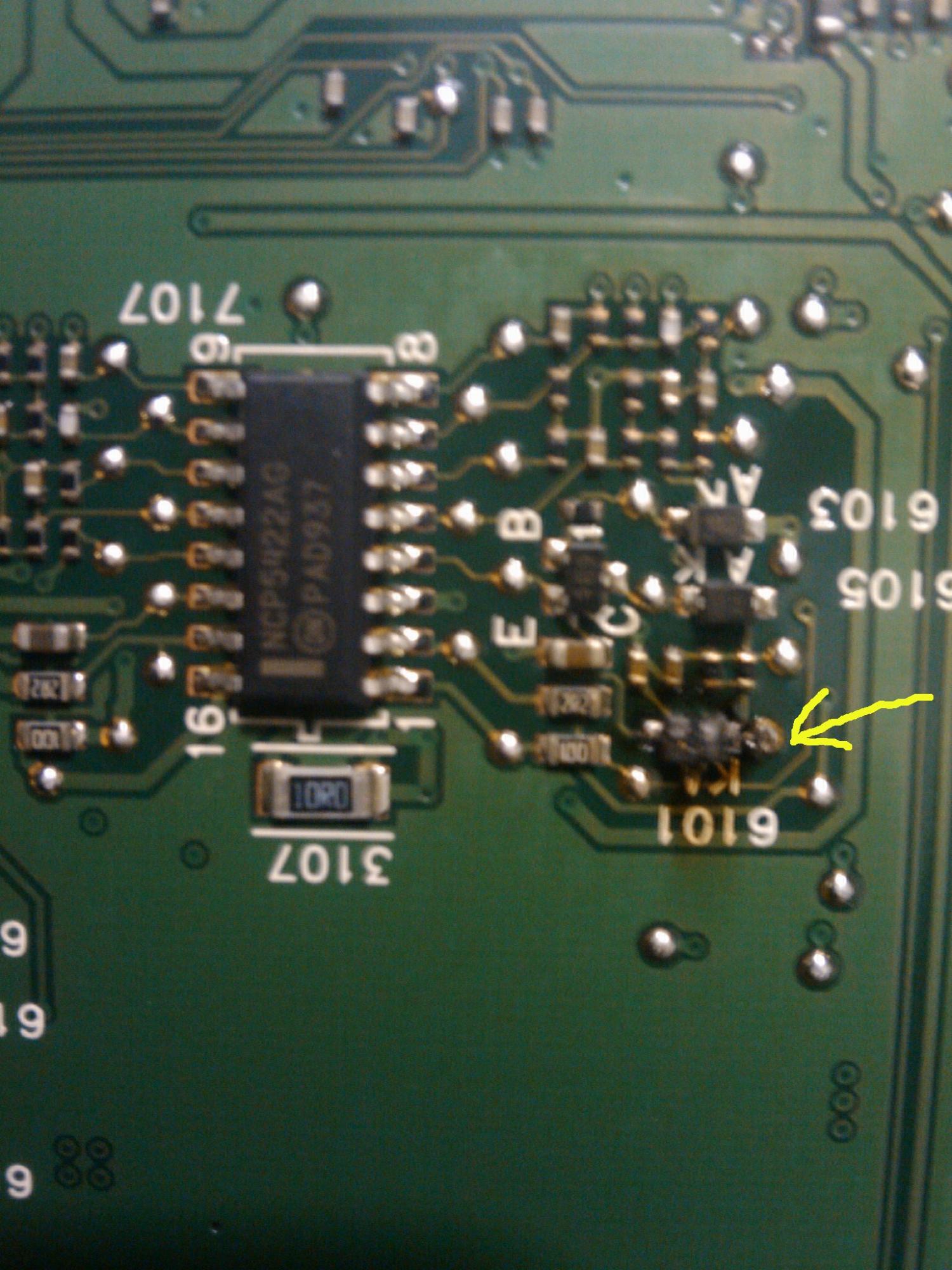

    So that's basically where I am now... so far it looks like only 2 simple SMD devices were destroyed (assuming no ICs or other critical devices got zapped along the way of course...). I assume they are either resistors or diode (one of them as the marking 'K A' beside it so I assume that's a diode. It's close to the NCP5422AG Buck controller and the label 6101.

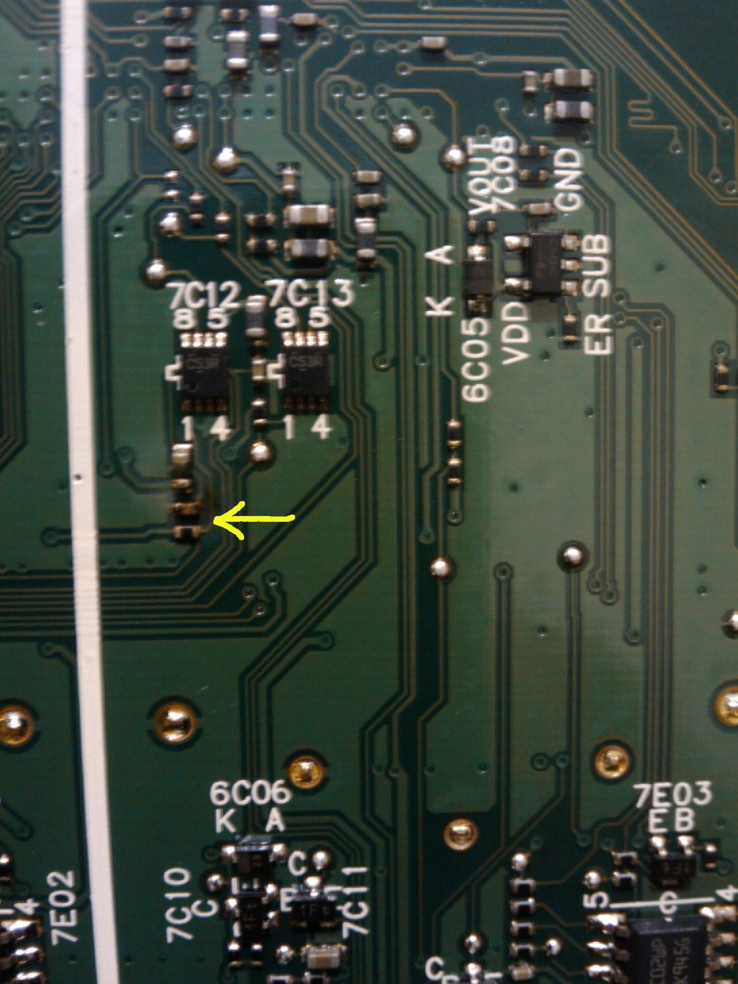

    The second shorted point is near a very very small 8 pin SMD device label 7C12 with engraved markings of C53R but couldn't find much on those.
    I'm looking at the 5422's data sheet to figure out which part it might be but having access to service manual and/or schematic would be very helpful if anybody can provide one... anything close to my model would be nice as the only other ones I've found on the net were fairly old.

    Close to the NCP5422AG IC I see a similar chip with what look like the exact same configuration (most probably another regulator block) Reading the markings of the "diode" corresponding to the burnt one shows "A6".... same as the other one which matches the suggested usage schematic in the data sheet's sample application section...
    Based on that extrapolation they all appear to be Zener Diode...

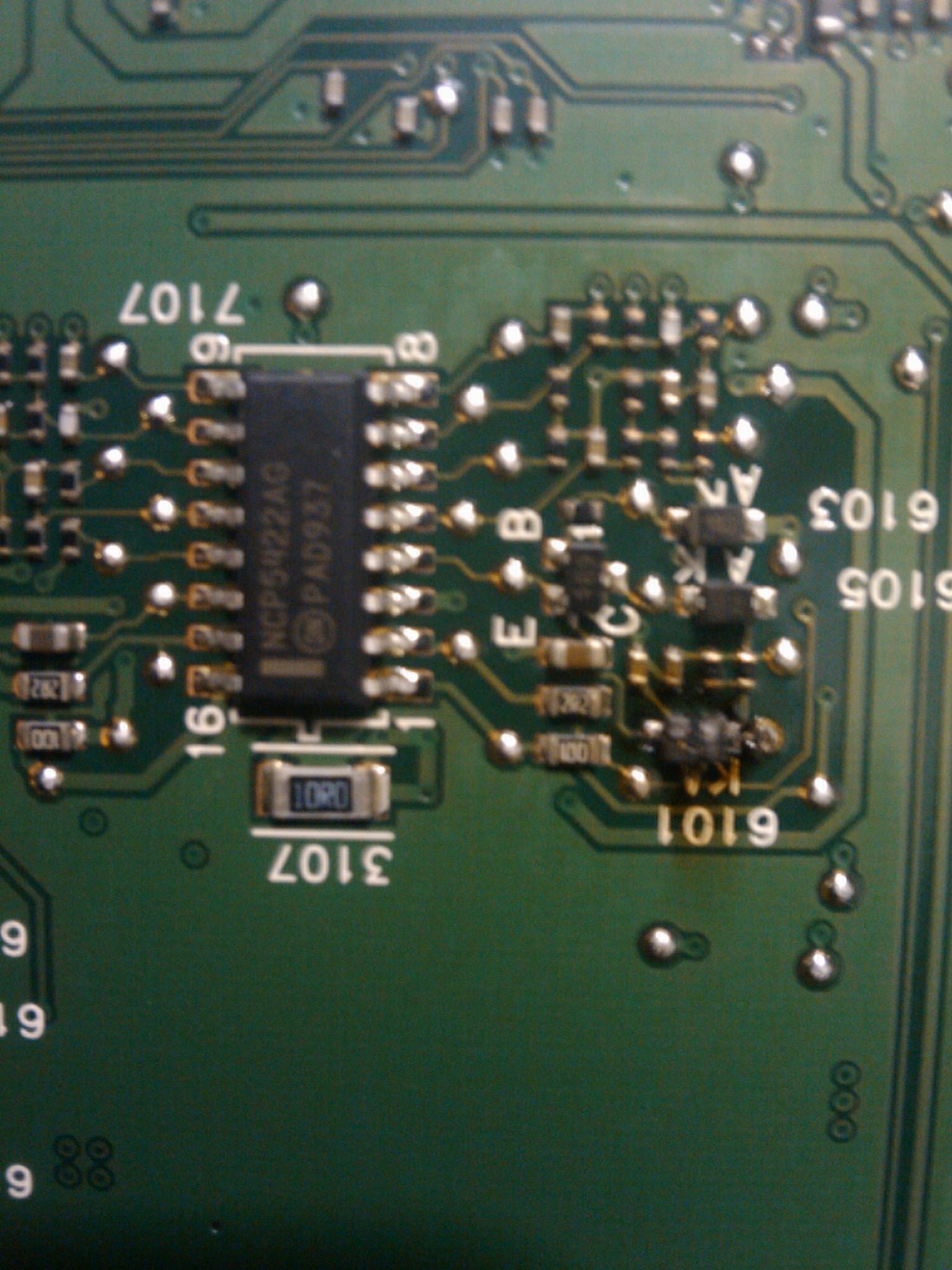

            Here's a few pictures... I apologize but my camera died so I'm stuck using my older android phone.. I'll try again with my HD webcam..

              Ok, I couldn't get any better pictures sadly so here are the same pictures with the burn part highlighted..

                It's unlikely (but not impossible) that is (was) a zener diode. Here are some ideas.
                The NCP5422A is a dual regulator controller. There is a very good chance the two sides are symetrical. It looks like the switching transistors are on the opposite side of the board.
                SMD code A6 crosses to a number of diodes, none of them seem to match this package.
                I've checked the numbers you listed; 312124001511 seems to be the part number of the assembly; it's used only on this TV.

                  I tried cross-referecing the A6 marking using the"SMD codebook" and it might actually be 'A6p' as it would match the package type more accurately (SOD323). It's possible as it's so darn small I couldn't see much more. The codebook says it's an BAS316 switching diode from Philips (duh!) with a leaded equivalent to BAW62 (1N4148).
                  I also found a SM for a different TV that uses the NCP5422 here. THere's a schematic for the dual setup with similar voltage outputs and both seem to use the BAS316 too.
                  What worries me though is the other end as I can't seem to find anything that has a marking of C53R so far... I'll have to see if I can find anything unique about it so I can track it in that aforementioned SM.

                    Somebody answered my SM request on ElektroTanya and I was able to double-check my work. The diode in question is in fact a BAS316. I used an equivalent (non SMD) 1N4148 to test my work and the TV came back to life so I'll have to order some SMD part to do the job right.
