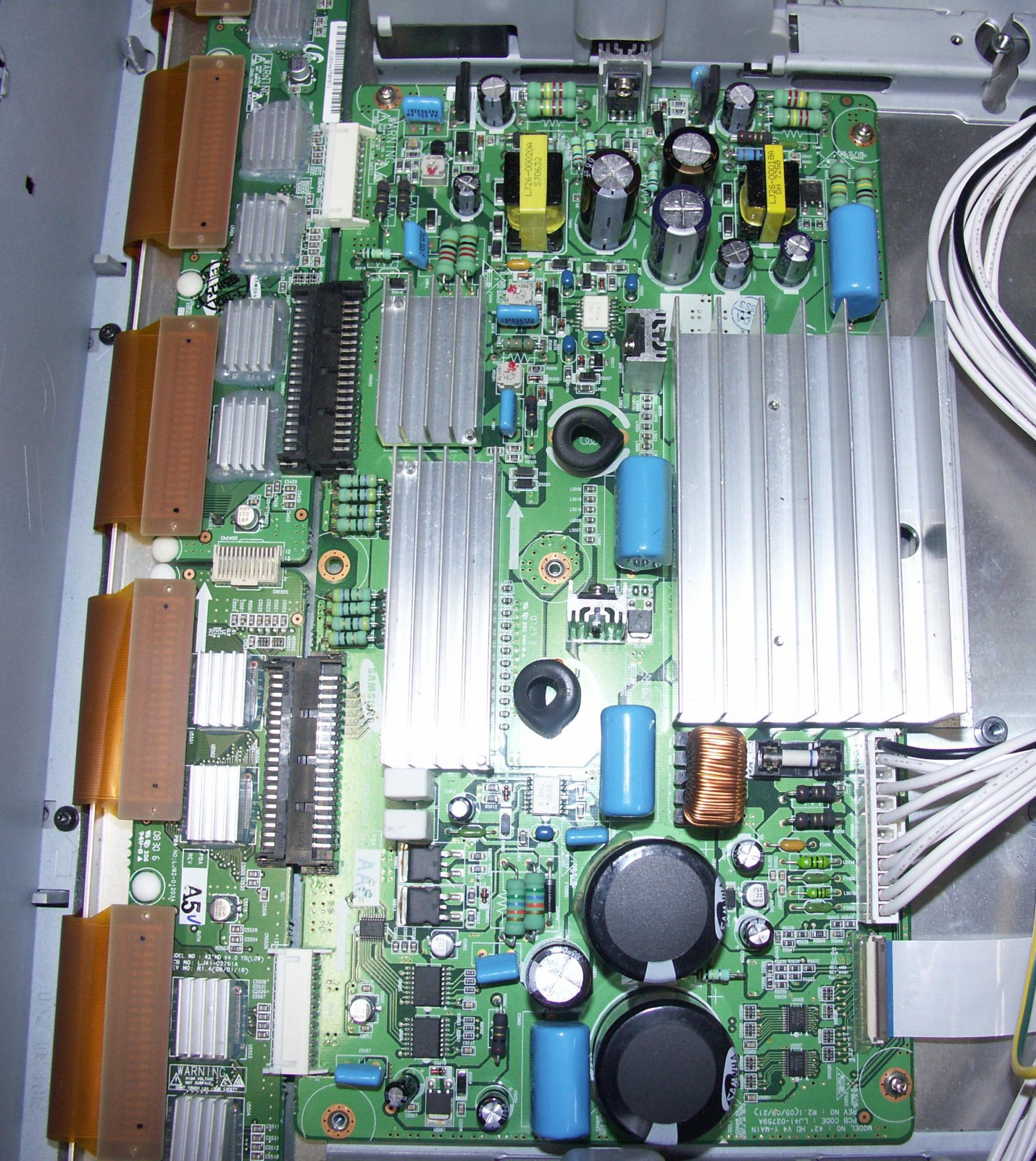

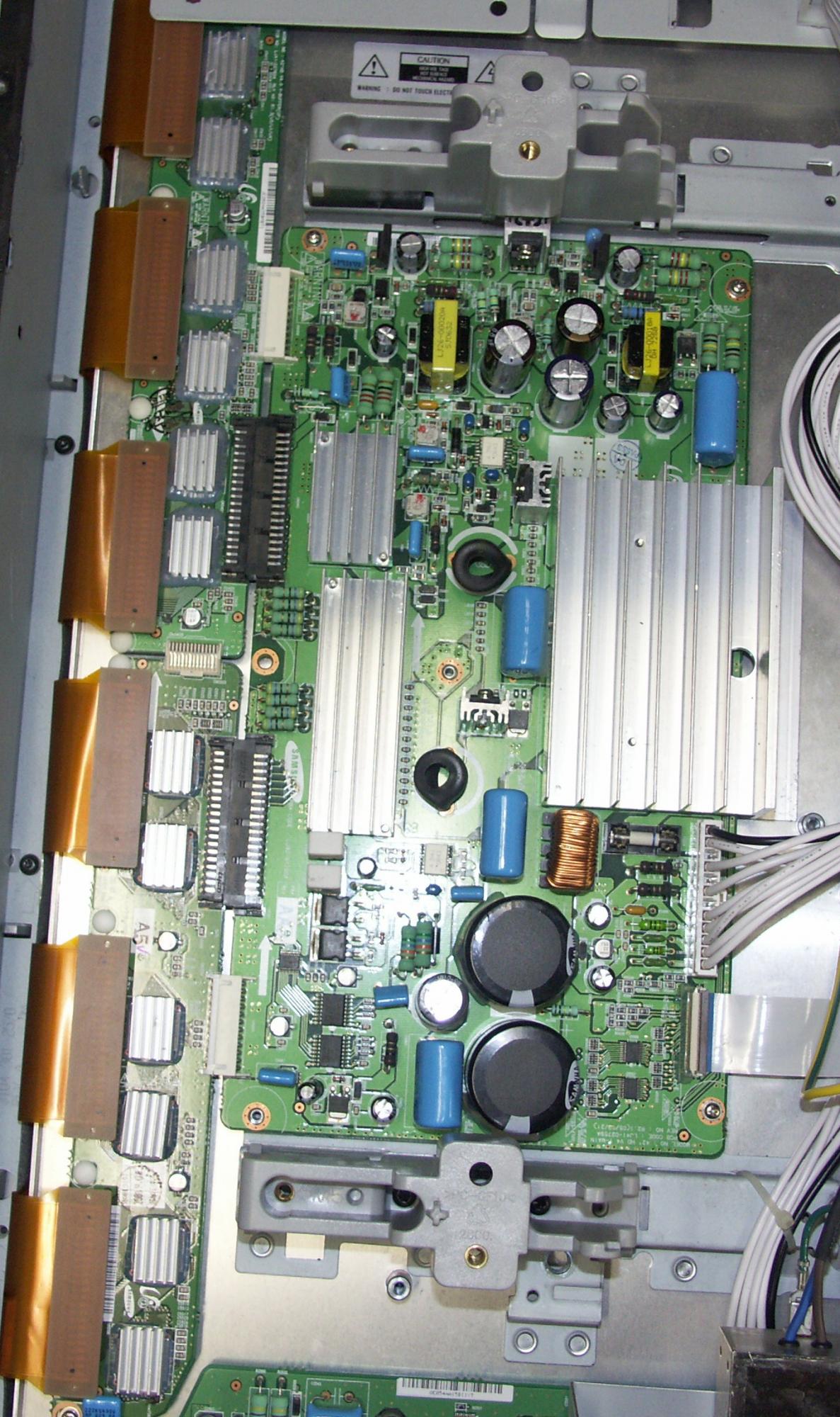

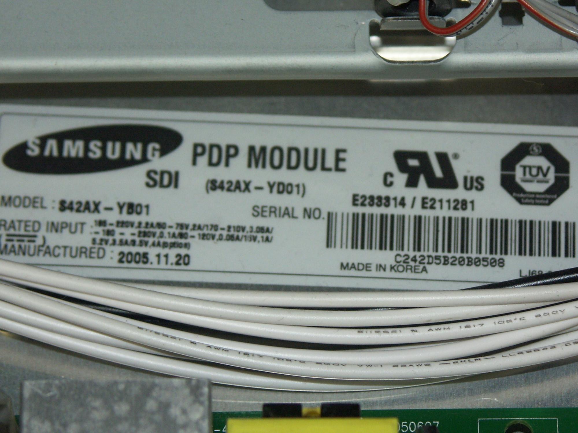

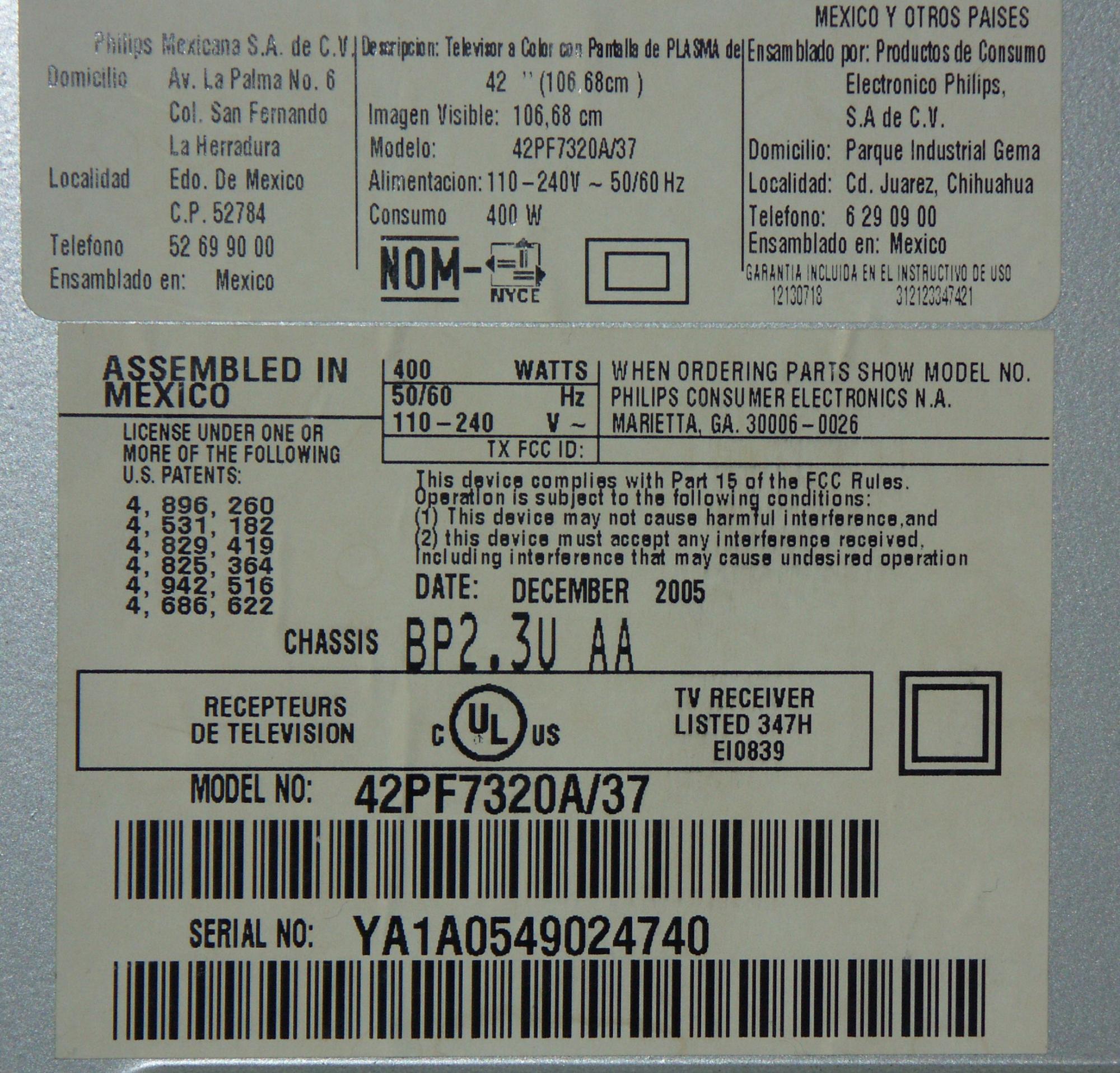

    hey guys working on this phillips 42" plasma..
    i actually have two of these, got them in a bulk deal...
    It has red and blue snow on the screen, that flashes. Thats all i can get it to do after power up. also looks like some oil slicking going on as well.
    ok heres the deal.. i have one totally torn apart, one mostly togther but was missing ysus and buffer boards. I opted to try to fix the one that(was) mostly togther.
    Took the loose ysus and buffers from the other set, the lower buffer board has one chip burning hot.. swapped with another buffer board, different chip running hot, swap with lucky#3.. this one runs cool so i think were set there for now..
    swapped ysus boards, no change. Swap xmain boards, no change. Swap video input boards no change. changed the little board that all the ribbon cables meetup at, no change.
    Power supply is working. wtf is going on here. I might have to call these a lost cause because who knows wtf is any good here..

    Re: phillips 42pf7320a/37 blinking screen+sparkles

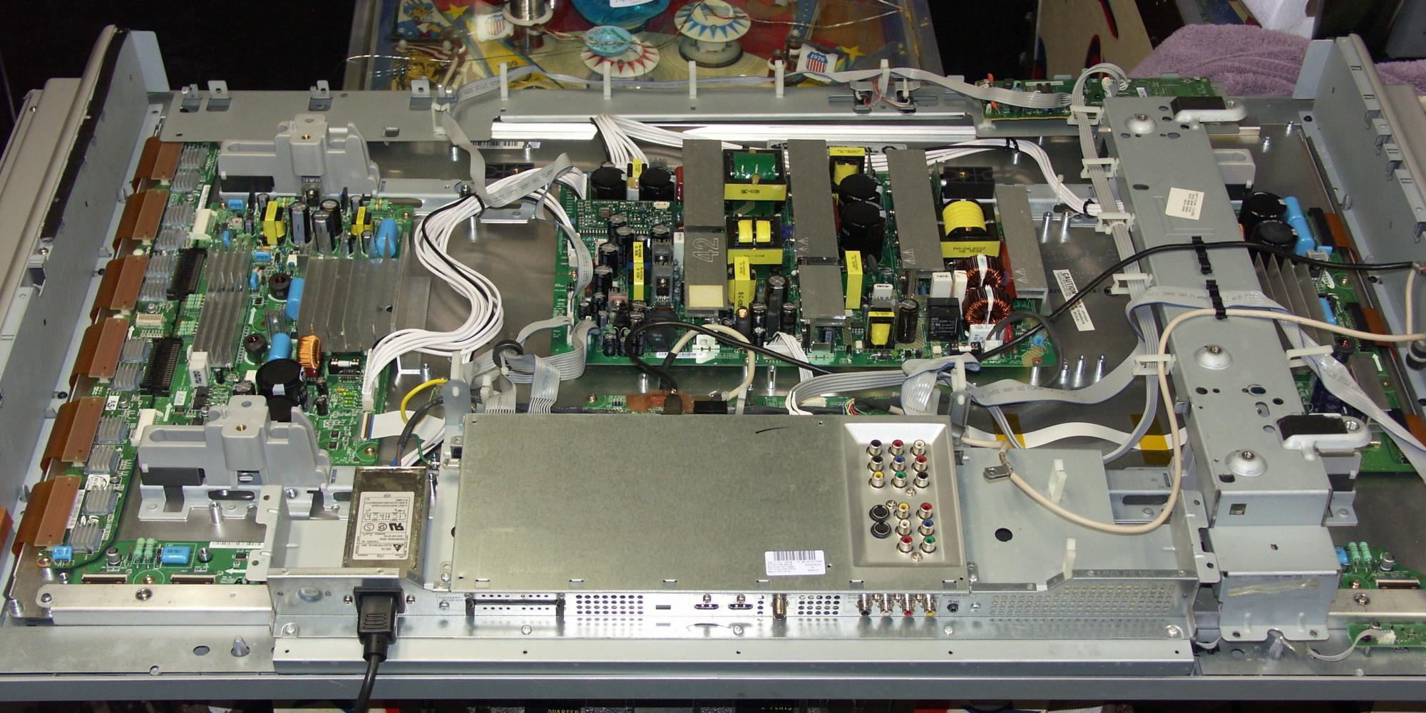

    I need more information, and you can do this two ways.
    1. Provide the part numbers of the Y-Sustain, upper, and lower Y-buffers.
    2. Provide a good top-down picture of the Y-sustain.
    PlainBill

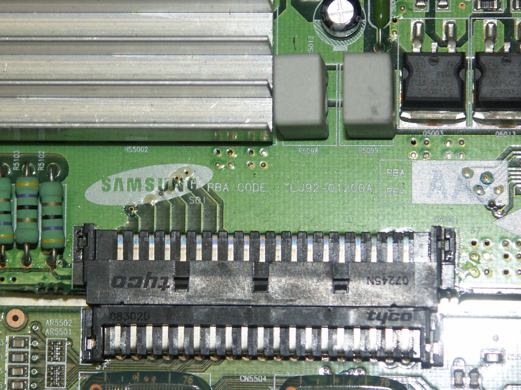

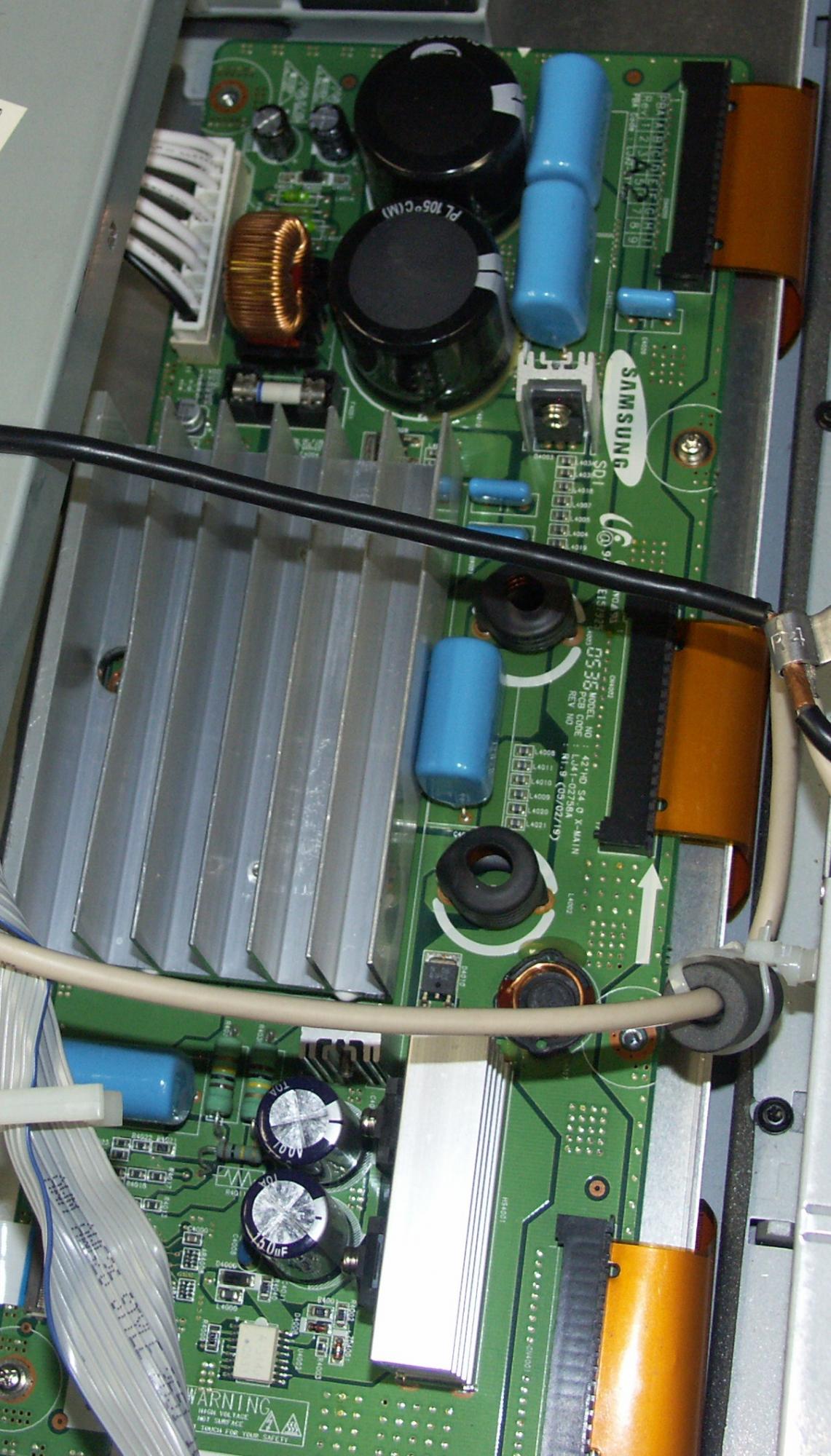

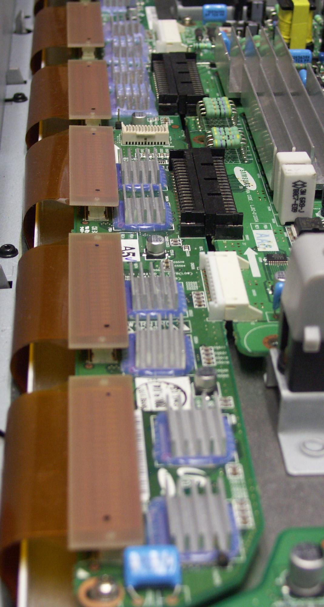

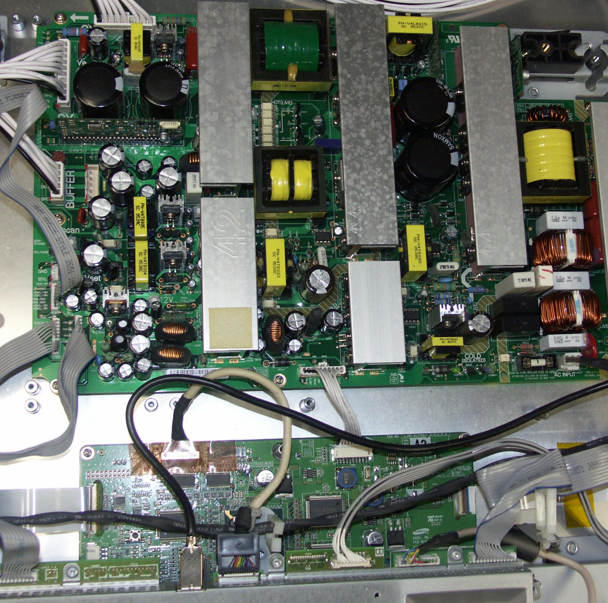

      i will most definately get some pics later tonight...
      THis set could be running fine with just screen issues, theres no input button just menu, bieng the menu is unseeable i cant go any firther to see if it has audio or not..
      • cadillacman
        • Feb 2011
        • 524
        Ok here we go. Wish me luck. If you want any other specific shots ill be happy to take them.
          These aren't worth fixing. Your problem is bad buffers and y-main. All 3 will need to be replaced if you want to get these going. Parts will cost almost as much as the tv is worth. Even if it is only one board that is bad the others will not last much longer if you only replace the bad board. A week or two at most.

            Check these out:
            Link 1
            Link 2
            You can send off the y-sus and buffers to be rebuilt for ~$130 or you can repair them yourself.

                  I can confirm what daimoku said. Those panels are the pits. One buffer blowing will short a drive transistor on the Y-Sustain. The drive transistors are relatively inexpensive; it's replacing them that might be a challenge - they are are mounted next to one another.
                  It's not necessary to remove the heat sink. All transistors have the sources connected together, and all have the drains connected together. The gates are driven from a common point with a series resistor. By connecting one lead of a DMM to the drain and probing the gates of the transistors you can identify the shorted one. Coppell explains it here. By using a long thin probe you can touch the individual gate leads without pulling the heat sink.
                  Note this auction. The guy will provide a repaired Y-sustain AND test your buffers. I've contacted him, he runs the buffers in a working TV. This leads to a question - if a shorted buffer will blow a $7.00 transistor on the Y-Sustain, how can he afford to test buffers for free? One possible conclusion is he has some method of protecting the transistors. I'd like to know what it is.
