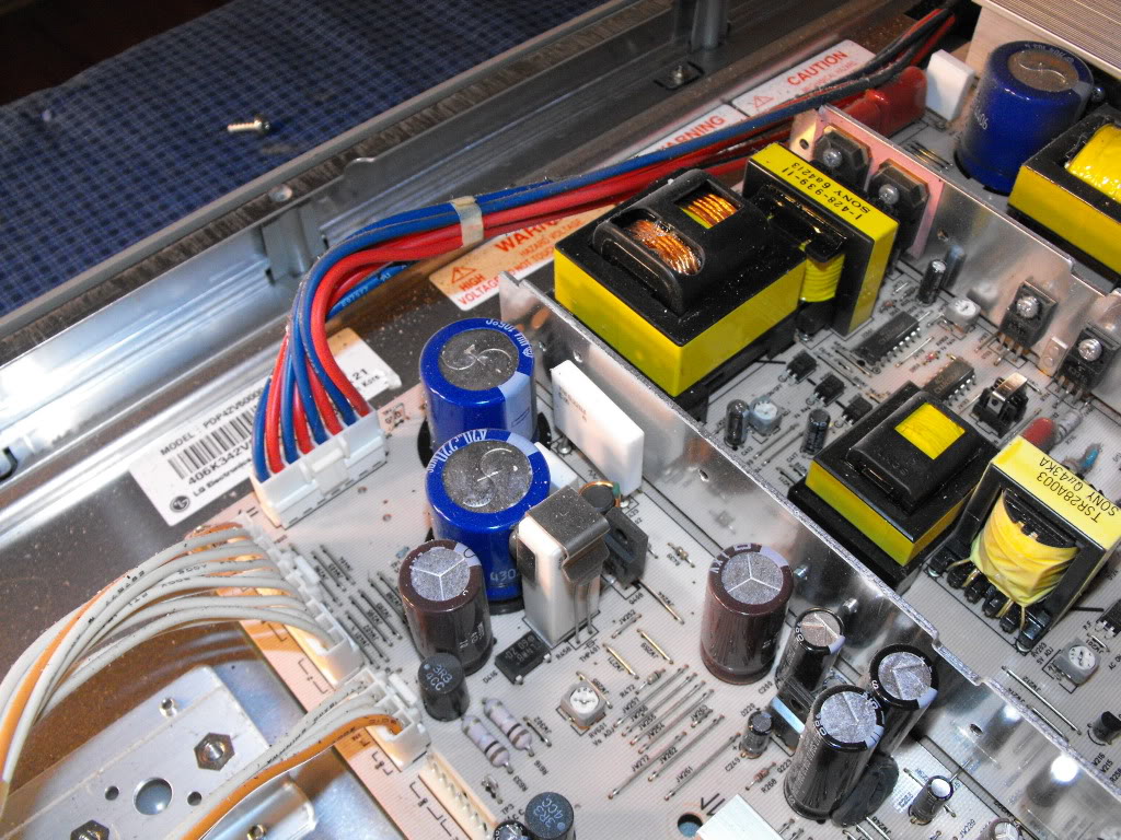

    We bought an LG 42" plasma TV about 7 years ago for $2500..
    Couple of weeks ago the video signal went on the fritZ. (Large block of white screen jumping around the display).

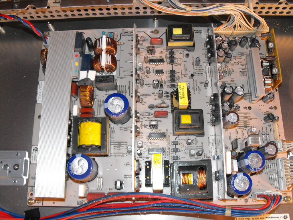

    I have been here reading since Dec.2010 and from what I have gleaned, I figured "Bad Caps". So I pulled the rig apart (complicated) and laid my eyes on 3 bloated caps, (pictures). Upon further examination I see two more slightly domed caps on the psu.

    Anyway, I have only been able to find the 680uF 250V caps of which I needed 4.
    The 2 each 420uF 220v 2 each 240uF 450v I have not been able to find.
    I Bought the 4 caps at TSM Inc. They sent out the wrong ones so now I'm waiting again for the right parts, maybe next week.

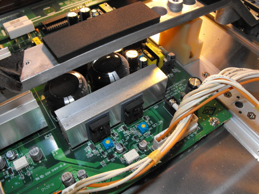

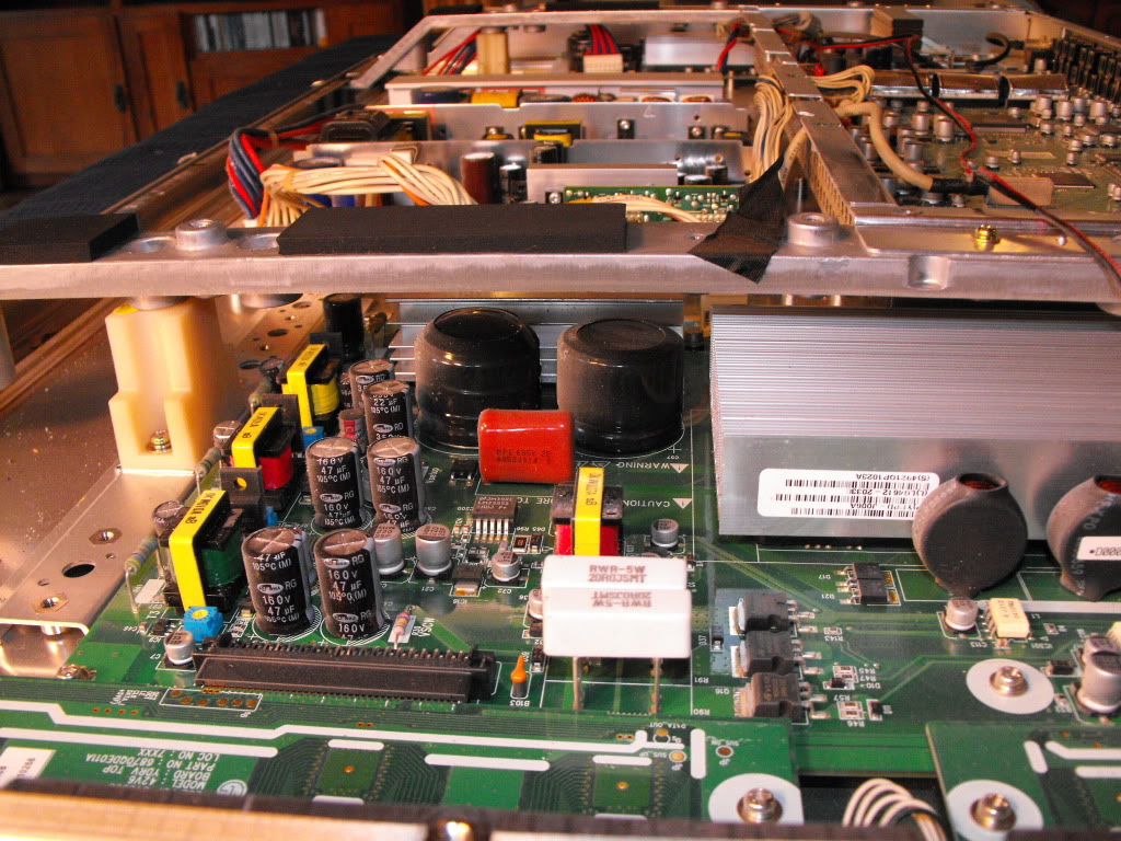

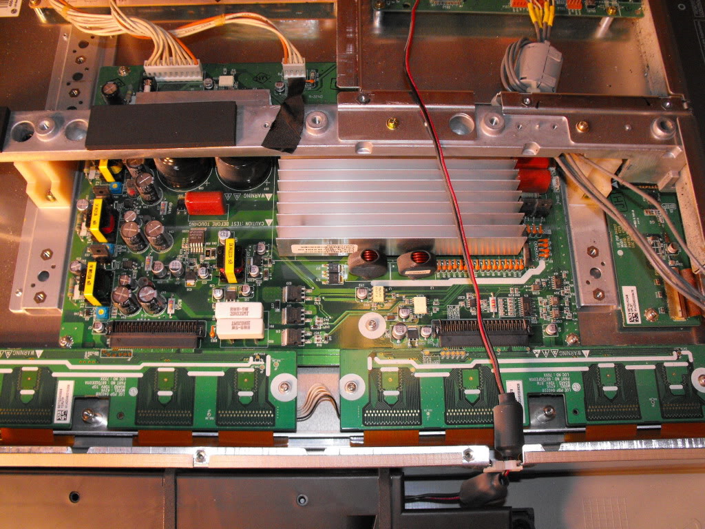

    You have to check fuses too. Don't worry about bloated caps, need to check big IC are not shorted. This take effort to change because of very heavy copper in the circuit board absorbing heat from soldering iron if soldering iron is not up to this task and issue of finding correct IC for 7 years old plasma. Once you know the status of ICs and fuses, then you can proceed repairing rest of TV with caps and parts. Otherwise you did right thing to buy new LCD.
    And don't forget the other ZSUS board make sure fuse on these is not blown and check big IC is not shorted as well.

      At digikey.com, you can get Panasonic capacitors that are close of the uF and voltage values above. The general rule is to keep the uF the same and you can go higher on voltage. Slight increases in uF are okay.
      So Panasonic has a selection 470uF 250V and 270uF 450V.
      So search for "470uF 250V Panasonic" and "270uF 450V Panasonic" at digikey.com. Choose your height and diameter properly so the replacement caps fit.

          Thanks for posting! I checked the fuses first thing, all good. I don't know how or which big ICs to check. I'll need instructions on this.

            Thanks retiredcaps for helping once again! I'll be ordering what you suggest.
