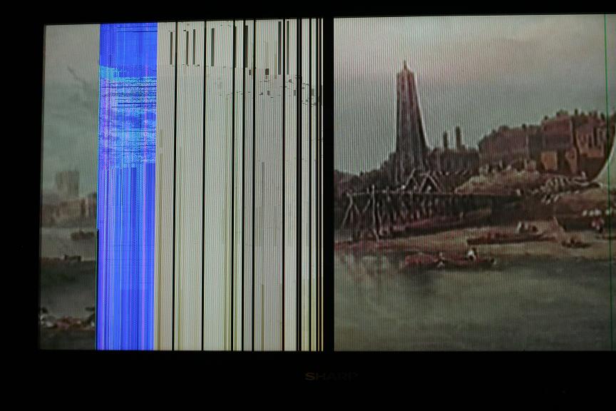

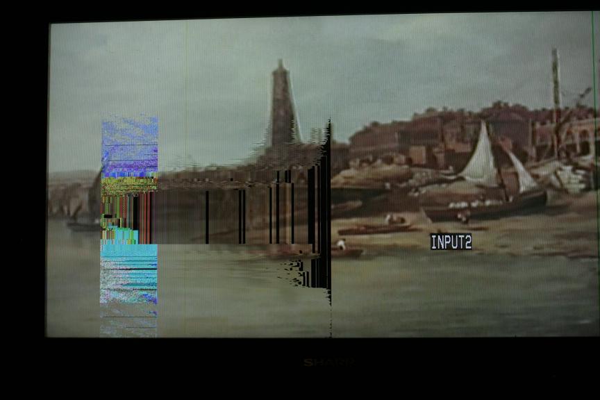

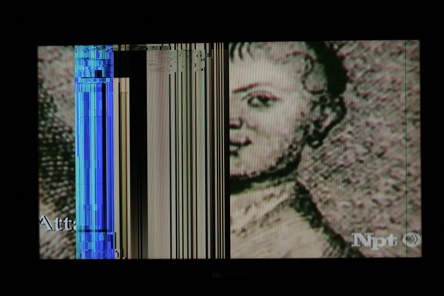

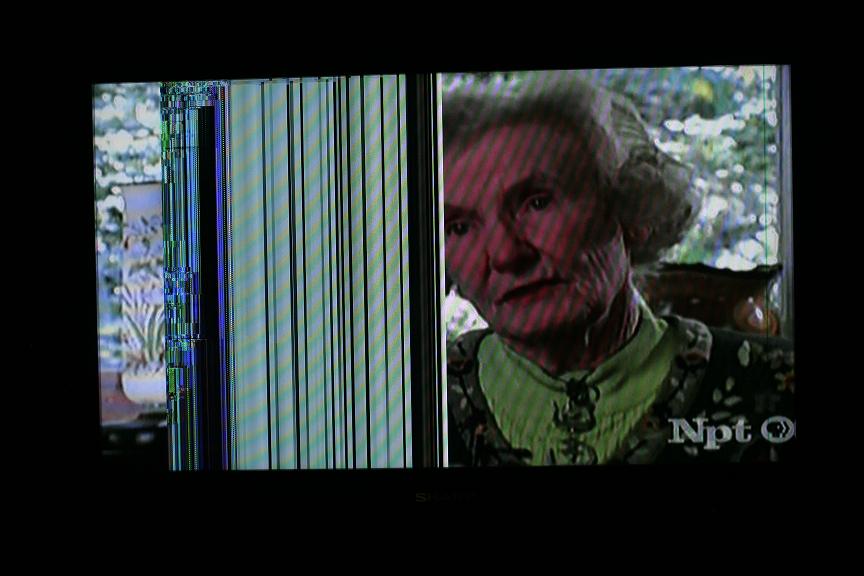

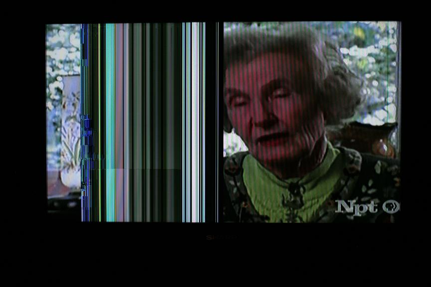

    Greetings-
    I have a Sharp Aquos LC-26D40U purchased new in December 2007 (warranty expired). Recently it began this: When turned on, the picture is fine and everything operates as it should. After a few minutes, the screen begins acting up as seen in the photos below. At first, if you turn it off for a few minutes and then turn back on, the screen returns to normal until it warms back up again. Obviously something heat related.
    With the nature of the problem, I suspected and replaced the T-CON board, but that didn't work. I also cleaned and tightened all ribbon cables and their connections. Mainboard?
    This happens regardless of input selected. If the menu is selected, it is also distorted.
    (BTW- all other artifacts on screen only show up in photo. Not actually there)
    Any help is greatly appreciated.

    Could be a few things, but I would say start at the video board becouse it does not seem to be consistant. I would look for caps that are going bad, or overheating logic chip. I would also check thecable going to the screen from it. and last it may be a bad screen, but it should do that all the time if it was, and flexing it would make it better or worse depending.

        I think Tab Bonds that run along the top of the LCD panel is lose
        check this http://www.avsforum.com/avs-vb/showthread.php?t=1173106
        check Posts: 27 by OnlyTono his had picture & step by step to fix you problem

          You were exactly right! I did as the thread instructed and it worked like a charm!
          Thanks sincerely for your help.
