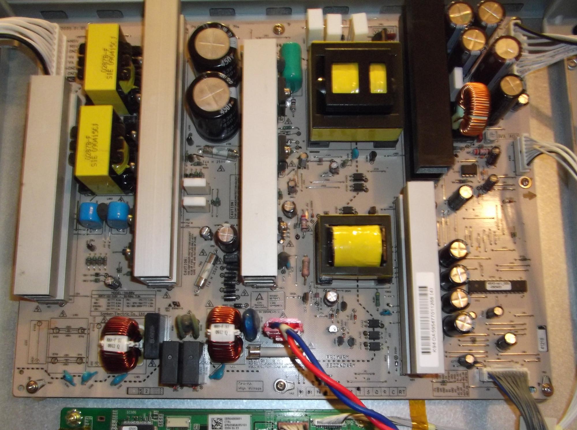

    Bad PSU that dies with usual load but works with lowered.

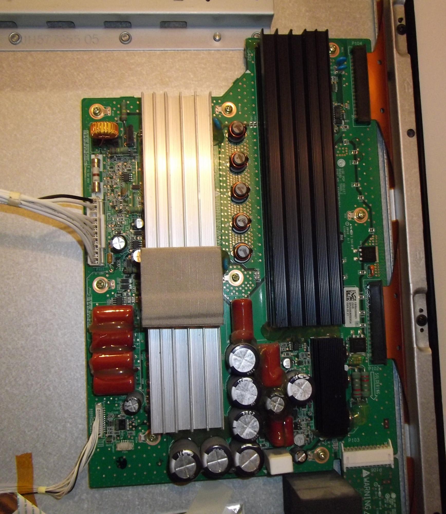

          The flashing led sequence may actually give you a fault code. Count the amount of flashes and try to find the service manual for the set at Elektrotanya.com. If you're lucky, the led sequence shows a defective Z-SUS and you may want to replace that board.
          Anyway, most service manuals provide their troubleshooting help like you already did - Disconnect one board at a time, power up the set. That board which refuse the set to power up normally is having a failure.
          Most Z-SUS and Y-SUS are possible to repair, but sometimes it might be worth to just replace the entire board.

              This is much newer design. Check fuses, then inspect the buffer ICs that runs vertically on left, those square black ICs for any cratered hole (blown out). If not, ohm measurment is needed.
              Even newer plasma TV design have no fuses on the ZSUS and YSUS boards, and a well designed SMPS that detects overload and shuts down.

                        however I tested board and found several Mosfets s/c including the ones available in a kit I have since seen advertised.
                        after repairing the ZSUS board I then looked at the 15vdd voltage and found this was missing. this turned out to be a faulty chopper Mosfet on the YSUS board, i replaced this and the set is back running again. I do however have issues with the temperature of Q13,14 &15. I have replaced all 100uf caps on the control board (also available in the kit I have seen) but the heat issue I have is still under investigation.

                            Replace the transistors on the Zsus heatsink as well ad the resistors in the kit. To fix the overheating of them replace ALL the 100uf caps on the control board and the little 47uf 50v cap on the Zsus near the heatsink with the failed transistors.
