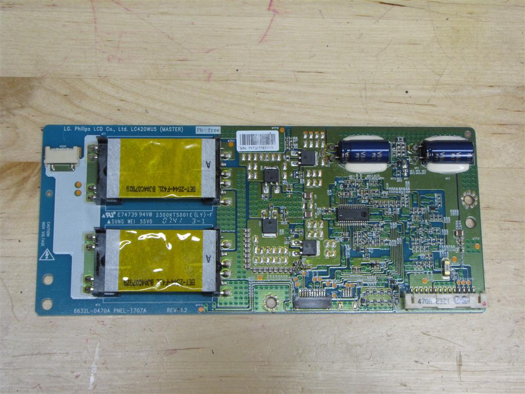

    My Vizio 42" will not turn on. I looked through some of the existing issues individuals have had on the same TV.
    I did notice that 2 of the 4 MOSFETs on the Master Inverter board measure less than 8.6Kohms (1 almost 0ohms and the other like 2.2Kohms). I removed those 2 mosfets and confirmed that they were OK. It appears my BD9897FS is no good on the Master Inverter board.

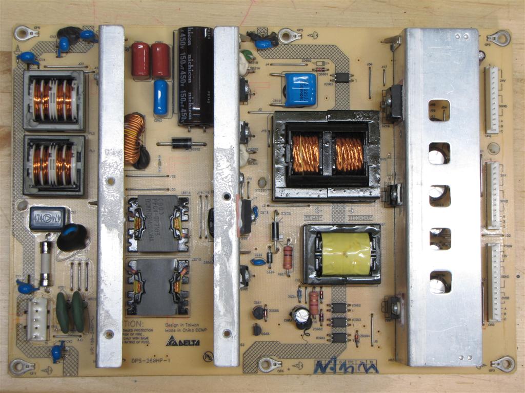

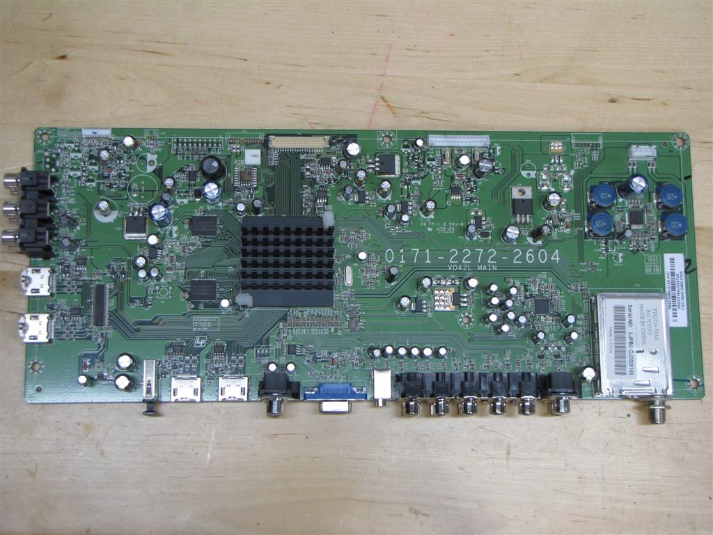

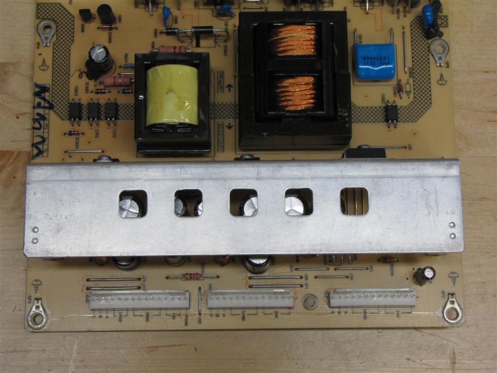

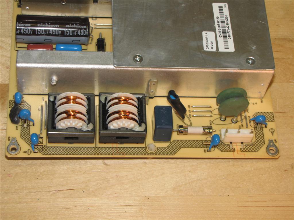

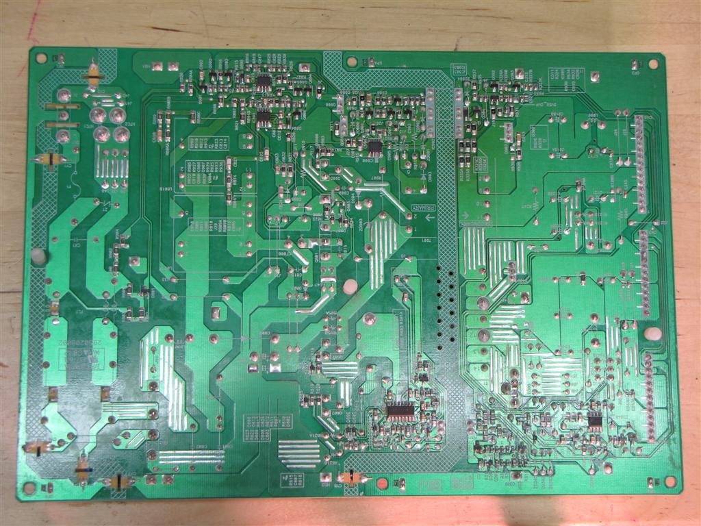

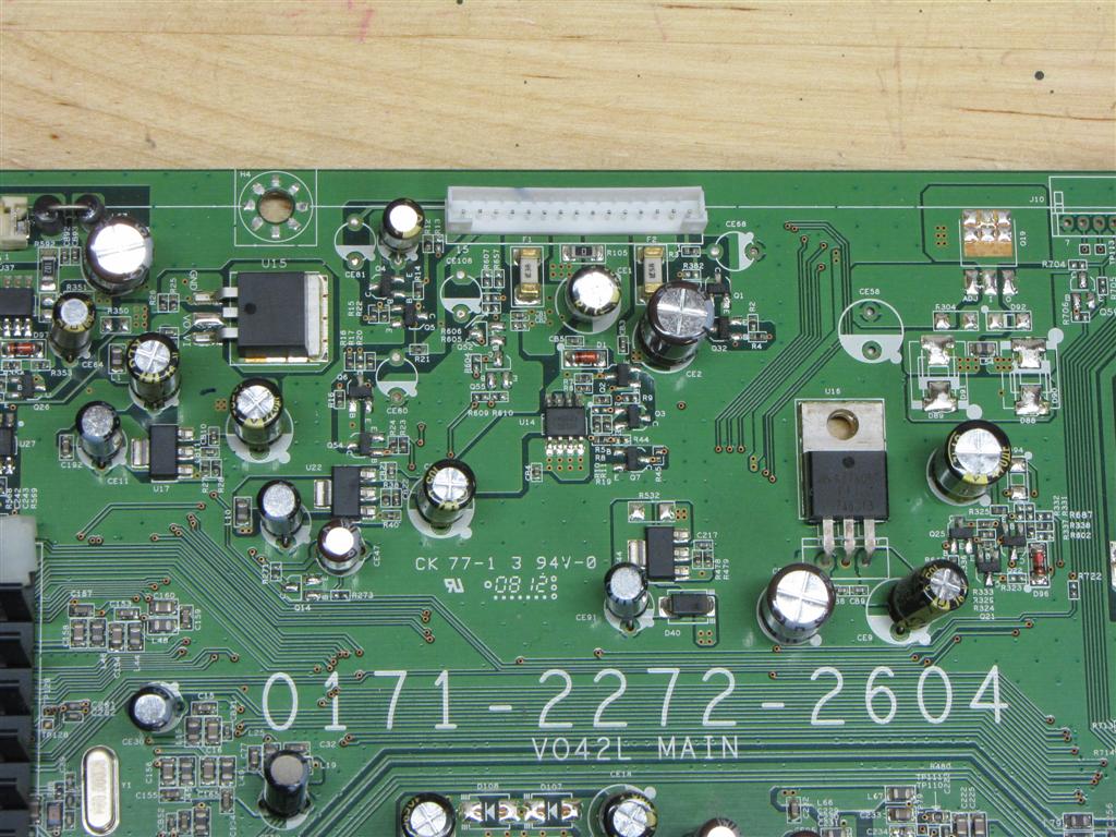

        I have attached some pictures of the power supply, main board, and the Master Inverter boards.
          Re: Vizio VO42L FHDTV10A will not turn on...

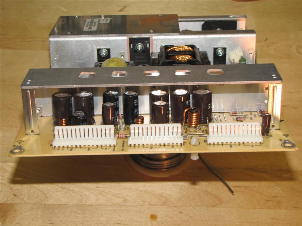

          It helps if you keep the pictures as close to 2000 x 2000 pixels as possible. That way I can read the labels on the connectors. I get tired of asking for clear pictures.
          This is a dual power supply with PFC front end. In the picture of the entire supply the smaller transformer to the lower right is for the standby supply. Hook the supply up to the main board and the AC cable.
          Points to check. What is the voltage across the large (150uF, 450V) cap? Do you get any readings between any of the pins on the connector at the lower right?

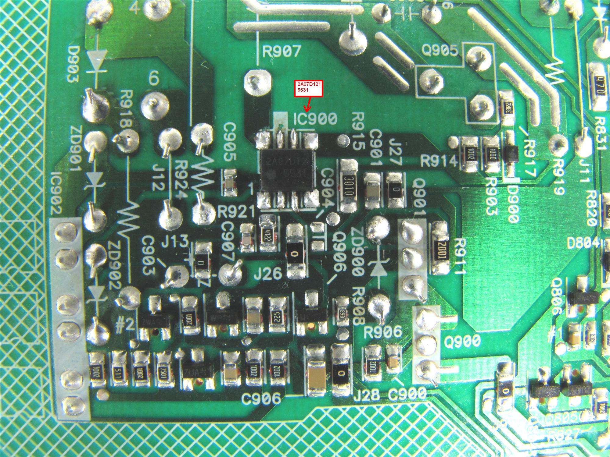

              That really helps to narrow the problem down. The standby supply isn't coming up. Now to figure out why.
              On the picture of the bottom side of the board there is an eight pin IC near the top center of the board. It is slightly above and to the left of the transformer I have identified as providing standby power. What is the part number of that IC?

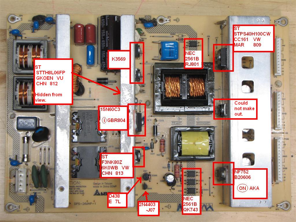

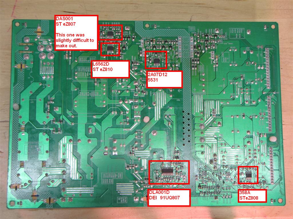

                I have attached additional pictures with labels. I hope this helps.
                  PlainBill - thank you for your assistance.
                  Not really - but it's not your fault. I can't find any references to a 2A07D12.

                      You have listed 5 ICs on the board. They are DAS001, which appears to be a legitimate number, but I have been unable to discern it's function, in large part due to a lack of interest - it's associated with L6562D, which is a PFC controller from ST Microelectronics. The DLA001D (actually an L6598) is an SMPS controller, and is obviously for the main supply. The 358A is actually an LM358A, a dual op-amp.
                      The only one I have been unable to identify is the 2A07D12. By it's physical location and some clues from the picture, that chip is the SMPS controller. With the datasheet for that IC I MIGHT be able to figure out if it is defective, or if the problem is elsewhere.

                              Well I installed/soldered the BD9897FS chip onto the Slave Inverter board. Made sure that all 4 MOSFETs now read 8.6Kohms across the Drain and Source. Connected everything back up and hit th epower button... nothing.

                                    I have spent time trying to track down the 2A07D12 5531 8-pin chip.
                                    I came across a website of someone looking for a very similar part (2A06810 5522), and it was suggested that the part number was most likely Fuji Electronics FA5522.
                                    I thought I try searching for Fuji Electronics FA5531 and sure enough I found some information. I also found that ON Semiconductor equivalent is NCP1207.
                                    In past posts this is the chip which PlainBill could not identify. I'm hoping this information will help me get further into figuring out what is wrong with the PSU (assuming that FA5531 is infact the correct chip).

                                      It appears to be a match; at least I didn't see any obvious discrepancies.
                                      Using the negative lead of the 150uF, 450 V cap as the ground point, with power connected carefully measure the voltage at pins 1-6 and 8 of the SMPS controller. I am particularly interested in the voltage at pins 4, 6, and 8. This IC uses a internal current source to provide start up power. Historically, these ICs have a higher failure rate than those which use a resistor (or resistors) to drop the voltage to the IC. Also, with power off, what is the value of R907?
                                      PlainBill
                                        PlainBill, I finally had a chance to measure the voltages and the value of the resistor. Pin 6 measures 8.4v, pin 8 measures 13.3v, and all other pins measure 0v. For the heck of it I also measured pin 7 which indicated 0.1v.
                                        Also, resistor R907 is a 100Kohms that measured 99.4Kohms.
