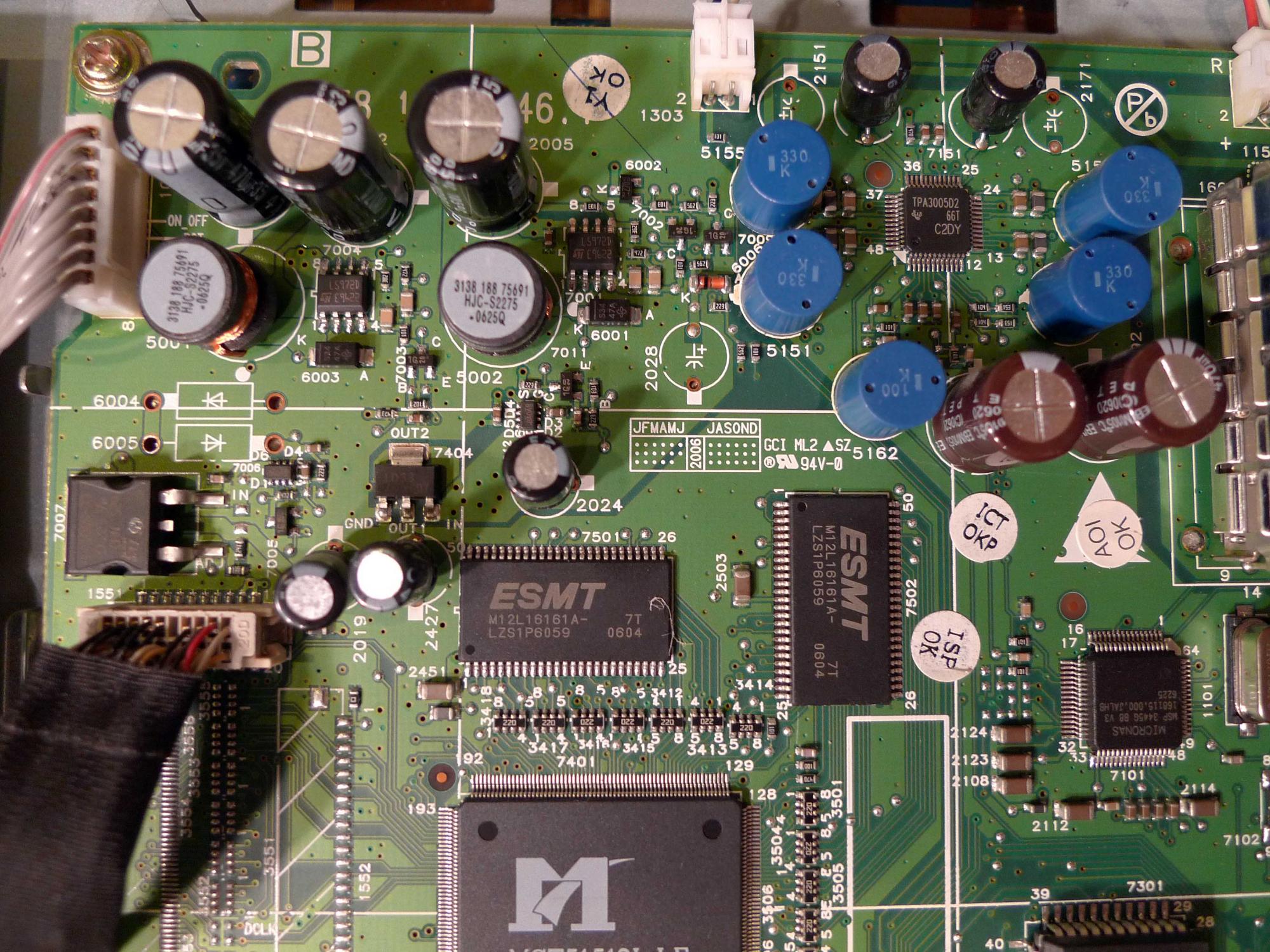

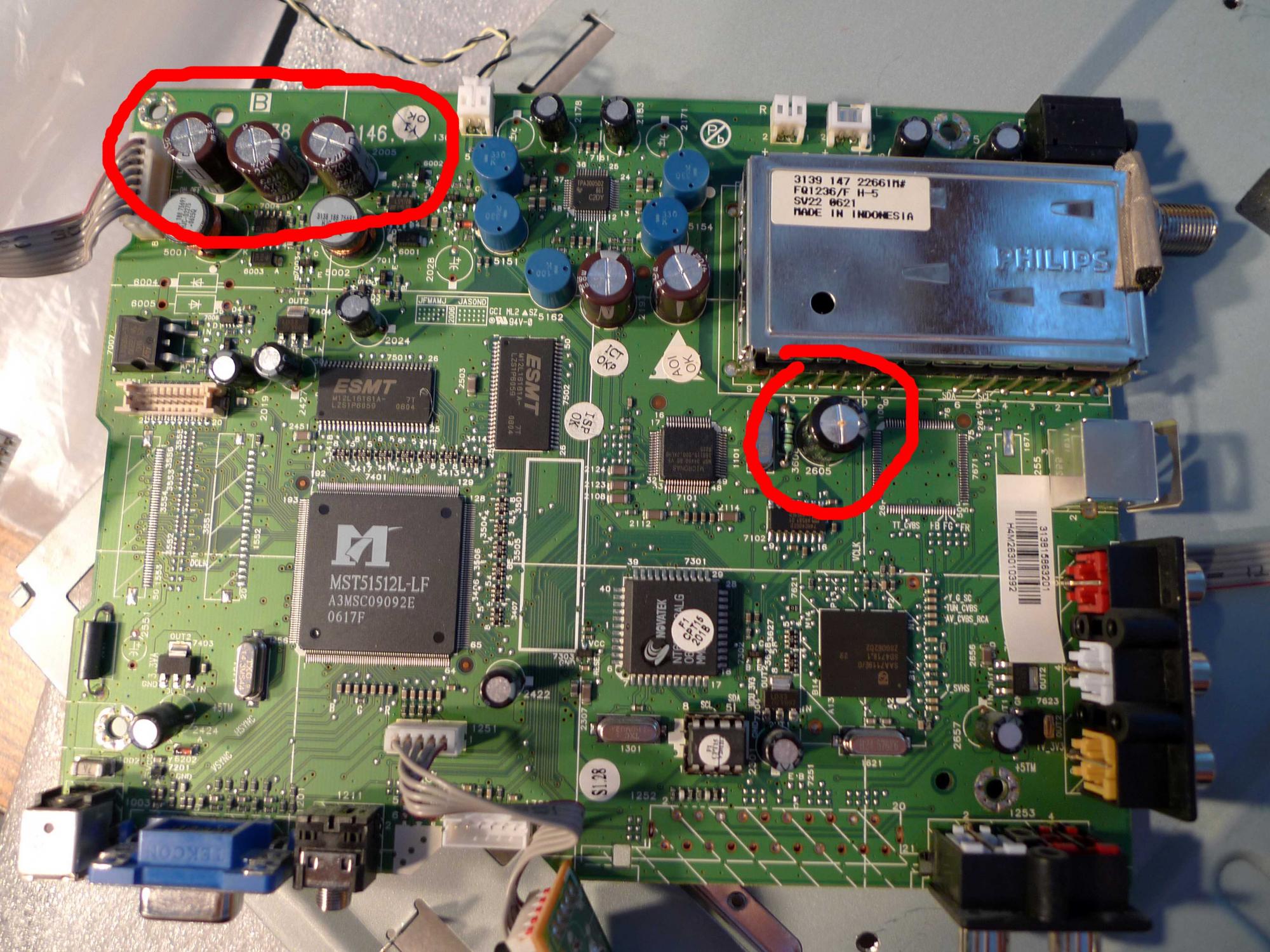

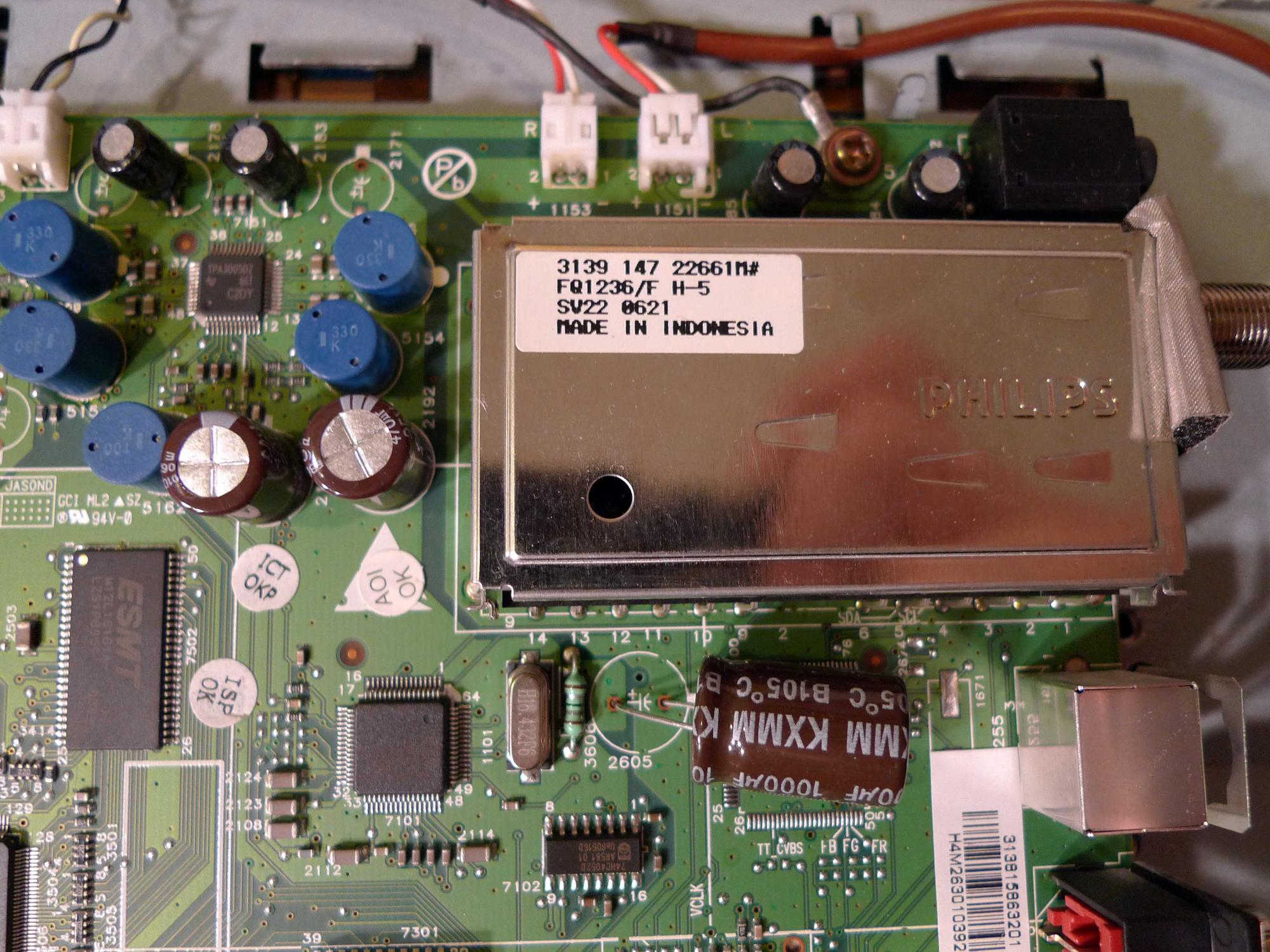

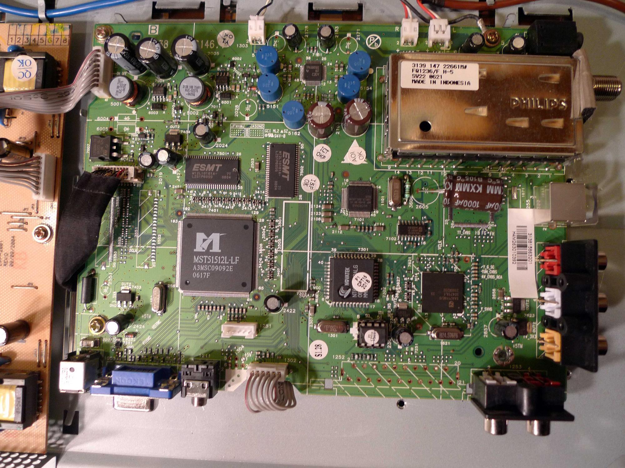

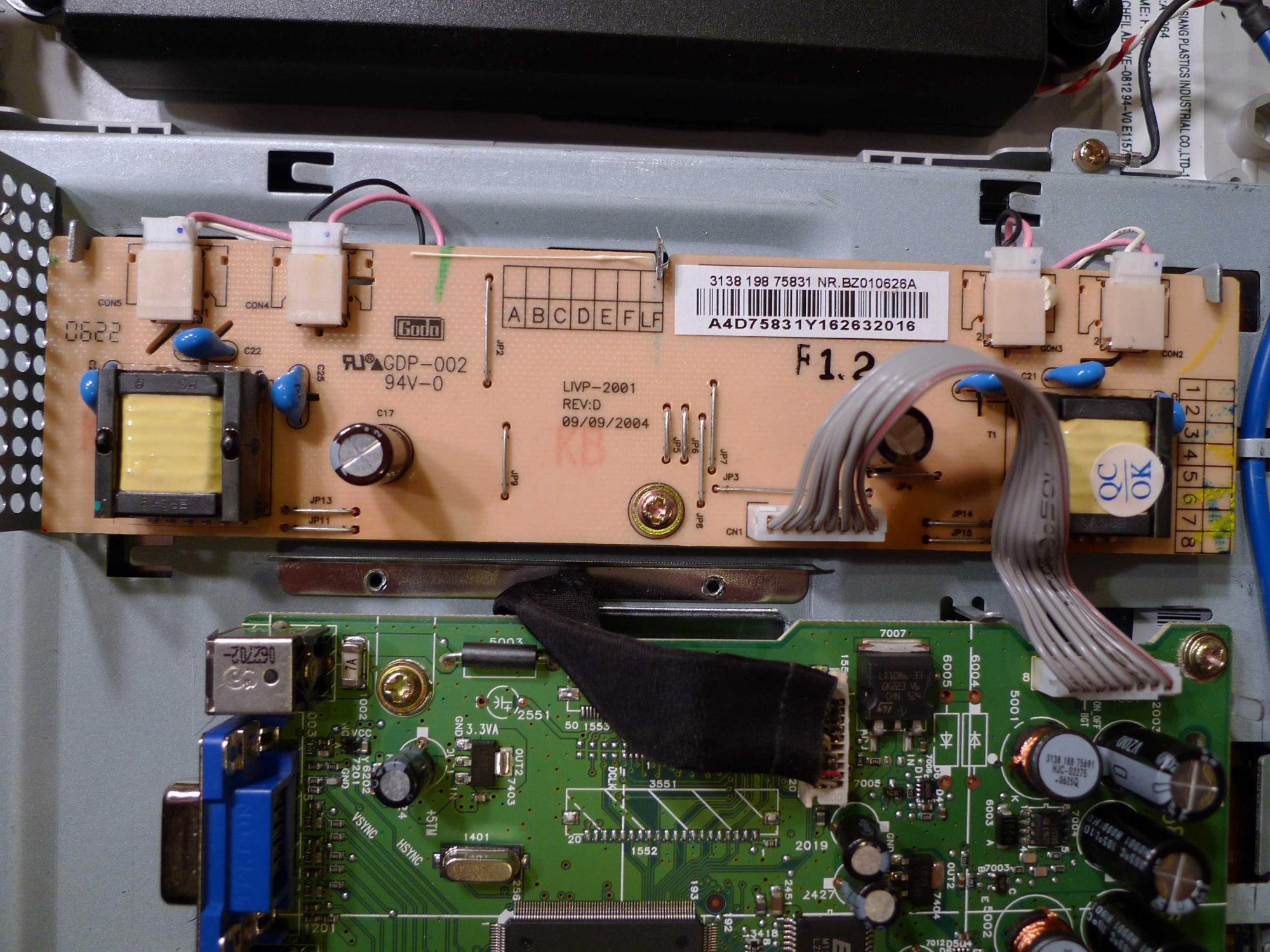

    Picked this little guy up for free and thought it would be an easy fix since I saw buldged caps on the inverter board and power supply. But replaced them and nothing. I turn the power on and I see nothing, not even anything dim w/ shining a flash light through and no sound. So I'm guessing there's something up with the power supply. There was one bulged cap that was kind of out in the middle of no where on the power supply which I thought was weird.
    Thoughts?
    EDIT: Just replaced the caps circled in red and the 2 on the inverter board.

    It appears this uses an external power supply. Are you getting the proper voltage out of it? Have you checked the various voltage regulators to see if they are working?

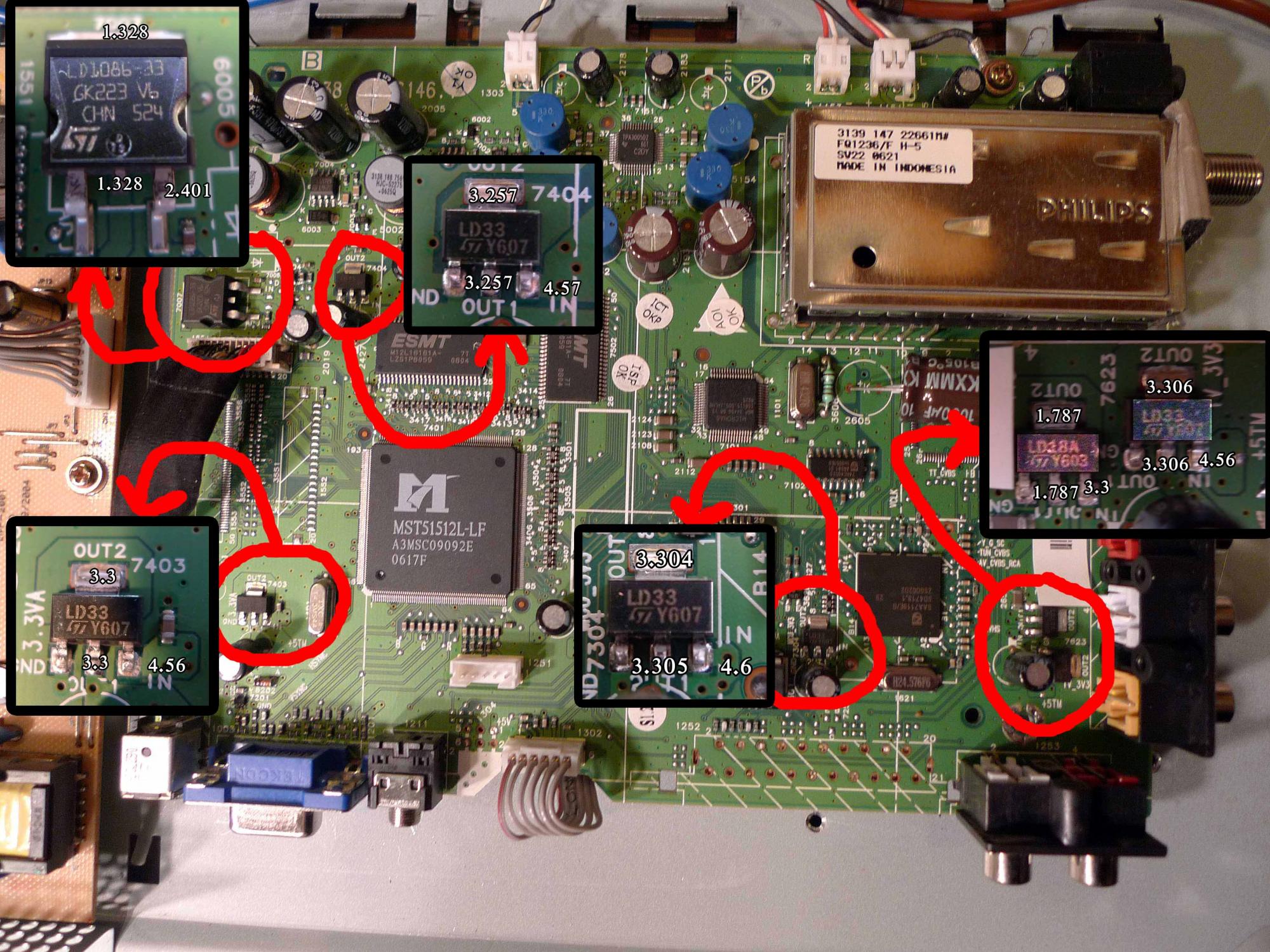

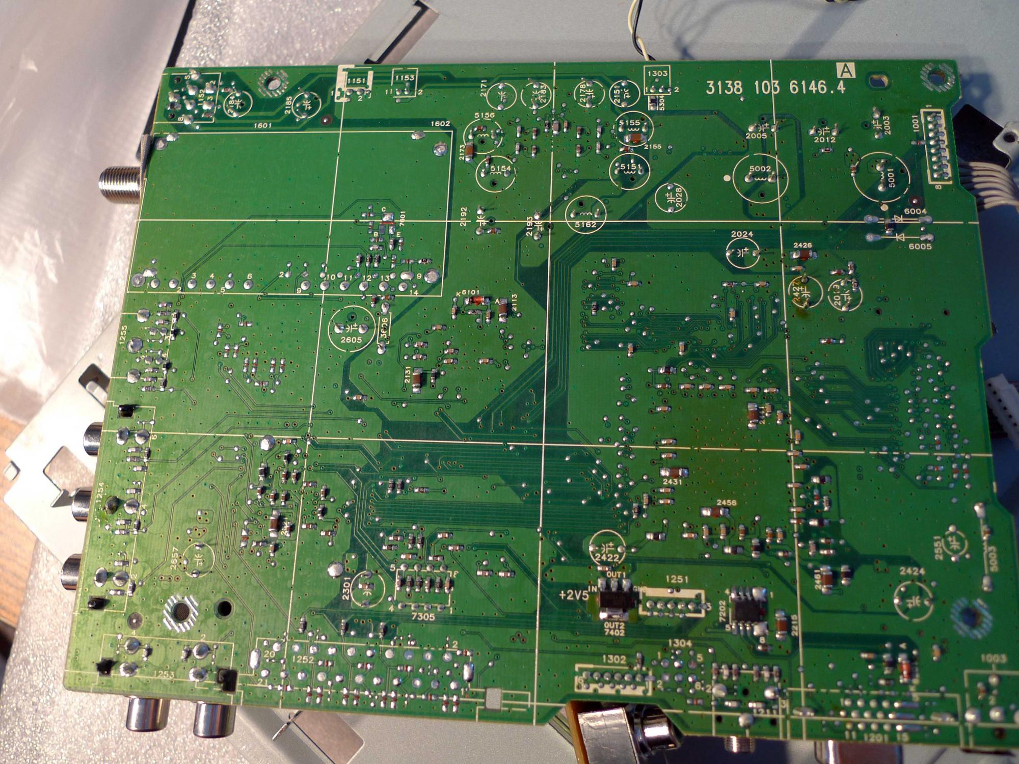

      As far as voltage converters we got...
      (1) - LD1086-33
      (4) - LD33 Y607
      (1) - LD18A
      I'd help find the datasheets, but for some reason I'm not good at finding them

        http://www.alldatasheet.com/datashee...CS/LD1086.html
        the LD1086-33 should be putting out 3.3V, but it's only 1.328V...
        the LD18A (1.8V) is a little bit low for my liking, but one that may be still ok..
        LD1086-33 -> 3.3V
        LD33 -> 3.3V
        LD18 -> 1.8V
        edit: btw.. the center pin and the tab are the same thing on those..

          Wahoo!!! We have a smoking gun!!!
          That was an interesting way of posting the results. I almost asked 'Why the dickens didn't you post the voltages???'
          Note that there is a problem at the LD1086-33 at 7007. The input voltage is less than half what is required for good regulation. Also, the LD33 at 7404 has a slightly low output. I'd investigate the LD1086-33.

            just an idea.. if the LD1086-33 (7007) gets hot, try unplugging the panel cable below. something might be shorted on the panel (T-Con?), overloading the v-reg & dragging down the voltage..

              Alrighty... I'll trace back from the LD1086-33 and see what I can find.

                  The LD1086-33 is the baddie! unsolidered the "in-lead" and tested the voltage and it was 4.6 (something close to there) and then when I placed the lead back down, went to 2.63. So just need to order a new one of those hopefully!

                    check the resistance on the output of that IC. if its low, itll explain something dragging down the IC. if not, the IC is bad.
