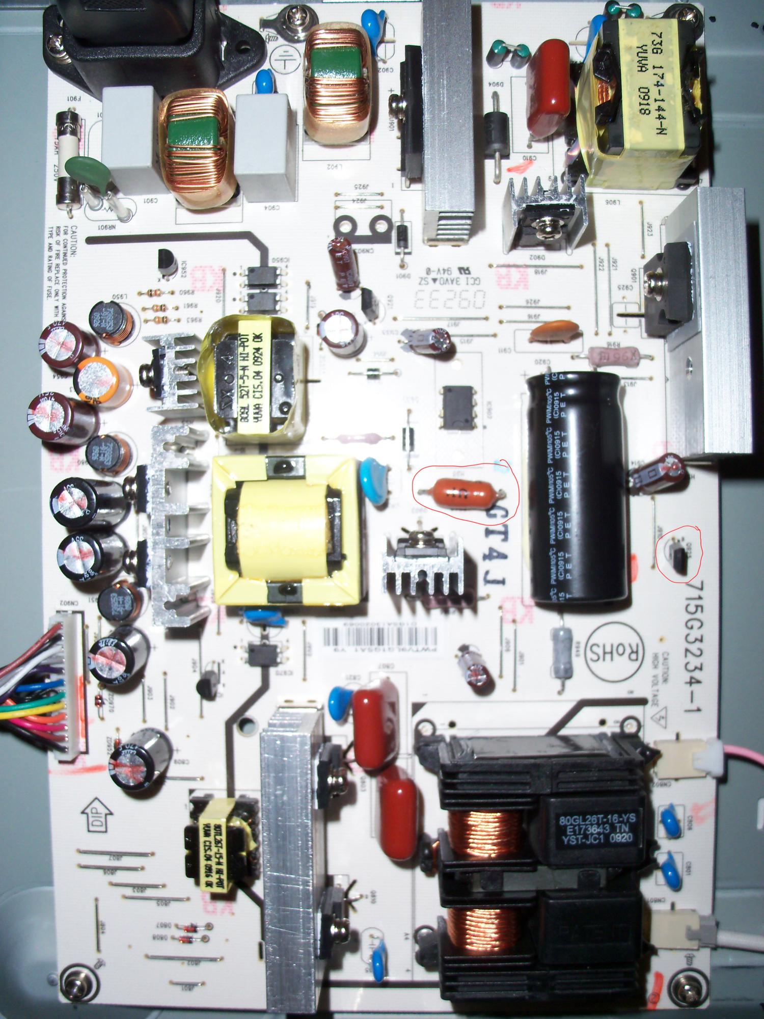

    I got a vizio 32"lcd with a bad power supply for $20
    initialy unit failed to do anything when plugged in.
    found a resistor blown, and replaced it, now yellow light on front flashes, and 5 volt lines read 4.2 and 2.3 volts.
    also found a transistor with signs of arcing corisponding with arcing marks on the metal housing of the tv.
    put arced transistor on my multimeter, it read 0
    i assume that is bad
    transistor is a1273, capacitors are "elite" brand, should i replace those at the same time as the transistor or not?

    I would order new caps and replace the transistor. I would replace the transistor first and retest (to verify or find root cause). If it works, I would still replace them with some high quality low ESR caps.

      I looked up the elite caps, and am replacing the big ones with panasonic FM's
      however the small ones are listed as "low impedance high ripple" what is sutibale for that?
      also another cap is an elite EA cap wich isnt listed

        Sometimes the datasheets for caps are not available, so I just generally go with Panasonic FR, FM, and FC (in that order).

          I also need a equivalent transistor to A1273

            For jap/kor transistors you need to add 2S in front of the product code. So it's 2SA1273... nothing special. PNP -30V -2A 1W 120MHz. If you can't find an equivalent on your own please state your location so that we can point you to a parts distributor in your area.

                thanks, got the transistor from electronix
                any reason to order a new primary cap?

                  Not unless it gives you warm fuzzies line caps even crap ones rarely fail and can be left alone.

                    replaced the blown transistor, now both +5v lines read 4.2v when hooked up to the main board/led.
                    when tested without load they read 5v, but clearly dont have the power to drive the board.
                    still waiting on caps from digikey, will recap, then try again.

                      that component doesnt appear to be a resistor. it appears to be a FUSE.
                      • rubicondsrv
                        • Nov 2010
                        • 39
                        Re: reviving vizio power supply
                        the red bloby thing?
                        that is a .1ohm resistor that replaced a blue .1ohm resistor with a hole in the side.
                        • mbates14
                          • May 2005
                          • 169
                          ah, ok, so its a fusible resistor.

                            mabey, I just got it from a local shop, not sure what its specs are apart from being .1ohm and rated for 3 watts.
