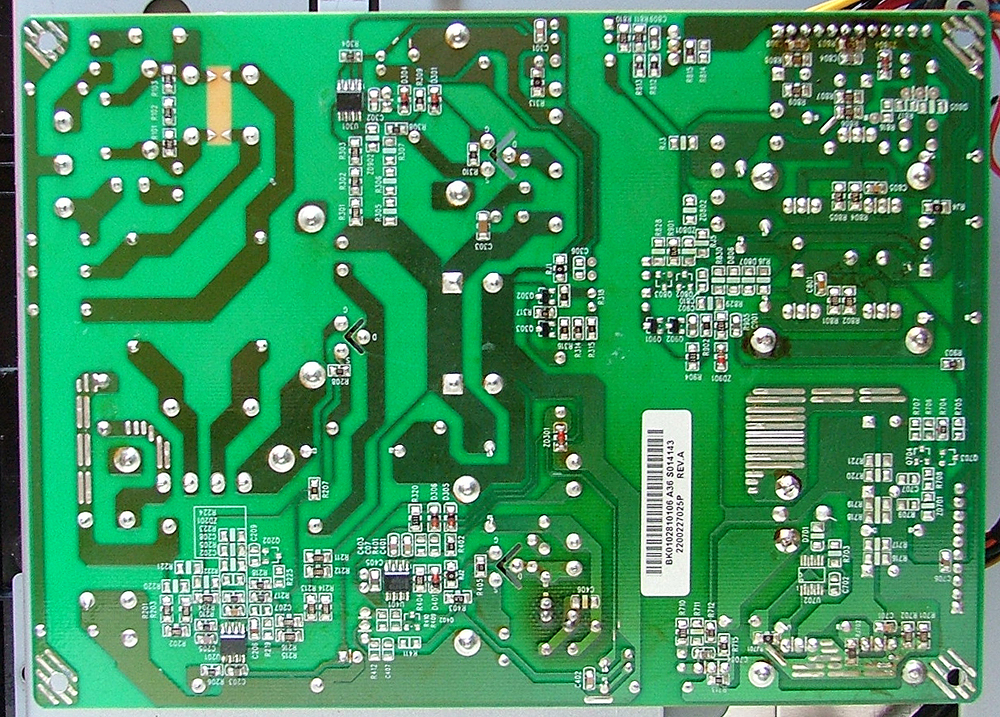

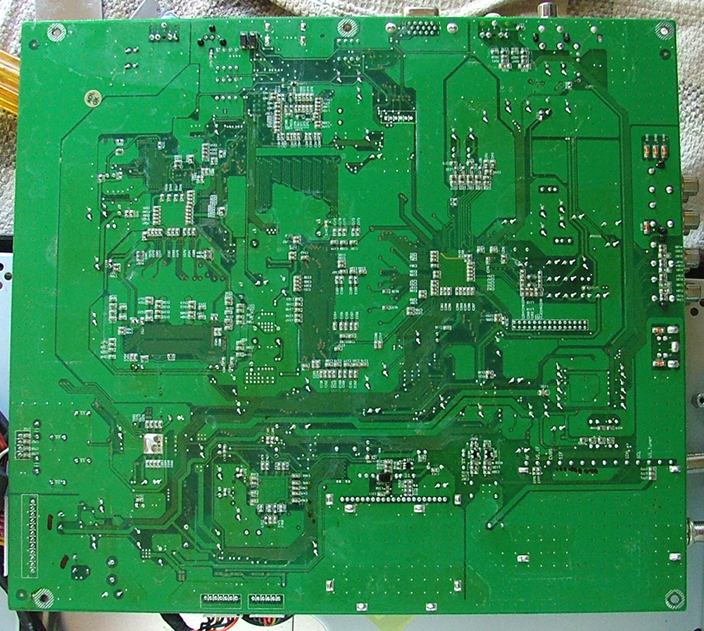

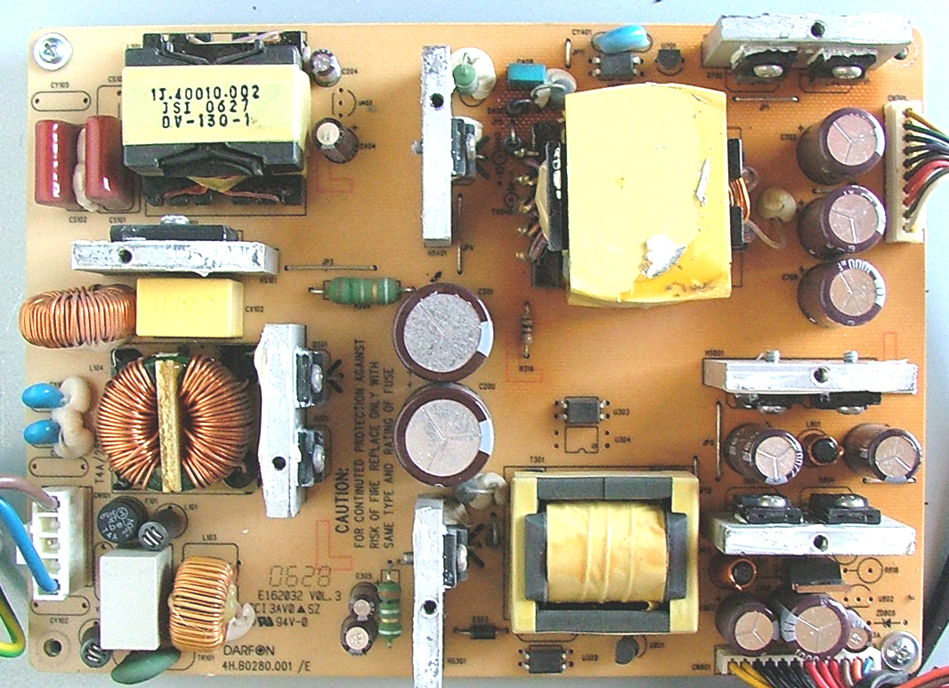

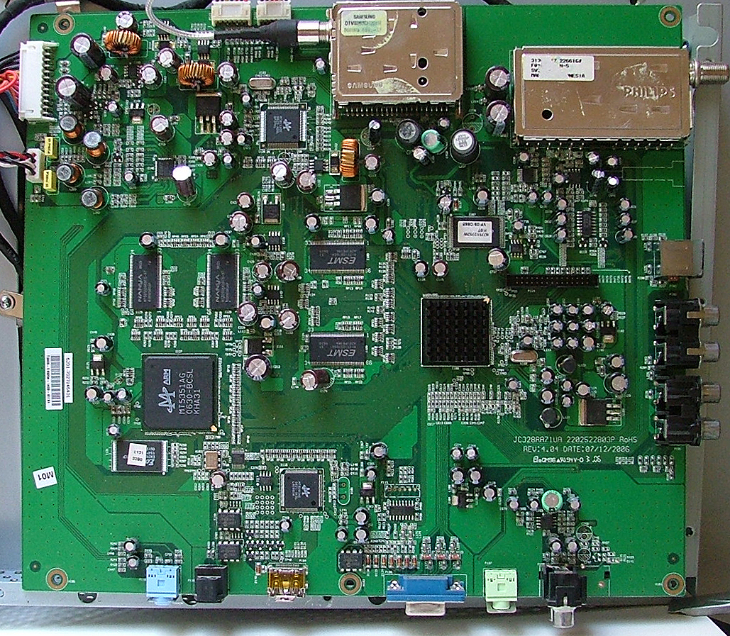

                Thanks for the responses I've received so far, they keep my enthusiasm up. I've included jpegs of the power board and main- video board. I'm thinking the problem is in the main board but I can't be sure. The back light works well. The screen shows an illuminated grey blue color with a thin bright blue vertical line running down the middle of the screen. I'm wondering if the entire screen is being reduced to that thin bright blue line. Any thoughts? Cheers......Ray

                  Re: viewsonic n2751w dark blue screen
                  Illuminated white/gray screen with no picture is more likely to be a t-con board failure. The blue line is a bid odd, though. If possible, post some pictures of the t-con board.
                  Meanwhile, I suppose it also wouldn't hurt if you check the voltage regulators on the video/logic board.
                  With the TV plugged in and turned on, measure the voltage on all of the voltage regulators on the video/logic board. I see 10 of them, but there may be more. These very rarely fail, but it's still worth checking. Let me know if you need help locating them.
                  The way you measure the voltage on a voltage regulator is you put the (-) multimeter probe on ground (any metal part of the case of the TV) and the (+) probe on the tab of the voltage regulator.
                  It also looks like your video/logic board has some HERMEI caps - they're known to be crap - but let's assume they're fine for now and just check the items I mentioned above.
