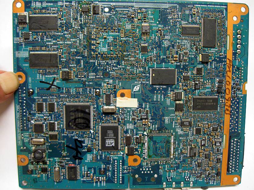

    Re: Toshiba Plasma TV 42HP95 ...seine board pics to check
    I figured those large board jumper/connectors out, basically you need a strong glass to see and study the tiny and fragile plastic locks. I had to remove the upper black one from both sides first, then the left side on the grill-like spring connector leaving it on the seine board. Removing the board from the chassis after that was no treat either...no wonder they charge so much on these sets...a lot of disconnecting to remove one board. Speaking of boards if you were wondering there are no less than 20 on these plasma sets...whoa, give me that cheap Vizio to work on it only had 6 or so !
    Anyway now attached are the top and bottom of my seine (main) board, will you sharp eyes please help me look for damage, any suspects, and which you think are the ceramic capacitors?

        Toshiba TV 42HP95.....> cap ID's on seine board
        I'm stumped on some capacitor ID's as are the techs at Digikey and Mouser...do you know how to read these cap ID's, marked thusly...
        10
        CHB.
        507
        another example is :
        100
        CHK.
        5v7
        You can see them both in lower left of 1st pic in my new post # 2.
        • kingofcoins
          SaveOnGreen-Cap
          • Jan 2010
          • 162
          Got it !
          I found the right tech who figured they may be Panasonic and the codes in their catalog are here for aluminum eletrolytic SMD's:
          10 > 10uf capacitance
          CHB. > C is pan code for 16V, and HB is their series
          507 > a lot number
          100 > 100uf
          CFK. > C is for 16V, and FK is the series
          5v7 . again a lot number
          I have 12 SMD caps to replace so stay tuned for my seine board fix report...

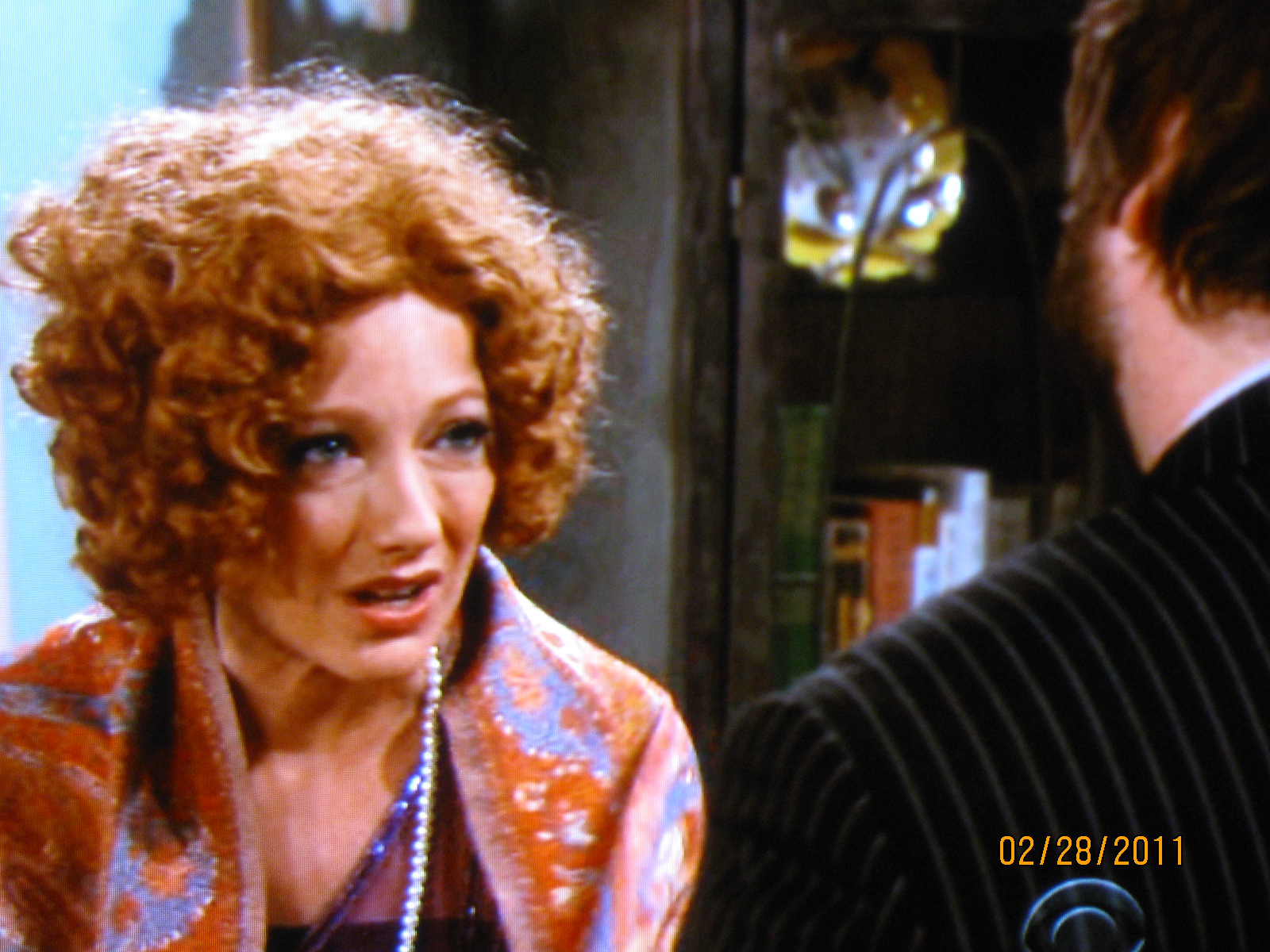

                It was a long battle but I finally won the 'seine' war ... I don't think I can explain it other than it took many long hours of careful probing and reading of tiny parts..and in the end was probably luck that I happened to change the right SMD's in my last go around. All I can say again is if you try this fix, is look to the SMD ceramic caps....or send it in.
                Here's a pic of my view now...
