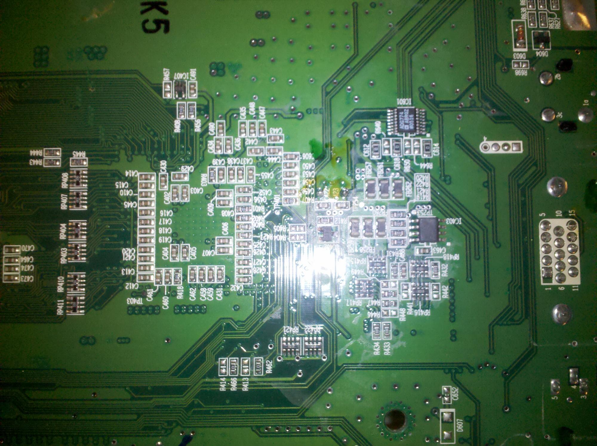

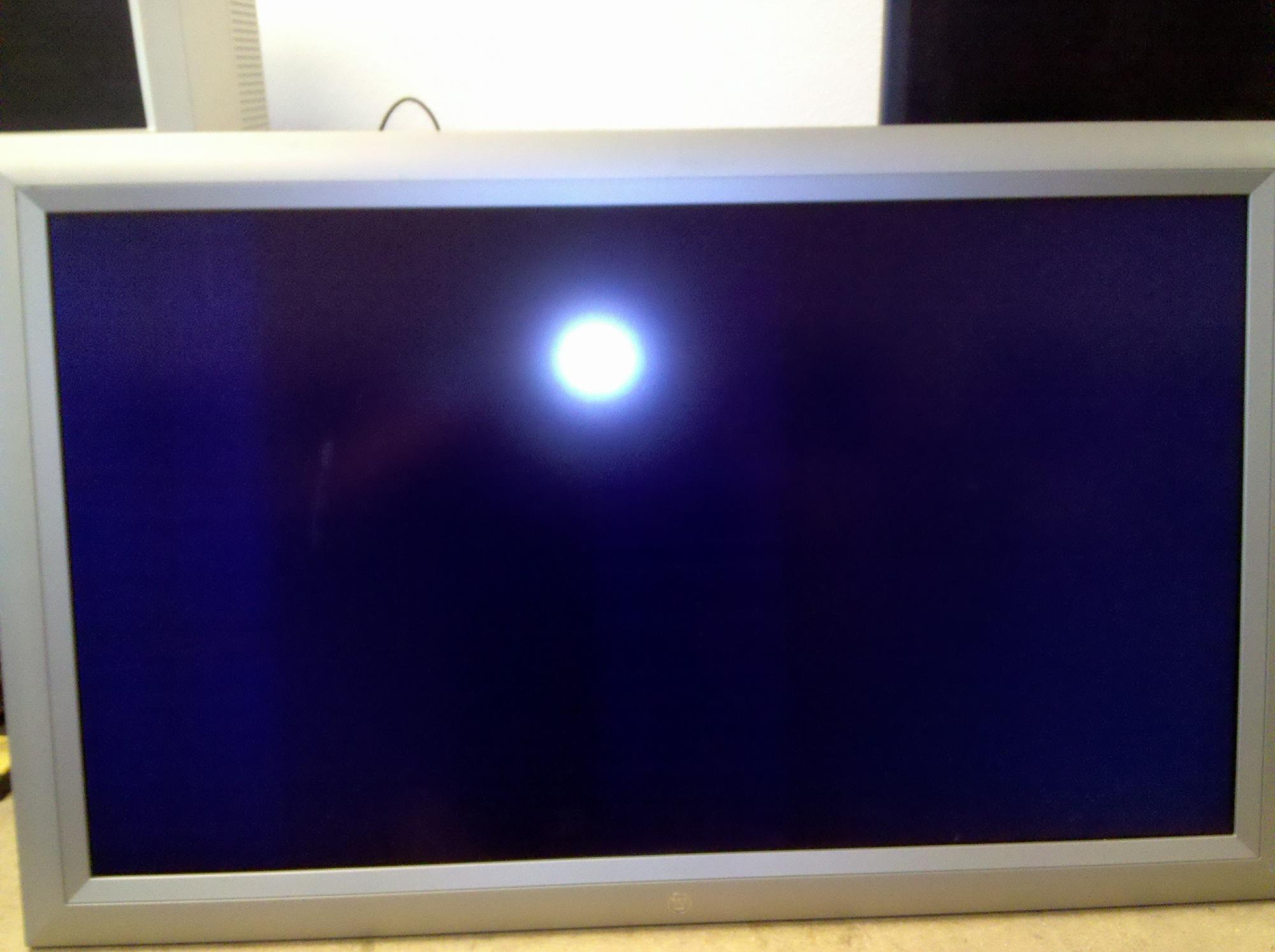

    i have a 37 inch westinghouse lcd tv and when i turn it on it powers up and i can see video but its all distorted, the video is flashing and looks like there are lines. It was working just a few days ago just fine. ive taken it apart and i dont see any burn marks or blown caps ill up load some pics now.

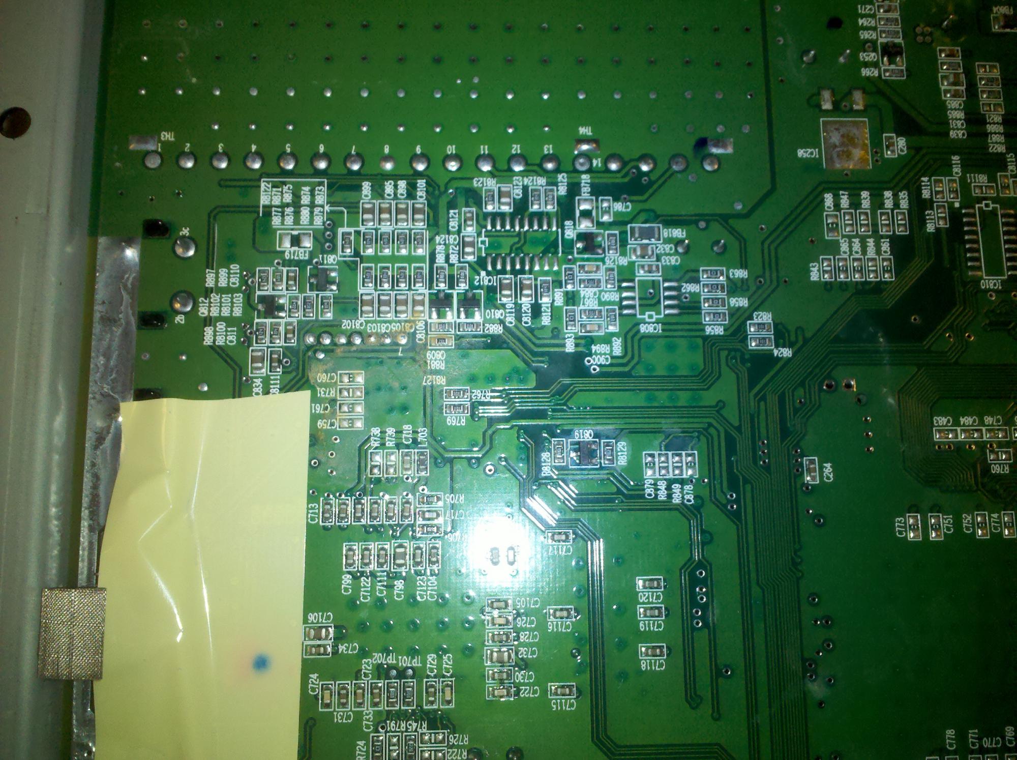

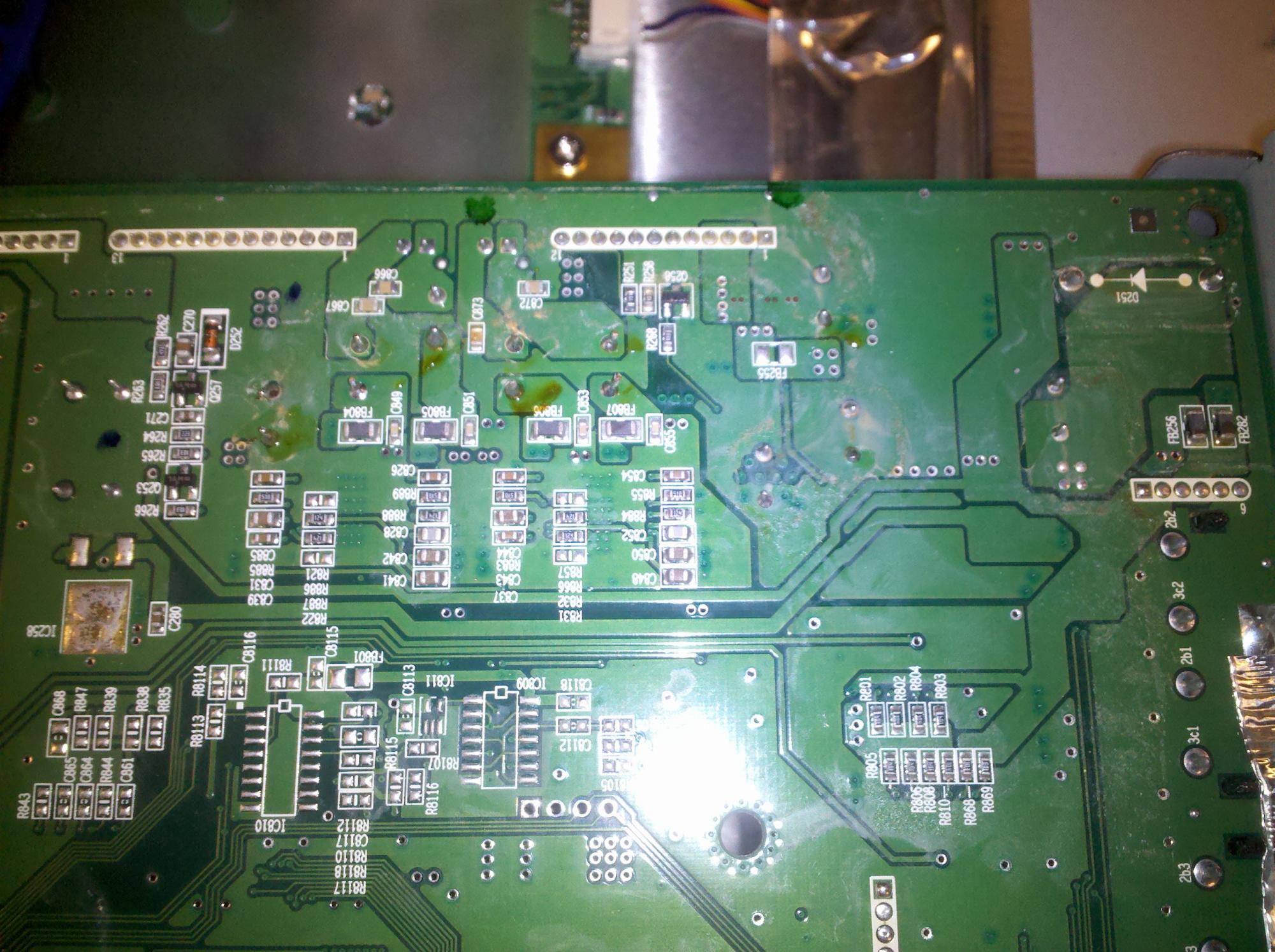

        here are some pics i took a few days ago. it looks like it had some water spilled on it and i cleaned it and resoldered the areas that had water stains and that seemed to fix it for a while but now its not working again.

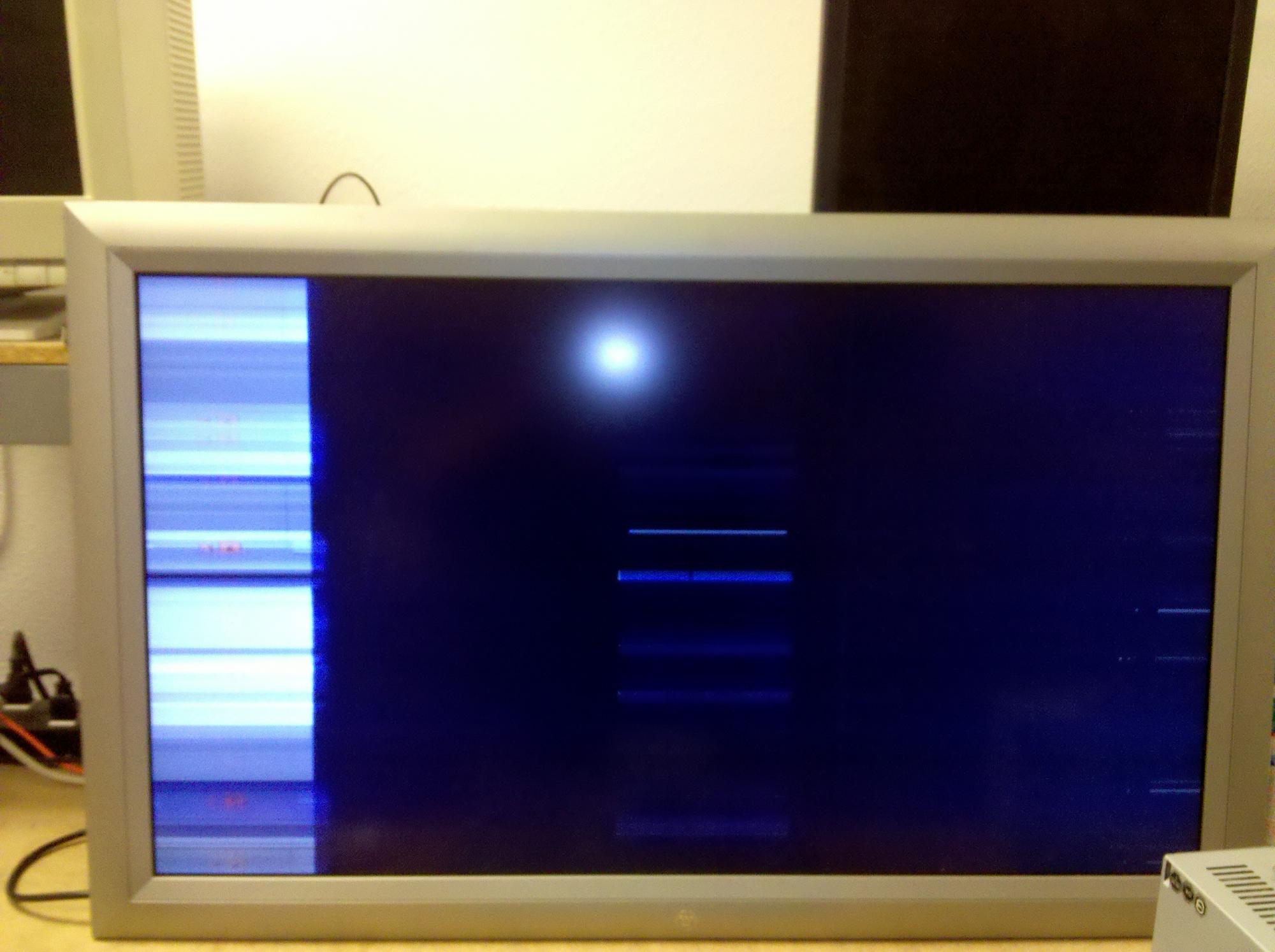

          Re: westinghouse lvm-37w1
          here is a better pic of what the tv screen looks like
            Possibly Tcon, or a bad panel.
